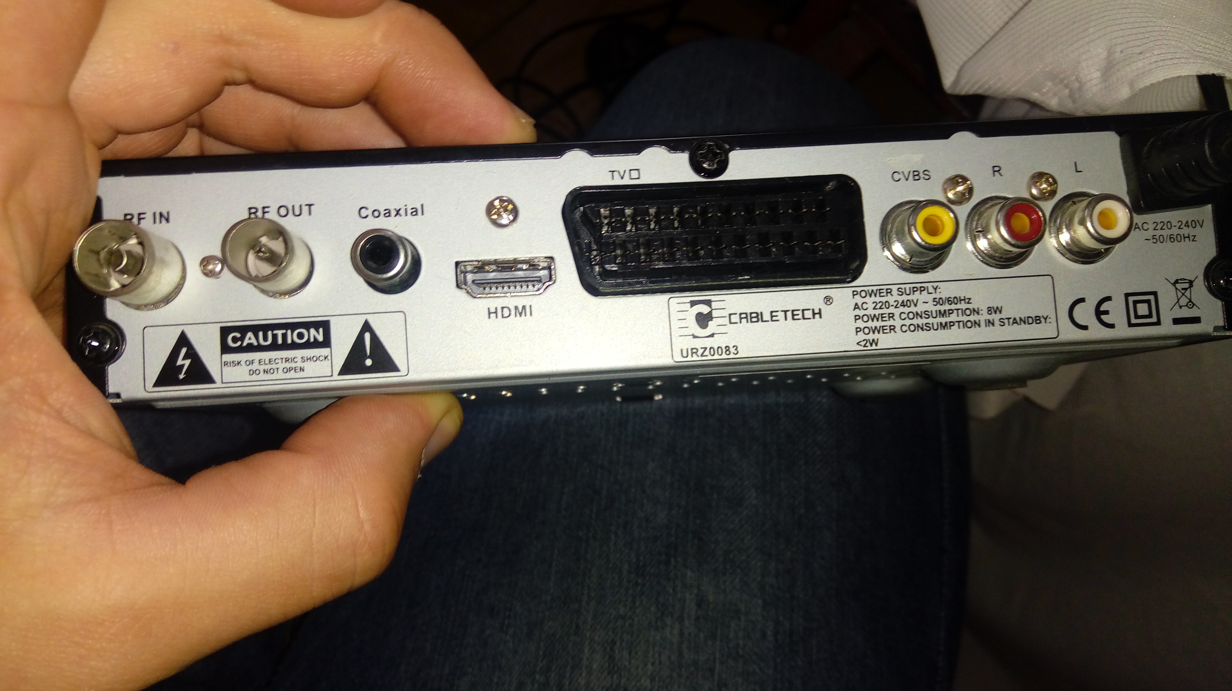

    When searching, does not look in these channels (except 6 to 12), does not find these channels.

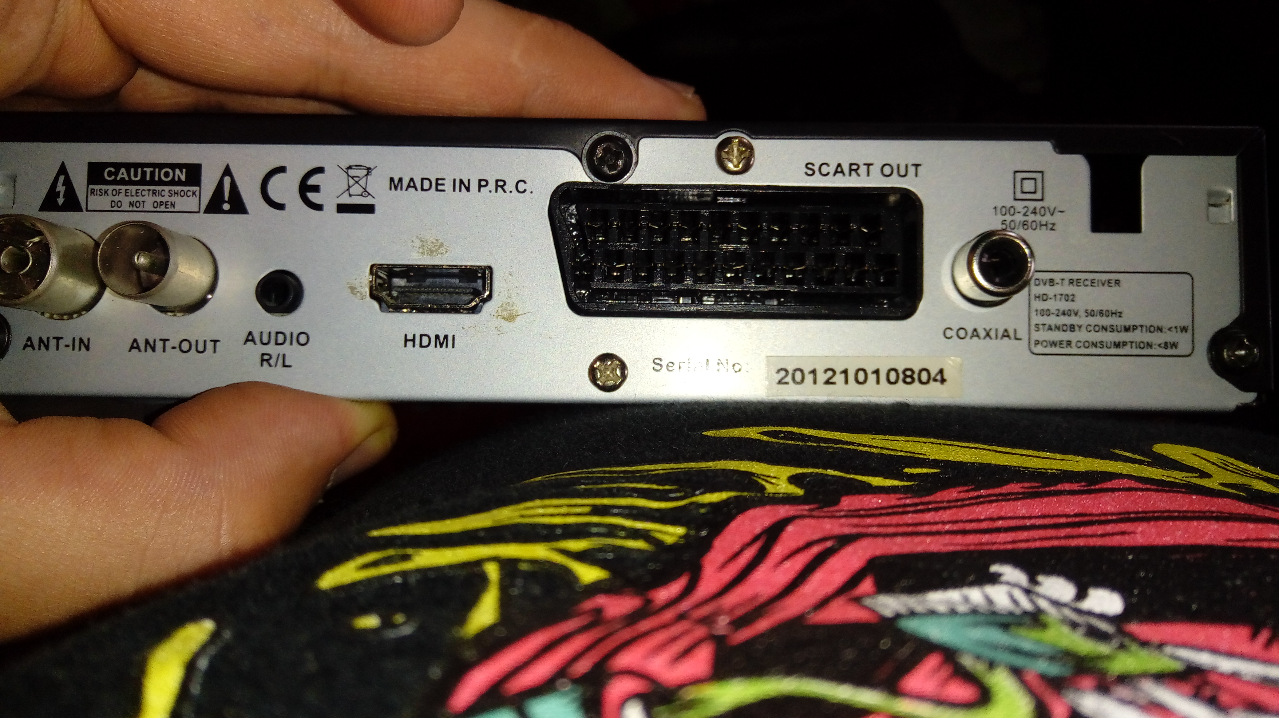

    A decoder connected to the same antenna searches and everything flashes.

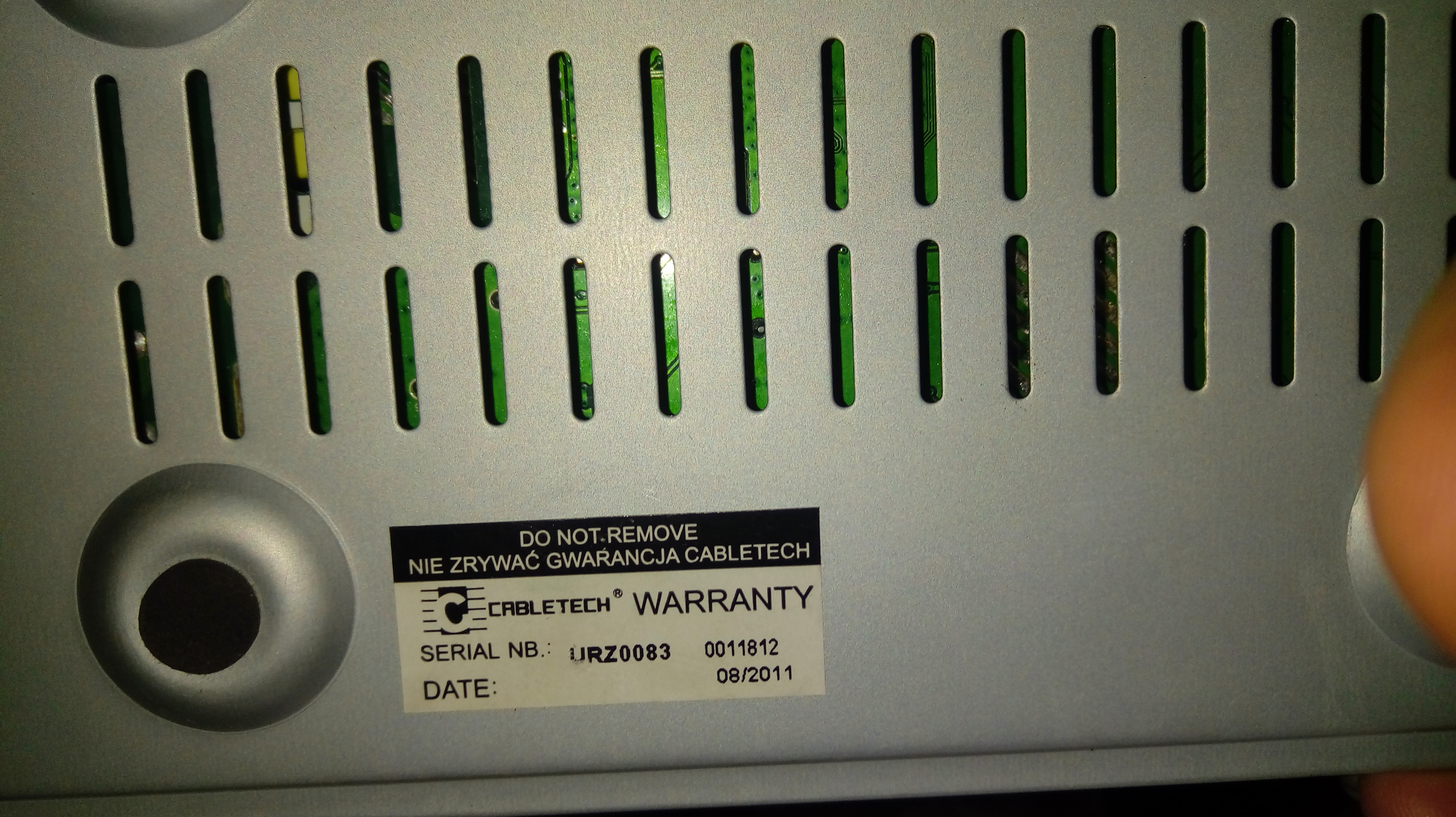

    This decoder is from 2011 Cabletech URZ0083 Decoder Issue: Missing MUX 8 Channels (6-12) Despite Antenna Connection Cabletech URZ0083 Decoder Issue: Missing MUX 8 Channels (6-12) Despite Antenna Connection Cabletech URZ0083 Decoder Issue: Missing MUX 8 Channels (6-12) Despite Antenna Connection

    This decoder does not automatically search for all items. As mentioned above, you should manually set the search parameters for MUX 8 and manually search for channels. It worked for me.
    Good luck

    Older type of decoder
    You had to manually enter the frequency.
