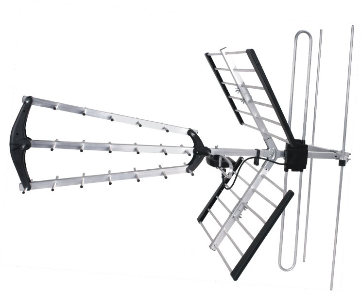

    Installing channels and only 7 is found. How to find them all Hello
    I have a FUNAI 32FDB5514 / 10 TV set, after the technical data that I will add as a picture, I understand that I have a built-in tuner for receiving analog and digital TV in this TV, am I wrong and I need a decoder? I bought an antenna DVB-T ANTENNA OPTICUM COMBO AX1000 SET 3 TV MUX8 but I only have 7 channels, how to get reception of all available terrestrial channels? I live in Gdańsk and my transmitter is from Gdańsk Chwaszczyno. The distance from me is 20 km.

    In the link, transmitters min. - Gdańsk. Search for other muxs manually ...
    Mux1-k58
    Mux2-k35
    Mux3-k48
    Mux8-k6 pol. vertical
    https://emimaps.emitel.pl/
    • Installing channels and only 7 is found. How to find them all t_ax_1000.jpg (50.85 KB) You must be logged in to download this attachment.

    Buddy, you have a high-gain antenna, do not use an amplifier because you are distorting the signal at the head's input. The quality parameters are going down and hence the trouble.
    20 km from the transmitter that "blows" 100kW on MUX 1/2/3 is not much for this antenna. Put the amplifier in the drawer.

    Mux8-you receive in vertical polarization -antenna complex as in the picture above

    Installing channels and only 7 is found. How to find them all My antenna is assembled so I can't put the rear wires vertically, unless I turn the antenna completely
    However, now I noticed that the neighbor has the same antenna, but there is no such element at the end of the antenna as I do, can it be the fault that I cannot find the channels because I understand that my antenna now has horizontal polarization?

    On MUX 8 there is no chance. It is in vertical polarization and this antenna will not receive it. Rather, as a colleague wrote the amplifier to be thrown out, but MUX 8 should not be received by the antenna

    You won't pick up Mux8, but the others will. Unscrew the amplifier, but you have the antenna low - it's probably the 1st floor ...

    The neighbor just doesn't have an attached VHF part. I suspect that my colleague's antenna has UHF and VHF permanently mounted on a common drawbar for reception in the field. H. It is like that in the description.

    Ok, I threw the amplifier away, see what happens. Okay, otherwise, maybe there are about 32 programs on terrestrial TV, if I'm not mistaken, I have 7 programs, what antenna or what I need to have to receive all these programs.
    I would like to add that I have a power supply connected to the antenna and TV, is this not a problem?

    First, try to receive without an amplifier ... disconnect the power supply

    The power supply is not needed. I would suggest putting on an LTE filter

    Gentlemen, thanks beautiful, I was able to find everything and the antenna is picking up even MUX 8 I disconnected the amplifier and the power supply once again the cable manual search and your help and I have everything thanks again
