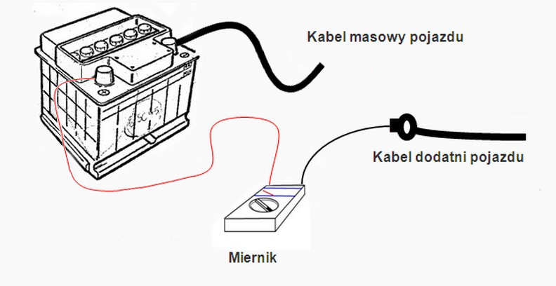

    I have a pytanko I connect as in the attached picture and I have a fuse in the meter. Why?

    Do you measure on the ignition switch off? Maybe the collection is greater than 10 Amp.

    Do not turn on the ignition.

    Power consumption higher than 10A and that's why the fuse is burning :P
    The second reason may be the ignition turned on, and when you try to start with the meter it is not at all :)

    At the moment of connecting the power supply, some components of the car are started and the momentary initial power consumption is considerable. So at the beginning of the test, connect the meter and connect the power supply, and then remove the jumper.

    klepka-l
    Posts: 59
    Rate: 26
    Checking Power Consumption in Car: Fuse in Meter with Attached Picture Setup Explained
    When connecting the meter, make a jumper (green) as in the picture, then disconnect it and then it will show you what is the power consumption at rest. Because the devices need some energy when connecting the voltage source, eg capacitors must charge, on the radio and other devices

    Do not connect the meter directly. Use a measuring bypass, eg this one
    https://sklep.avt.pl/bocznik-pomiarowy-100a-60mv.html
    which you include in a series of klam. And with the meter you measure the voltage drop on the shunt. You know the value of the current from Ohm's law. When the current flows 100A, the meter will give you 60 mV voltage drop on the shunt. As 100A is too much (and little sensitivity), use a smaller one.

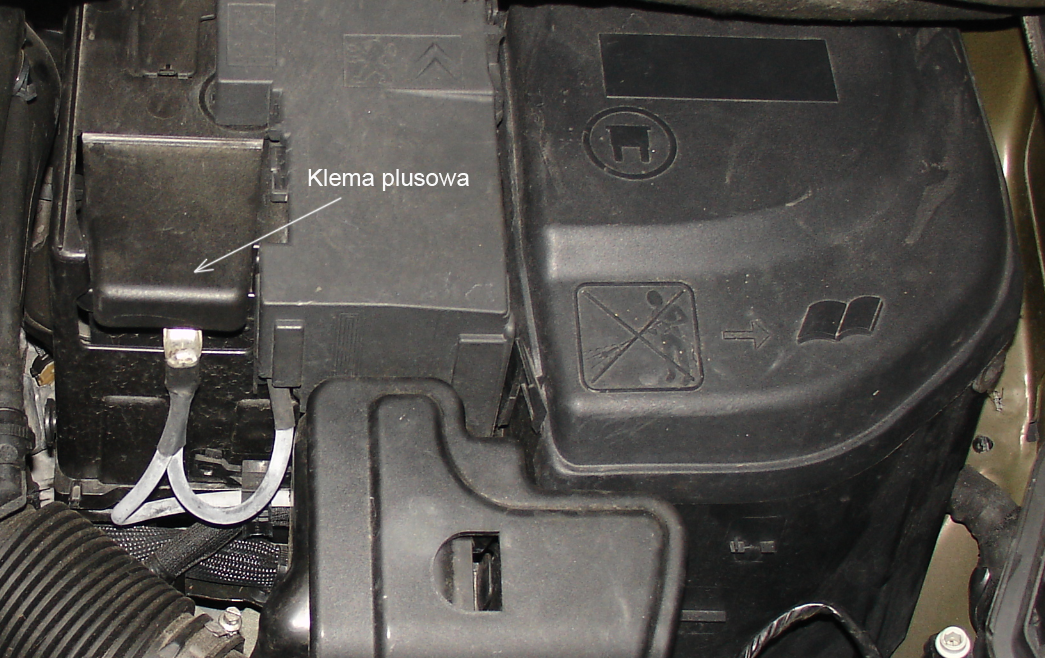

  • Using meter leads instead of battery clamps
    #21 20173562
    kp.
    Posts: 197
    Rate: 17
    Hello, I know the old thread, but I have one related question.
    And is it possible to connect with a meter instead of an unfastened negative clamp and a positive one?
    I think so, but I'd rather ask.
    I am asking because in my car, I have not seen a negative clamp yet :) it is hidden somewhere in the back.
    I will probably see it when I have to replace the battery and then I will have to disassemble it all.
    However, from the shore, I only have access to the plus one.
    This is what it looks like:
  • #22 20173665
    SlawekKedra
    Posts: 16859
    Help: 1575
    Rate: 1962
    kp. wrote:
    And is it possible to connect with a meter instead of an unfastened negative clamp and a positive clamp?
    Yes, of course, you can use a plus point.
