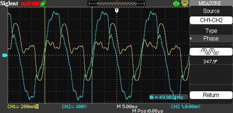

    Drill with speed controller:
    PF = 0.29
    ? = 348 ° (-12 °)
    P06S-20/100 panel power consumption / energy consumption meter - test
    As you can see from the above screenshots, this is not an ordinary cos ?, but it looks like a reasonably correctly calculated Power Factor.
