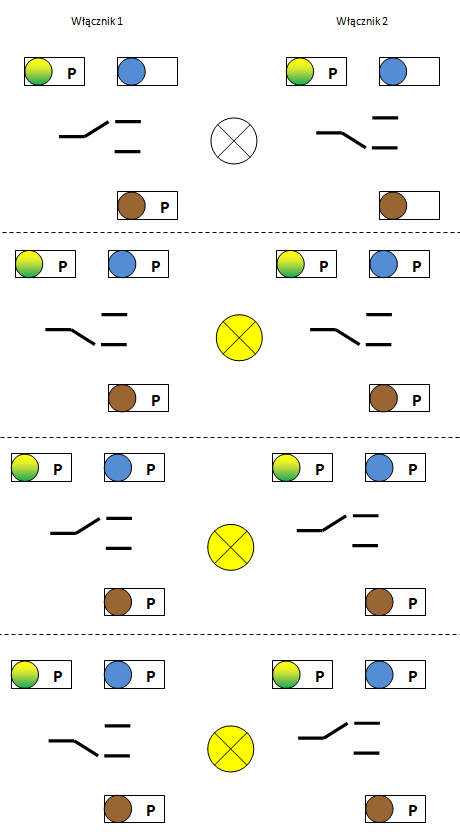

    I have a problem with the stair switch. Two stair switches in the corridor, one lamp (ordinary light bulb). After turning on the light with one switch, it cannot be turned off with the other (the bulb seems to tremble, but it is still on). The second switch, on the other hand, operates only with one setting of the first.
    Everything has been working fine so far, the problem appeared suddenly, overnight, there were no changes in the installation in the meantime, I did not disconnect anything for painting, etc.
    My first thought was to damage the switch, I bought a new one, replaced it (identical switches, wires connected the same) the problem is still there.

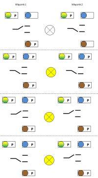

    Below I put all combinations of switches, the letter "P" marked which wires are live.
    Stair Switch Issue: One of Two In Corridor Not Turning Off Light Bulb - Sudden Malfunction

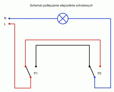

    From what I have read here on the forum, I already know that the wrong colors of the wires were used (this is how the installation was done) - but this is not the cause of the problem
    Probably the brown wire in the switch 1 is the main current wire (constantly live, the same contact is connected to the wire leading to other rooms).
    According to the diagrams that I found on the internet, the brown wire from switch No. 2 should lead directly to the lamp, but after it is completely disconnected, I can turn on the lamp with switch No. 1.
    A standard 3-color wire is connected to the lamp, when the light is on, the voltage is always on brown.
    I do not know if it matters, but in the box behind the switch No. 1 I have connected cubes:
    - 3 blue wires
    - 3 green-yellow wires
    - 2 brown wires
    What could be the cause of the problem, what should I check next?

  • #2 16419323
    Arturo2005
    Posts: 1892
    Help: 149
    Rate: 485
    * protective conductor not included

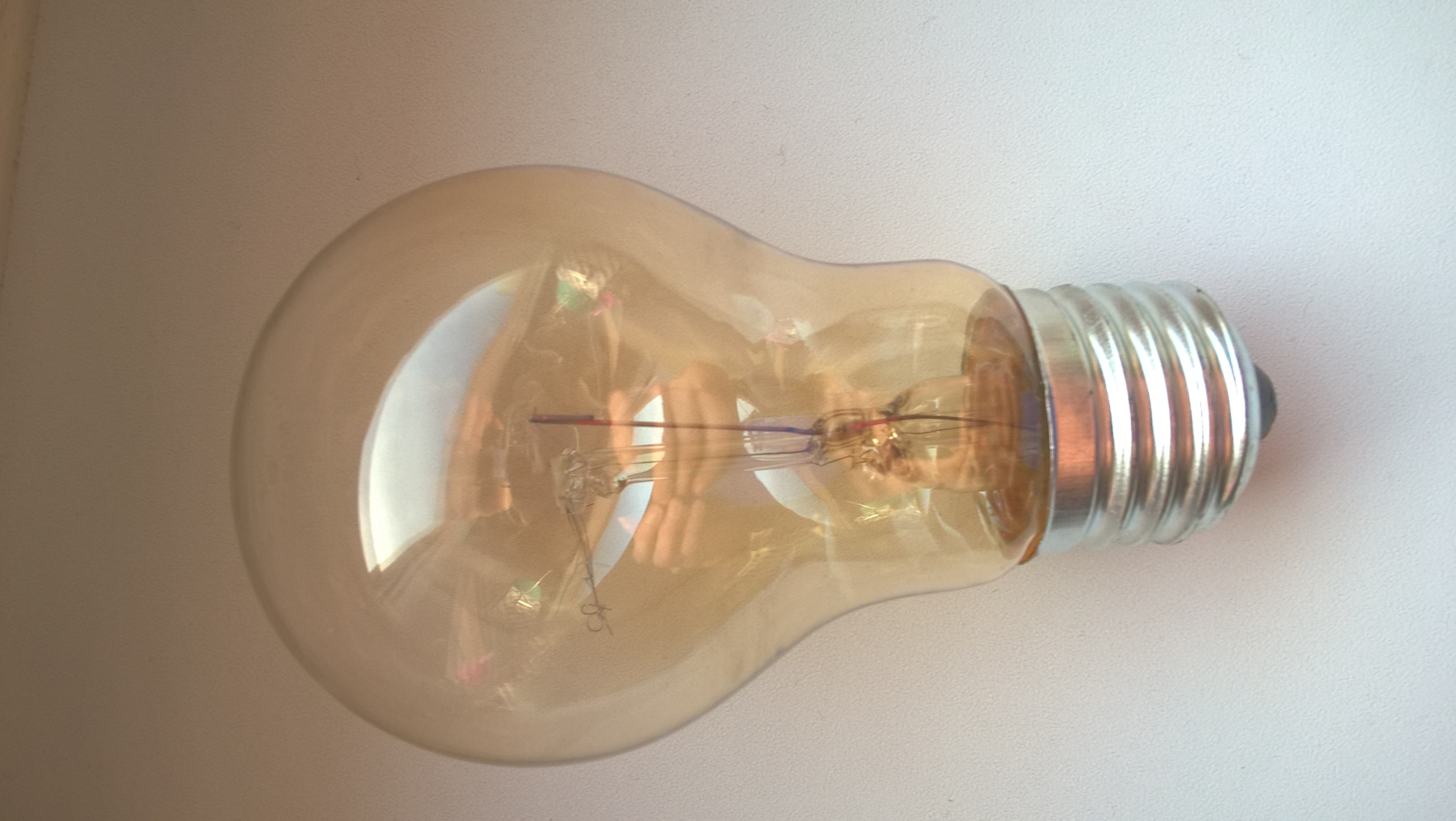

    mar_uda wrote:
    then add, please, a clear photo of this "ordinary" light bulb.

    The cable between the switches is obviously damaged. Probably a short between the blue and brown wires. If it was certain that this was the only damage, one could still be tempted to use a bistable relay, but it is not known whether any structural element is energized in this way.
    If there is still a can on the way - you can look there. If not, the damaged section will need to be replaced. Alternatively, you can be tempted to invite an electrician with the appropriate equipment who can try to locate the fault, but it will not be cheap.
  • #26 16453653
    marhir
    Posts: 7
    Rate: 8
    mar_uda wrote:
    it is not known whether any structural element is under voltage in this way
    following this lead, I checked everything metal in the corridor, the nail on which the photo was hanging turned out to be the culprit (hammered about two years ago)
    Thanks everyone for the tips.
