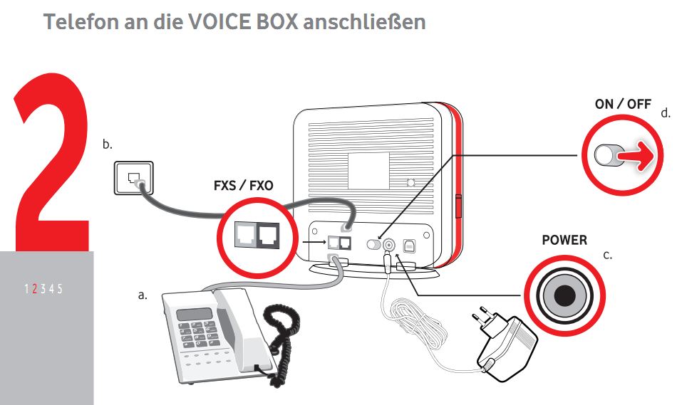

    b) you can use a GSM gate (e.g. Vodafone RL-500) into which you insert a SIM card and put the whole thing on or by the window.
    Affordable GSM Amplifier for Level -1 Living: Enhance 3G Network Coverage in Subterranean Spaces Affordable GSM Amplifier for Level -1 Living: Enhance 3G Network Coverage in Subterranean Spaces Affordable GSM Amplifier for Level -1 Living: Enhance 3G Network Coverage in Subterranean Spaces
    An external antenna will be connected to the gate, searching for the strongest signal.
    Any analog wired or wireless telephone can be connected to the gateway.
