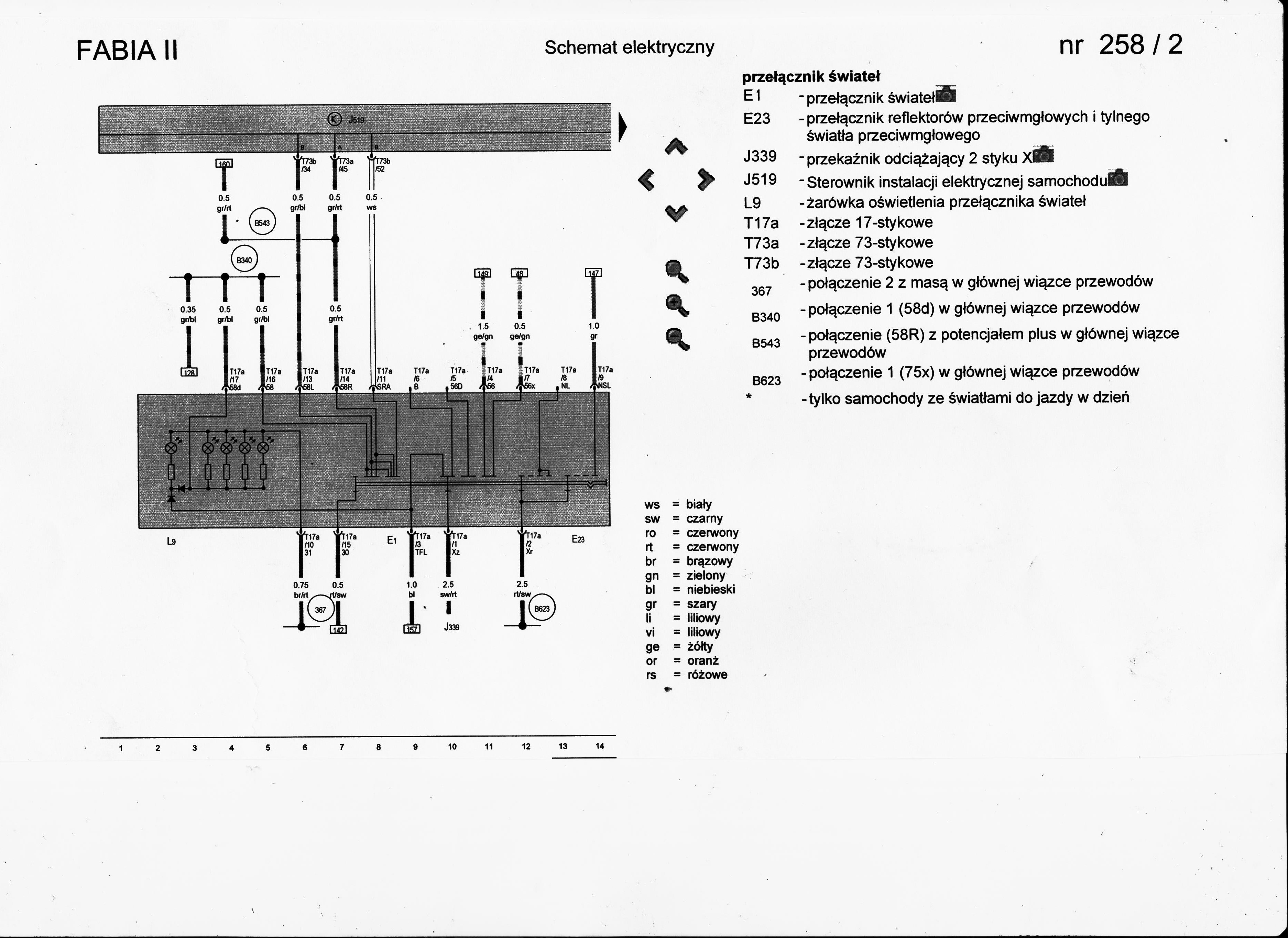

    In the car, as in the subject, the low beam does not work.
    https://www.elektroda.pl/rtvforum/topic2057046.html I haven't checked this issue yet, but I will do it right after returning home from work. Anyone else have any suggestions or advice? Thank you in advance for all your help
    Added after 7 [hours] 22 [minutes]:
    The voltage comes out of the switch, but there are no fuses. After feeding + 12V for a short time the fuse lights up. Is this not the fault of the combined switch?

    There the lights are switched on by the bordnetz module, the one under the steering wheel.

    So is it not that the control goes through a combination switch in the steering wheel ?? Because I don't have short long ones, the rest works including the lamp height control. I can only turn on this momentary glow of long.
    Added after 10 [hours] 31 [minutes]:
    I think the switch on the steering wheel will actually be damaged. There is voltage on the black and white wire after turning the light switch. However, there is no voltage on the yellow-green or white-green wire (as I give the voltage on these two wires, the lights are on).

    Jacek didn't understand me a bit. I mean if he understands well the fact that the white and black wire comes from the dipped beam switch and there is switching between yellow green and white green for short / long lights

    So it's not what I think. I need to check if I have power on the T41a / 39 red wire
    Added after 2 [hours] 31 [minutes]:
    there is voltage there, so a 99.9% switch. Crap expensive business, and the car year 2012

    The switch under the steering wheel changes the road supply without ignition from a permanent plus, e.g. to flash or after ignition from the light switch when the low beam is switched on. The low beam are powered directly from the switch, does the ignition on the low beam turn on power for pins 4 and 7 (yellow green)?

    from the dipped beam switch voltage goes to the black and white wire (pin4) lights high current circuit (I think so) and white (pin 11) after + 12V on this wire the indicator on the meter lights

    Do you have H4 headlights?

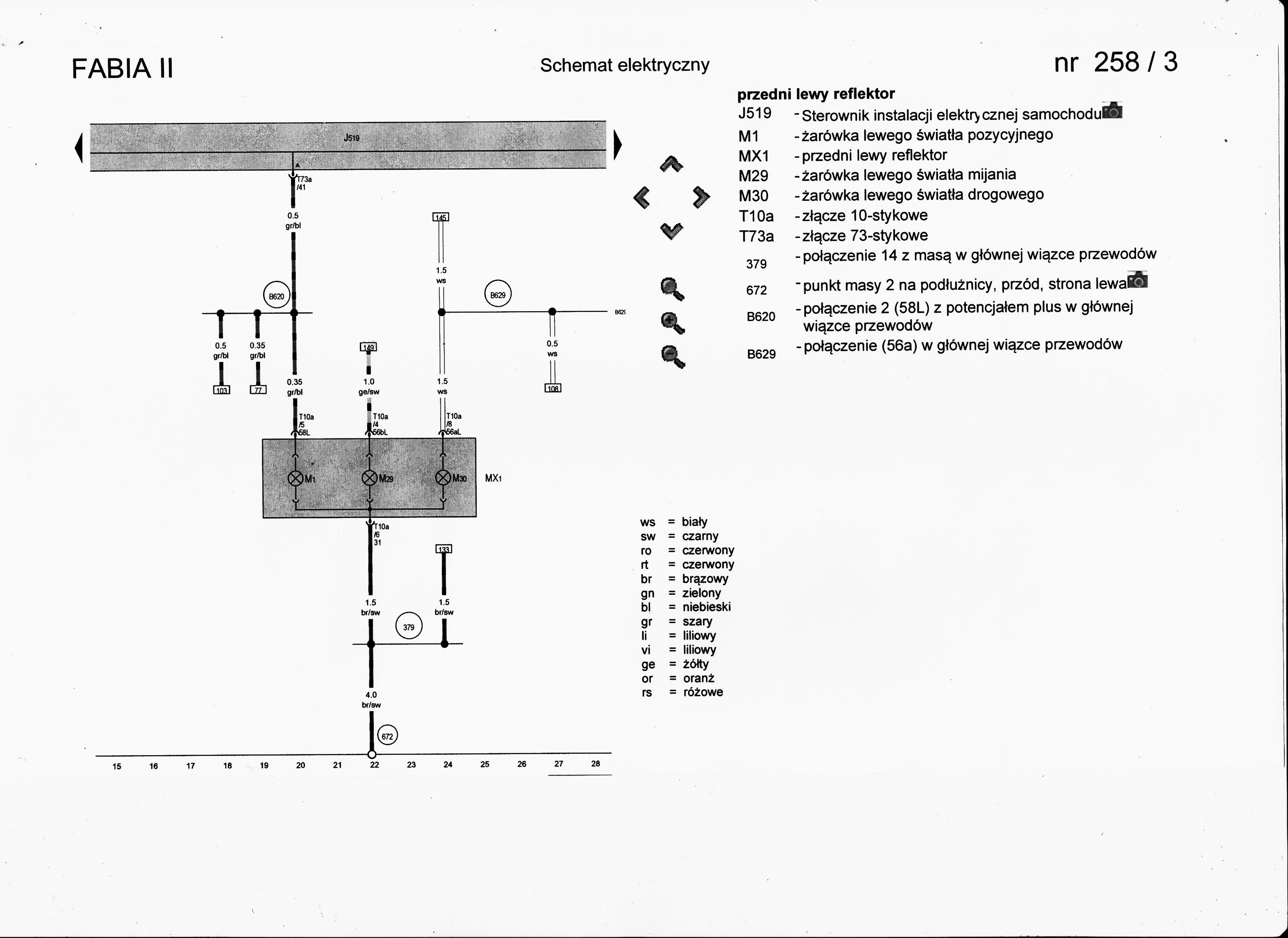

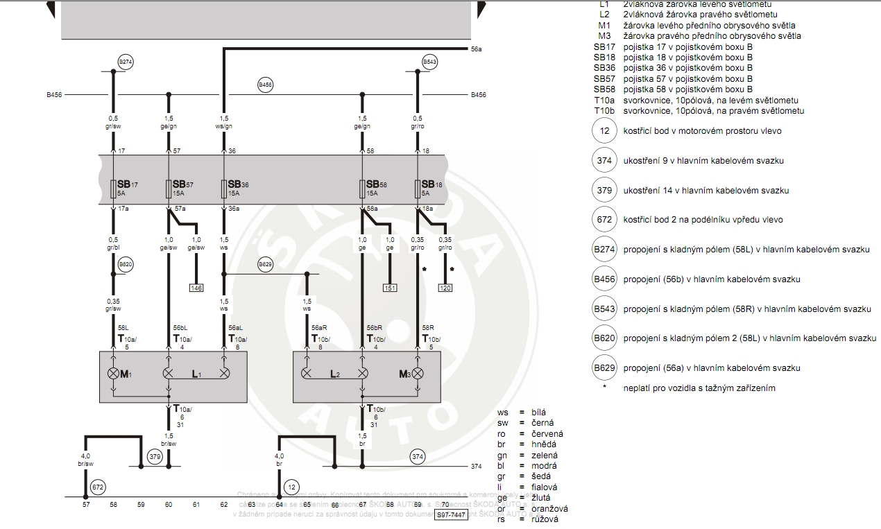

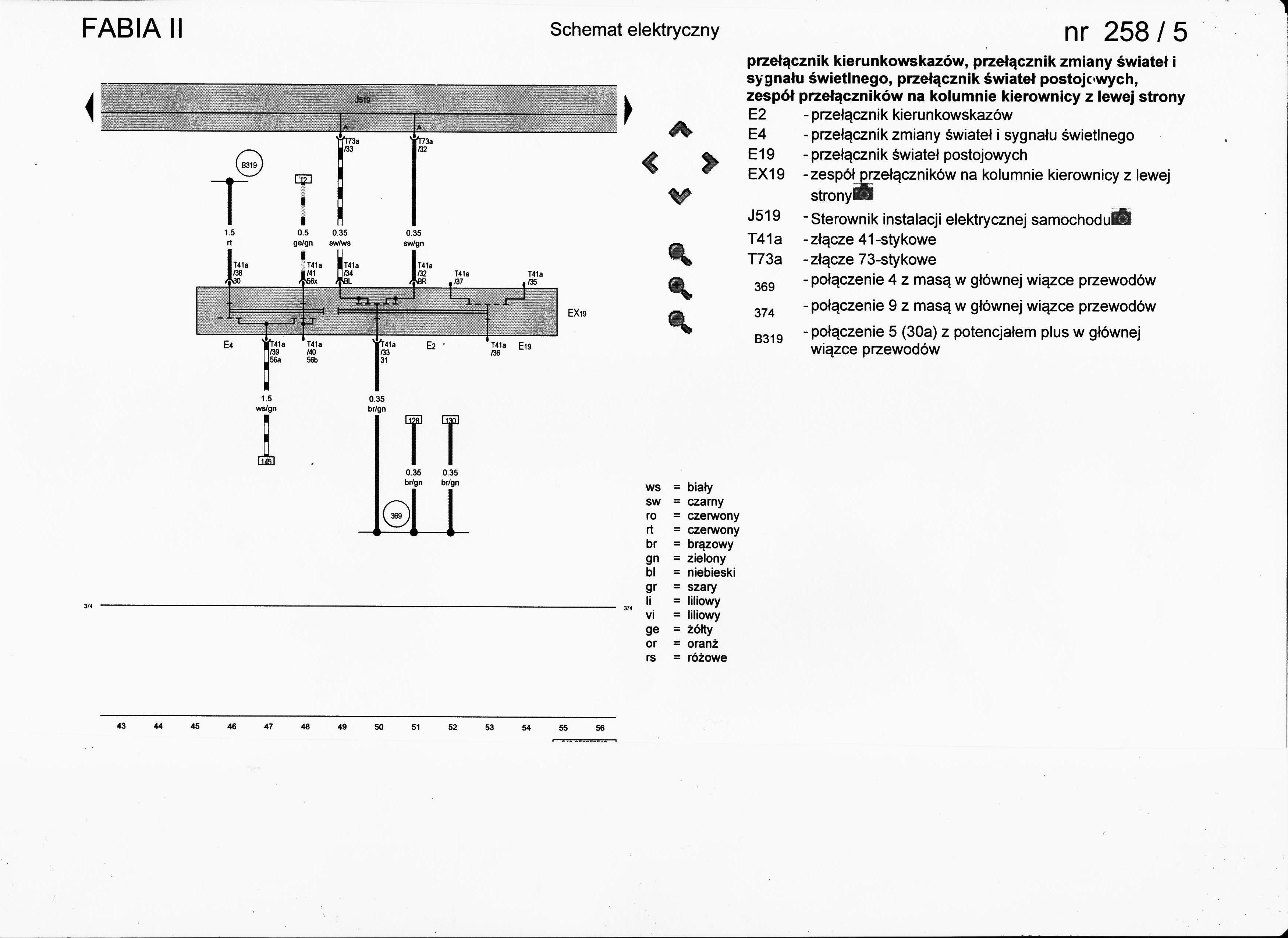

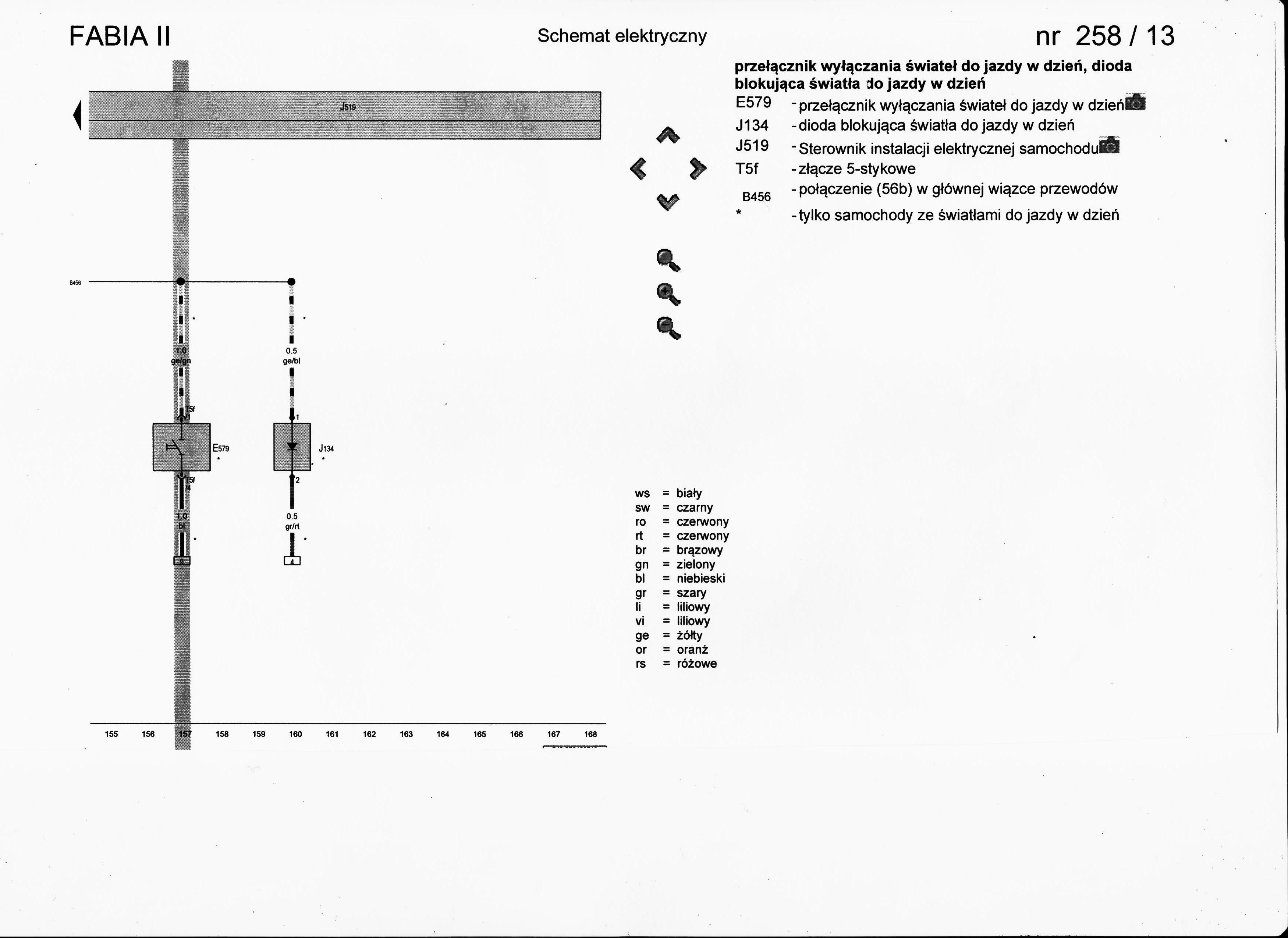

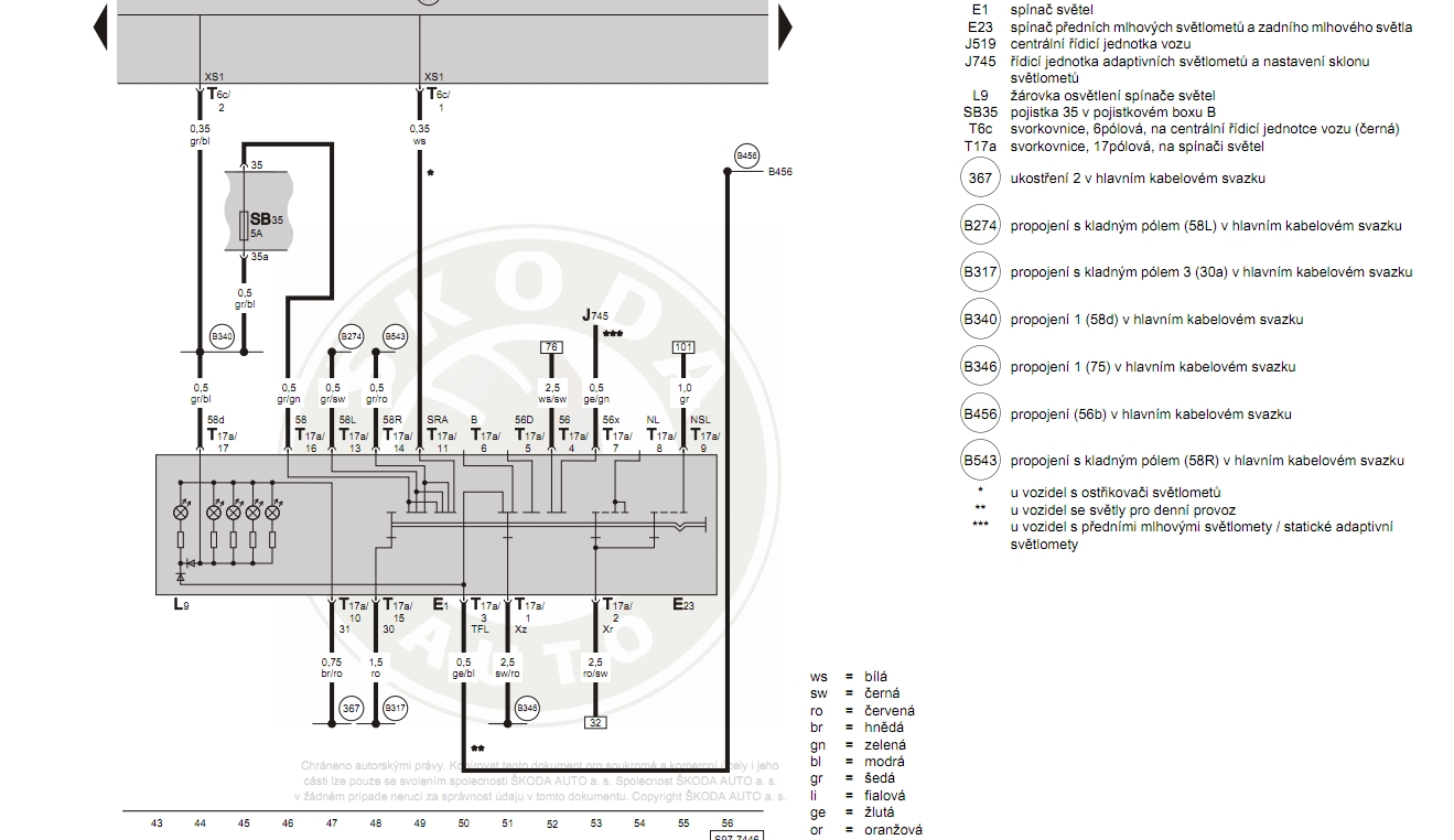

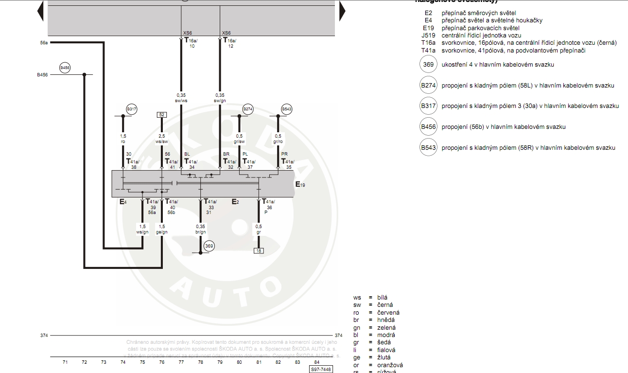

    Fabia II 2012: Low Beam Not Working - Could it be a Faulty Combined Switch? Fabia II 2012: Low Beam Not Working - Could it be a Faulty Combined Switch? Fabia II 2012: Low Beam Not Working - Could it be a Faulty Combined Switch?

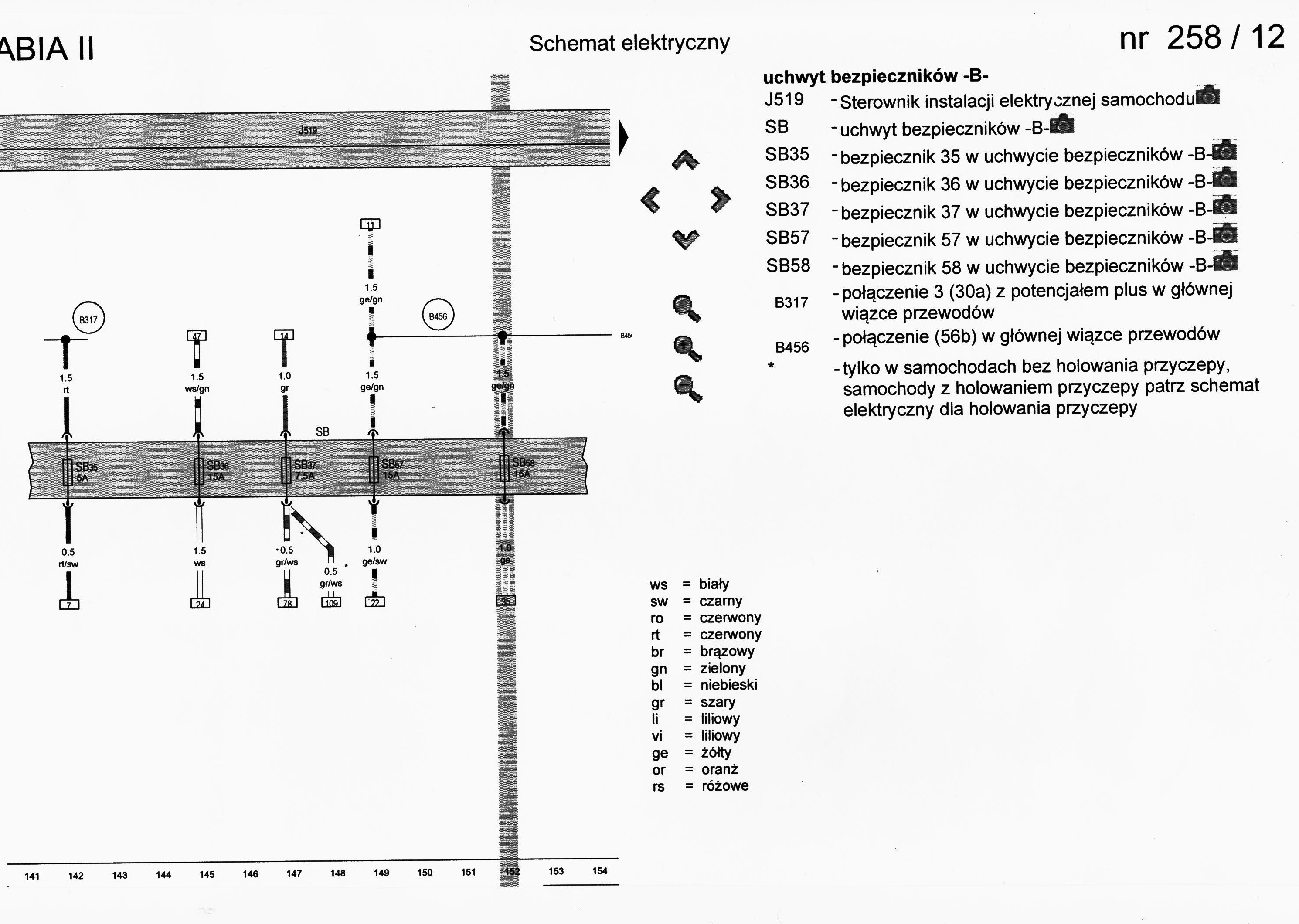

    Schemes Fabia II from April 2009

    I agree. There are tensions on red and white and black, and they don't go white green and yellow green.

    Turn on the lights, bridge the piece of wire on the steering wheel switch between white black and white green, then yellow green. You will skip the switch. The lamps will light, you already know what is broken. We will not light looking in the switch on the board. Although you wrote that you have voltage on black and white and checked with a meter, you can have a drop under load.

    Bridges I have already done everything is ok I will check white and black under load. I will temporarily put on the relay parallel to the combined switch with the connection after turning on the long one. I will leave it even after replacing the combined switch. The new one will be less burdened.
    Added after 14 [hours] 30 [minutes]:
    Problem solved, damaged combination switch on the steering wheel. I temporarily put on two relays. The first switches on the dipped headlights after turning them on using the switch, the second turns off the first relay when the long lights are turned on. Everything works as it should. The only drawback is the lack of constant long lights, only a short backlight works.

    1. Blown fuses - this is where the basis begins. Nos. 57 and 58 - right bottom in the box on the left side of the steering wheel.
