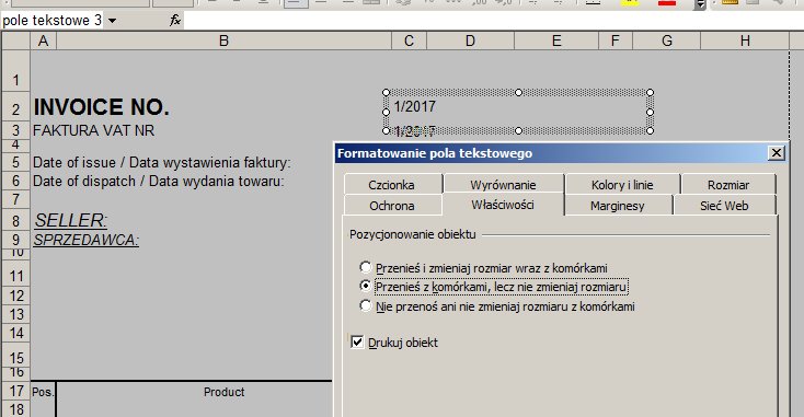

    I am a new VBA user and I have never programmed before, but I built an invoicing program for myself, before that someone helped me edit the code correctly, maybe this time someone will enlighten me for the future.
    I have an invoice file in which, when you click one of the buttons, windows pop up to complete subsequent sections of the invoice.
    Unfortunately, at some point I realized that when I use the code to enter data into a cell, e.g. Range ("C5"), the data will always be entered into cell C5, but in the case of invoices, - with more positions, the cells move, but my inputboxes and all the rest of the boxes still stick data "rigidly". I missed it in a clever way as you can see, but unfortunately it let me down because in addition to the patting of the textures.
    at the end, it copies all these data to the invoice database, and here's the problem, because ctrl + f will not find me things in the text fields
    here is my code:
    How can I make the data fall into cell C5, unless it moves down, then it has to enter the data, for example, to C6 or C15 there

    hmm ... The whole snag is that no data from the inputbox dialogs are typed into any cells, but into text fields.
    By adding a new row in the table with invoice items, for example: in the " currency PLN, ENG 0% "the only thing that can be 'moved' are the text fields below the table: ' REF ',' REQ ',' AFTER ',' General description 'i' VAT rates '
    [VBA, Excel] How to Dynamically Update Cell References in Invoice Program with InputBoxmysticmari...ls_002.jpg (45.7 kB)You must be logged in to download this attachment.
    To avoid 'certain unwanted behavior' of text fields, you can select the appropriate options in their properties:
    [VBA, Excel] How to Dynamically Update Cell References in Invoice Program with InputBoxmysticmari...ls_001.jpg (48.58 kB)You must be logged in to download this attachment.
    or
    play around controlling the position of these text boxes from within the code:
    Code: VBScript
    However, when it comes to 'code flexibility' in this particular case, the option to completely rewrite the forms should be considered, so that each entered data has its own cell or range in the worksheet. It is easier then to do anything than to move the text boxes point by point on the screen of the monitor with the macro code, because it is rather a tedious job ... :|
