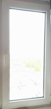

    Good morning
    The topic may seem simple, but I must admit that I have big problems coping with this problem. I moved into a new apartment and a PVC window howls at the desk. I turn on the sound. It goes crazy all day long. : /
    Of course, under the slogan window adjustment there are various movies and tutorials, but none leads directly to the issue of this squeak / howl, and an attempt to adjust the side clamps did not bring any result. I also tried to seal the window in accordance with online tips, but the same -
    nothing happened. I don't know where to start and what it means "you have to figure it out". I will be grateful for specific information. Where does it come from, what to do with it and how to proceed.
    I also add a picture of the window. How to adjust the "squeaking" / "howling" PVC windows? although I don't know if it will change anything, except that it is a standard PVC window.
    I write immediately - I do not have warranty for these windows, I do not have the option to force the owner of the exchange; I am not looking for alternative solutions in the style of knock / wall - I am interested in whether this problem can be solved, and if so, how.
    Thank you for the advice and best regards

    This sound from the file is extremely intense. Something must generate it. Is there, for example, an antenna dish hanging near the window and the blowing wind "rolling" through it, or the cables causing no sound? When the wind changes direction is it just as loud?

    #9 16443390
    leburaque
    Posts: 488
    Rate: 111
    OK, it will probably be funny, but ...
    I tried all possible options by adjusting element by element, moving them in different combinations and nothing. Then, using carpentry clamps, I tried to constrain various points of the window on the wardrobe and check which part of it may not adhere exactly - nothing. I was looking for small places where the wind could blow and move these tissues ... Then I tried different versions of seals and tapes - also nothing. And finally, on the advice of Waldemar from Kashubia, I began to look in other places. And you know what? I feel very stupid, but it turned out that the sound generates the clearance of leaky silicone below the window - in the place where the window connects with the door frame. I covered with adhesive tape and stopped whistling. : /
    I don't know what to say, stupid thing. If someone wants to add something, I invite you and tomorrow I close the topic as solved. :)

    leburaque wrote:
    that the sound generates the clearance of the leaky silicone below the window - where the window joins the door frame. I covered with adhesive tape and stopped whistling. : /
    So just a window wrong, poorly seated in the window opening, the window itself is not guilty, in a word, simply "partacka work" during assembly :| :D
