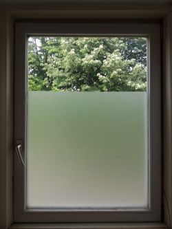

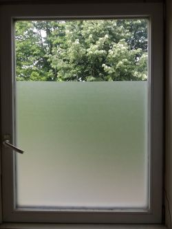

    I was struggling a bit with this window today. I pressed but nothing. I don't know if I messed up more, because the handle does not return to the vertical position now.
    I am uploading two photos of what this window looks like:
    Window not opening. The handle locks after turning 45 degrees. Window not opening. The handle locks after turning 45 degrees.
  • #7 18688066
    misiek1111
    Level 37  
    Posts: 4121
    Help: 325
    Rate: 1097
    You can also try to lift them up. It may have fallen off the hinges and is hooked.
  • #8 18691740
    saskia
    Posts: 5759
    Help: 174
    Rate: 1086
    Or painted on the outside and the paint glued them to the frame.
  • #9 18696090
    bmw5256
    Posts: 76
    I don't think I'm going to open that window myself, but never mind. The topic can be closed. However, the owner surprised me and sent a specialist who said that he would not open the windows and would install a new window for me. Unfortunately, he did not say what happened to the window, so I will not share this information. Thanks all for the advice.
  • #10 18696615
    balonika3
    Posts: 11103
    Help: 1336
    Rate: 3759
    Poor professional. Each window can be opened by removing the glass. After that, just fix the fitting.
  • #11 18696652
