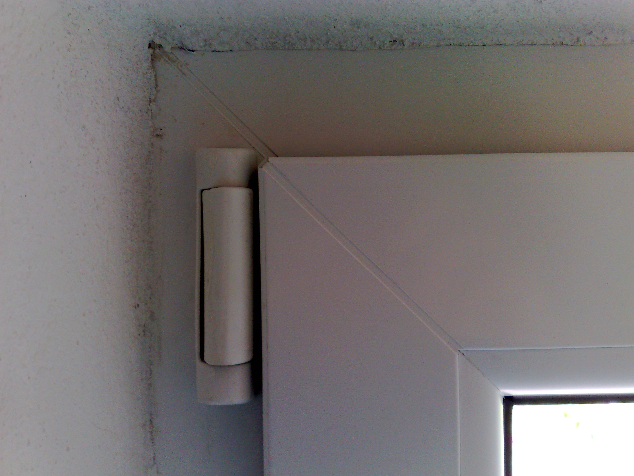

    Hello, I have a problem with a plastic double-leaf window with a movable mullion, the right sash is tilt and the left one can only be opened, the problem is that during a strong wind in the upper left corner of the sash hinge you can hear a slight whistle of the wind and feel the wind blowing. It looks like a small pressure on the upper left corner because the window can be slightly tilted when it is closed. I also have the same problem with a tilt and turn window, it blows in the upper left corner, when the window is closed, you can also slightly tilt the upper left corner of the window. Nothing is blowing in the other windows and there is a strong pressure on the entire window. Can you tell me how to increase the pressure of this place and is it possible? The window is 7 months old, I will try to take and send photos soon.
    Here I present photos, unfortunately I could not achieve better quality.
    The left sash of the swing window, in this corner you can pull the window a little, at this point at the hinge it blows and there is a whistle of the wind
    Plastic Double-Leaf Window (Movable Mullion): Wind Whistling & Blowing at Hinge, Upper Left Corner
    here I present two pictures of the same window only open
    Plastic Double-Leaf Window (Movable Mullion): Wind Whistling & Blowing at Hinge, Upper Left Corner Plastic Double-Leaf Window (Movable Mullion): Wind Whistling & Blowing at Hinge, Upper Left Corner
    Here I present a photo of the second tilt and turn window in which also slightly blows at the hinge and there is a small pressure on the upper left corner.

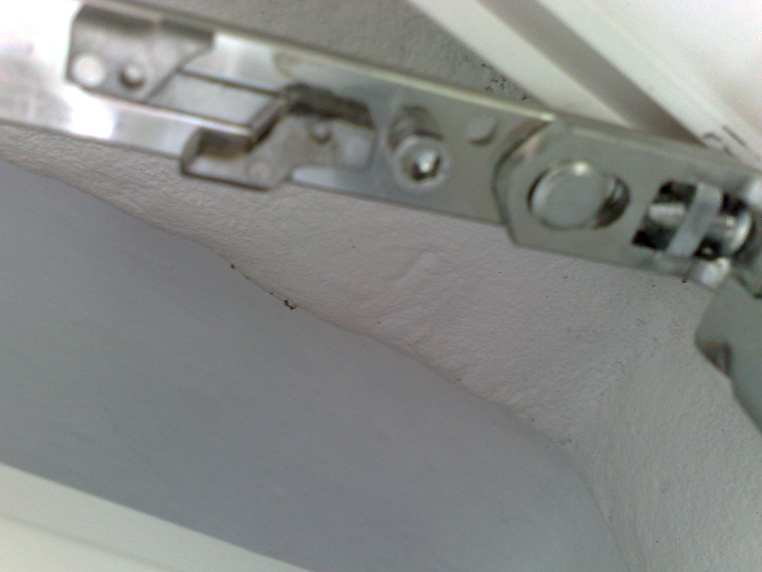

    In the turn-only sash there is an adjustment of the pressure from the top of the hinge. Give a picture of this hinge (from the second picture) from above. In the tilt and turn sash, the adjustment is most likely from the bottom of the arm. Give a photo of that arm (last picture) just from the bottom.
    Alternatively, it can be adjusted from the side - you need a photo from the side (third picture) - from the right.

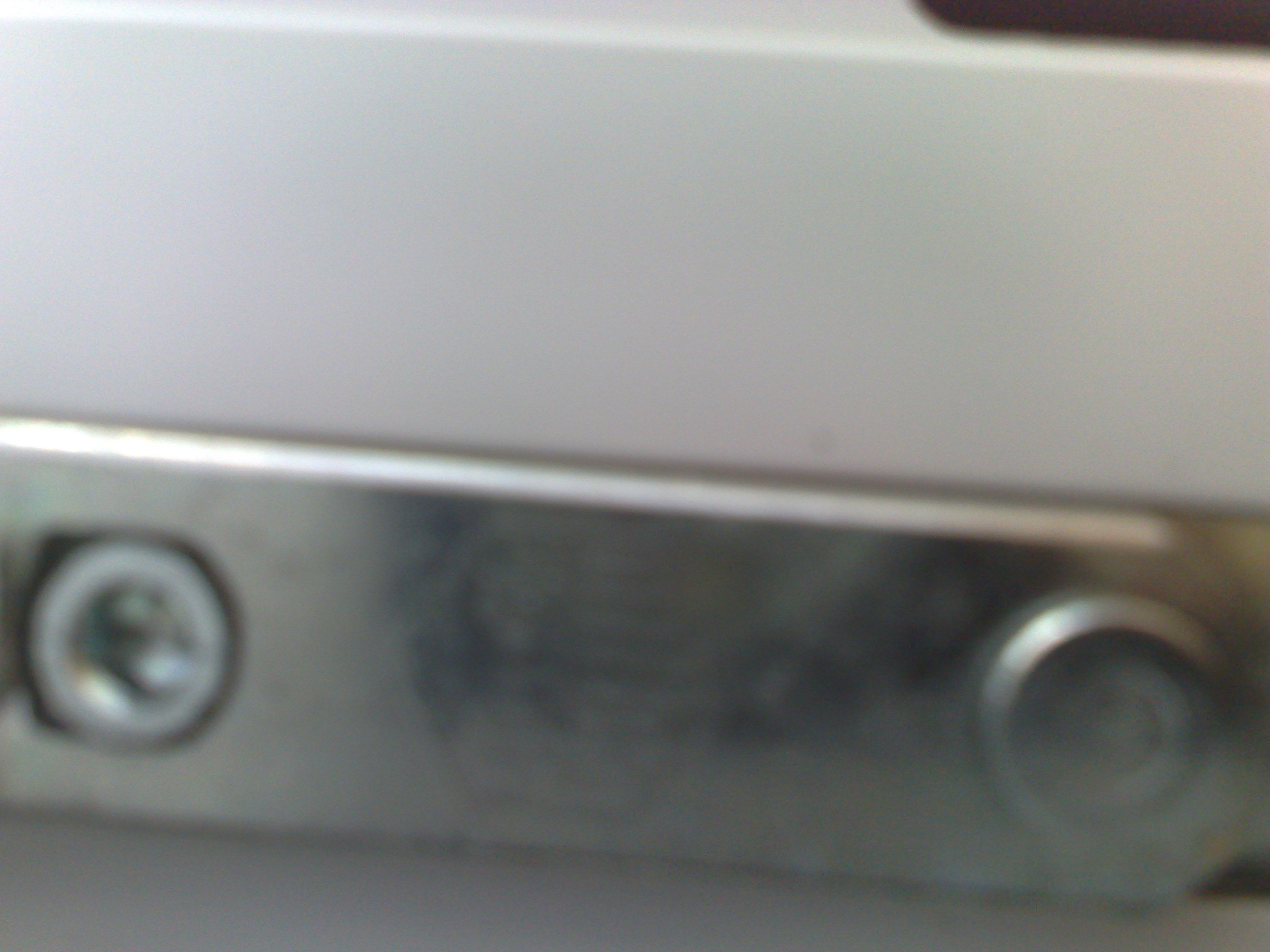

    Please, this is a photo from the top of the second picture, there is only one screw that can be seen in the photo, sorry for the quality, but unfortunately such a camera in the phone, but you can see something there
    here is a photo to the last picture from the bottom in a Tilt & Turn sash
    photo from the side, third picture (unfortunately it is difficult to take a picture because there is little space and unfortunately blurred)
    Plastic Double-Leaf Window (Movable Mullion): Wind Whistling & Blowing at Hinge, Upper Left Corner this screw looks identical to this one Plastic Double-Leaf Window (Movable Mullion): Wind Whistling & Blowing at Hinge, Upper Left Corner
    I will also use files sent by alekt77

    But nothing explained. The pressure adjustment can be seen in the photos in post no. 6. In the first photo, the roller on the left, on the second it is probably the one in the middle (it is hard to see). These rollers are eccentrics. They should be turned (hexagonal or torx) so that the hinge presses more firmly against the seal. Under no circumstances twist the lock from the third photo, because the wing may fall!

    I wrote that they are eccentrics, so what do you want to screw?
