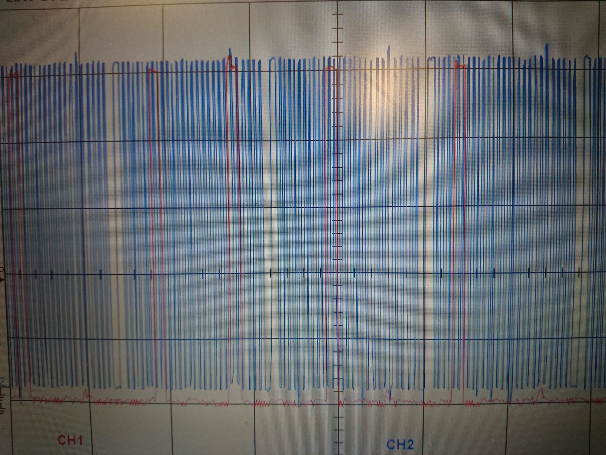

    Hello all. Good day. I have a problem locating the fault in the Passat b5 1.9 BLS. The problem concerns the camshaft sensor g40 sensor error. The customer came to me after exchanging a set. clutch and after a week said that the car started to burn heavily. Actually, you have to shoot about 3s. There is a constant error 00833 G40 impulsable signal (writes from memory). So I changed the sensor g40 and nothing, I replaced the sealer with a pulse ring behind the two-legged and nothing, raised starting doses on the map (KESS, WINOLS) and nothing. From the observation I can see that the VCDS in the engine in group 4 and in the 4th window shows 0.0, regardless of how I change the timing wheel. The client tells me that the problem was observed when he tried to fire once and when he was filming he heard a strong thunder, a thump and apparently from then on he smokes heavily. I attach still a photo from the oscilloscope of both shaft and shaft sensors and please confirm whether you can not see the synchronization and answer the question if it is possible that the pulley on the timing side is moved (no wedge) can cause such an error. I will add that the timing setting has been checked and is ok. VW Passat b5 1.9 BLS: Camshaft Sensor G40 Error, Heavy Smoke, 00833 Code - Clutch Replacement VW Passat b5 1.9 BLS: Camshaft Sensor G40 Error, Heavy Smoke, 00833 Code - Clutch Replacement

    There is no signal from the shaft sensor, if it was out of range, you would not start it at all.

    And the red impulses on the oscilloscope? It's just the shaft sensor, I even put a new beam from the sensor to the controller.

    Maybe the driver itself does not see the signal.

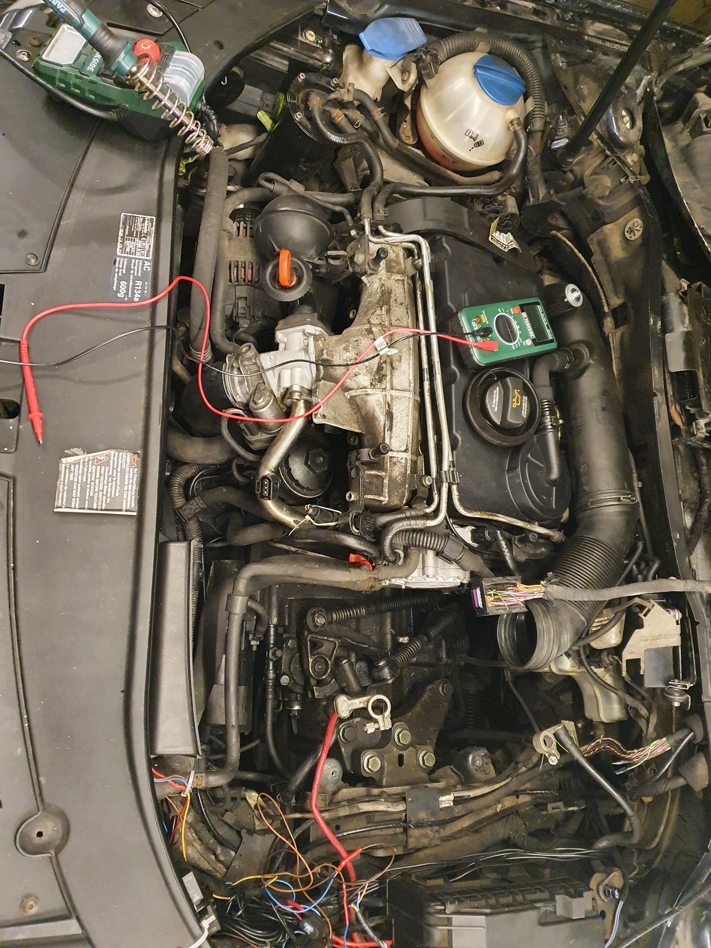

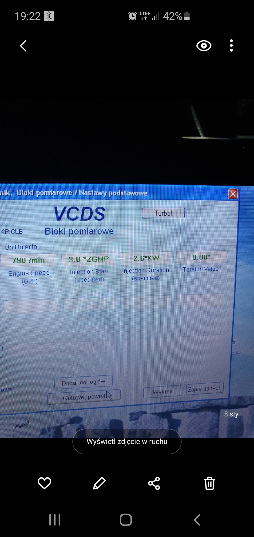

    I have the same problem but in the B6 2.0 TDI BKP passat
    VcDS The problem is that in the engine 01, group 051 shows in position 2 the value of the camshaft sensor (g40) and they are the same as the shaft (g28), the car fires hard on warm.
    Sensor replaced, beam checked with a multimeter for a break from the sensor to the controller - everything ok.
    Have any ideas ???
    Sync angle to 0.

    In this case, gentlemen, plug in the oscilloscope and check the actual mileage from the shaft and camshaft sensor, compare it with the waveform library, e.g. (...) I will not mention the name of the company for obvious reasons, do not follow VCDS. These problems appear, for example, after replacing the timing, a badly seated sensor.
  • #20 19168891
    chymek1234
    Posts: 106
    Rate: 33
    Write to me on priv with what should I compare it. Tomorrow I will check the seating of the camshaft sensor. Thank you . I'll let you know tomorrow.

    In the cold, the camshaft synchronization is 0.35 and in the warm one 0.0.
    I have nothing to do with eprom
    I will add that the car muli up to 2,000 revolutions then it's ok.
    This is also why I lean on the camshaft

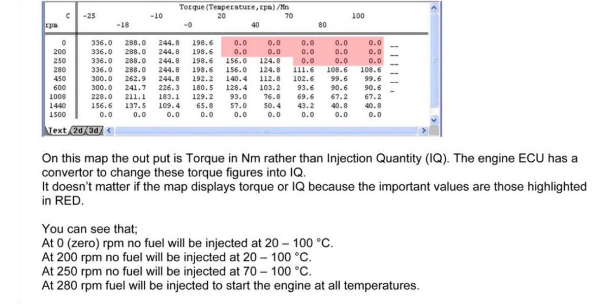

    hello ... I think the problem is stereotypical and it's called hotStart and it's not about the size of the doses but the threshold (turnover) of their occurrence, you have to read the flash, not the eeprom. For example, Mpps is diabolically without a problem, but it seems to me that the last update will also solve the problem, because apparently Volkswagen made a patch for it ... apparently

    Changing the dose is not a solution to the problem but a workaround. The cause of the problem is unknown.

    yes, it is impossible to disagree, but to paraphrase a classic of recent times is an alternative fact
    By studying the moza temperature map you will find out that VW Passat b5 1.9 BLS: Camshaft Sensor G40 Error, Heavy Smoke, 00833 Code - Clutch Replacement
    fuel injection starts from 200 rpm at 20 degrees C, but at 70 from 250 rpm
    up to 20 degrees injection in full range and the magic of hotstart is that the engine (read starter) due to its condition is not able to reach 250 rpm after reaching 70 and more
    This may serve as a clue when looking for an answer to the bug

    So you can check if the hot engine starts easily with disconnected temperature sensor, or with a 3 k? resistor inserted, which corresponds to a temperature of approx. 20 °.

    Today I replaced 3 wires from the sensor to the engine controller. Unfortunately, to no avail: / it still does not show the value of the rotational camshaft sensor :(
