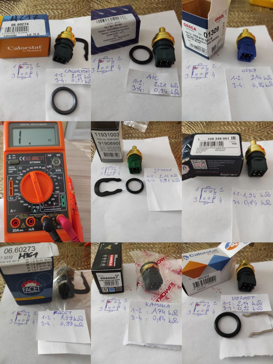

    For how long has the coolant temperature indicator been showing a lower temperature. After replacing with another temperature indicator it showed correctly, however, there were problems with firing at temperatures close to zero. I have already bought the fourth sensor and it is the same for everyone. I bought the original VW, Febi, one I brought from Germany and the same on each. In addition, when the engine is warm, it tugs especially at a speed of about 2,000. or lower. Does not show any errors on Vag, cables, and candles replaced. I will mention that the car has a gas installation for which the same happens regardless of whether I switch to gasoline or gas.

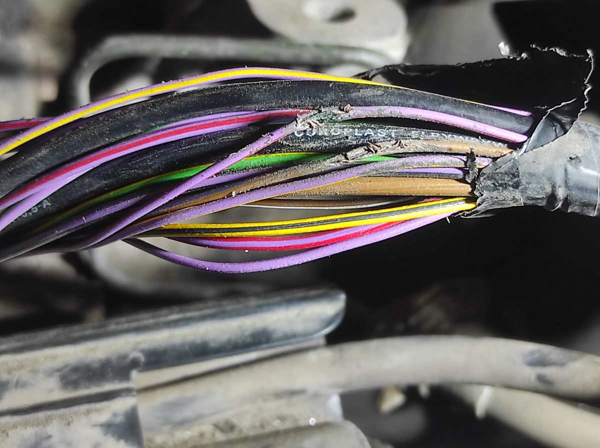

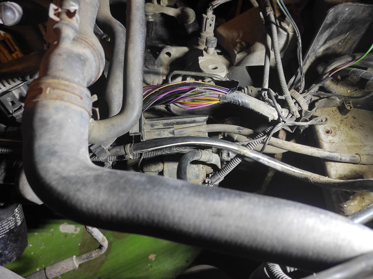

    #16 21628233
    mariuszka-72
    Posts: 18
    >>16432716 In my case, two wires in the harness that goes over the starter were damaged. One of them definitely went to the temperature sensor (the brown one with the blue stripe). The other damaged one was the purple one with the red stripe. They ran right next to each other and there was definitely a 'transition' between them. I took the opportunity to purchase a couple of sensors to compare them, and measured them with an ohmmeter. The parameters were similar. Different equipment. Prices from around PLN10 to PLN30. I attach photos of the damaged wires and photos of the measurements.
    Measuring various coolant temperature sensors with ohmmeter and resistance notes .
    Damaged wiring harness above the starter in a car engine bay .
    Damaged wire bundle above starter motor in engine bay .
    Close-up of damaged wire harness with frayed insulation on multiple colored cables .
