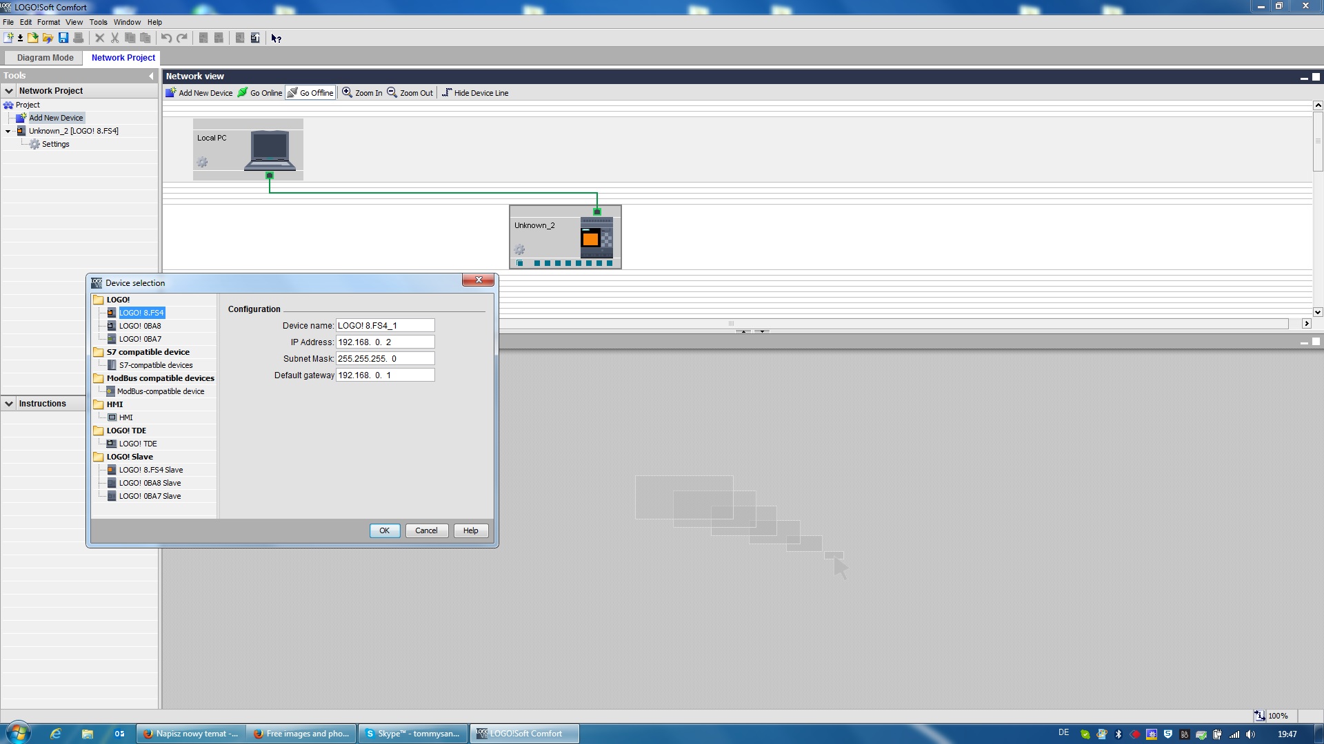

    I inherited a machine from a colleague to program on the unfortunate Logo! 8, Logo Soft Comfort 8.1 software
    Adding DM 16 24R Expansion Module to Logo! 8 in Logo Soft Comfort 8.1 Software: Step-by-Step Guide
    I cannot or do not know how to add (so far I have only used stepa7 and TIA) the DM 16 24R expansion module. As you can see in the picture, the module is in the foot.
    Below is a screen with the soft comfort logo. As you can see, after clicking Add device, I cannot add DI, DO modules. I do not know if there should be any CD with libraries to be uploaded to the modules, although I do not have any CDs, or maybe you can download a library of external modules from the net.

  • #2 16434144
    arek.m
    Level 22  
    Posts: 322
    Help: 62
    Rate: 66
    It seems to me that the modules are not connected with each other, there are shifts with an arrow on the top of the modules, you need to move them to the left, you need to check if the plugs are removed from the sides of the modules.
    Nothing is added in the program, only exits and entries count.

  • #4 16440923
    Popak
    Moderator on vacation ...
    Posts: 2762
    Help: 97
    Rate: 270
    @Schnapsik This problem can also be solved :)
    But I don't know if it makes sense. You just add one more logo and connect them to the master and slave and then the maser controls the slave and this one outputs :)
    I used to do this when the logo entered7.
  • #5 16440930
    kracek2
    Posts: 136
    Help: 6
    Rate: 14
    LOGO 8 supports 20 digital outputs and 24 inputs (as a single relay)
    These gray pins need to be pushed to the left.
    Each new program in Logo Soft Comfort has the maximum I / O and analog configuration at its disposal. This is selected from the tab after selecting an input or an output
  • #6 16441350
    Schnapsik
    Posts: 31

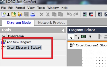

    Exactly as kracek2 writes. The gray sliders were not moved, too many modules were attached.
    Popak, I saw that movie. We did without it, but I am puzzled by one thing. Can I upload both cards to the PLC by creating part of the program as Diagram1 and then the second part of the control on Diagram2? Will there be blocks from two diagrams in the PLC then?

  • #7 16442069
    kracek2
    Posts: 136
    Help: 6
    Rate: 14
    Diagram1 is a program for one LOGO
    Diagram2 is for the second.
    This is used if they are networked and you can easily switch between programs
