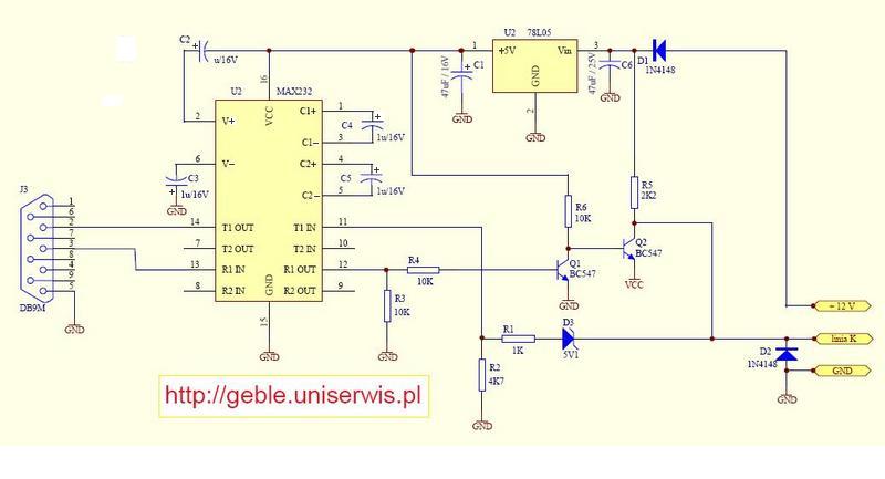

    Diagram of a working interface under RS232:
    Interface Diagram for BRC Sequent 24 LPG Installation: Programmer Guide & Assistance
    The diagram has an error - the emitter of the transistor Q2 should be connected to the ground, not to the power supply.
    The circuit is checked, it connects. I have additionally inserted optical transmission signaling in the form of a double LED.
    It cost me PLN 4 (MAX 232 price), and the execution time was 2-3 hours. Interface Diagram for BRC Sequent 24 LPG Installation: Programmer Guide & Assistance
    • Interface Diagram for BRC Sequent 24 LPG Installation: Programmer Guide & Assistance BRC 24.jpg (34.05 KB) You must be logged in to download this attachment.

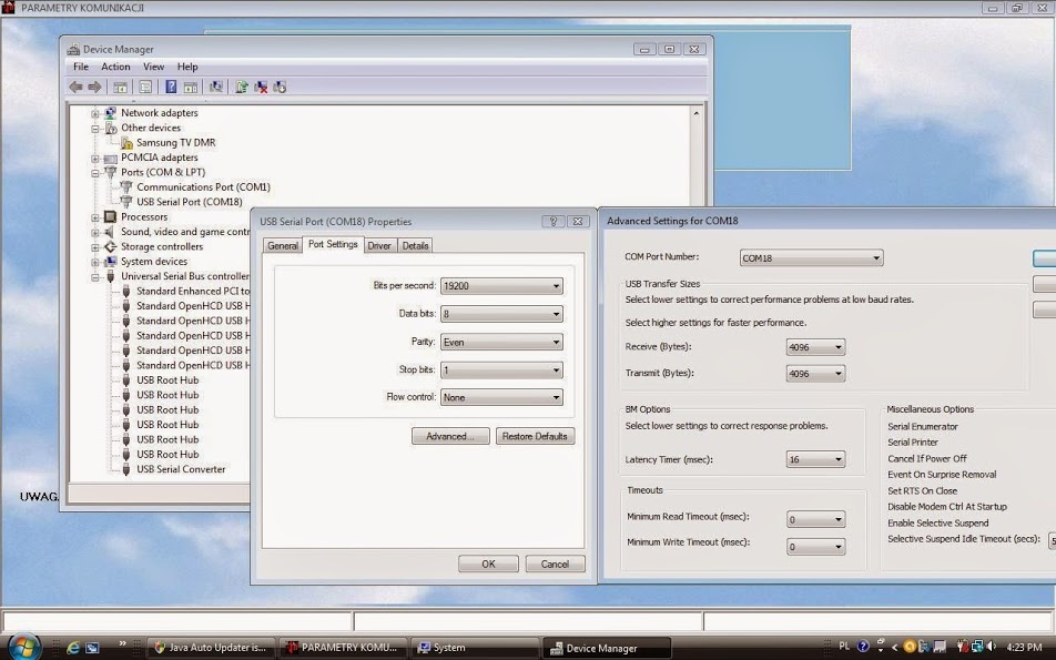

    #11 14364004
    lutek34
    Posts: 153
    Rate: 47

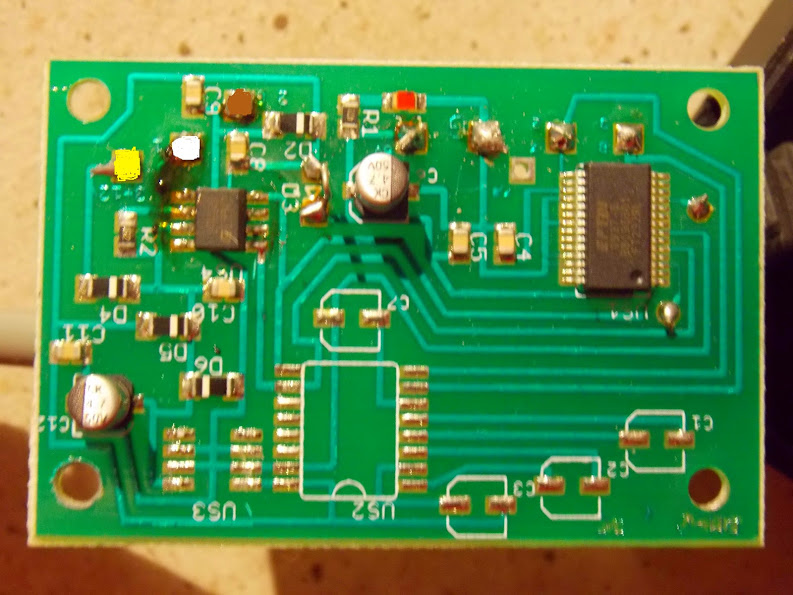

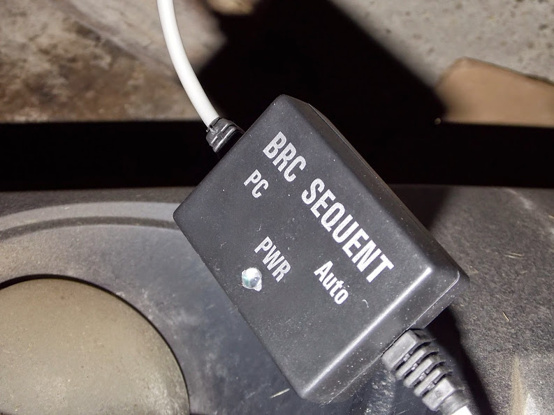

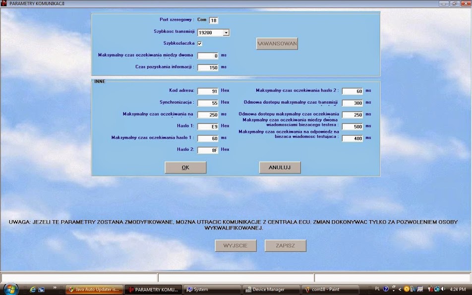

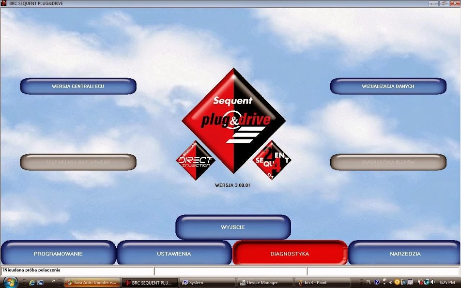

    Gentlemen, I bought a used BRC Sequent interface on OLX, which is supposed to work with BRC P&D that I have installed in my car. first I updated the FTDI drivers from 2.8 to 2.12. After connecting the interface to the PC in the manager, the USB Serial Port (COM18) appears in the ports, i.e. in the P&D program in the Tools / Communication tab, COM 18 should be set?
    So I did, set different speeds in the P&D program with no luck. In the COM18 port settings, I also changed the speeds and still no communication.
    Maybe someone from the screenshots below will find what is wrong with me, that I can't connect.

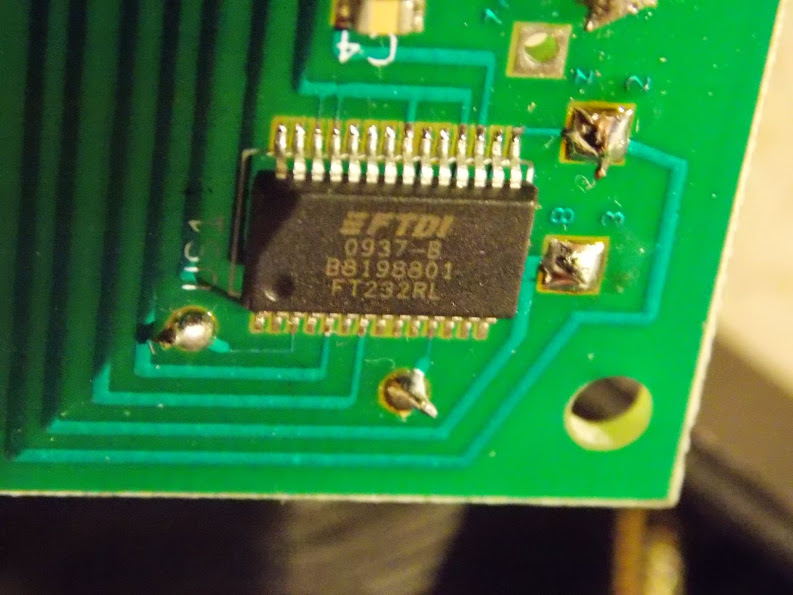

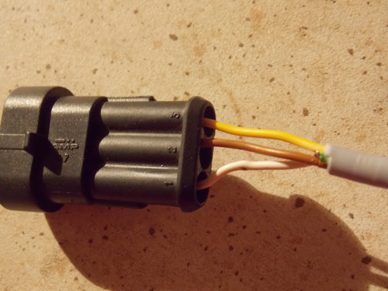

    Now the interface itself lights up red after connecting to the PC. This is what it looks like inside, can any of you say whether the wires to the switchboard plug are soldered in the right order?

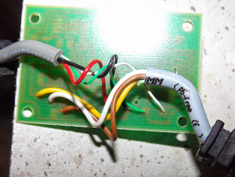

    In the photo below I have marked what color of the wires is soldered to a given place on the board and the colors in the plug.
    Is the whole contraption at all composed of the appropriate components?

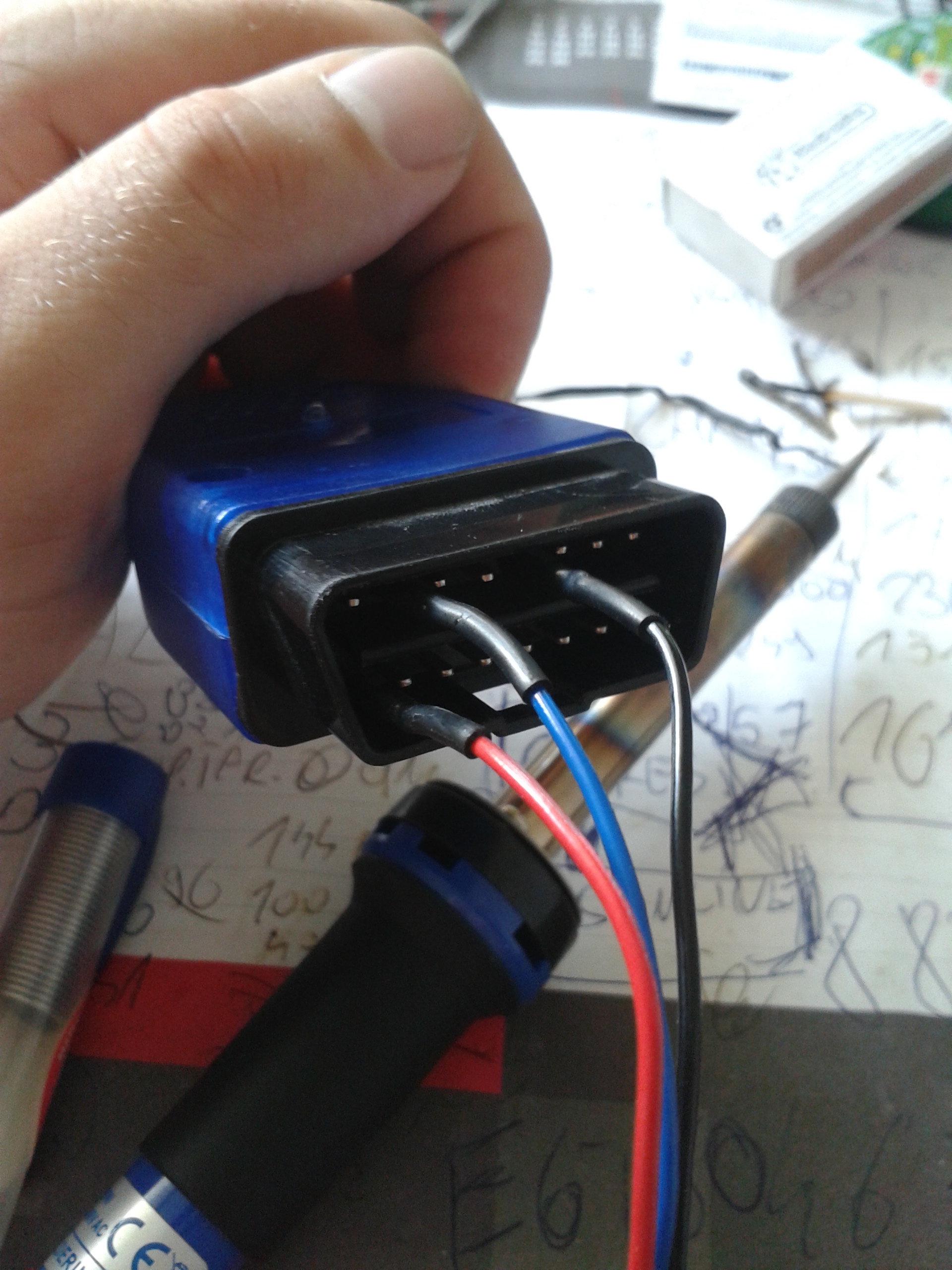

    There's a way with a vag cable
    red power, black ground, blue line k
    and how to do vag cable already on the forum :)

    #20 15176720
    djr2
    Posts: 68
    Rate: 22
    yes (I do not remember if the drivers had to be changed, but I think they were the ones that Windows update downloaded), I tested how I changed the control unit (if you need to check something, you do not need to buy a cable), but anyway, I recommend buying a dedicated interface, they are not expensive (it comes about the length of the cable and USB power supply, when it comes to sharpen the map, a non-combined cable causes less problems)

    Buddy djr2, which pins in the OBD plug do you connect the power supply and signal to?
  • #23 15179324
    bubu1769
    Posts: 8063
    Help: 1177
    Rate: 2374
    4.5: mass, 16: + 12v, 7: linia k.
  • #24 15182810
    grunz
    Posts: 417
    Rate: 82
    I did as described above and it works ;-)
    So if someone has an OBD diagnostic cable, it can be used for BRC Sequent24 :-)
