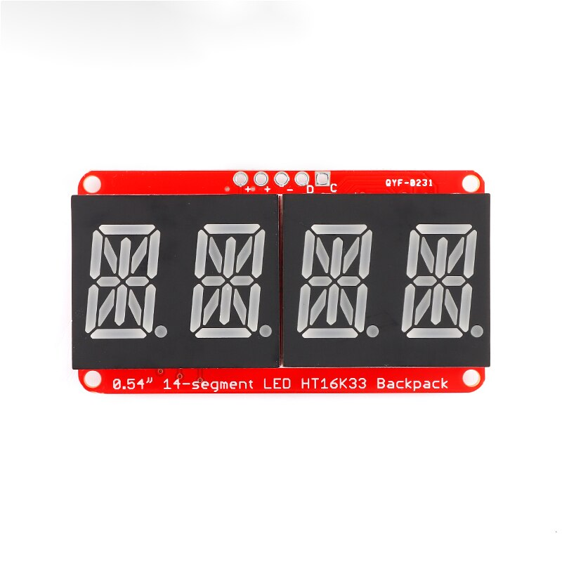

    I will present here an interesting LED display controller module that supports 16 segments and 8 characters via the I2C interface. Here I will discuss its communication protocol, demonstrate its implementation and also show how to run it with Arduino. The display discussed here will in my opinion be better than the previously shown TM1637, because it supports addressing multiple devices on one I2C bus, which was not possible in the case of the TM1637 with their strange I2C-style protocol.
    At the beginning, it is worth linking the topic about TM1637:
    7-segment displays on TM1637 - 4 and 6 digits - Arduino, protocol
    Here I would like to point out that the topic was created in cooperation with my tester, @DeDaMrAz, I do not physically have the module myself and all photos come from my tester.

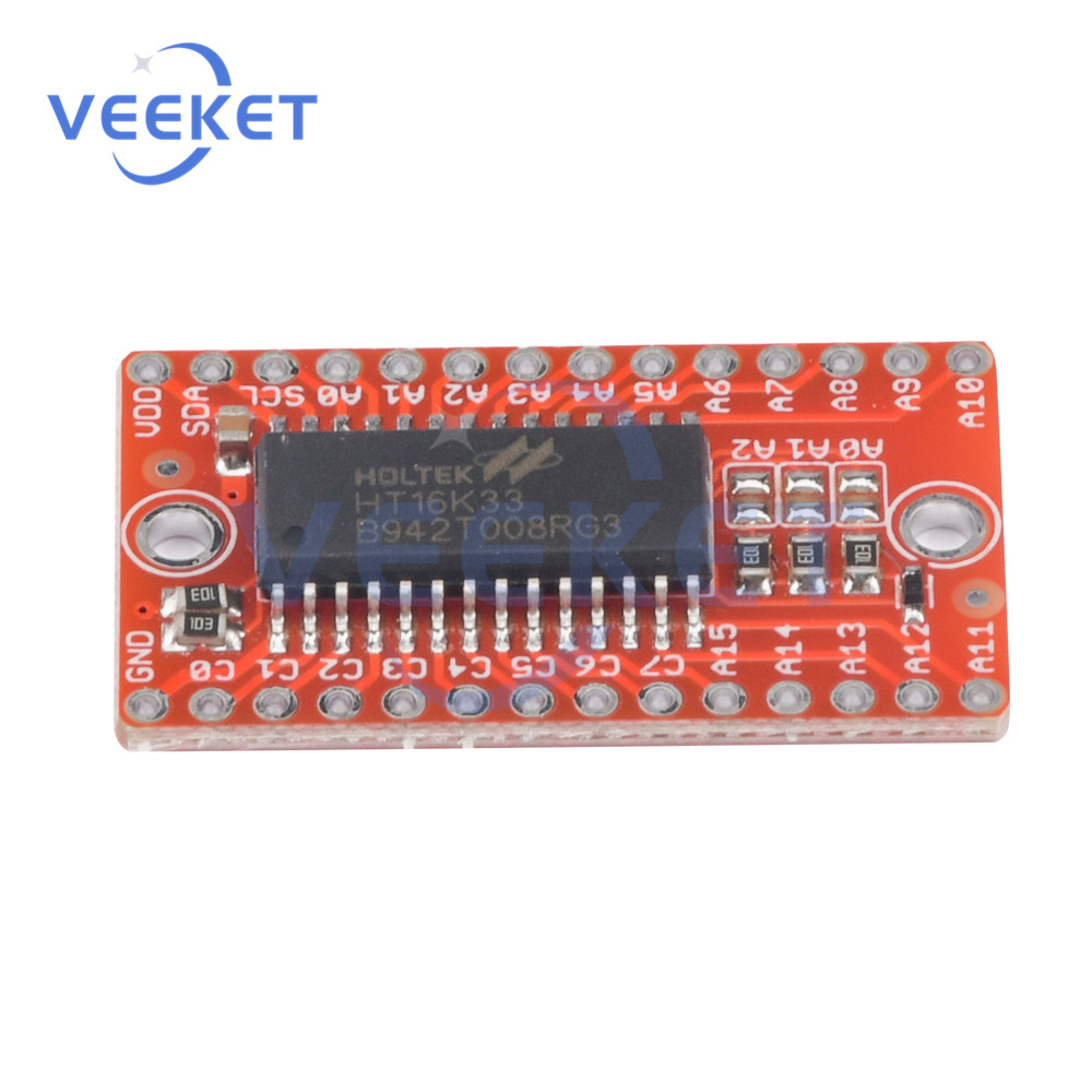

    HT16K33 - purchase of the module
    The module is available in China for about PLN 20:
    HT16K33 alphanumeric LED display module 14 segments 4 characters - protocol, Ard
    Various LED colors can be selected.
    It is worth noting that this board uses up to 14 segments per character, and the chip itself supports up to 16 segments per character. This gives much more possibilities than a 7-segment display.

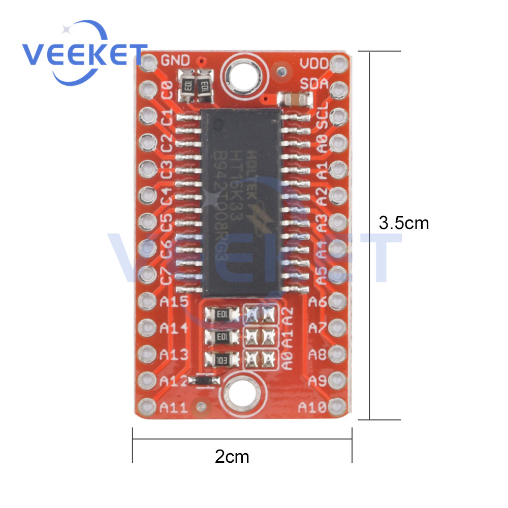

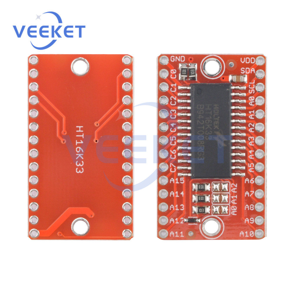

    Boards without a display are also available, half the price:

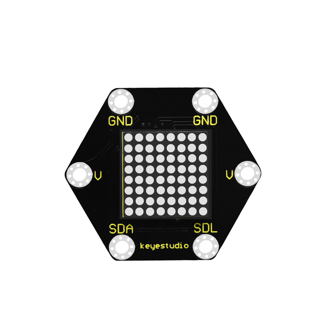

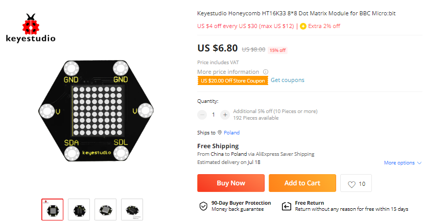

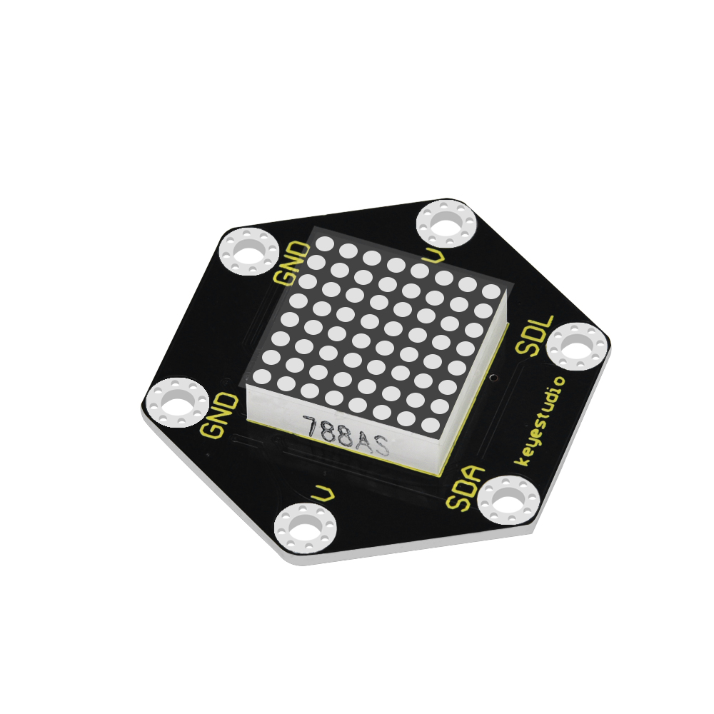

    There are also versions with an 8 by 8 display. Here, for example, for PLN 30:

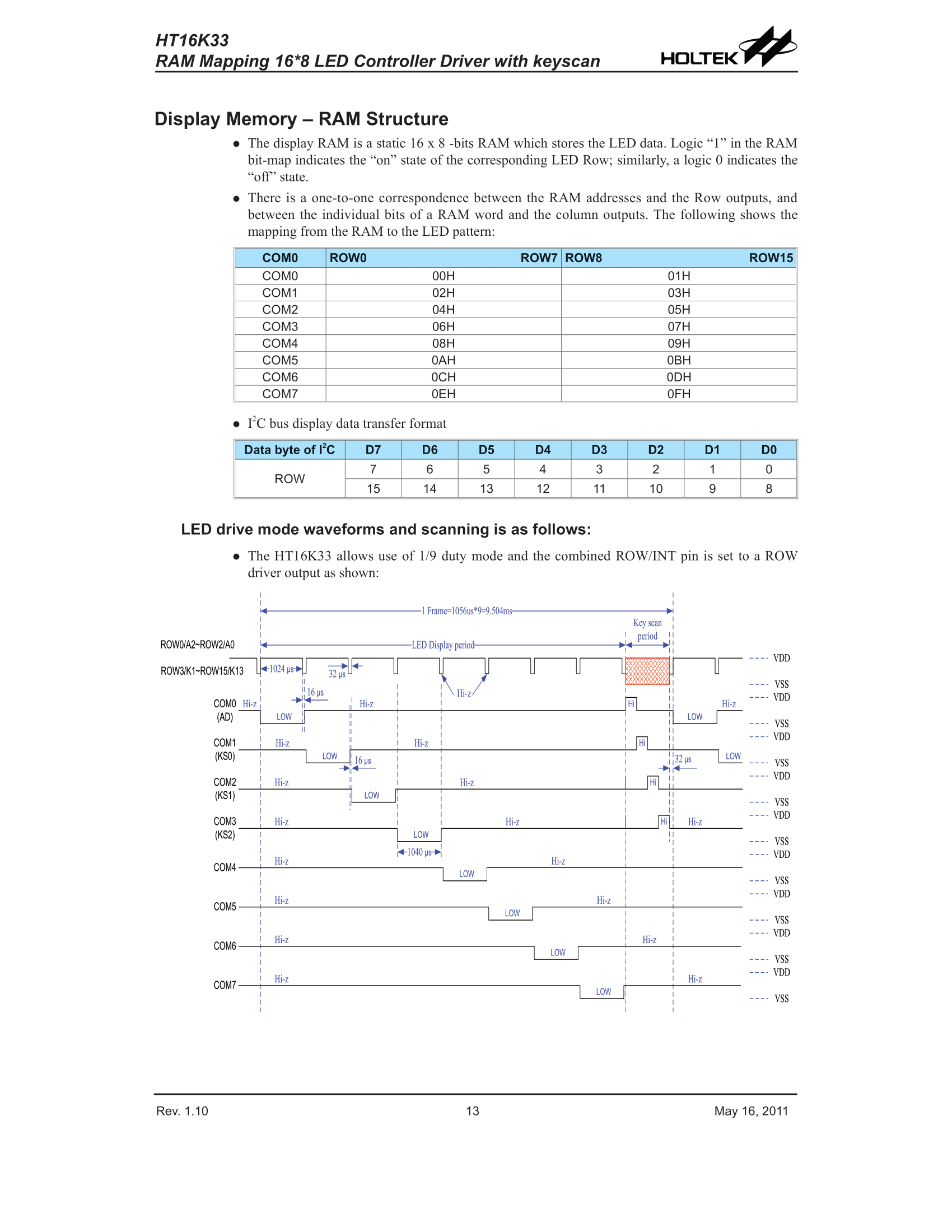

    This layout supports up to 16 segments and 8 characters. A whole 2 bytes per character.

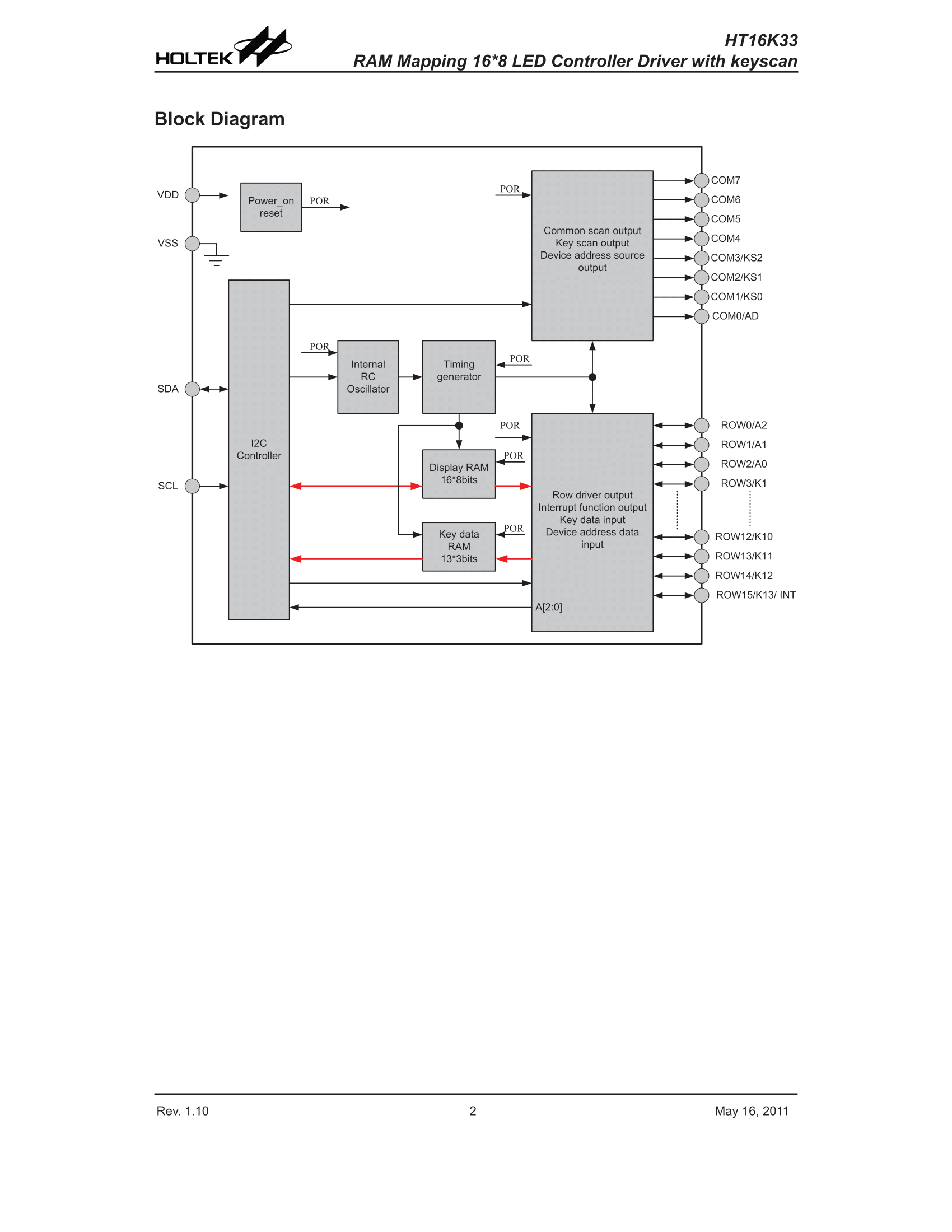

    Internal construction (pins A0, A1, A2 can be seen from the selection of the I2C address):

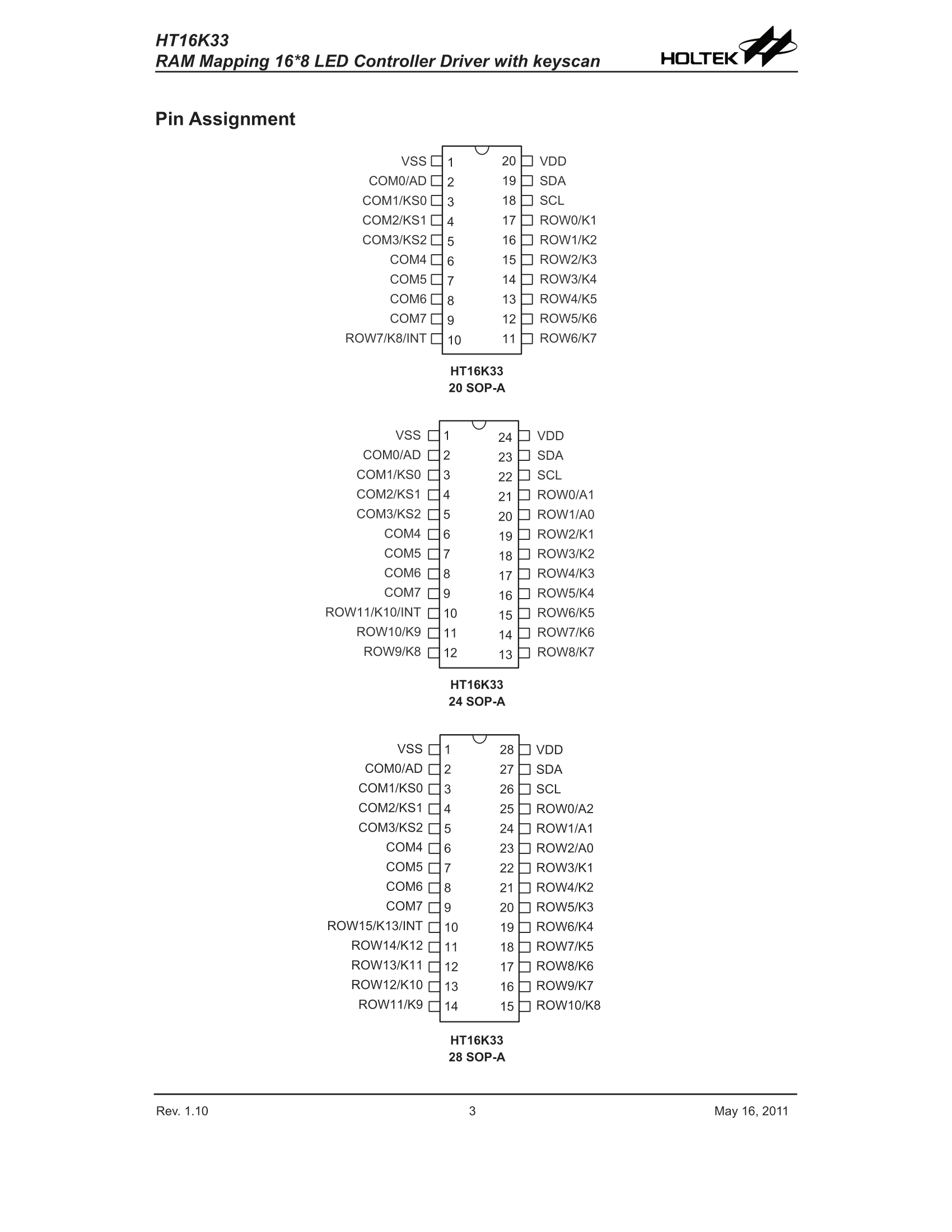

    Pinouts:

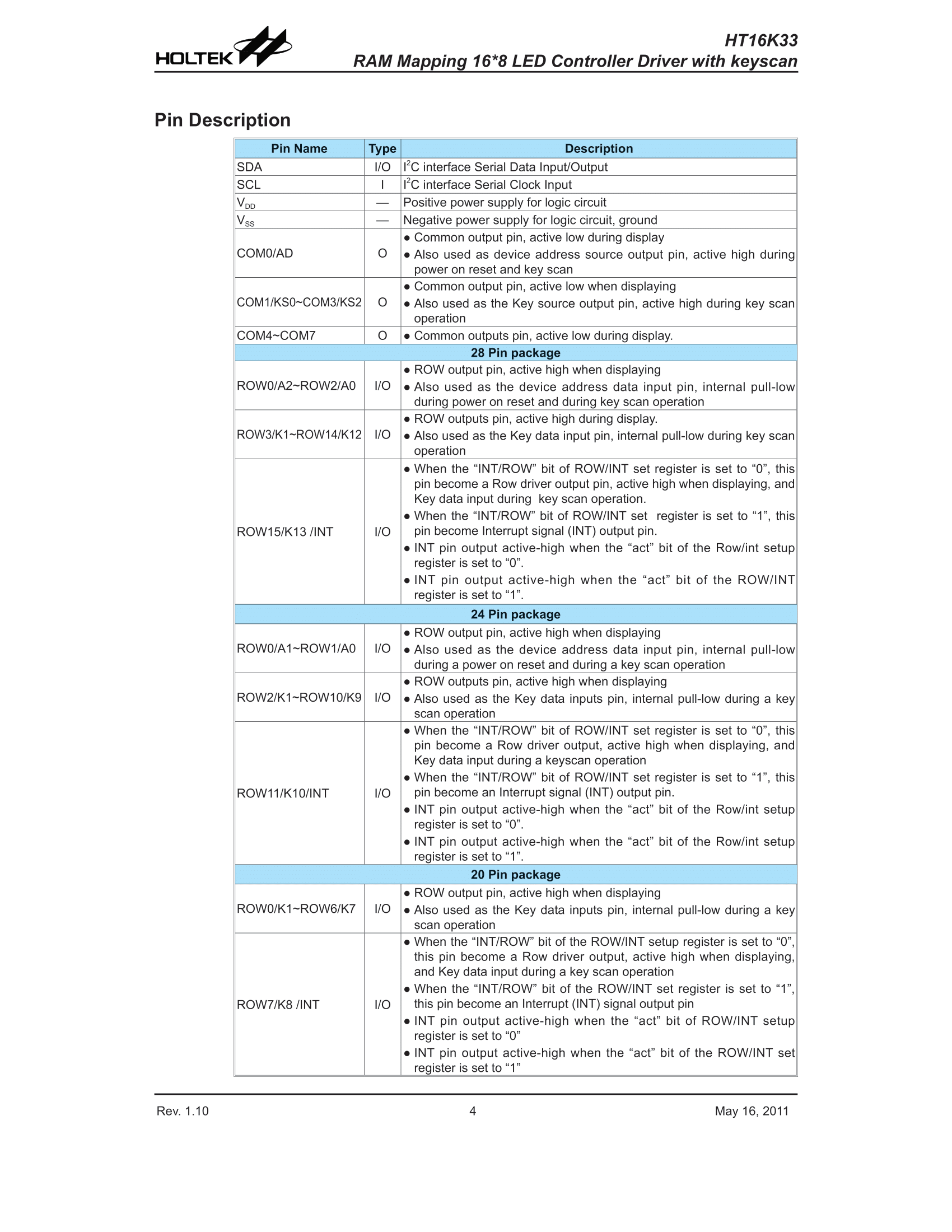

    Pin roles, some pins have several roles, e.g. the same ones are used for keyboard and display:

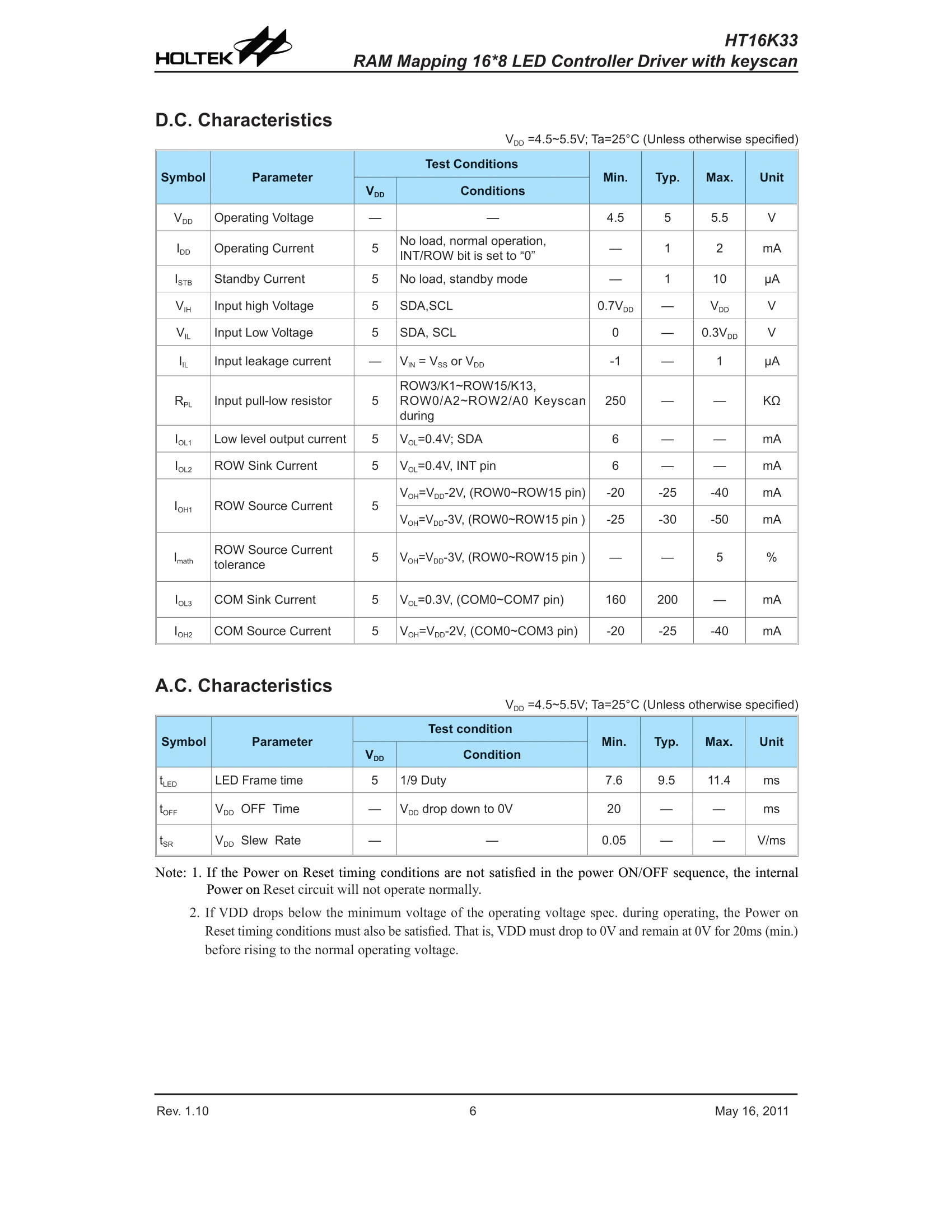

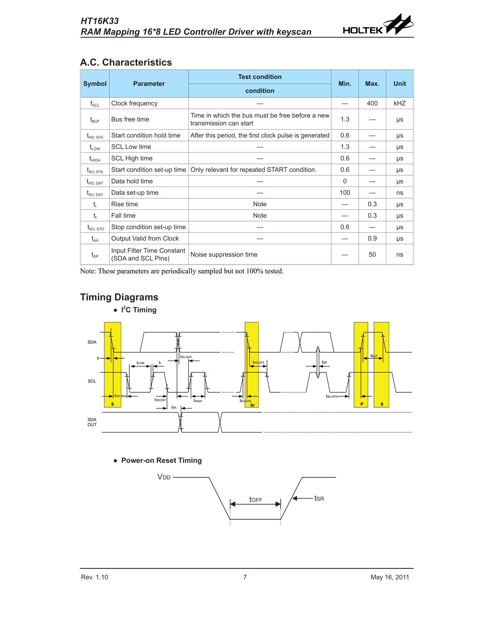

    Current parameters for the display and communication times (maximum 400kHz clock):
    HT16K33 alphanumeric LED display module 14 segments 4 characters - protocol, Ard HT16K33 alphanumeric LED display module 14 segments 4 characters - protocol, Ard

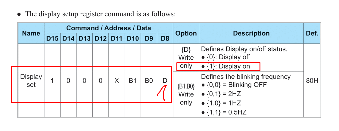

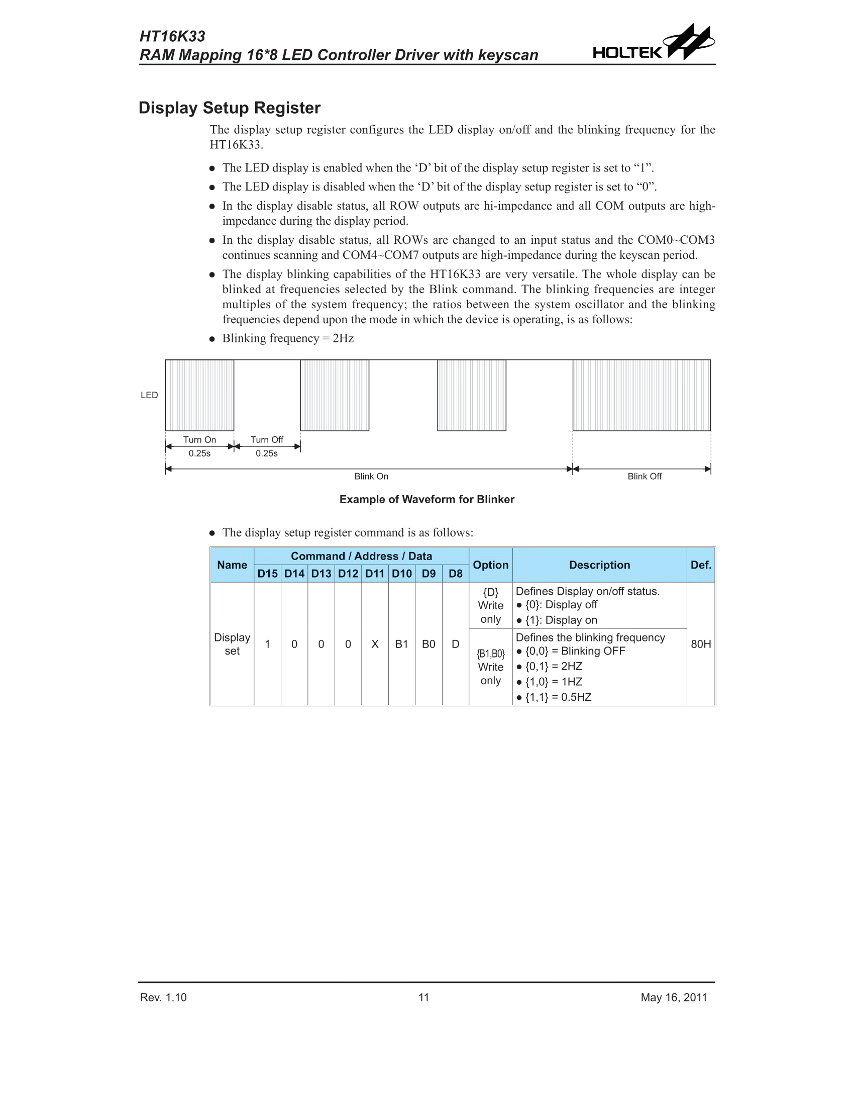

    The most important is probably the Display Setup Register. There we can turn the display on or off, although you also need to handle standby from the System Setup Register beforehand. We also have flashing settings there, we can simply set the display to flash at a frequency of 2Hz, 1Hz or 0.5Hz and it will happen automatically without our further intervention. It is worth paying attention to how the display knows which register we are writing to - simply, e.g. in Display Setup, as shown in the picture, bit D15 is 1, and e.g. in System Set, bit D15 is 0.
    We also have registers that contain what we want to display:
    It is a 16-segment display. Here we have two bytes per character. Each COM* specifies a character and consists of two bytes, as in the table.
    The system, of course, already performs multiplexing of the display itself.

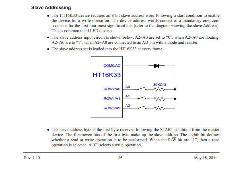

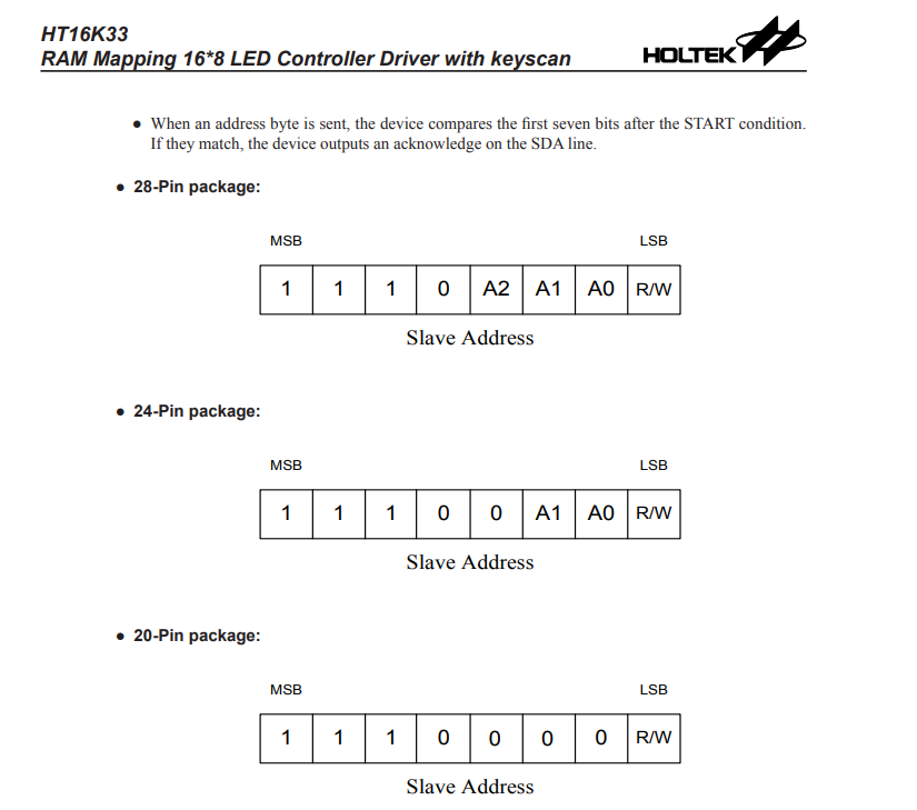

    Let us now turn our attention to the addressing issue. Here are the address details:
    And the structure of the address itself (interesting, depending on the housing, the addresses are different):
    By default, we have control over 3 address bits, so we have 2^3 different address options. It is the same in many other systems, I2C expanders, memory chips, etc. It is worth keeping an eye on whether we have the right address of the system, because communication will not work through the wrong address. If you are not sure about the address, you can always search for the I2C scanner on the Arduino network and search for this address in practice.

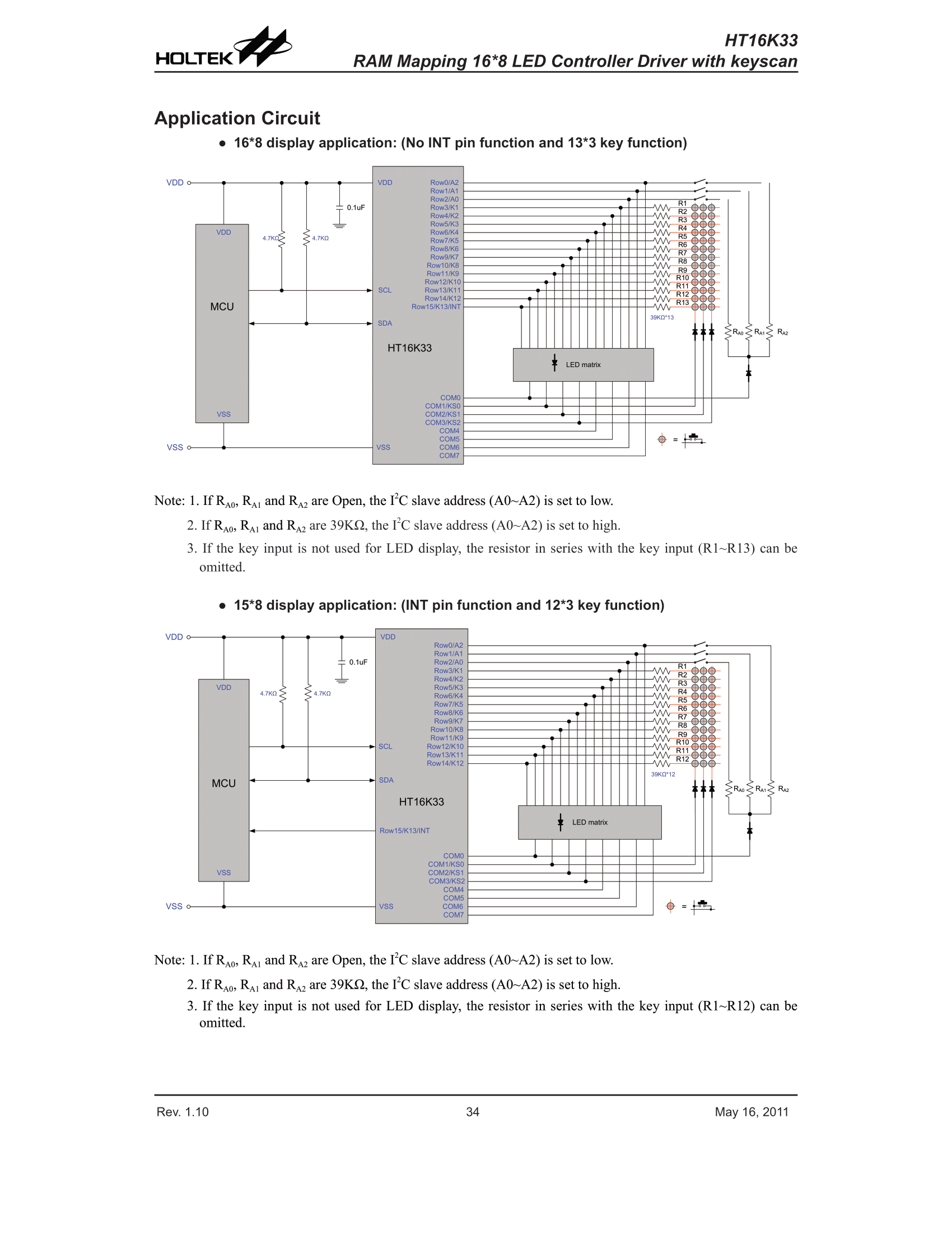

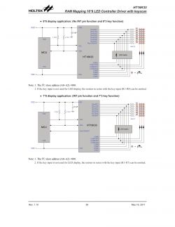

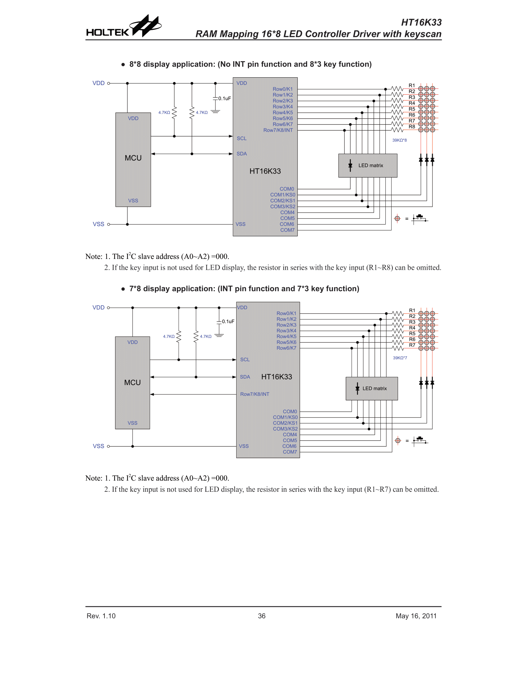

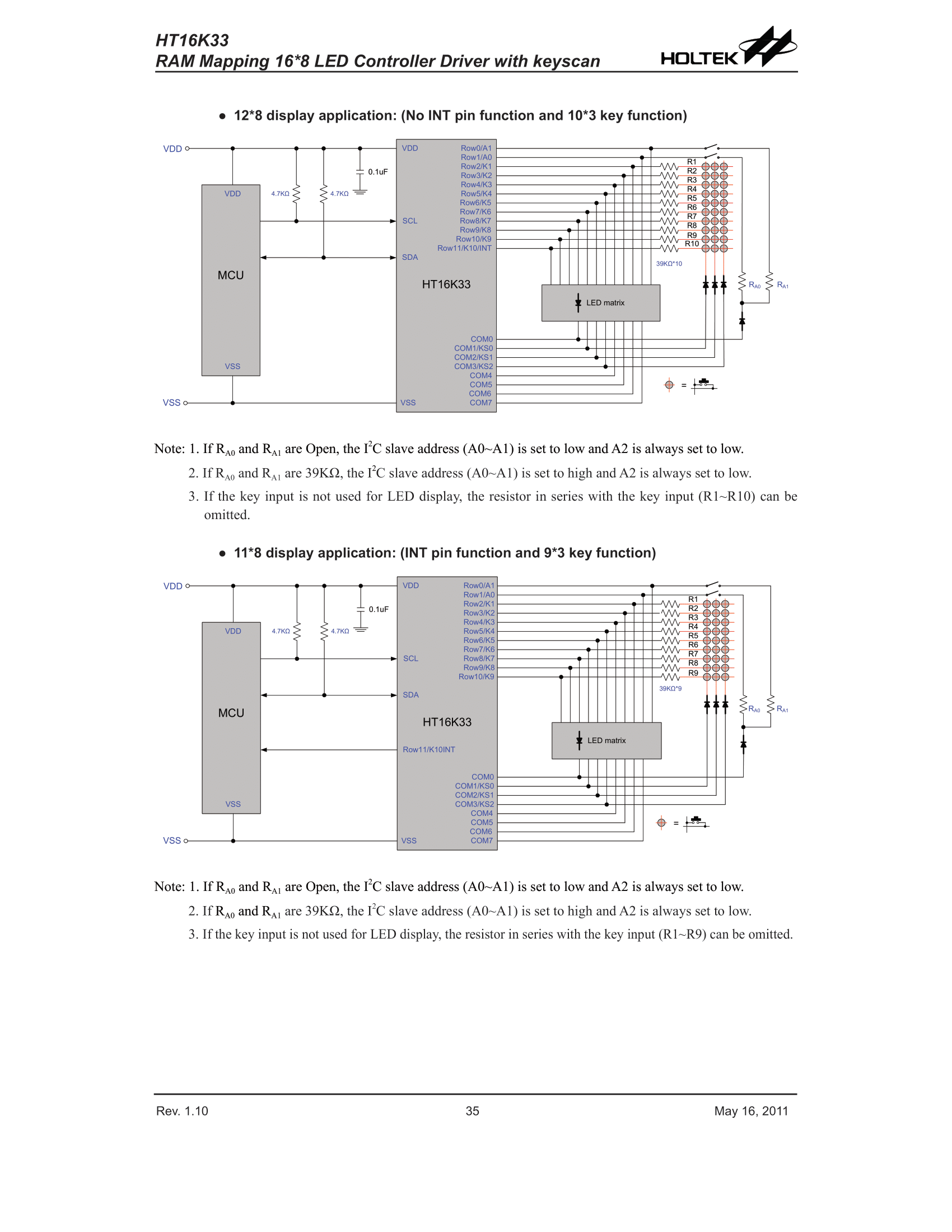

    Now, for illustrative purposes, sample applications:
    16*8 and 15*8 display:
    12*8 and 11*8 display:
    8*8 and 7*8 display:
    The applications also show the matrix keyboard connection, you can see that it uses the same pins as the display. In addition, the method of selecting the I2C address was taken into account.

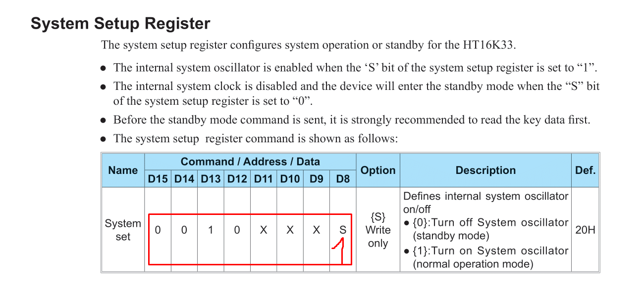

    Then I decided that it's worth sending a command first HT16K33 on but how should it be done?
    We look at the catalog note.

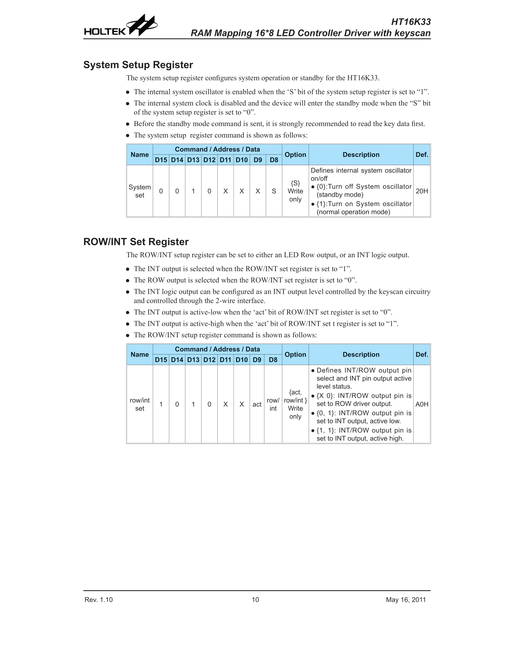

    We want to set Standby Mode to 1. We look at the table of what bits we want to send.
    You need to send 0010 0001, which is 0x21.
    Code: C / C++
    Then we want to send display on , similarly, we are looking for the appropriate table:
    We rewrite the bits, we have 1000 0001, this is 0x81:
    Code: C / C++

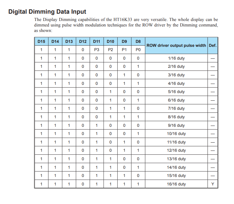

    Now setting the brightness .
    The four least significant bits determine the brightness level. So we have 2^4 levels. Numerical values from 0 to 15 inclusive. In addition, you also need to send those constant bits that are at the beginning of the table, the oldest. How to do it?
    Code: C / C++
    Basically that's enough to add. By the way, there is also a condition in the code to remove invalid brightness values. Then we use our send command to send it and you're done.

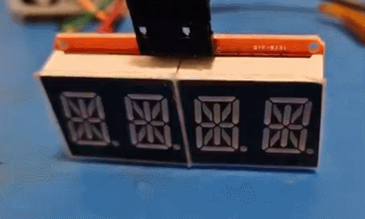

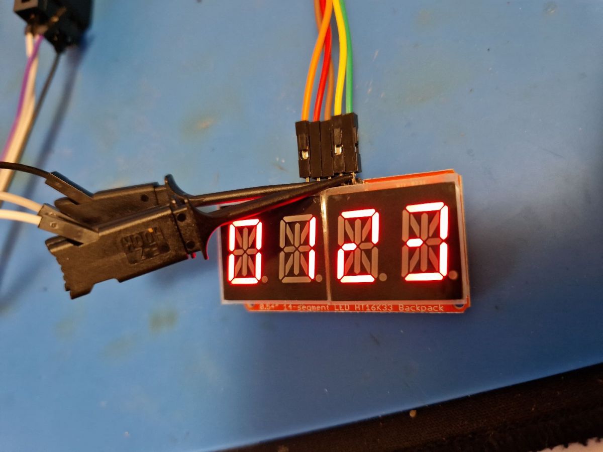

    And I tried to display something:
    Code: C / C++
    What happened then? I give the floor to graphics/photos from my tester in Serbia. Maybe some specifics first:
    Works! It's not perfect, but it works. So a 7-segment font matches this 16-segment...

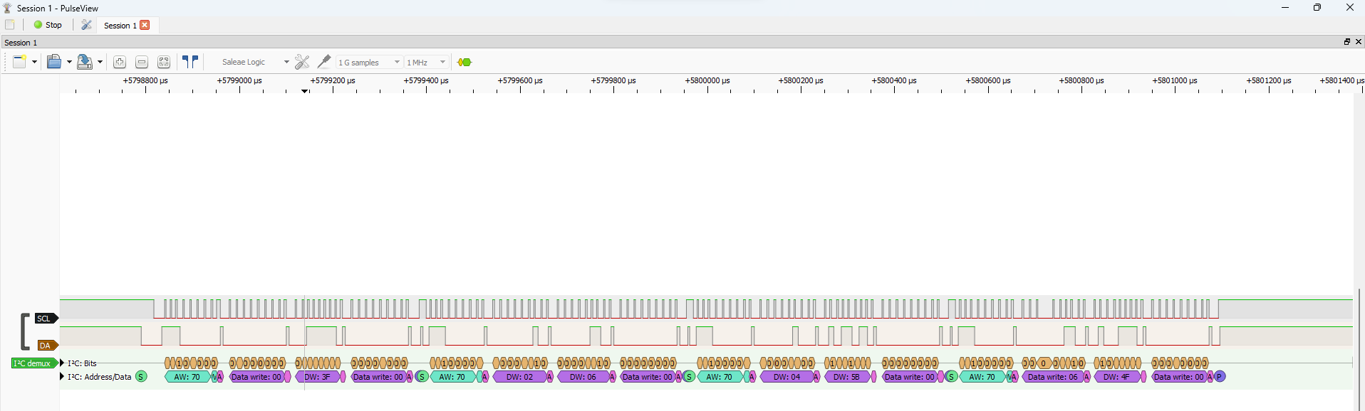

    And now a preview of communication from the logic analyzer. It shows nicely I2C transactions. You can see the mentioned address 0x70, and then you can see the commands, and then also the writing to the display (and these offsets, respectively 0, 2, 4, 6 ...):
    This is a screenshot of the Sigrok app from here: https://sigrok.org/wiki/Downloads
    It's good, but rather you need to unleash all the possibilities of this module and start with a 16-bit font. Github has come to the rescue again:

How can I display numbers on a 14-segment HT16K33 module using an existing 7-segment font table?
Use the 7-segment byte pattern as the low byte and write 0 as the high byte. The thread tested values 0, 1, 2, and 3 with a 7-segment charmap. It worked on the 14-segment module, but it did not use all segments. This method suits numeric tests, not high-quality alphanumeric text. [#20622372]
What is the correct way to create or use a 16-bit font for a 14-segment HT16K33 alphanumeric display?
Use a 16-bit character map where each glyph sets both low and high segment bytes. A 7-segment table uses 8-bit values such as 0x3F for 0. A 16-segment map can use values such as 0x4000 for a dot or 0x12C0 for plus. The thread moved to a convert16seg(char c) function for full alphanumeric support. [#20622372]

How can Sigrok or a logic analyzer be used to inspect HT16K33 I2C communication?
Use a logic analyzer with Sigrok to decode I2C transactions and confirm commands and RAM writes. The thread shows address 0x70, setup commands, and display writes to offsets 0, 2, 4, and 6. This exposes failures such as missing acknowledgements, wrong shifted addresses, or incorrect byte order. Sigrok is named as the viewer used for the screenshot. [#20622372]
