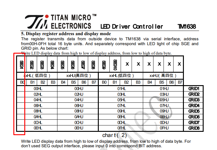

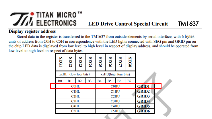

    It seems that this TM1638 is using one segment per digit, see datasheet section:
    TM1638 Driver Development Progress: Updates on Module, Code, and Integration Features
    This is different from TM1637 I tested in the past, which was using one grid per digit:

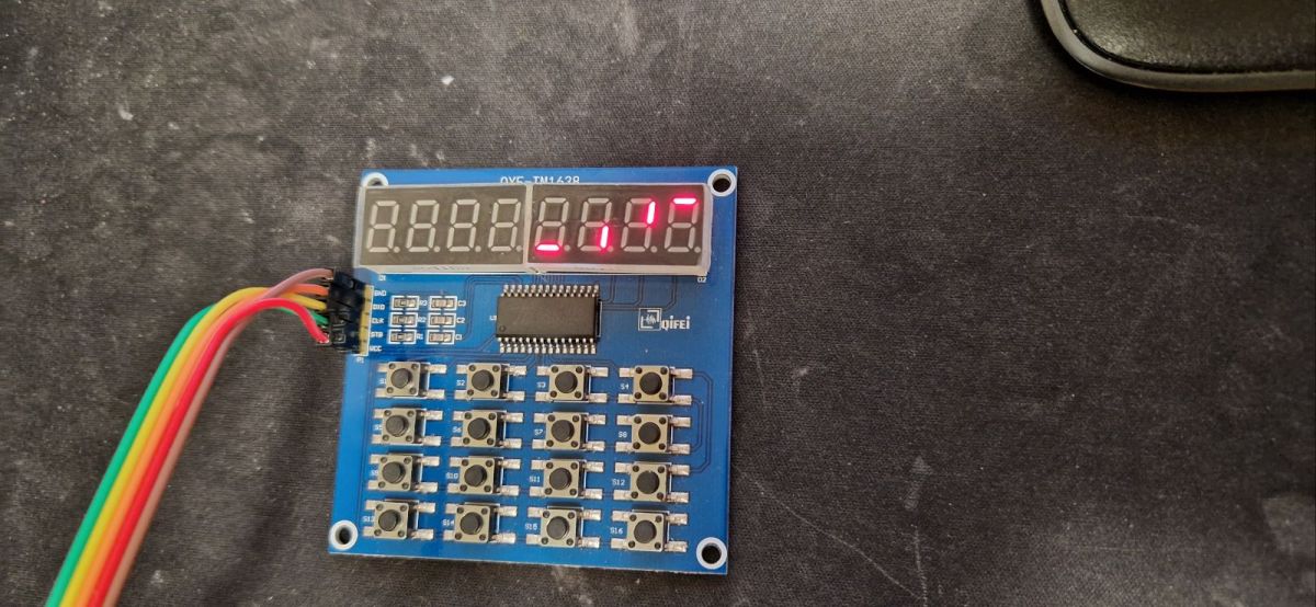

    Build 1.17.34 and this command
    backlog TMGN_Clear; TMGN_SetBit 0 0 1 ;   TMGN_SetBit 0 1 1 ;  TMGN_SetBit 0 2 1  ; TMGN_SetBit 0 3 1
    returns this:
    Added after 20 [minutes]:

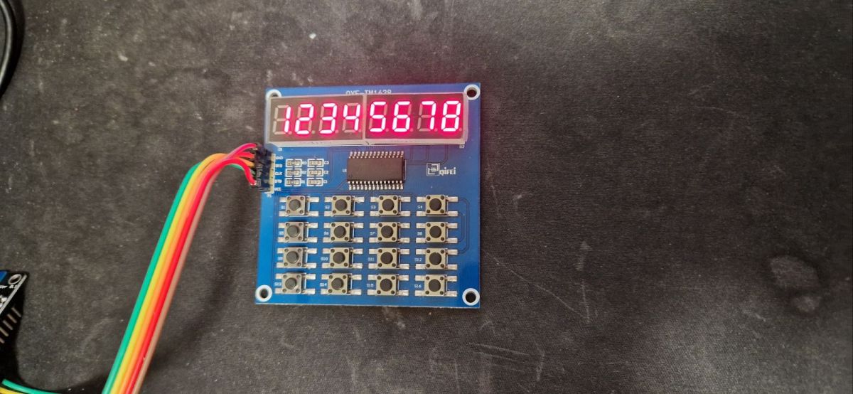

    Progress report with build 1.17.35:
    backlog TMGN_Print 0 0 1; TMGN_Print 1 0 2; TMGN_Print 2 0 3; TMGN_Print 3 0 4; TMGN_Print 4 0 5; TMGN_Print 5 0 6; TMGN_Print 6 0 7; TMGN_Print 7 0 8
    Also mapping works:
    TMGN_Map 7 6 5 4 3 2 1 0

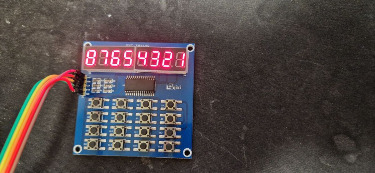

  • #5 20554121
    DeDaMrAz
    Posts: 621
    Help: 34
    Rate: 130

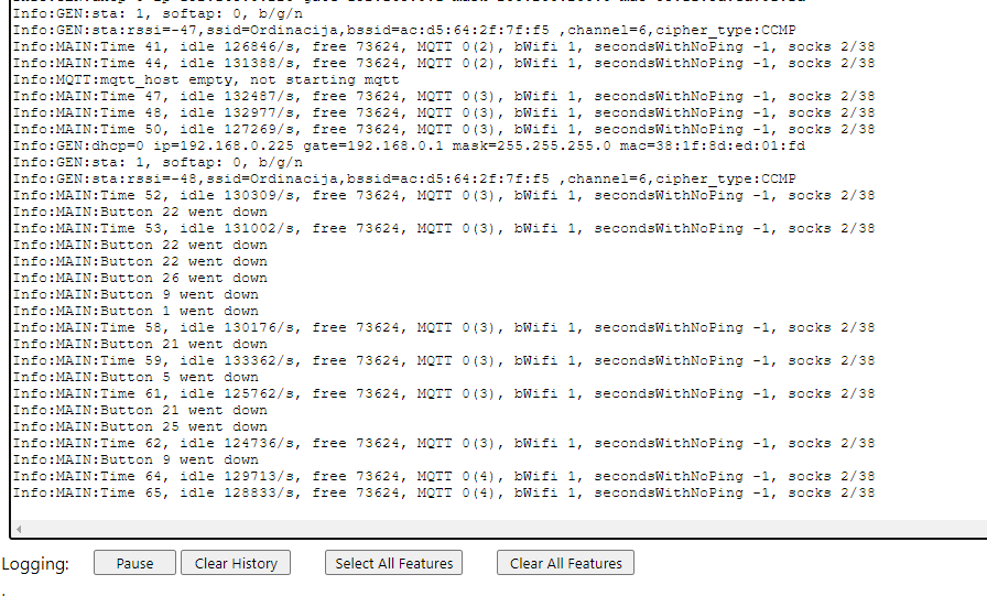

    Build 1.17.43 progress:
    Keys can now be read with TNMG_SetupButtons [value_in_milliseconds] command - typical 100mS
    Log should be something like this:
  • #6 20554205
    Posts: 14795
    Rate: 12947
    I've added ability to fire events for TM1638 buttons:
    addEventHandler OnCustomDown 1 echo Button 1 is going down
    addEventHandler OnCustomUp 1 echo Button 1 has been released

    #7 20554255
    DeDaMrAz
    Posts: 621
    Help: 34
    Rate: 130

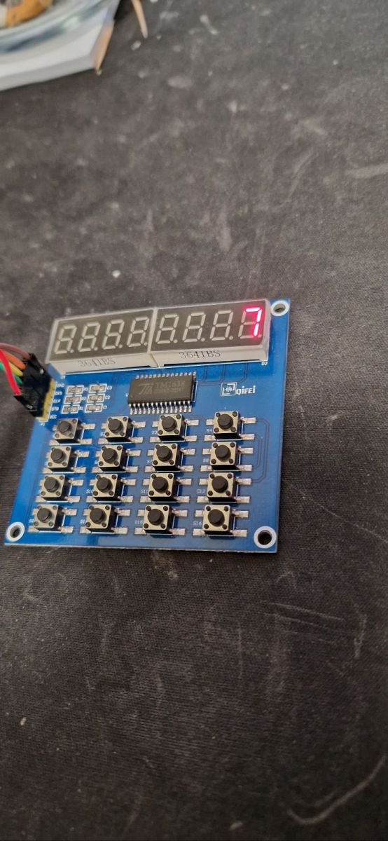

    It looks like it is working, see the picture.
    Added after 9 [minutes]:
    addEventHandler OnCustomDown 1 TMGN_Brightness 1
    addEventHandler OnCustomUp 2 TMGN_Brightness 7
    or entire script for testing:
    startDriver NTP
    ntp_timeZoneOfs  +2:00
    TMGN_Clear
    again:
    // TMGN_Print  offset len value bPadToLenWithZeros
    TMGN_Print 6 2 $second 2
    TMGN_Print 4 2 $minute 1
    TMGN_Print 2 2 $hour 1
    goto again

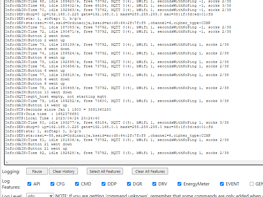

  • #8 20554662
    Posts: 14795
    Rate: 12947
    Hello, your script is incomplete.
    You've forgot to include:
    TMGN_SetupButtons 100
    required to setup button scan every 100ms.
    Buttons will not work without that.
  • TMGN_SetupButtons 100 required for button scanning
