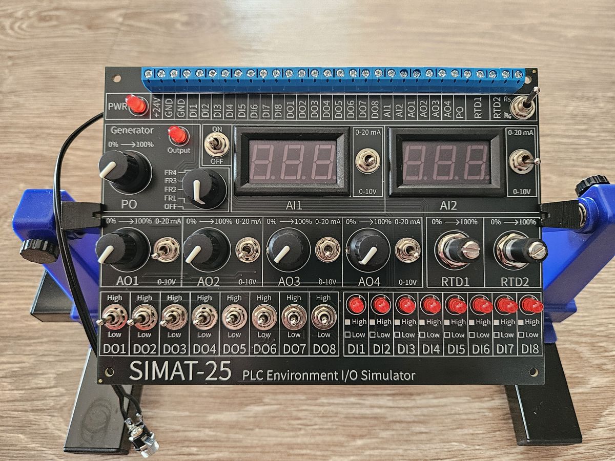

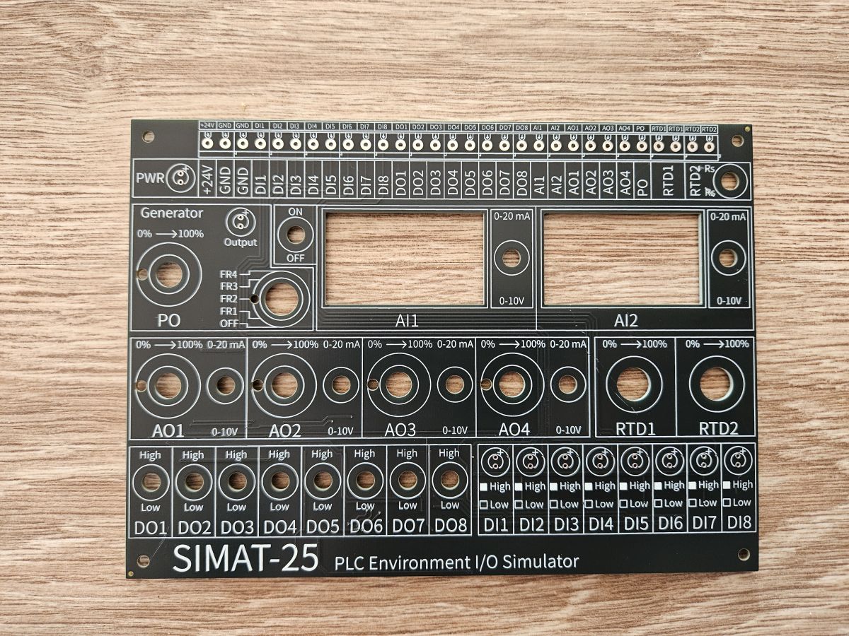

    Some time ago I started my adventure with PLC programming. To start with, I found that Siemens LOGO! was sufficient. Creating a program in FBD language is quite transparent but, as you know, the created program must somehow affect reality. It is a good idea to test the written programme on a workbench in order to identify and repair potential errors before the whole assembly is assembled in the final location. This involves simulating certain states to the controller at its inputs and visualising states at its outputs to determine if the application is functioning as expected. I found that combining with switches, lights, potentiometers, etc. was not very convenient. I found signal simulators dedicated to LOGO! on the web, but for various reasons I refrained from buying one. I decided that I would design and make my own simulator. It was to be a compact design providing all the basic signals for the PLC under test. And so the device I called SIMAT-25 was created, and many factors determined this name.
    The complete device is shown in the photograph below.
    SIMAT-25 simulator casing with diagram on top .
    The case is a Z33 model from a well-known company in the industry. Dimensions: height 46.0 mm, width 140.0 mm, length 190.0 mm. On the lid there is a plate showing in simplified form the idea of the construction of the individual signal tracks. For those in the trade, this information contains all the necessary data. The lid protects the panel components from mechanical damage. When the lid is removed, the panel is visible.
    SIMAT-25 signal simulator for PLC environment. .

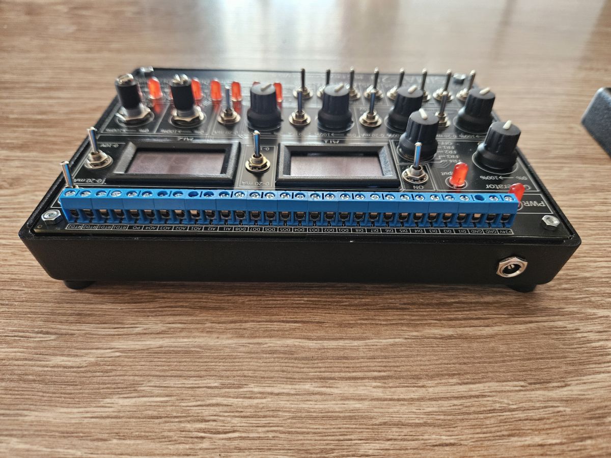

    On the side of the case there is a DC 2.5/5.5 socket for connecting a 24VDC power supply ("plus" inside).
    SIMAT-25 controller with knobs and switches on a wooden table. .
    The simulator is designed for PLCs supplied with 24V DC. The power supply is connected to the ARK connectors with the description +24V DC and GND. The GND terminal is common to the power supply and the simulated signals. In this way, the power supply for the simulator can be taken from the system in which the PLC under test is running. It is also convenient to use an additional 24VDC power supply and connect it to the DC 2.5/5.5 connector on the side of the housing. In this way, the controller under test can be powered by wires plugged into the ARK +24VDC and GND connectors and in this way it is the simulator that powers the controller under test. This way of power supply suits me so far.

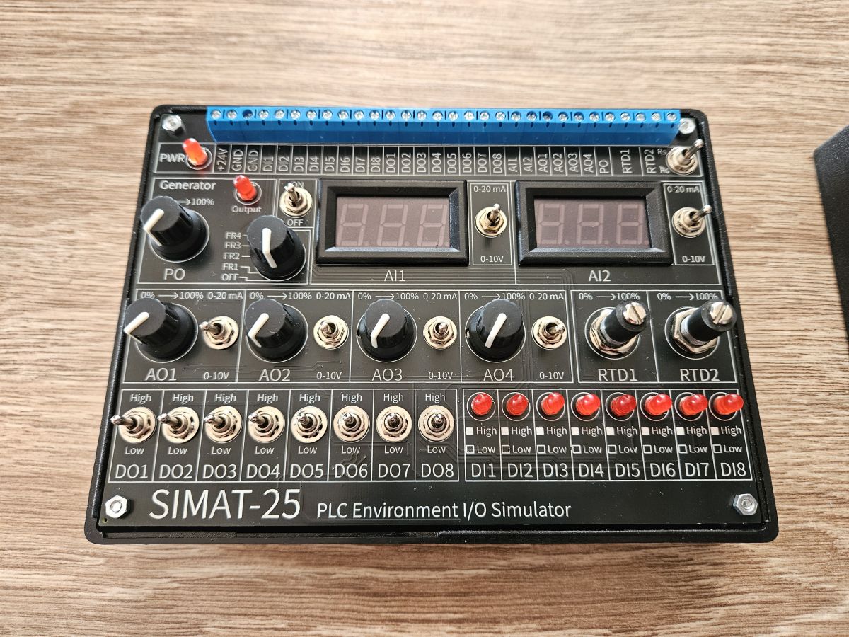

    The main electronics board of the simulator is also the front panel. All electronic components are smd type and are located on the underside of the board. The main board itself has protection against reverse connection of the supply voltage, while the corresponding pins of the DC supply connector and the ARK +24VDC and GND terminals are directly connected to each other.
    Correct connection of the power supply is indicated by the illumination of the red LED with the description PWR.
    Sets of potentiometers, switches, LEDs, displays are given names identifying the supported function/signal. The corresponding names are also found on the ARK screw terminals, so it is immediately clear which connector is the signal of interest.

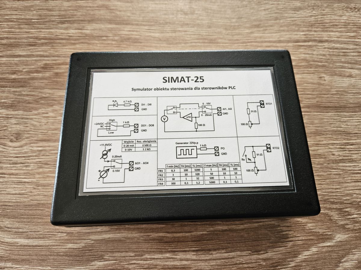

    Signals and their characteristics:
    DO1-DO8: three-state digital output: logic 1 "High" state (short-circuits to plus supply), logic 0 "Low" state (short-circuits to GND) and high impedance state (output "hangs in the air"). There is a 1k/1W resistor in series at the output of each DO signal. This protects both the simulator and the PLC from connection errors (short circuit). A value of 1k is sufficient for a correct reading via the DI input of the PLC.
    DI1-DI8: digital input. LEDs with series resistors. The current drawn by one input for 24V DC is approximately 4.5 mA.
    AO1-AO4: analogue outputs 0-10V and 0-20mA selectable by switches. With the potentiometer position at 100%, the voltage is equal to 10.5V and the current 21mA. This slight overdrive has been implemented intentionally. The minimum load resistance of the 0-10V output is 2kOhm. Below this value, the output starts to limit the output current. This ensures that when the 0-10V output is mistakenly connected to the 0/4-20mA input of the controller under test, it will not damage this input. The maximum load resistance of the 0-20mA output is 500Ohm. The open loop voltage is 11.8V. Thus, mistakenly connecting the 0-20mA output to the 0-10V input of the controller under test will not damage this input.
    RTD1: PT100 sensor simulator. A 10-turn precision potentiometer with a value of 100Ohm. Connected in series internally with a 91Ohm precision resistor. The whole provides a resistance range of 91Ohm-191Ohm which corresponds to a temperature range of -23 to + 245 stC. Per revolution, there is a change in simulated temperature of approximately 26stC
    RTD2: same operation as RTD1 but in this block it is possible to eliminate an additional series resistor by using a switch. The Rs position indicates a 91Ohm resistor in series and the Rs crossed out position indicates the bypassing of this resistor. This option offers two advantages:
    (a) this allows very low negative temperatures to be simulated
    (b) it is possible to connect two RTD1 and RTD2 blocks in series using an external bridge and create a single circuit to simulate a PT100 sensor with a maximum resistance value of 291Ohm while maintaining continuous control with two potentiometers. This corresponds to a temperature of approximately 530stC.
    AI1, AI2: these are voltmeters/ammeters for visualising the status of the AO output of the controller under test. In the 0-10V position the circuit measures the voltage, the value is displayed in volts. The input resistance is several hundred kilohms. In the 0-20mA position, the circuit is an ammeter. The displayed value is in milliamps. The input resistance is then 100Ohm.
    PO: rectangular wave generator. It is useful for pulse counting circuits. The amplitude of the waveform is approximately 22Vp-p. An LED labelled "Output" is connected to the generator output and flashes in sync with the output signal. There is a 1k/1W resistor in series with the generator output. This protects both the simulator and the PLC from connection errors (short circuit). A value of 1k is sufficient for a correct reading by the PLC input. The operating modes are selected by a 5-position rotary switch. Positions FR1-FR4 are the ranges of the frequency of the generated signal fluently varied by a potentiometer within the range.
    OFF- generator turned off. Low state at the PO output.
    FR1- Potentiometer position 0%- frequency f= 0.3Hz, duration of high state TH= 100ms, duration of low state TL= 3200ms.
    Potentiometer position 100%- f= 5Hz, TH= 100ms, TL= 100ms.
    FR2- Potentiometer position 0%- frequency f= 3Hz, duration of high state TH= 10ms, duration of low state TL= 320ms.
    Potentiometer position 100%- f= 50Hz, TH= 10ms, TL= 10ms.
    FR3- Potentiometer position 0%- frequency f= 30Hz, high state duration TH= 1ms, low state duration TL= 32ms.
    Potentiometer position 100%- f= 500Hz, TH= 1ms, TL= 1ms.
    FR4- Potentiometer position 0%- frequency f= 300Hz, high state duration TH= 0.1ms, low state duration TL= 3.2ms.
    Potentiometer position 100%- f= 5kHz, TH= 0.1ms, TL= 0.1ms.
    The frequency ranges "overlap" providing access to any value in the range of approximately 0.3Hz to approximately 5kHz.

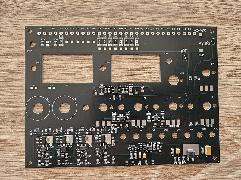

    I made the board design in OSHWLAB, manufacturing with component assembly in JLCPCB.
    This is what the TOP side of the board looks like
    Front panel of the SIMAT-25 simulator with printed descriptions of inputs and outputs. .
    And this is the BOTTOM side
    Top view of the PLC simulator main board.

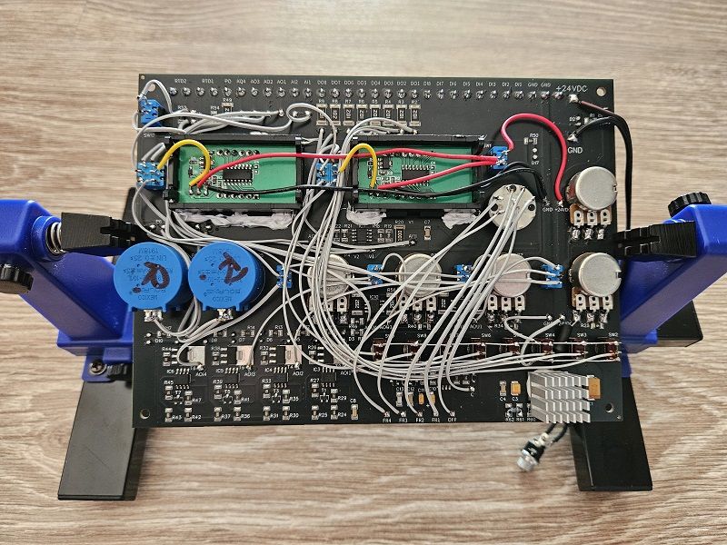

    TOP side after installation of potentiometers, switches etc.
    SIMAT-25 PLC simulator with various knobs and displays on the control panel.
    And the BOTTOM side after making the connections. Spaghetti but unfortunately unavoidable.
    Signal simulator circuit board with numerous components and connections. .

    It looks great! But when fully assembled, the inside becomes a visual mess; if the paths were routed so that there was no need for a spider web of wires, just the shortest possible wires, it would be even better.
  • Short wires not possible due to PCB clearance

    Thank you:) Yes, it looks quite chaotic, but according to the design :) Your idea to locate the soldering points as close as possible to the switches which would allow the use of short wires I also analysed during the design. And unfortunately, because of the path-free area on the PCB that has to be provided for switches, potentiometers, displays etc. there is not enough space for routing further paths. Nevertheless, from the point of view of soldering the wires, it is the same job regardless of the length of the wires. Aesthetics suffer, of course, but ultimately the wires are well hidden. The most important thing is the solidity of the connections and the insulation of each other.
    Regards

"A PT100 sensor simulator is a resistance source that imitates a platinum RTD, reproducing temperature by presenting the ohmic value a PLC analog input expects from a PT100 probe." RTD1 uses a 10-turn 100Ω precision potentiometer in series with a 91Ω precision resistor. That gives 91-191Ω, which the author maps to about -23°C to +245°C. RTD2 works the same way, but adds a switch to bypass the 91Ω series resistor. [#21451523]
How can RTD1 and RTD2 be combined to simulate a wider PT100 temperature range up to about 530°C?
You can connect RTD1 and RTD2 in series with an external bridge and disable the extra series resistor in RTD2 when needed. In that configuration, the combined simulator can reach about 291Ω maximum resistance. The author states that this corresponds to approximately 530°C for PT100 simulation, while still allowing continuous adjustment with two potentiometers instead of fixed resistor steps. [#21451523]
What frequency and pulse-width ranges does the PO rectangular wave generator cover, and how can it be used for PLC pulse counting tests?
The PO block generates rectangular pulses from about 0.3Hz to 5kHz across four overlapping ranges. FR1 spans about 0.3Hz to 5Hz with 100ms high pulses, FR2 spans 3Hz to 50Hz with 10ms highs, FR3 spans 30Hz to 500Hz with 1ms highs, and FR4 spans 300Hz to 5kHz with 0.1ms highs. That makes it useful for checking pulse counters, high-speed input behavior and timing thresholds in PLC programs. [#21451523]
Why does the inside of the assembled simulator use many wire connections instead of routing everything on the PCB, and what layout limitations caused that?
The wiring harness exists because the component-filled panel leaves too little routing space on the PCB. The author says switches, potentiometers, displays and other panel parts require track-free areas, which prevents full routing of all connections. He considered placing solder points closer to switches for shorter wires, but there still was not enough room for additional traces. The result looks chaotic, yet the wires remain hidden and the electrical goal stays intact. [#21457973]
Universal PLC tester vs dedicated tester for one machine: which approach is better for commissioning, setup and basic diagnostics?
Both approaches are useful, but they solve different problems. One commenter said a dedicated tester for each separately manufactured machine makes setup and basic testing easier and can include custom logic or protocol analysis. The author answered that SIMAT-25 was intentionally built as a compact universal source of basic I/O signals for utility PLC programs, where switches, LEDs and potentiometers are enough. For simple applications, the thread clearly favors simple tools. [#21451954]
How can I design and manufacture a custom PLC signal simulator using OSHWLAB for PCB design and JLCPCB for assembly?
You can follow the same workflow used for SIMAT-25: design the PCB in OSHWLAB, then order fabrication and component assembly from JLCPCB. The author made the main electronics board as both the control PCB and front panel, with all electronic parts in SMD form on the underside. He then added panel components such as potentiometers, switches and displays, and completed the remaining internal wire connections by hand. [#21451523]
What should I pay attention to when choosing connectors, load limits and protection features in a DIY PLC simulator for 24V automation systems?
Choose robust connectors and define electrical limits before you build. One commenter warned that using the cheapest connectors can make the tool unpleasant to use. The thread also shows why protection matters: SIMAT-25 includes reverse-polarity protection on the main board, 1k/1W series resistors on digital outputs and the pulse output, a 2kΩ minimum load guideline for 0-10V mode, and a 500Ω maximum load for 0-20mA mode. Those limits reduce damage from common wiring errors. [#21451860]
