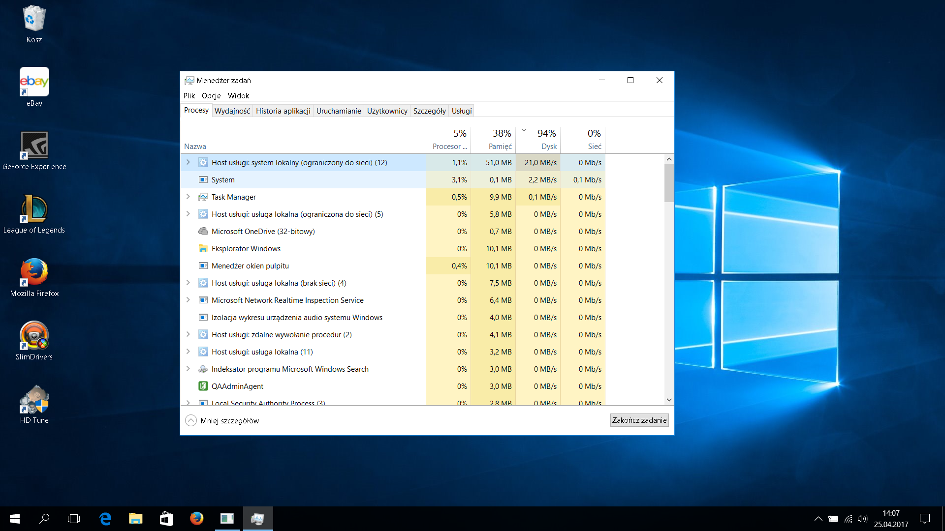

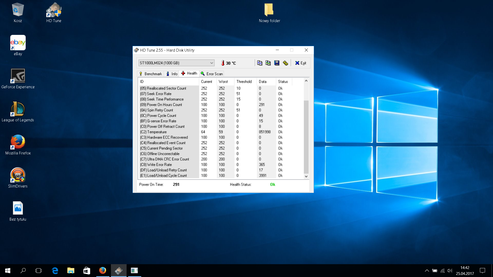

    The problem is the system is constantly crashing and mulching. All drivers updated, drive checked in HD tune, all green.
    Entering the manager I noticed too much disk load (screen).
    In services.msc I turned off the Windows update service but no result.
    In msconfig.exe I turned on all processors, but also without results.
    Photos open after about 16 seconds.
    New card in chrome about 23 seconds.
    Do you have any ideas, gentlemen?

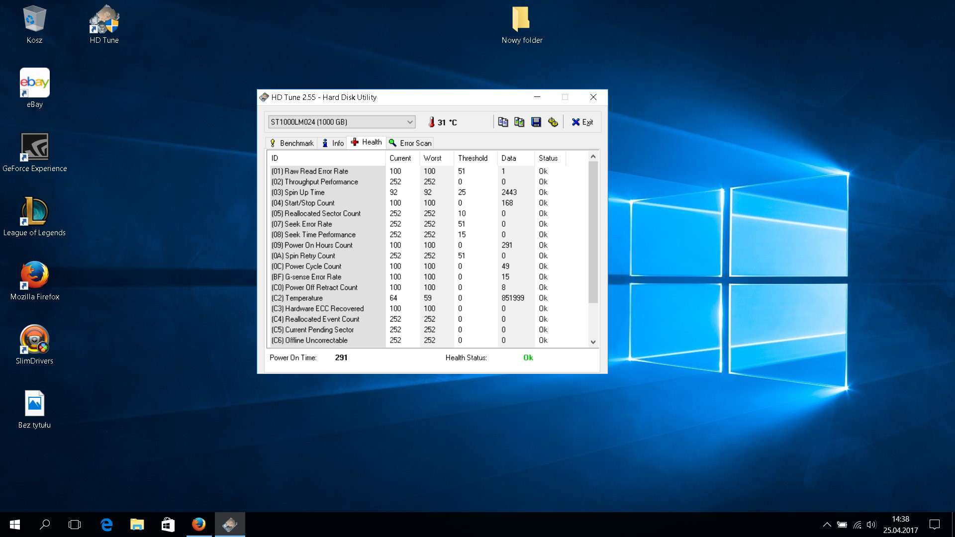

    Provide SMART disk.

    Please

    Is this laptop new?
    Because looking at SMART this disk has 168 inclusions.
    Monitor if parameter (01) does not increase quickly.
    As it should be zero for these disks, like (C8), do a surface scan with sector access times using MHDD =>
    http://www.nirvanowiec.republika.pl/MHDD.iso

    RADU23 wrote:
    Is this laptop new?
    Possible problems with the disk mechanics by looking at (C8).
    The laptop is 1.5 weeks old ...
    So what should I do ?

    Expand the process msconfig svchost - means the host of the service that uses the disk in the task manager. You will see which services can use the disk.
  • #8 16437130
    Aniolek84
    Posts: 35
    sylweksylwina wrote:
    Expand the msconfig process that uses the disk in the task manager. You will see which services can use the disk.
    I don't have such a process enabled

    There was a mistake on my part. Of course, it was a "service host" process that uses a hard disk.

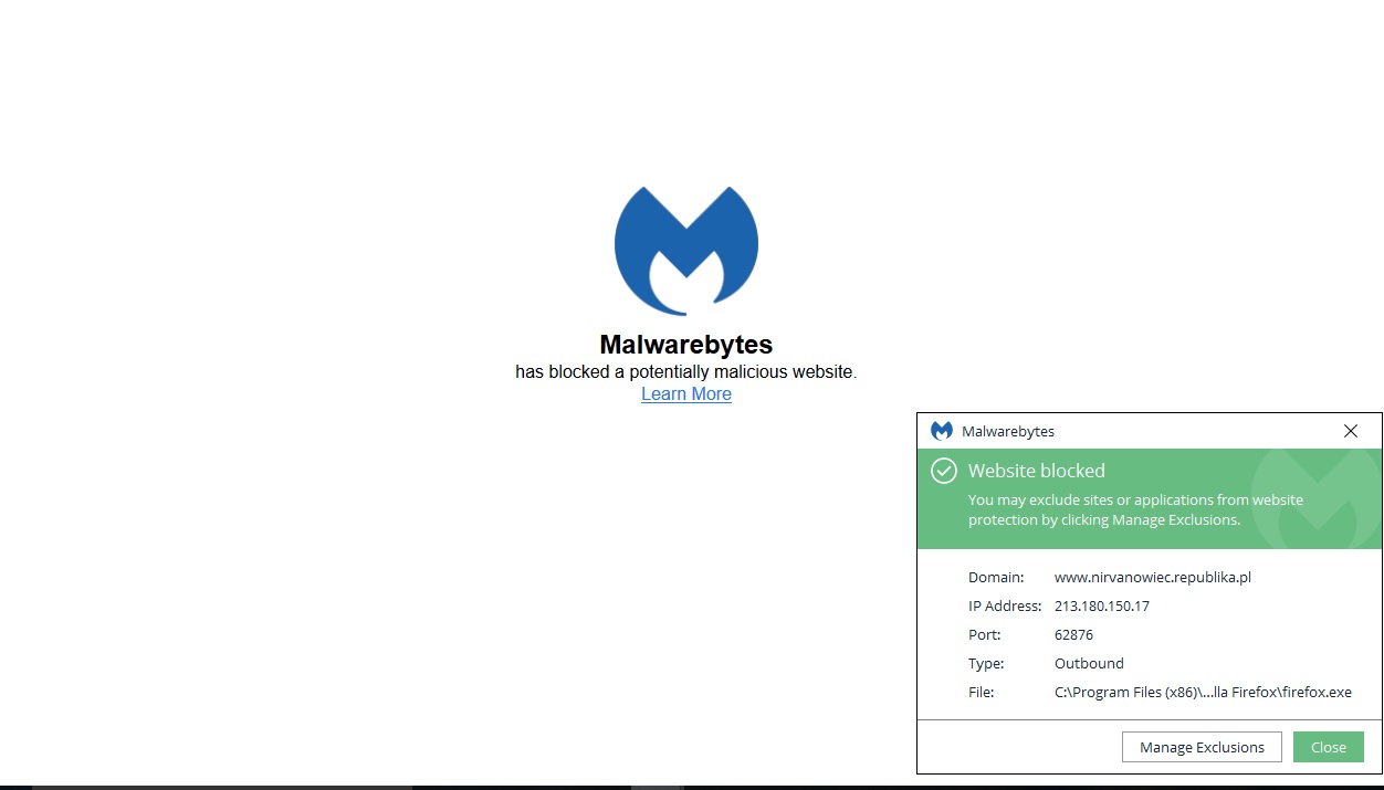

  • #16 16437831
    RADU23
    Posts: 20718
    Help: 2428
    Rate: 1732
    lisek wrote:
    Strange for me, this site is blocked as a potential "pest"
    It's actually weird.
    Because I use this site for a long time, on different computers, different OS, different anti-viruses and none communicated anything similar (both paid and free).
    Alternative => https://www.elektroda.pl/rtvforum/topic868490.html (post No. 2)
