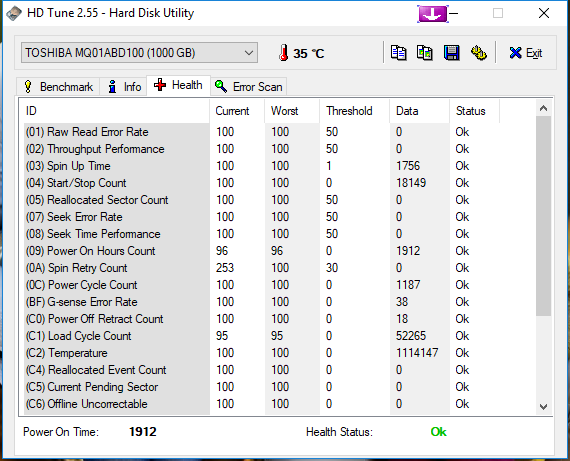

  • #4 17166606
    kingpc
    Posts: 186
    Rate: 7

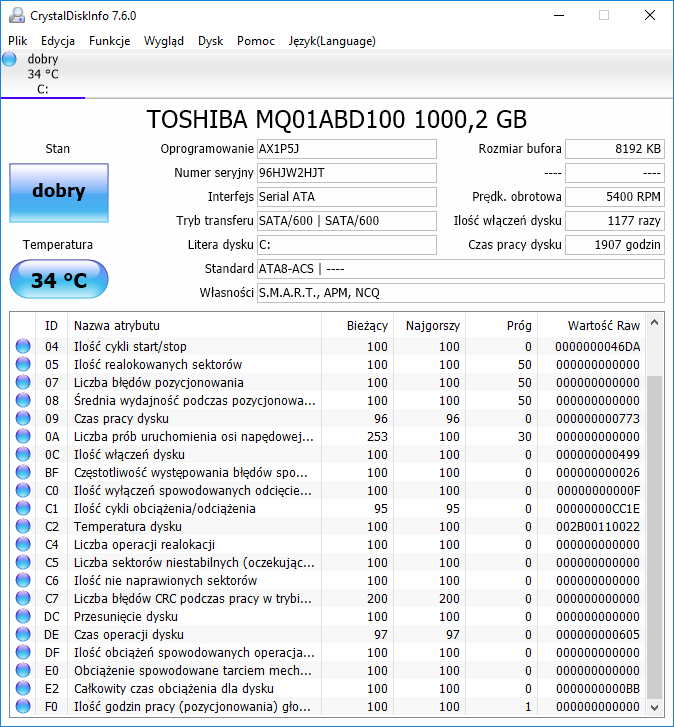

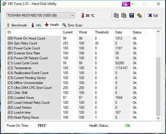

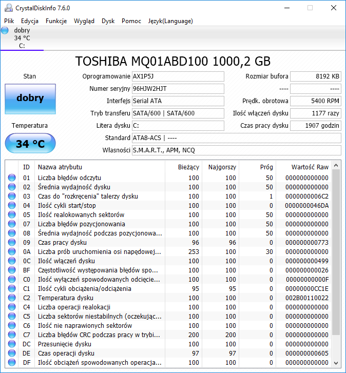

    SMART:
    Laptop Slow Boot & Long Response Time: Troubleshooting Startup Delays, Lag & Freezing Laptop Slow Boot & Long Response Time: Troubleshooting Startup Delays, Lag & Freezing
    I would like to add that it is an Acer ES1-572-30CZ Laptop

  • #7 17167207
    RADU23
    Posts: 20718
    Help: 2428
    Rate: 1732
    The drive is ok. SMART is not communicating anything disturbing.
    You can also take a prophylactic look at the surface scan, as my colleague mentioned @_robert_ B

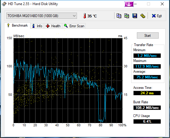

    Remove AVG completely, see what changes.
    Include Benchmark chart with HDtune, with before and after AVG removal, just keep whatever you can in the background.

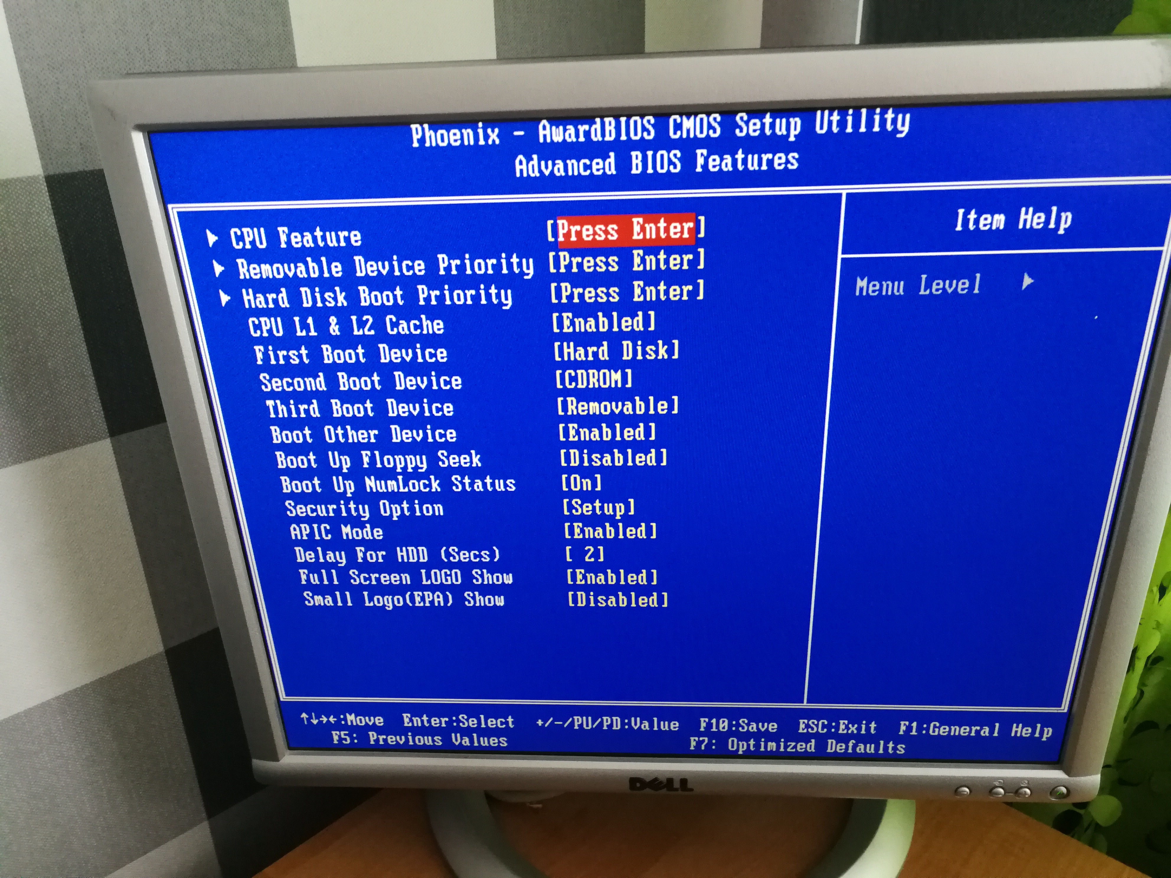

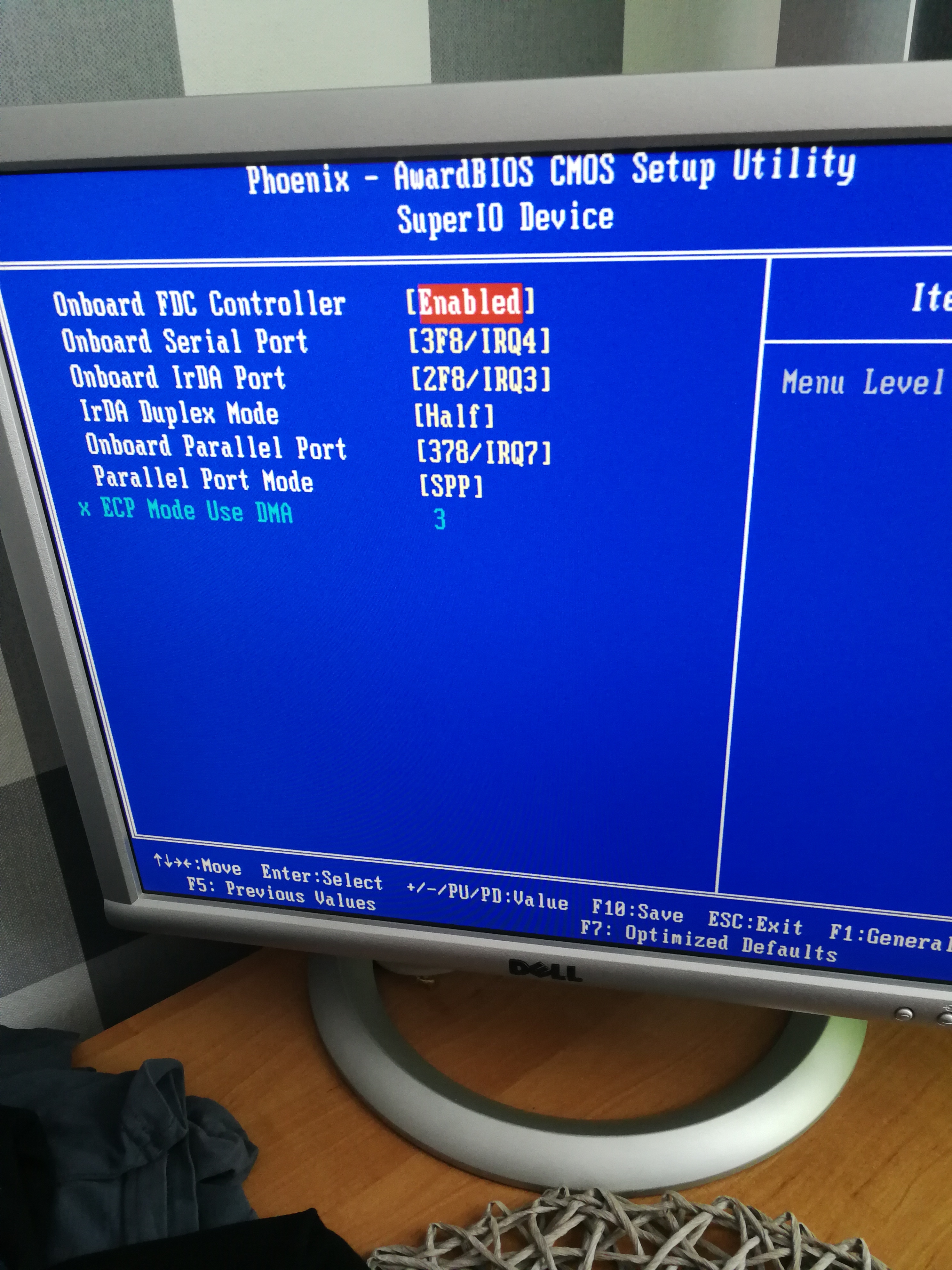

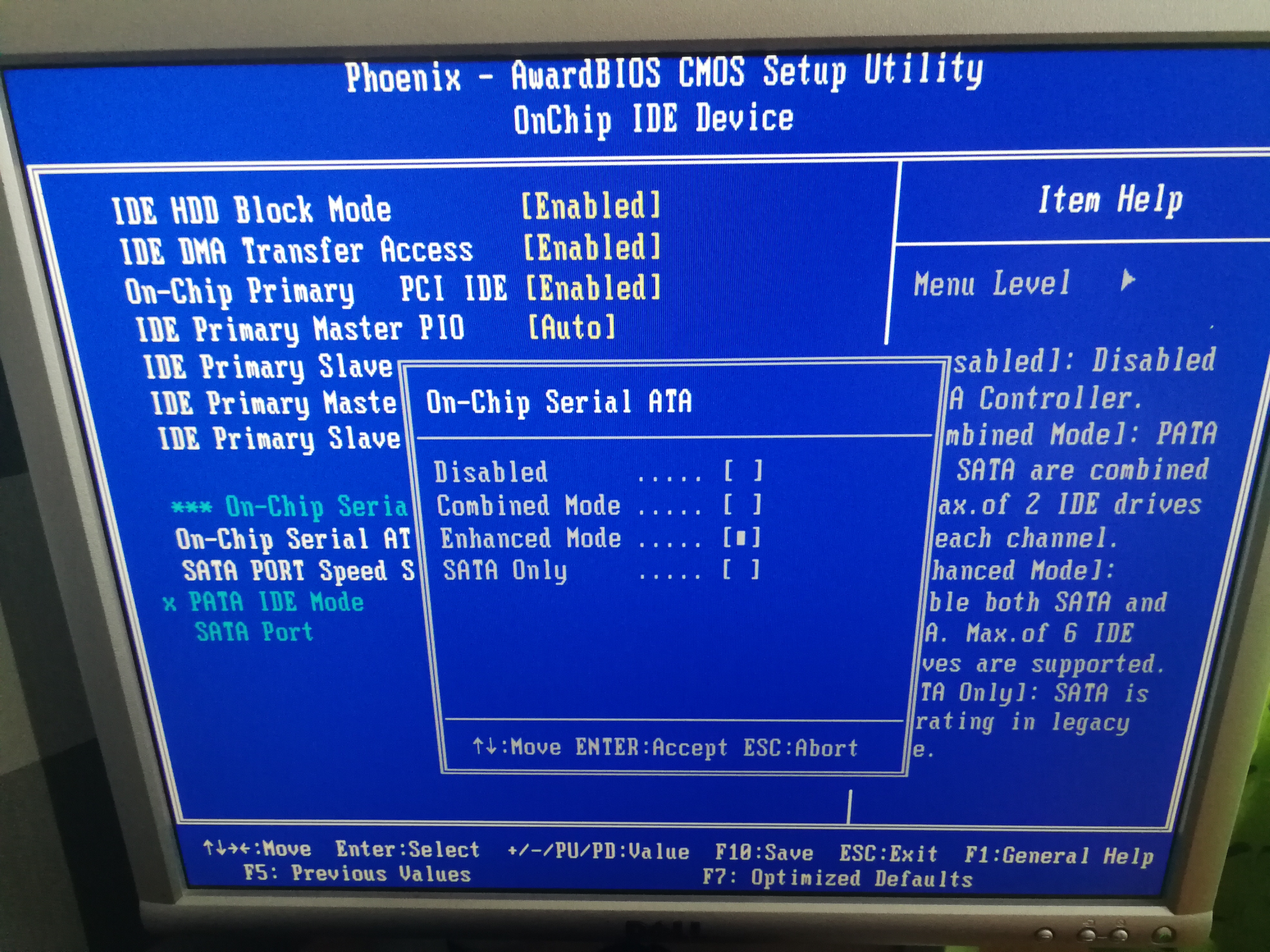

  • #11 17168352
    kingpc
    Posts: 186
    Rate: 7
    I will give HDDTune later.

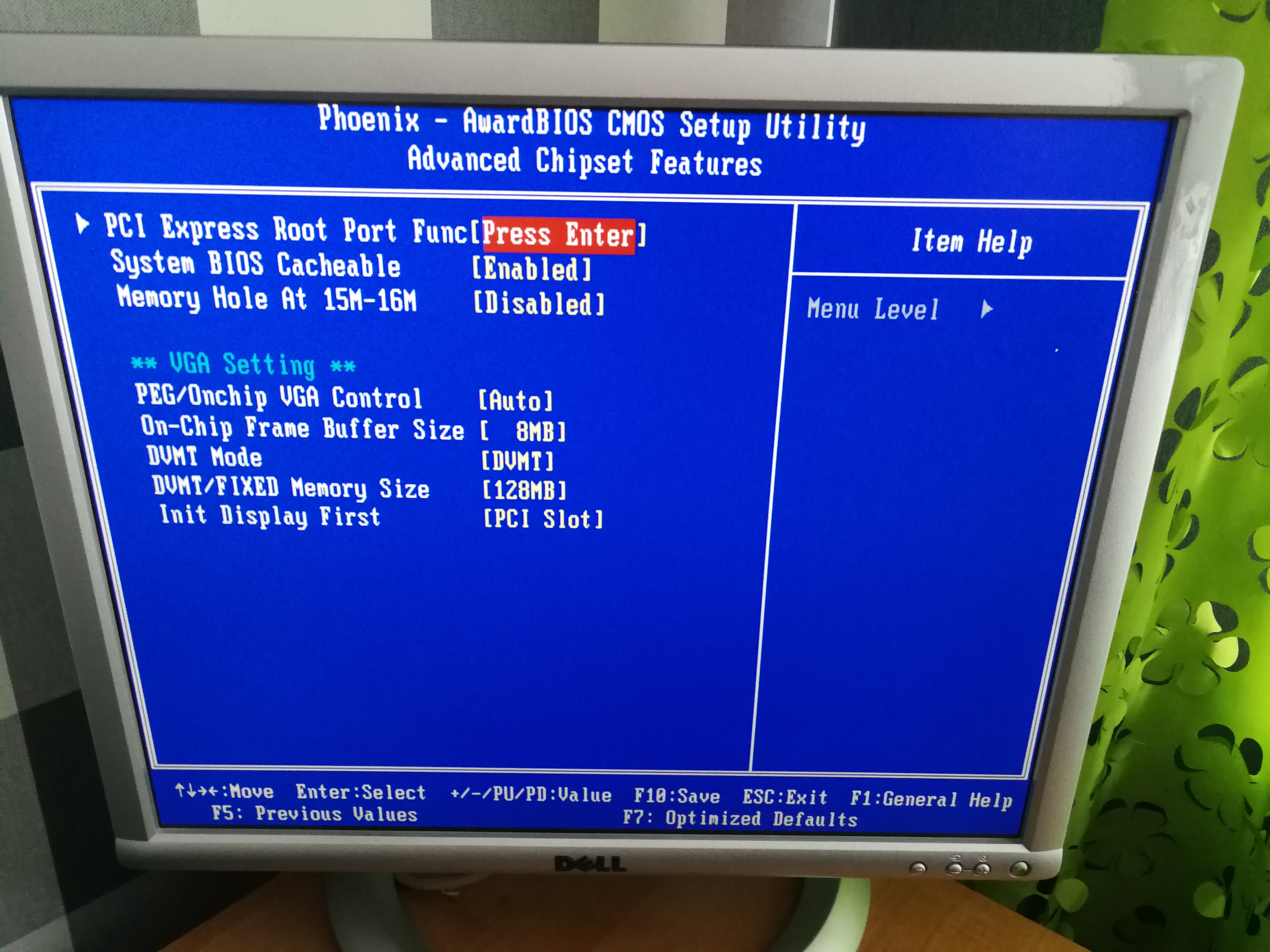

    The BIOS looks like this:
    Laptop Slow Boot & Long Response Time: Troubleshooting Startup Delays, Lag & Freezing Laptop Slow Boot & Long Response Time: Troubleshooting Startup Delays, Lag & Freezing Laptop Slow Boot & Long Response Time: Troubleshooting Startup Delays, Lag & Freezing Laptop Slow Boot & Long Response Time: Troubleshooting Startup Delays, Lag & Freezing Laptop Slow Boot & Long Response Time: Troubleshooting Startup Delays, Lag & Freezing Laptop Slow Boot & Long Response Time: Troubleshooting Startup Delays, Lag & Freezing Laptop Slow Boot & Long Response Time: Troubleshooting Startup Delays, Lag & Freezing Laptop Slow Boot & Long Response Time: Troubleshooting Startup Delays, Lag & Freezing Laptop Slow Boot & Long Response Time: Troubleshooting Startup Delays, Lag & Freezing Laptop Slow Boot & Long Response Time: Troubleshooting Startup Delays, Lag & Freezing Laptop Slow Boot & Long Response Time: Troubleshooting Startup Delays, Lag & Freezing
  • #12 17168366
    safbot1st
    Posts: 21951
    Help: 2719
    Rate: 1585
    Screen # 6. On-chip serial ATA - switch, save CMOS. If MHDD doesn't see the disk, it can't be helped. The HDD can then be checked in the MHDD on another PC.

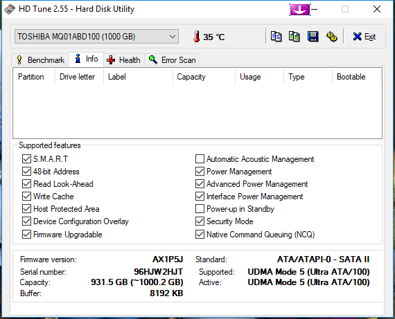

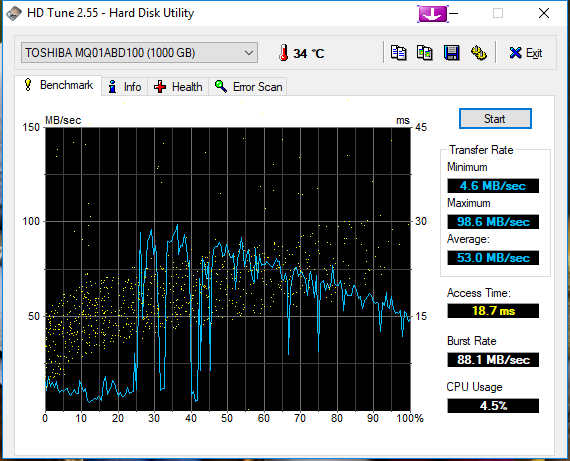

    HD Tune z Antywirusem:
  • #14 17169325
    safbot1st
    Posts: 21951
    Help: 2719
    Rate: 1585
    kingpc wrote:
    HD Tune with Antivirus:
    Ugly. And without?
    No more screenshots needed - we have already seen SMART.
  • #15 17170773
    kingpc
    Posts: 186
    Rate: 7
    After removing the antivirus:
  • #16 17170805
    safbot1st
    Posts: 21951
    Help: 2719
    Rate: 1585

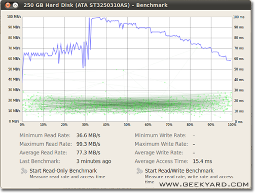

    Fire up Ubuntu from a bootable USB pen. There you have the HDD test - do it.
    I do not like this graph - either a damaged disk or something has entered the system.

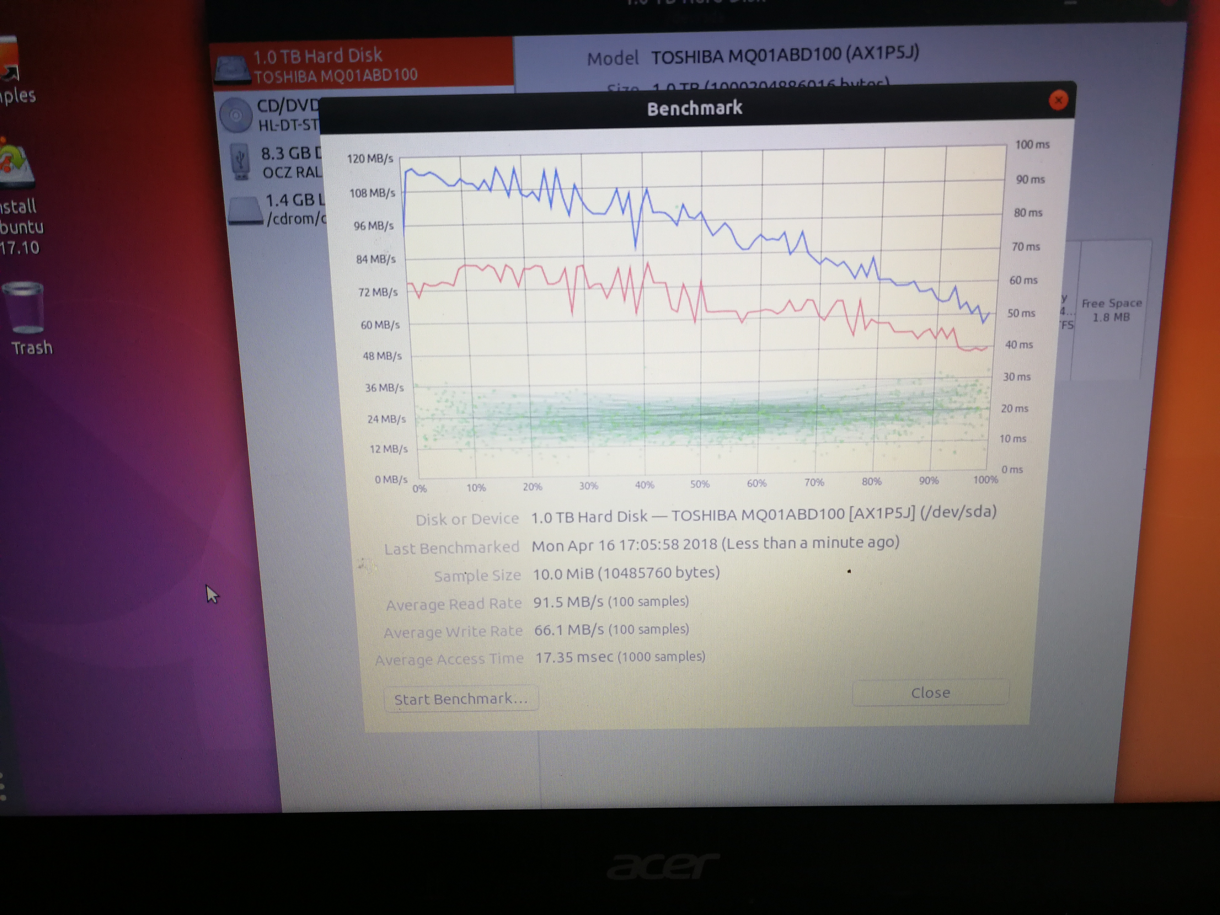

    In Ubuntu it looks like this:
  • #18 17170992
    safbot1st
    Posts: 21951
    Help: 2719
    Rate: 1585
    According to disk damaged. Let others comment, but since you booted the system 100% from a USB pen, there should be no such "teeth".
    There should be flat "steps" like in my screenshot at the end (non-sterile graph).
    Perhaps the scan in MHDD will confirm it, maybe not ...
    Ubuntu itself (eg internet) with USB pen works flawlessly and without jams?
    Of course, much slower, but more stable?

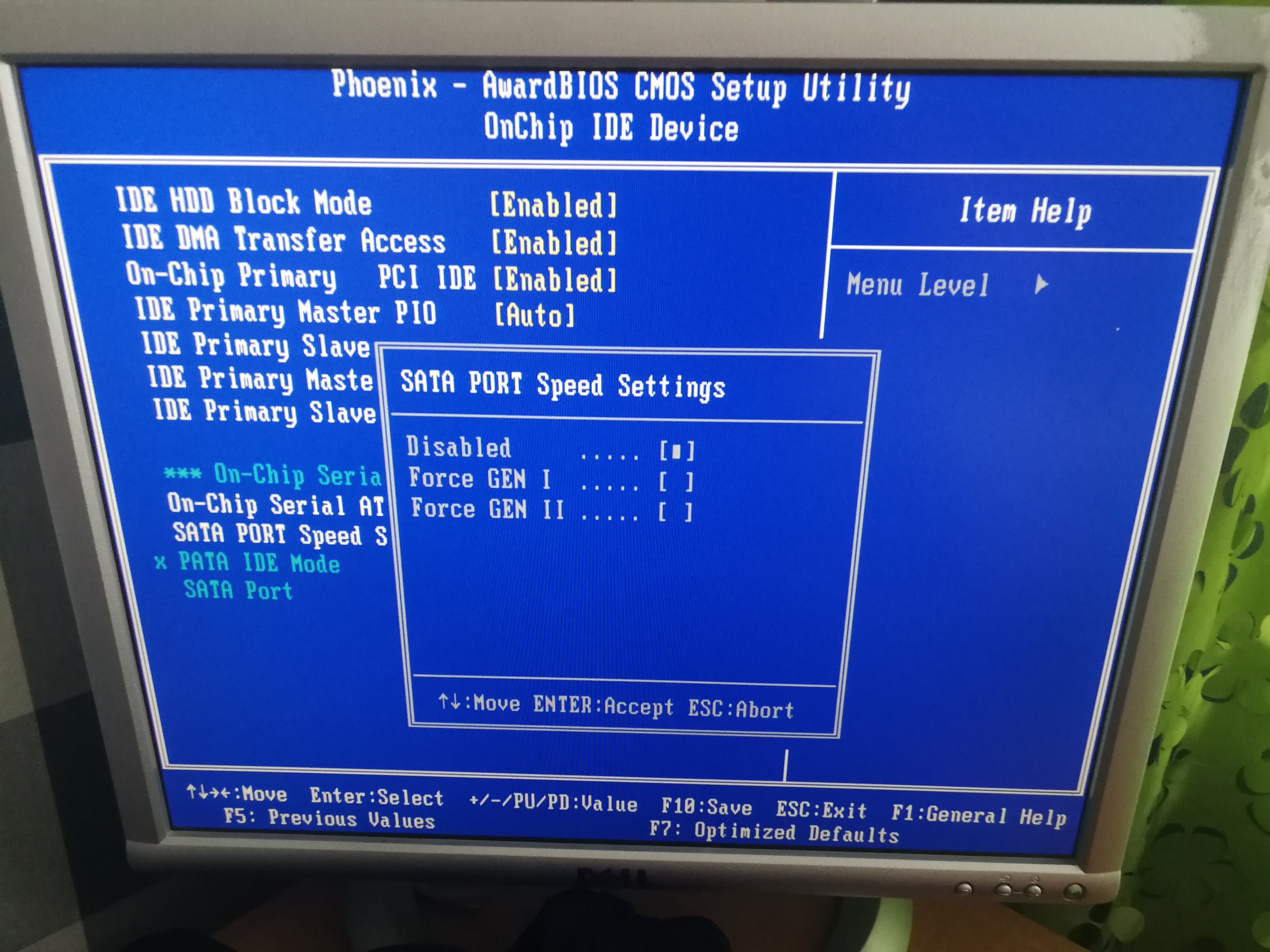

  • #19 17171289
    Robert B
    Posts: 22594
    Help: 2027
    Rate: 1412

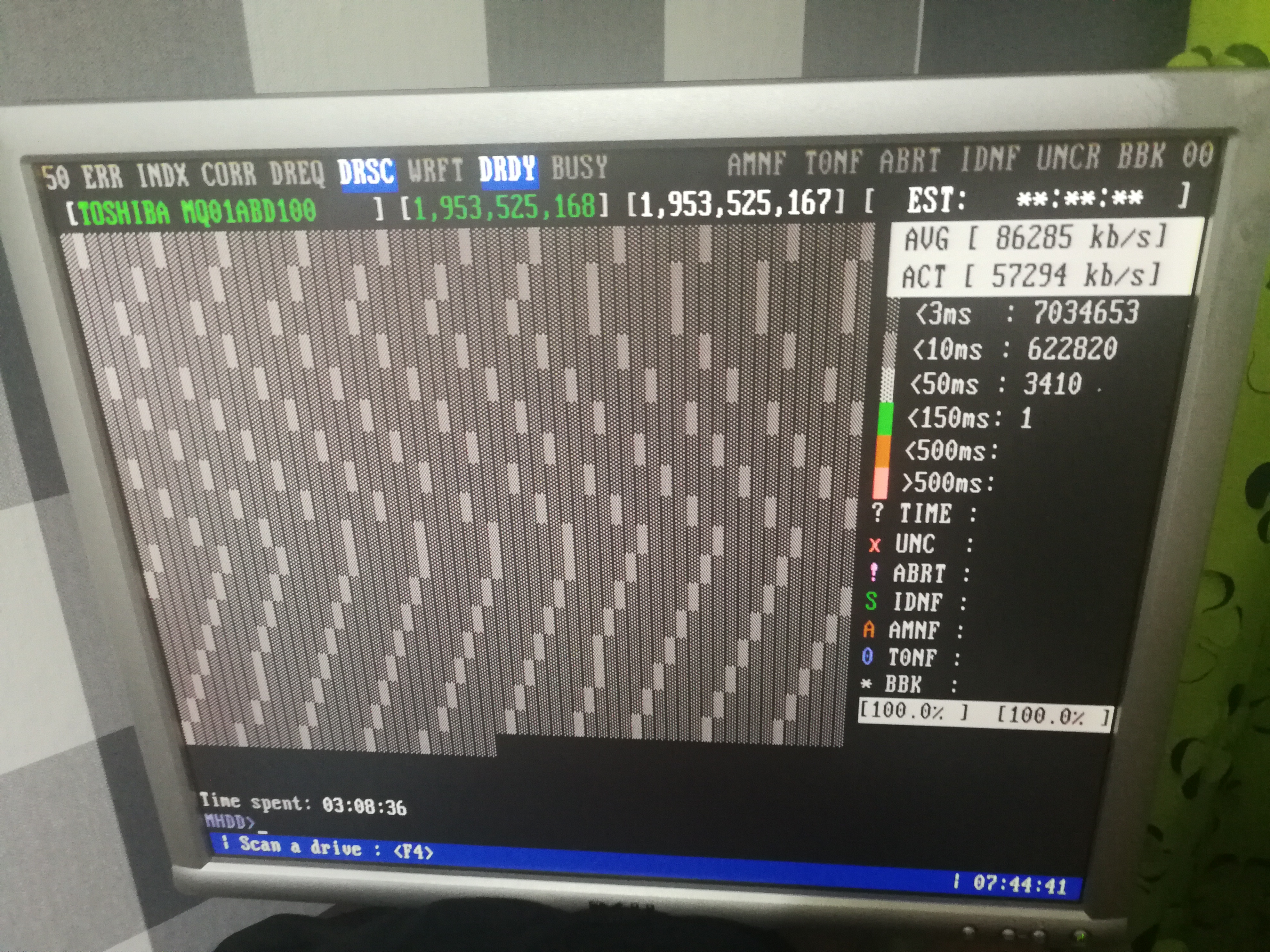

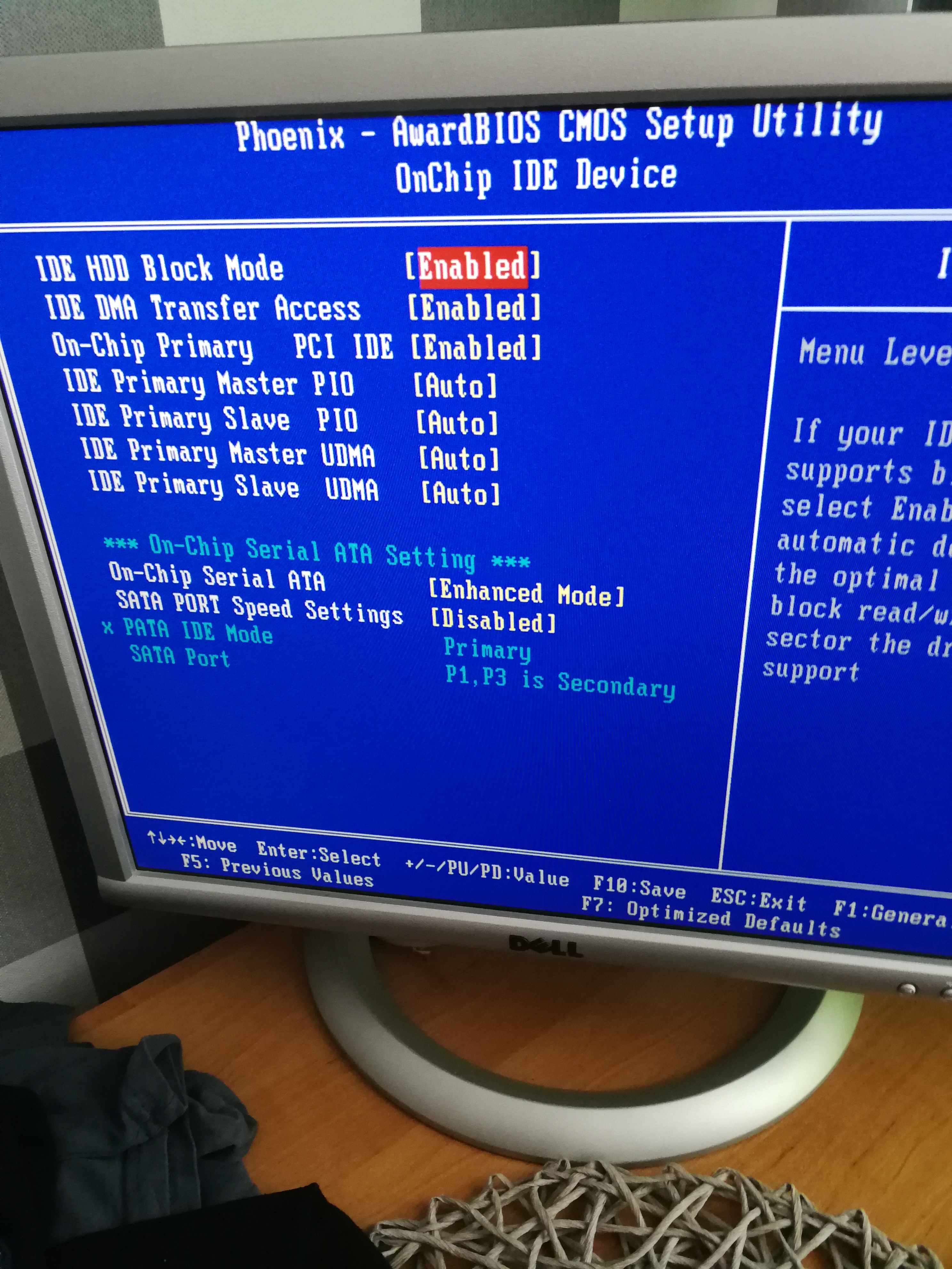

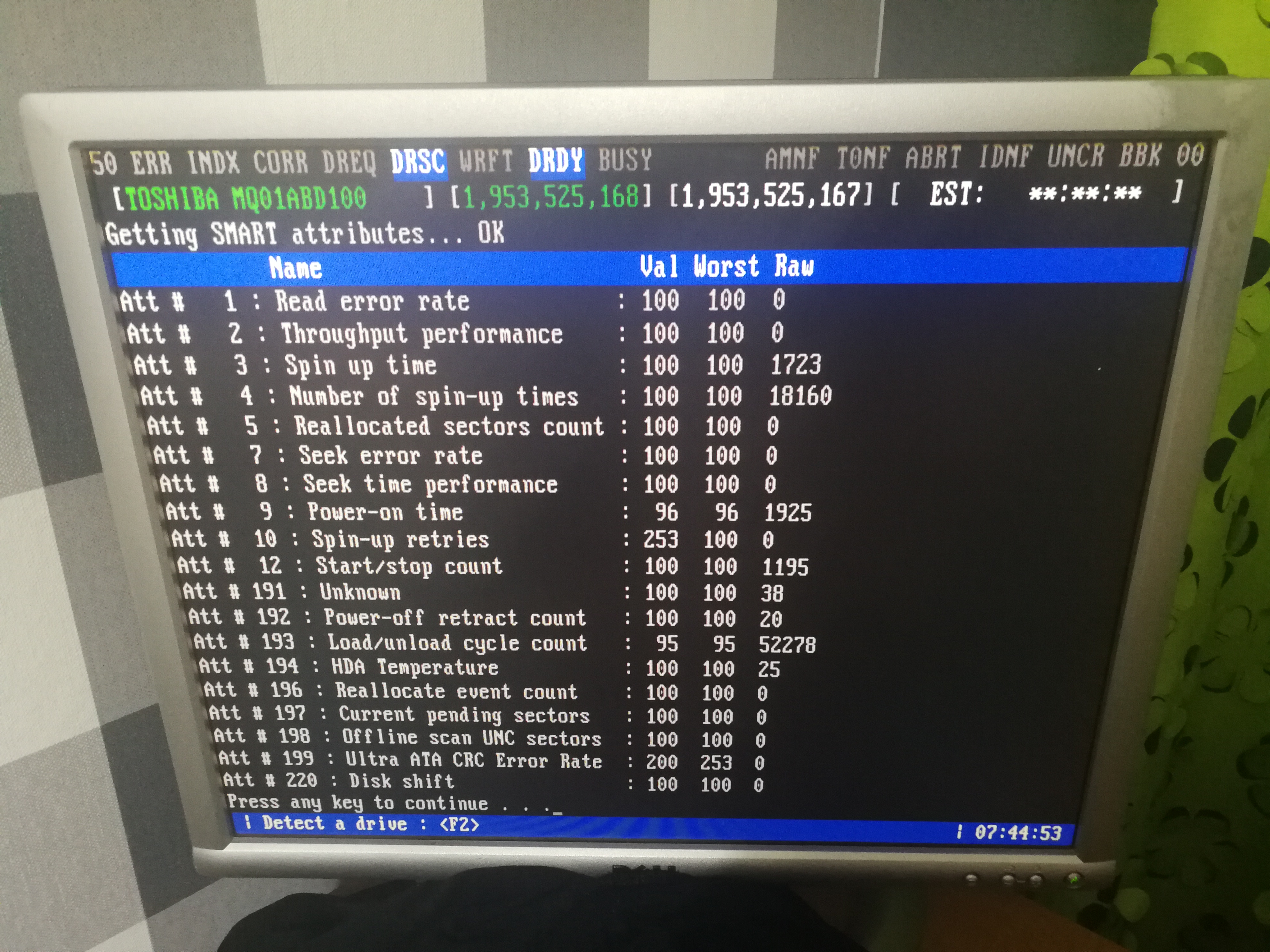

    For MHDD, first of all, switch the disk to the first channel of the controller and set booting from Removable first and show the settings:
    On-chip SATA
    SATA port speed
  • #20 17172089
    kingpc
    Posts: 186
    Rate: 7
    MHDD
  • #21 17172096
    Robert B
    Posts: 22594
    Help: 2027
    Rate: 1412

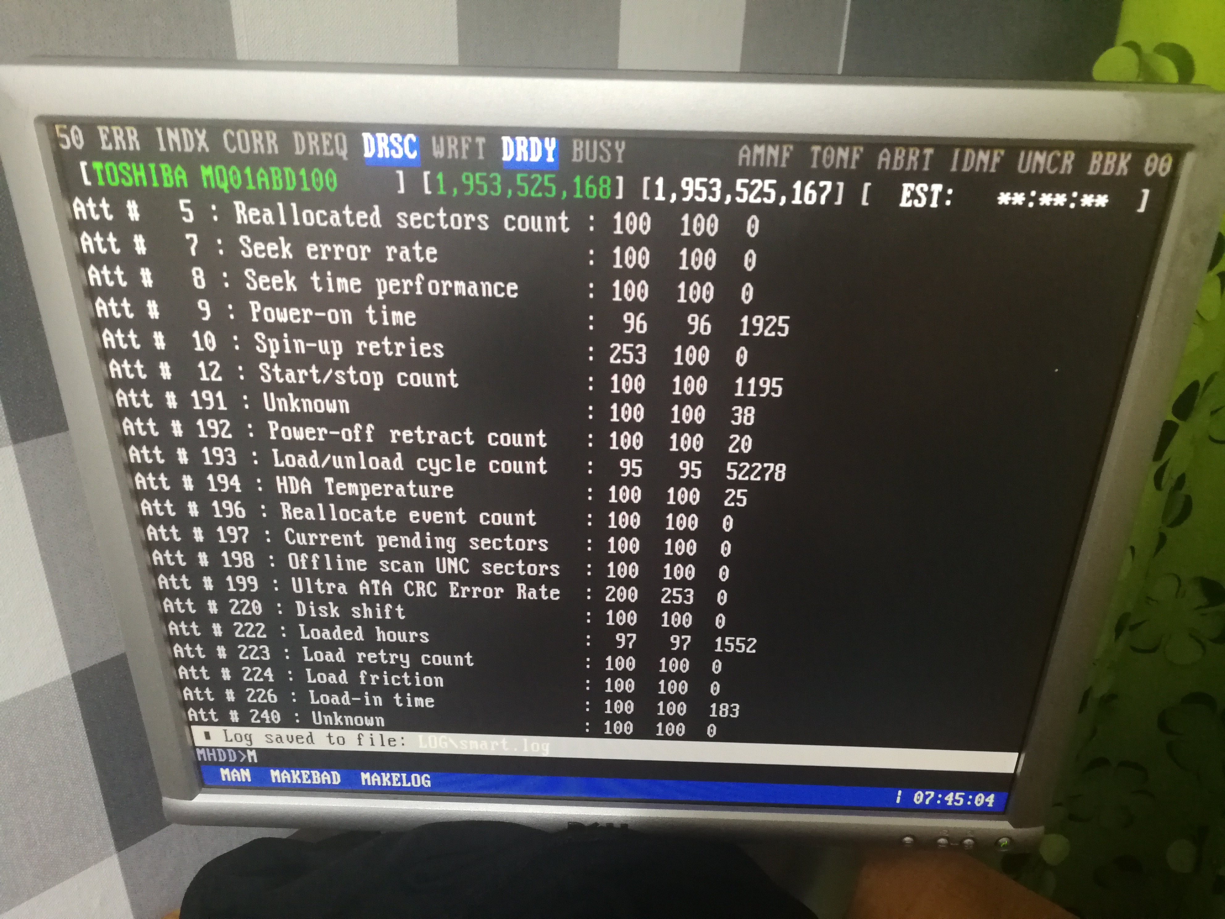

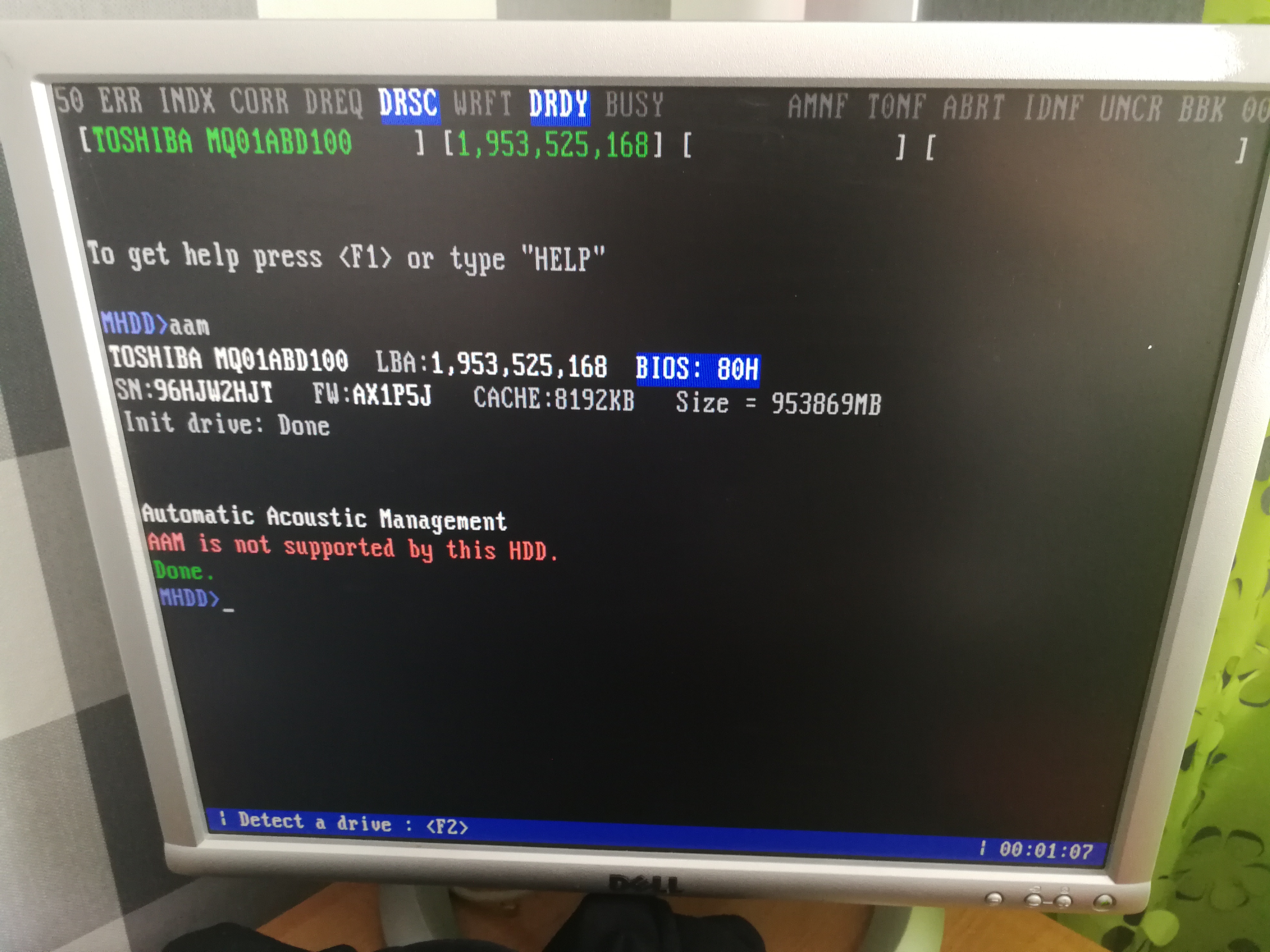

    The scan is very nice and there is nothing to complain about. Didn't even increase 191 (BF) :)
    Check in MHDD (and show the screen) how the disk responds to the command:
    aam
    If the hardware is OK, we will look for the reason in the software.

    Coming aam:

    @ TalkMiKaźmirz Dear colleague, the service starts with checking the hardware and then starts the software. Never the other way around, because there is nothing worse than repairing the software on unchecked / malfunctioning hardware and I sincerely advise you to get it right.
    kingpc wrote:
    Aam command:
    If it doesn't, don't worry about it.

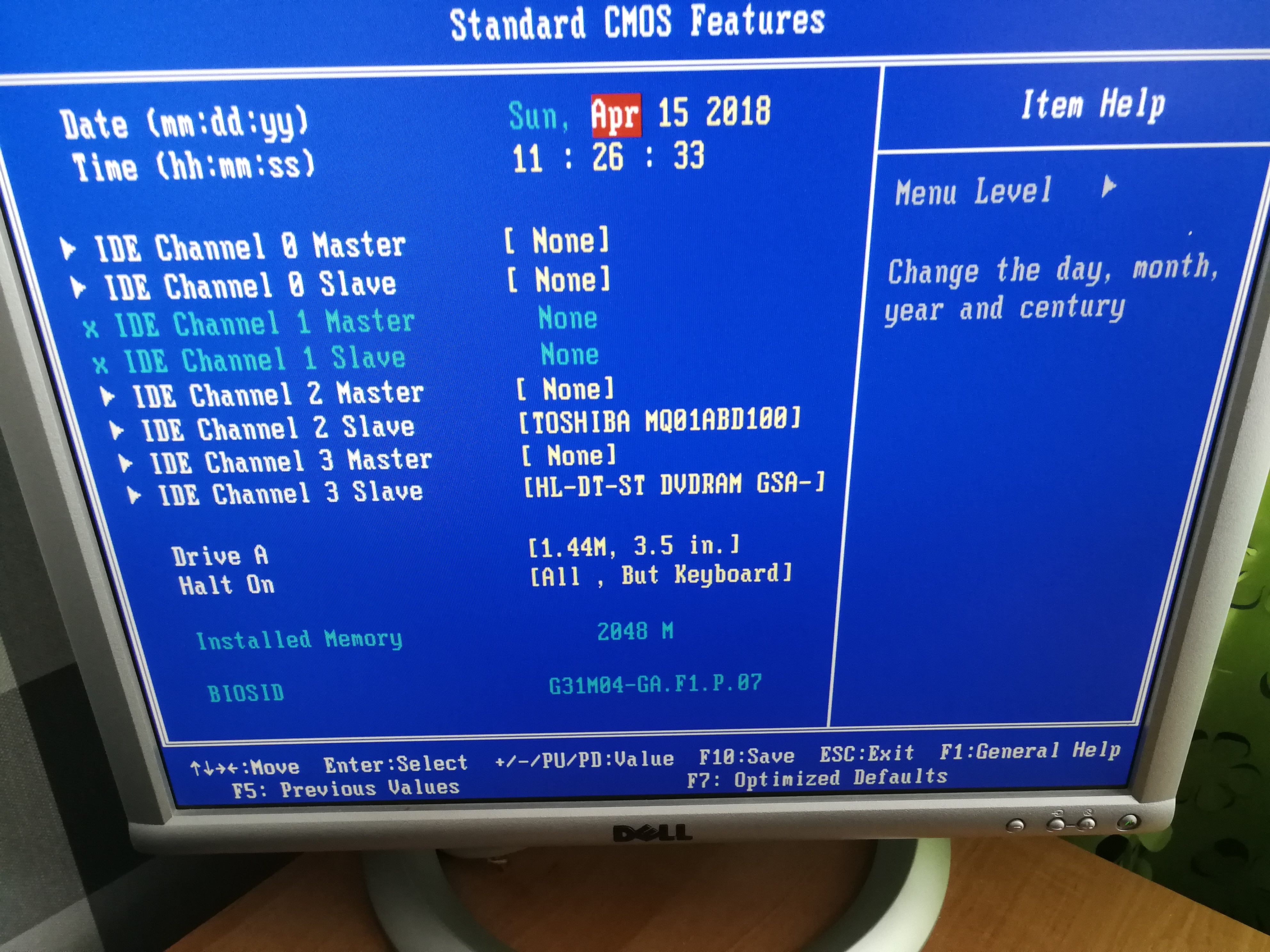

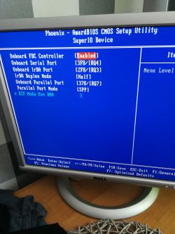

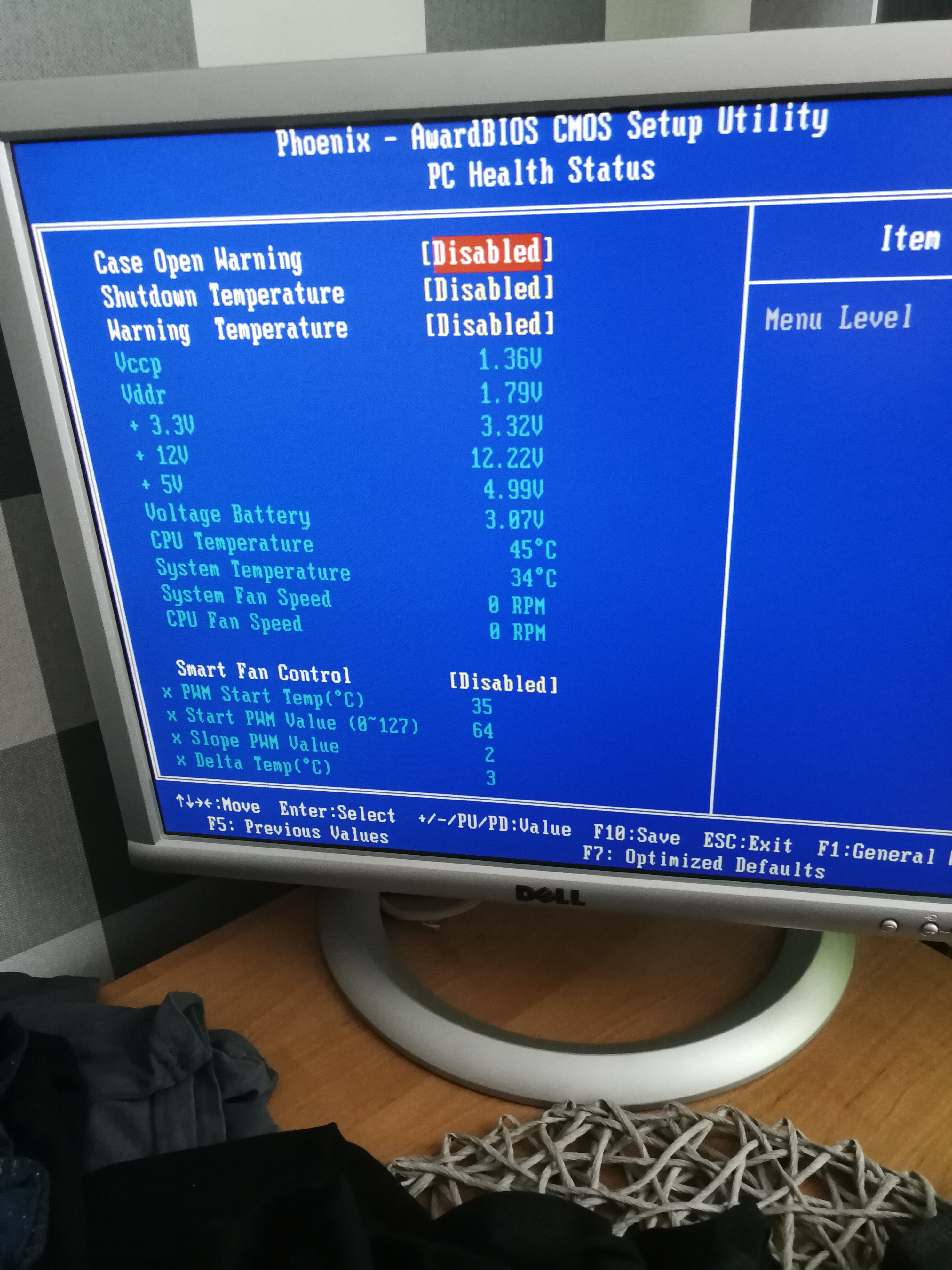

  • #25 17172866
    kingpc
    Posts: 186
    Rate: 7
    Robert, I'm sending you the screenshots you asked for. Only they are from the PC on which this drive is tested in MHDD.
  • Hardware should be checked before software repairs

    #27 17173957
    Robert B
    Posts: 22594
    Help: 2027
    Rate: 1412

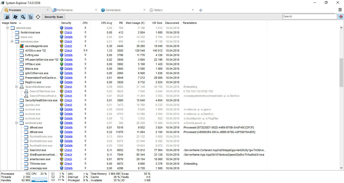

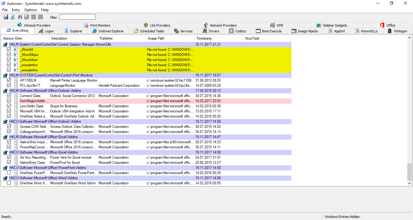

    kingpc wrote:
    I'm sending the screenshots
    Leave the on-chip SATA as is and set the SATA port to Gen II.
    It does not matter anyway, because the drive is supposed to work in a laptop :)
    Once the hardware has been checked, put it into a laptop and we will deal with this "long laptop thinking" :D

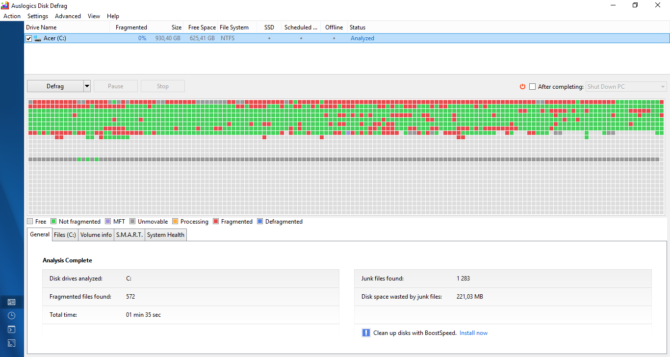

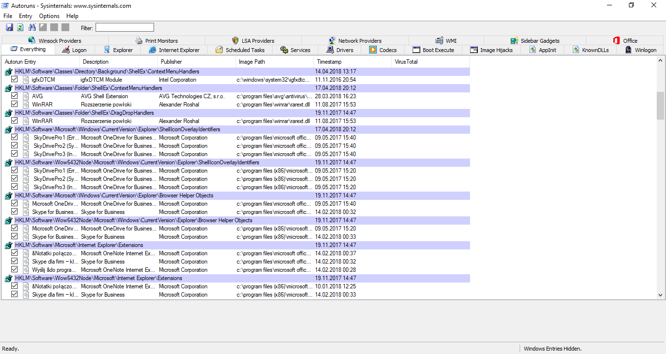

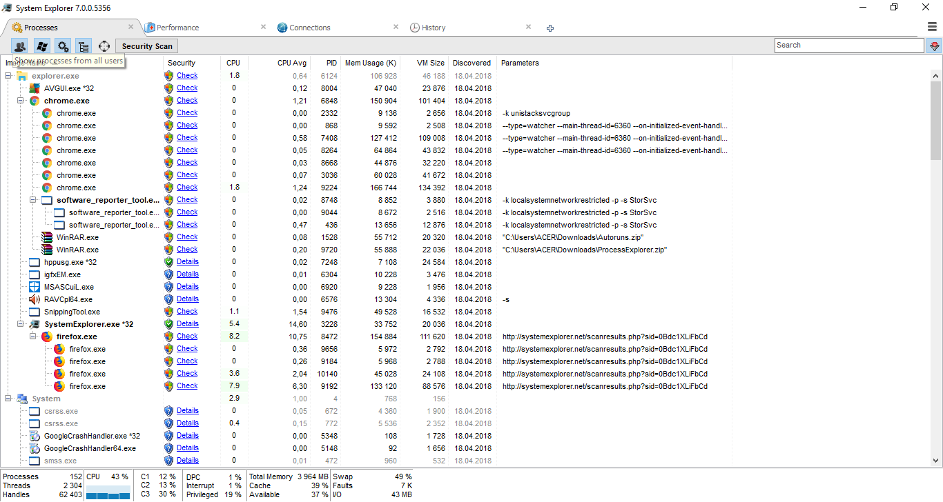

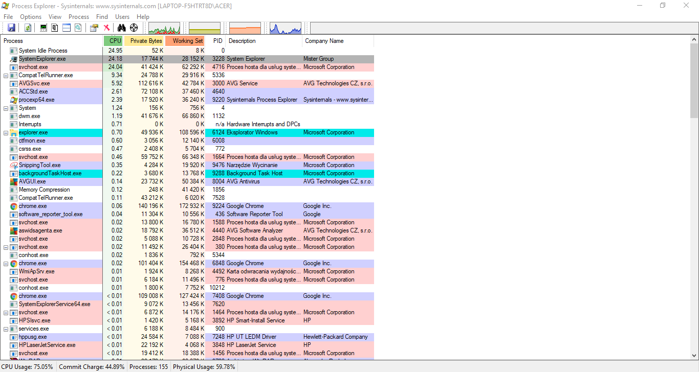

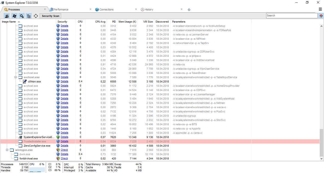

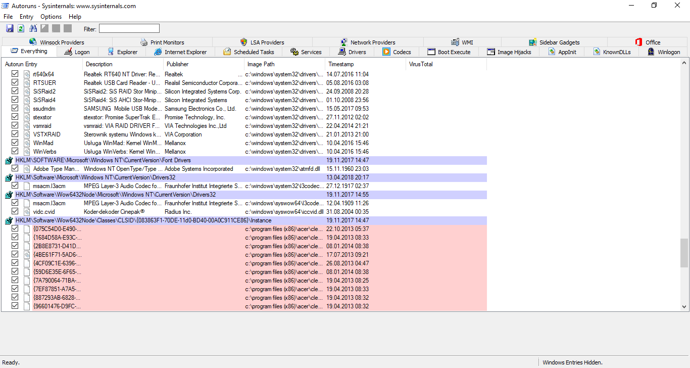

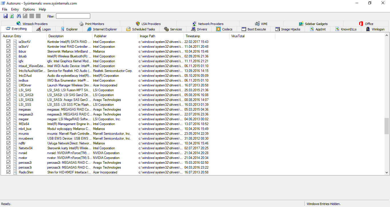

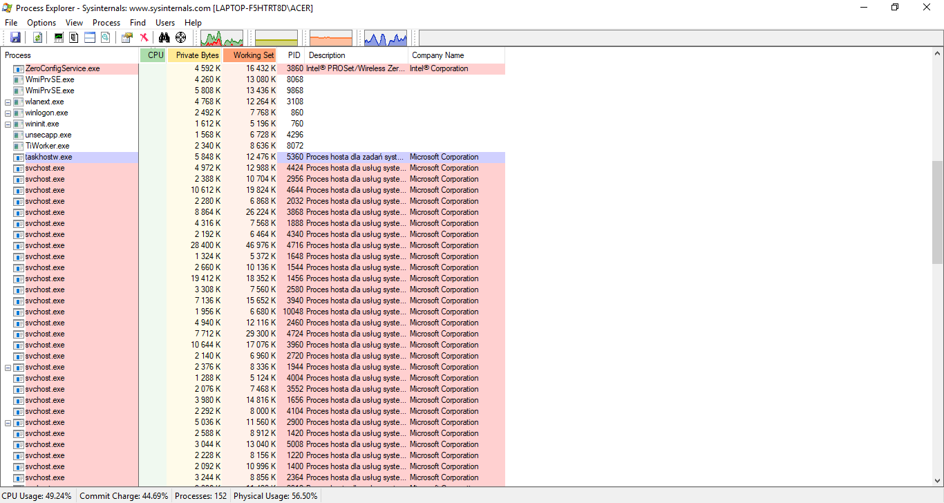

    First, show screenshots from:
    https://docs.microsoft.com/en-us/sysinternals/downloads/autoruns
    http://systemexplorer.net/pl
    https://docs.microsoft.com/en-us/sysinternals/downloads/process-explorer
    Also show the disk usage, eg SC-Diskinfo (in the attachment) or other newer program.
    Also show disk fragmentation:
    https://www.auslogics.com/en/software/disk-defrag/
    • SC-DiskInfo.zip (936.37 KB) You must be logged in to download this attachment.

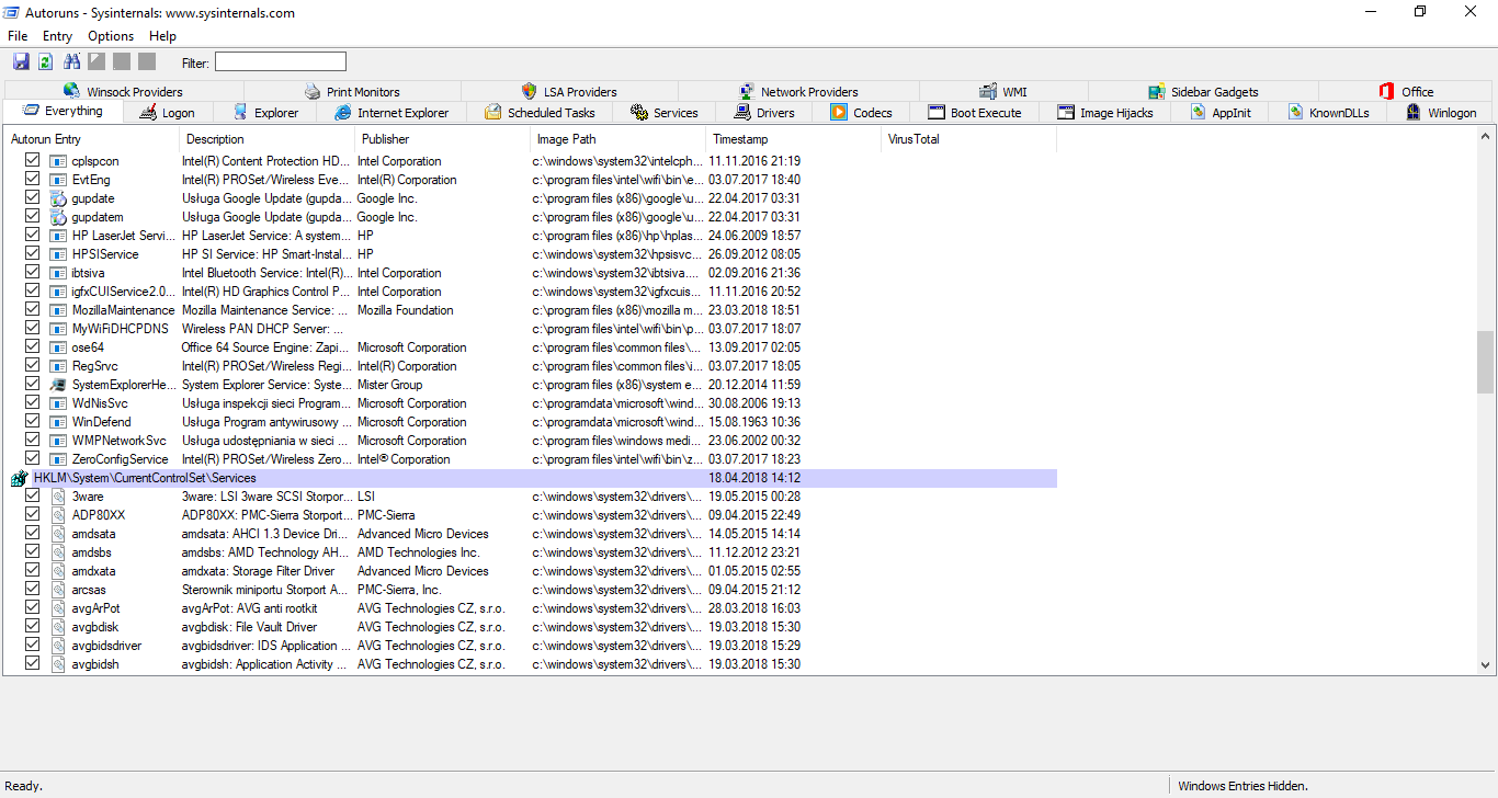

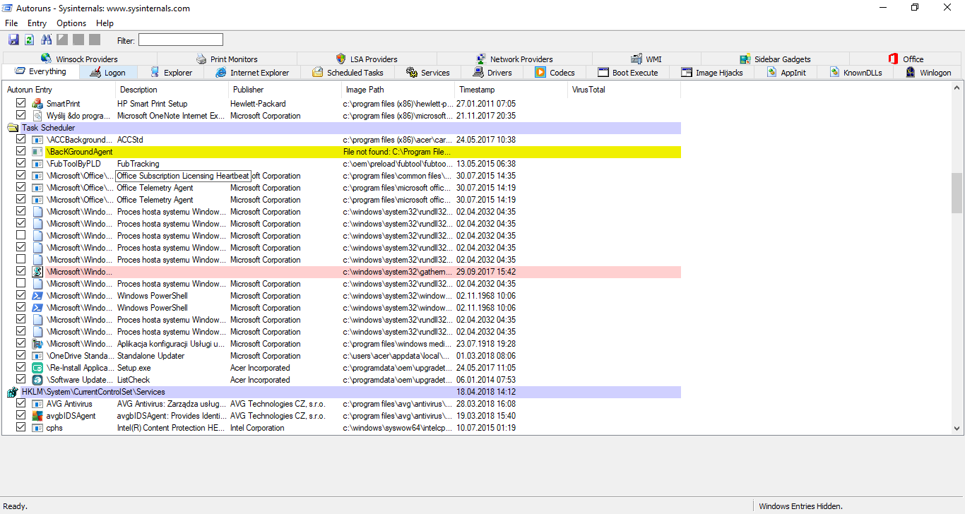

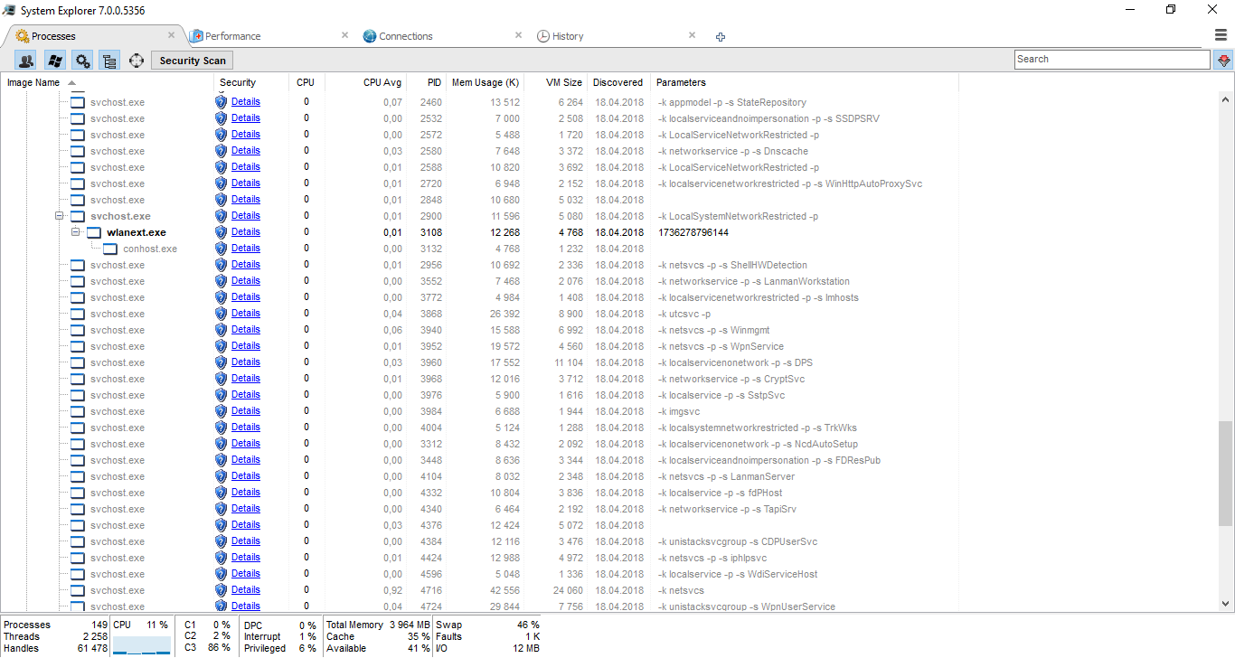

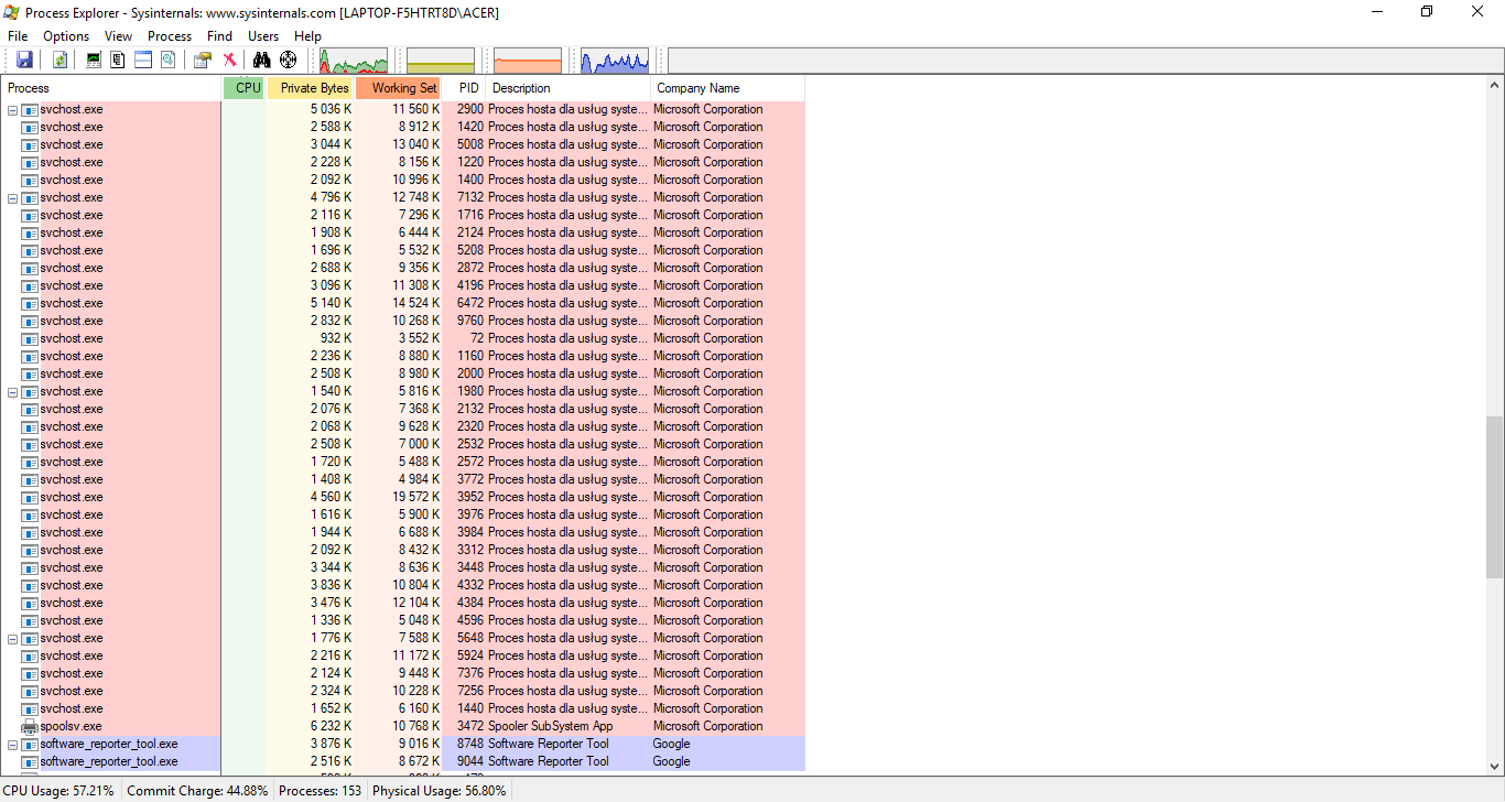

  • Autoruns, Process Explorer and defragmentation checks

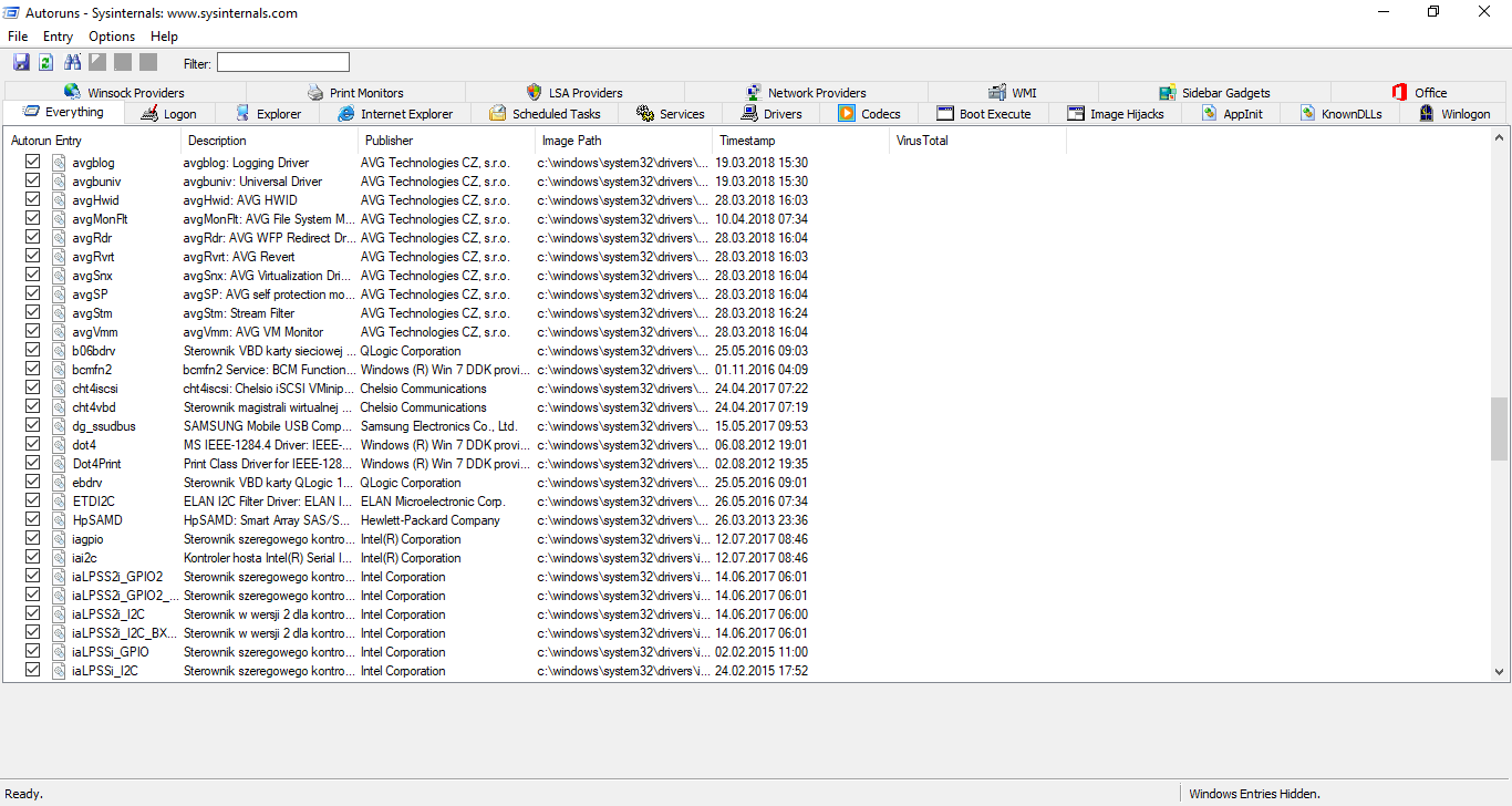

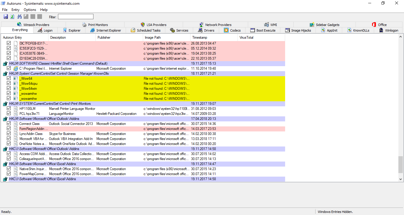

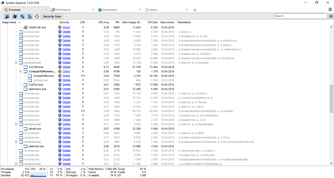

    #28 17174738
    kingpc
    Posts: 186
    Rate: 7

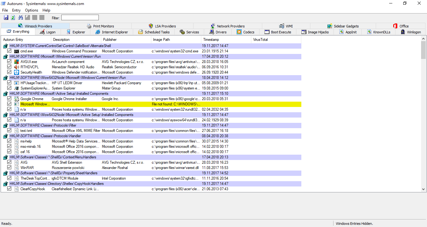

    Autoruns:

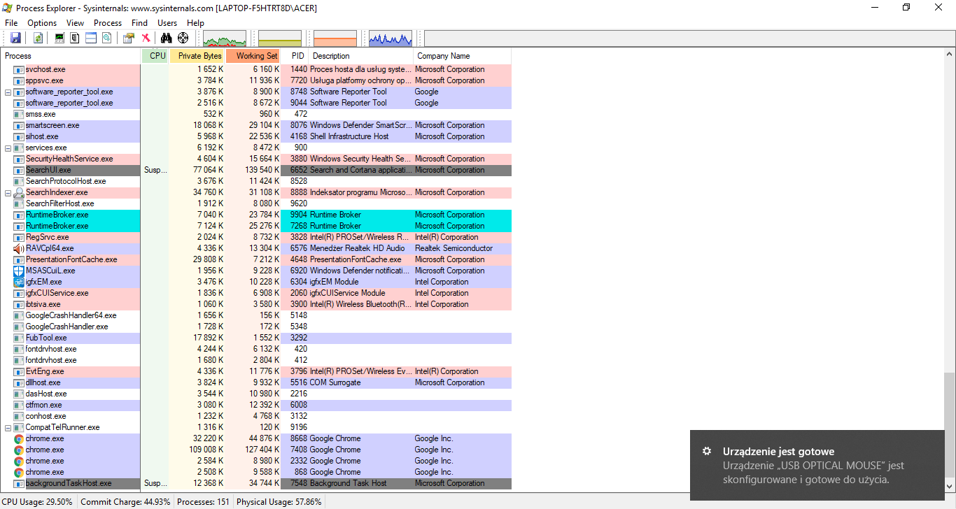

    Process Explorer:
    System Explorer"
    Defragmentacja

    Robert B
    Posts: 22594
    Help: 2027
    Rate: 1412
    Fast, because it was getting late :)
    1. AVG, Windows Defender and all Intel Protection Technology. Did you install that much on purpose? Too much, and not only that they disturb each other, they silt the system.
    2. Various bells and whistles of Acer. Do you need all of them?
    3. Software Reporter Tool. Unnecessary and muddy.
    https://www.download.net.pl/co-to-jest-softwa...-jak-wylaczyc-ten-proces-w-windowsie/n/11410/
    Also, check the Scheduled tasks folder in the Control Panel, because there are often various silts there.
    Check installed programs (including Hidden and System tabs):
    https://www.crystalidea.com/uninstall-tool/uninstall-wizard
    The 30-day free version should be enough to get rid of all kinds of crap.
    Do the defragmentation at the very end, after removing unnecessary programs.

What does the HD Tune benchmark tell me?
A flat descending line means consistent throughput; saw-tooth "teeth" signal random stalls, often from background scanning or disk errors [Elektroda, safbot1st, post #17170805] Average transfer below 70 MB/s on a 5400 rpm HDD suggests either fragmentation or heavy software load [Samsung, 2021].
When should I defragment the disk?
Defragment after removing unwanted programs, because new free space rearranges files. Auslogics Disk Defrag showed 13 % fragmentation on the user’s drive [Elektroda, kingpc, post #17174738]; bringing it below 5 % typically recovers up to 15 % read speed on HDDs [iFixit, 2023]. Never defragment SSDs.
My SMART is clean but the laptop still freezes. Next steps?
Clean SMART means hardware likely fine. Move to software: 1) single antivirus, 2) remove OEM utilities, 3) update drivers, 4) check for malware with Windows Malicious Software Removal Tool. Edge case: faulty memory can mimic disk stalls—run MemTest86 overnight if freezes persist [PassMark, 2022].

3-Step: Capture SMART with CrystalDiskInfo
  1. Download portable CrystalDiskInfo and run as Administrator.
  2. Press Ctrl+S to save a screenshot; ensure all attributes are visible [Elektroda, RADU23, post #17166451]
  3. Upload the PNG to the forum for analysis. This quick share speeds diagnosis.
What if MHDD shows sectors slower than 500 ms?
Anything ≥500 ms is a timeout risk. Backup immediately, then run MHDD’s Erase-with-Reconnect; if slow blocks persist, replace the drive. Drives with >50 slow sectors fail within 90 days in 87 % of cases [Backblaze, 2023].
