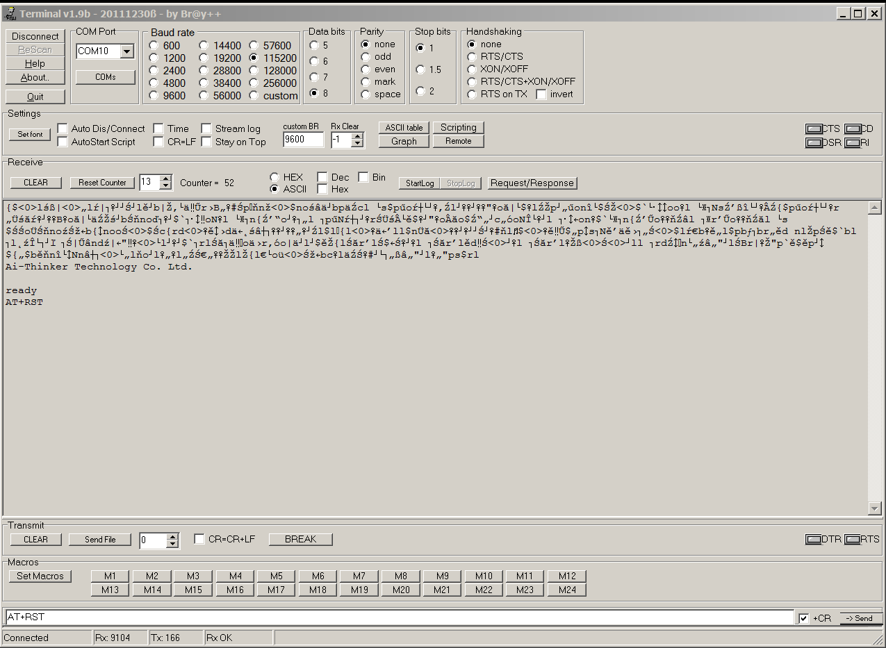

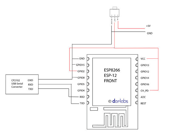

    I have connected the ESP-12-E according to the following drawing
    ESP8266 ESP-12-E: No response to commands, only echo in terminal .
    I have connected from the terminal successfully
    but the circuit does not respond to my queries, it only gets an echo as seen above.
    Has anyone had a similar problem?

    The command must end with CR+LF.

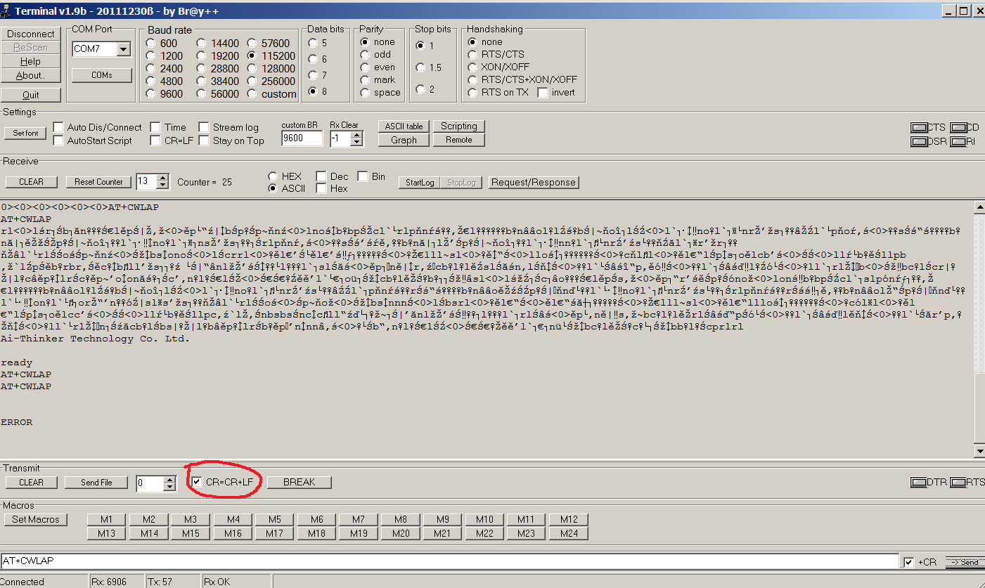

    the CR box is ticked in the terminal.
    Otherwise it does not work for me
    Added after 3 [minutes]:
    actually, I haven't ticked one box like this yet
    Thanks for the help, so I would try to upload another soft to ESP12
