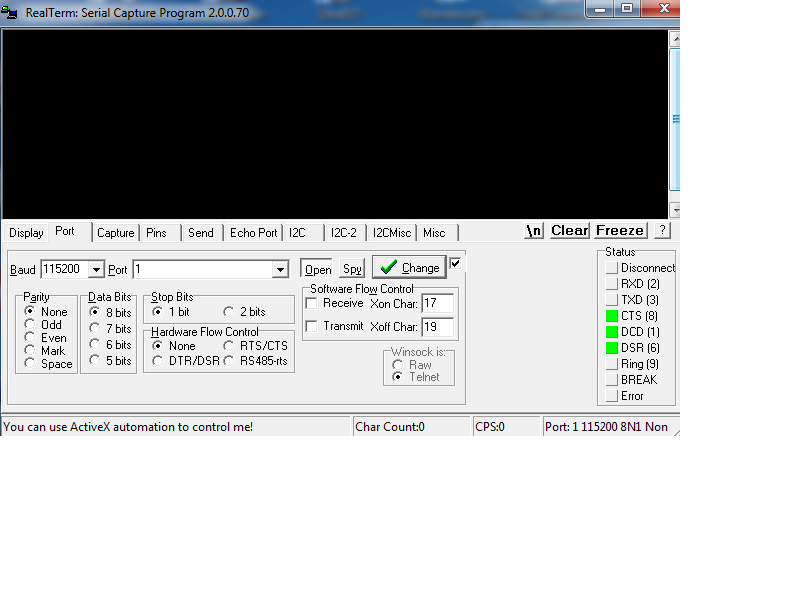

    Software upload addresses and ESP8266 esp-12 E unresponsive on AT Software upload addresses and ESP8266 esp-12 E unresponsive on AT .
    terminal 115200
  • #8 18179397
  • #9 18179401
    robo1973
    Posts: 679
    Rate: 59
    you have above Realterm

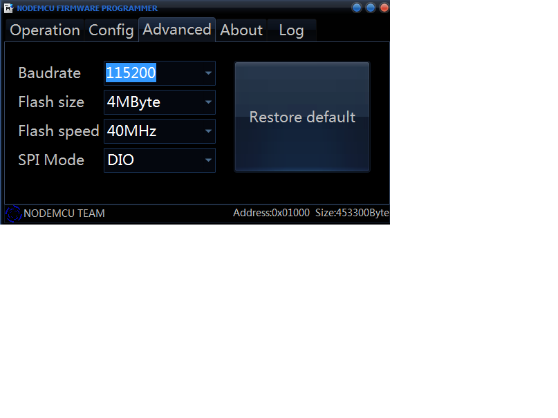

    It's I don't know what it is I'm uploading according to the addresses what you gave I have two modules and it's the same on two of them. With both the converter and the adrurino I cannot communicate over AT

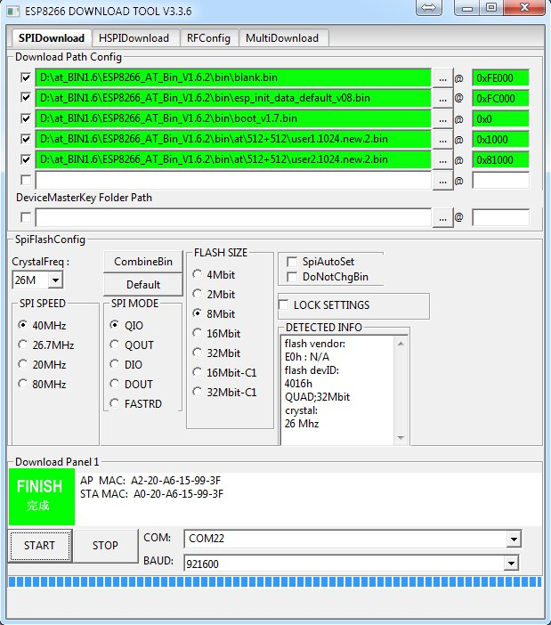

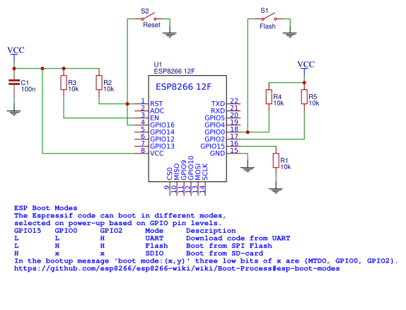

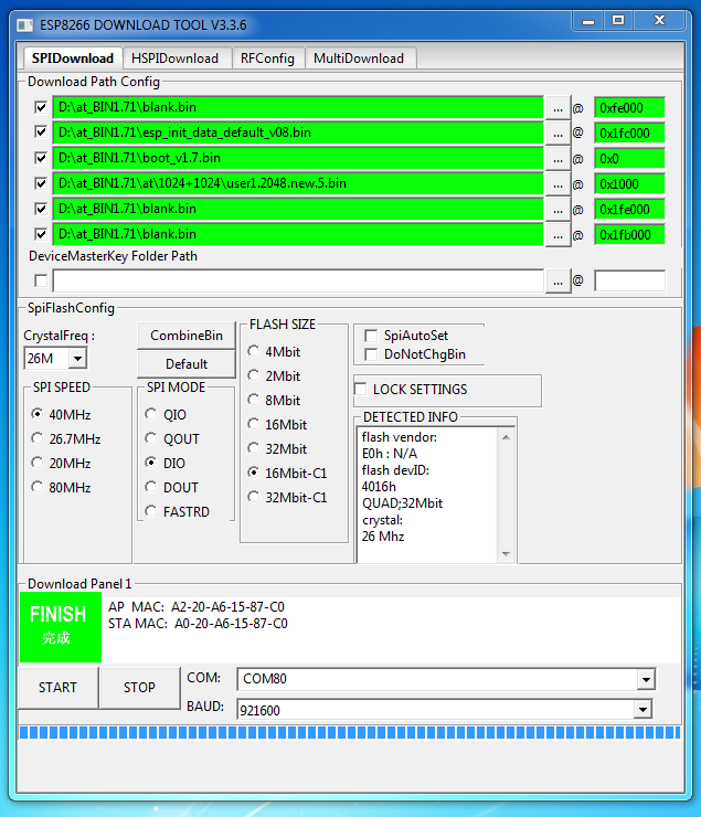

    In the schematic GPIO16 is connected to RST permanently, it should be a diode in the direction to GPIO16, such a connection makes it impossible to upload the firmware properly, unless you disconnect this jumper while uploading. If there is to be a resistor on GPIO15 then give a resistor - it is always better to do exactly with the instructions to start with.
    I always uploaded the AT firmware stating I had 1MB flash, even when I had 4, same settings for ESP12F/12E and 1MB ES01S:
    and as you can see with another program.
    If it doesn't work I reduce QIO, QOUT, DIO and finally DOUT in turn.
    Newer firmware has the AT connection at 115200, older ones had 9600, I always check both.
    Upload a sample sketch from the Arduino that prints something to Serial and see if it works properly.
    When you connect the ESP to the PC set the terminal to 74k and do a reset, paste the boot message here - it says what is uploaded and what mode it boots into, maybe something is not connecting and despite using the switch it still only boots into flash upload mode.

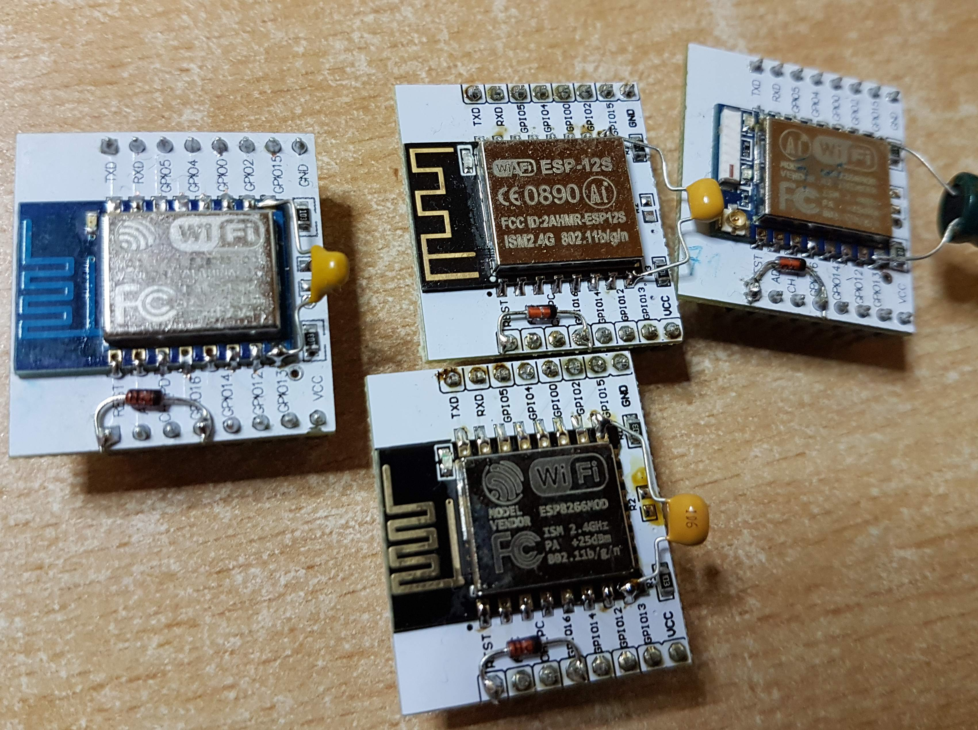

    Thanks to the diode from RST to GPIO16, it is possible not to move this connection any more and to have a permanent connection for wake-up, while at the same time flash uploading works. As someone doesn't intend to use sleep it is of course possible not to connect at all.
    I set the speed to 900k as everything is OK, sometimes I need to reduce it to 115200, and there were times when I had to upload 9600, it depends on which cable and which module, which UART converter.

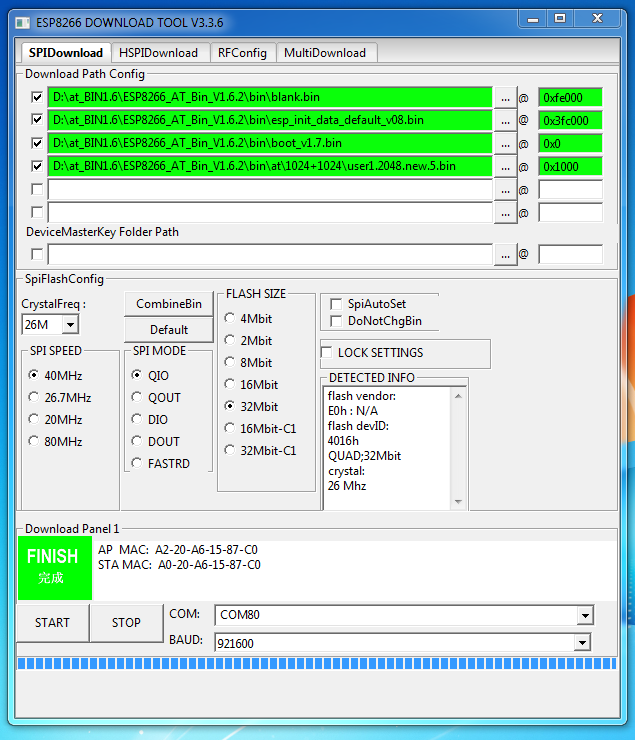

    Led is a special case of a light-emitting diode, I am writing about a schottky diode or ordinary silicon diode of 0.6V, towards GPIO16 )there above I wrote wrong):
    Attached is what I uploaded.
    PS:
    For the AT I don't see the point of connecting GPIO16 to the RST in any way, this is used to wake up every certain time with a code from the ESP level, that is when there is no other device controlling it.
    • ESP8266_AT_Bin_V1.6.2.zip (2.33 MB) You must be logged in to download this attachment.

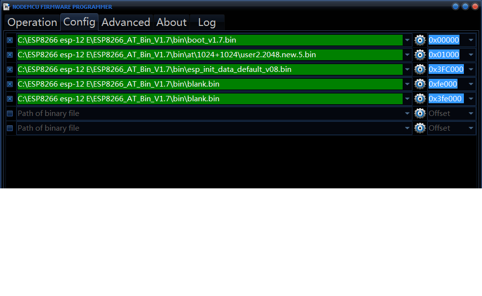

    #25 18182877
    robo1973
    Posts: 679
    Rate: 59
    After uploading your package, the terminal shows the following when connected to WiFi
    +STA_CONNECTED:"a4:50:46:d5:88:e6"
    +DIST_STA_IP:"a4:50:46:d5:88:e6","192.168.4.2"
    After the AT+GMR command, it responds with AT+GMR
    Strange that it responds to the command with the same /.
    user1.1048.new.5.bin and user 2 are uploaded to the addresses you specified
    while user1.2048.new.5.bin just uploads after 0c1000 and also wifi gets up
    Strange, because uploading ESP8266_AT_Bin_V1.7 to the same addresses causes wifi not to work

    After uploading everything, firing up the terminal at 115200 and pressing RST, the 74k speed rubbish should fly through first, followed by the READY text.
    AT commands can now be typed in.
    Configuration uploaded to a Wemos board with ESP12E and 4MB flash:
    Post-GMR response:
    Spoiler:
    AT+GMR
    AT version:1.6.2.0(Apr 13 2018 11:10:59)
    SDK version:2.2.1(6ab97e9)
    compile time:Jun 7 2018 19:34:29
    Bin version(Wroom 02):1.6.2
    OK
    Soft 1.71 is a bit more messed up, it worked in this setting:
    Spoiler:
    AT+GMR
    AT version:1.7.1.0(Jul 15 2019 16:58:04)
    SDK version:3.0.1(78a3e33)
    compile time:Jul 15 2019 18:12:41
    Bin version(Wroom 02):1.7.1
    OK
    I downloaded the soft from here: Link .

    The case is as follows I have uploaded the soft ESP8266_AT_Bin_V1.7 and ESP8266_NonOS_AT_Bin_V1.7.1 according to the settings in the last picture for Soft 1.71
    Soft loaded, I can see the network from the card . After a reset REDY.
    Terminal responds correctly after setting in ardurino : Both NL and CR
    Thank you !!!!
