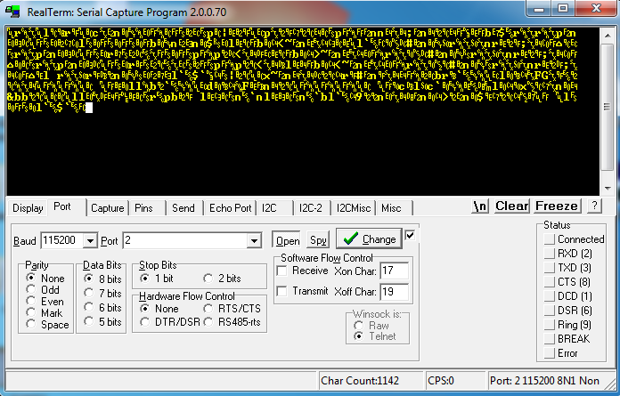

    On startup the ESP broadcasts status information at odd speeds, but usually after this sequence it switches to the "normal" speed of 115200. Just because there are bushes on startup does not mean that further communication will not work. Maybe the problem is with the PL2303? I always recommend communication modules based on FT232 (FTDI). Most modules are adapted to 5V and 3.3V logic (there is a jumper) and you don't have to combine with adaptations.

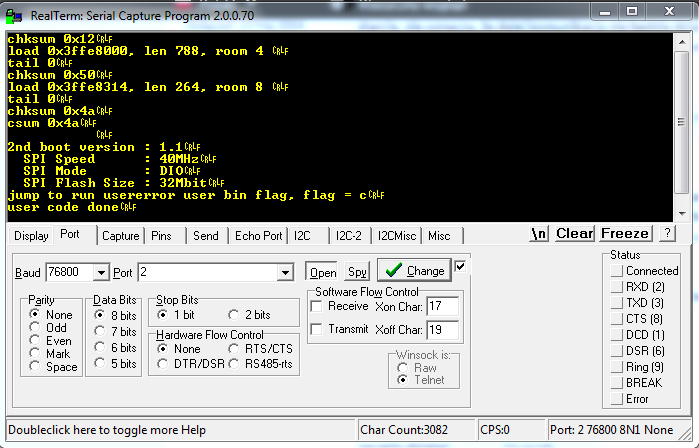

    EDIT: Problem solved windows suddenly started to see the usb converter and something started to work. I will add that I bought a new wifi module this time another esp-12. Something started to work: ESP8266-01 - No response to AT commands after firmware uploadPrzechwy..w.PNG (50.66 kB)You must be logged in to download this attachment. .
    Only according to the guide Link the text should end with the word ready. And the module still does not respond to AT commands.

    Set the speed to 115200 and don't worry about the "bushes" at the beginning.

    At 115200 I get these bushes and it doesn't respond to AT commands. Anyone have any ideas what is wrong?

    All 3 modules react similarly on 76800, i.e. they display what is shown on the screen, only without the bushes at the end. And on 115200 and 9600 total bushes.
