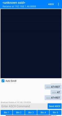

    This is what the data sent from the UDP terminal looks like:
    ESP8266 GPIO Configuration via AT Commands Over UDP Not Responding .
    This is what the data looks like when received at the terminal to which the (RS232) ESP module is connected:
    And this is what the data looks like when I enter the commands in the terminal to which the (RS232) ESP module is connected and, of course, the control works:
    Do I need to indicate in any specific way that I am sending an AT control command? So that the module interprets it in this way[/img]?

    #7 19732482
    mtbchn
    Posts: 130
    mpier wrote:
    That is, this esp8266 connected to the computer as a modem is supposed to reset, after loading in the browser this thread in which I maliciously wrote "+++ AT+RST"?
    I think it's easier to write a proper program than to rework the one with AT.
    Can you force the device connected to this esp to send appropriate commands in response to commands received?
    The issue is as follows. I have written an application in C# to communicate with the ESP using the UDP protocol - it works. However, the received commands are not identified by ESP as AT commands, but as text (as above in the screenshots). And exactly as you say, if I wanted to send the command: "AT+RST" then my goal would be to get the effect of a prock reset. Meanwhile, I only receive the text "AT+RST" - from UDP.
    Generally, writing a ready-made program - or using a sketch from an Arduino - is not a problem, and I have covered this topic.
    I also don't want the ESP to be an intermediary - i.e. e.g. ESP-01 connected via RS232 with another microcontroller and then the correct response to the message sent. What I want is for the ESP-01 to act as a full-fledged proxy, with the ability to control a single GPIO via UDP - i.e. over UDP I send it a series of AT commands and its response is to issue a high/low state on GPIO1 for example. I manage to achieve this, but when I type the commands in the terminal (RS232) manually, not when they come over UDP. And here I'm wondering if I shouldn't send the data by UDP somehow "dress" it up so that the AT firmware in the ESP-01 understands that it's a control command and not just a string :) .
  • AT firmware cannot interpret UDP as control commands

    khoam wrote:
    mtbchn wrote:
    I manage to do this, but when I type the commands in the terminal (RS232) manually, not when they come over UDP. And here I'm wondering if, when sending data by UDP, I shouldn't "dress it up" somehow so that the AT firmware in the ESP-01 understands that it's a control command and not a simple string
    I'm afraid the AT firmware doesn't have the functionality you expect. You can, however, from the ESP side query over TCP or UDP and retrieve data.
