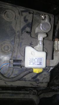

    The problem is the flashing loading light after clearing the error a few minutes is fine.
    Error codes F567-generator voltage out of range, I will add that the voltage is about slightly over 14 V and in bsi parameters 0.0 V.
    the other is F066 - no communication regarding the battery charging status - not recognized.
    anyone had a similar case? please help.
    best regards.

    Currently, I do not have a car and I can not give this number..but in my opinion the alternator is good because the voltage still charges over 14V.
    What do you think about this module on the minus clamp maybe it is the culprit ?? Peugeot 207 1.4 hd charging - The charging indicator is flashing

    Decybel91 was unfortunately not a regulator and I am 230 zlotys in the back ;) and 1 day of work. Maybe someone changed this current sensor on battery sometime ?? hint please
    Added after 57 [seconds]:
