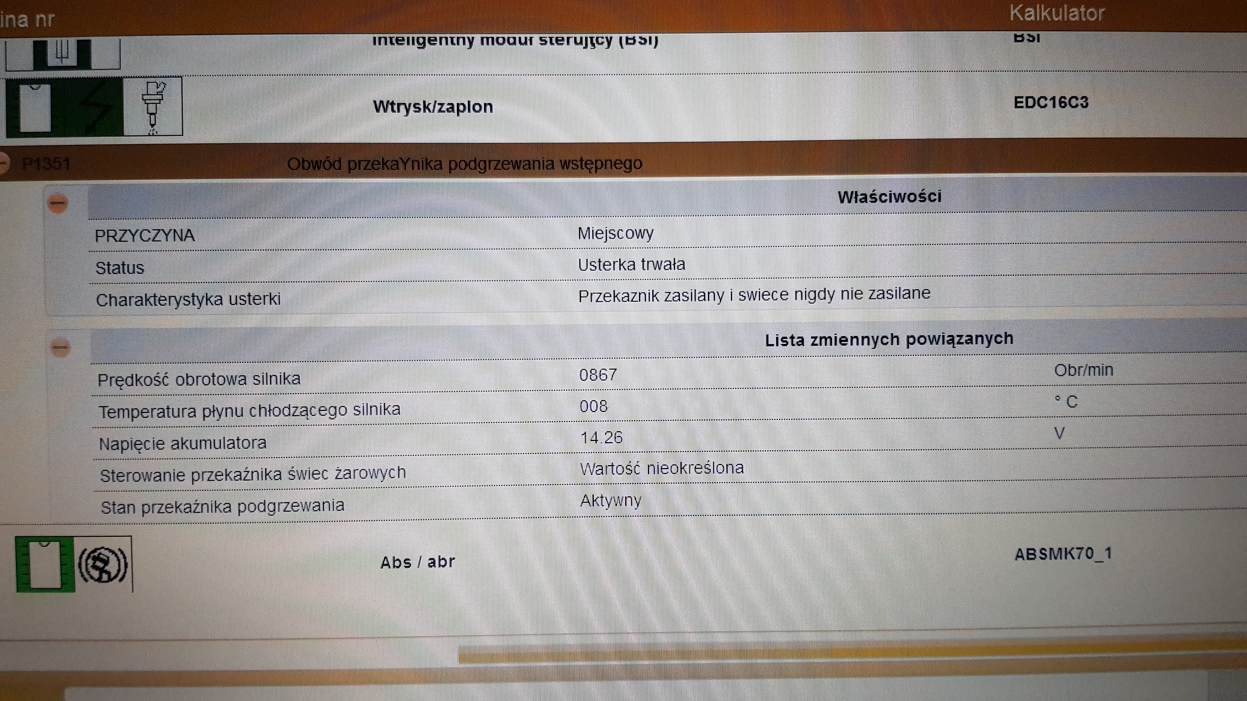

    As in the picture attached, I have a problem with the lack of candle power.
    Diagbox informs that the voltage reaches the relay, but the candles do not.
    Question: how to get to the relay in the easiest way?
    The relay is located under the left reflector.
    Is it necessary to dismantle the reflector? Can the headlight be removed without unscrewing the bumper?
    Is this relay semiconductor or electromechanical?
    Can you open it?

    I understand that you did not measure this tension, only you trusted what displays the diagnosis - and this is not true. Check the candles from the intermediate connector (a few cm from the candles) this error informs about the malfunction of the candles.

    That's right. Not making voltage measurements. Thanks for the hint. I will check the voltage at the connector. Where is the connector located? Under the air filter housing?

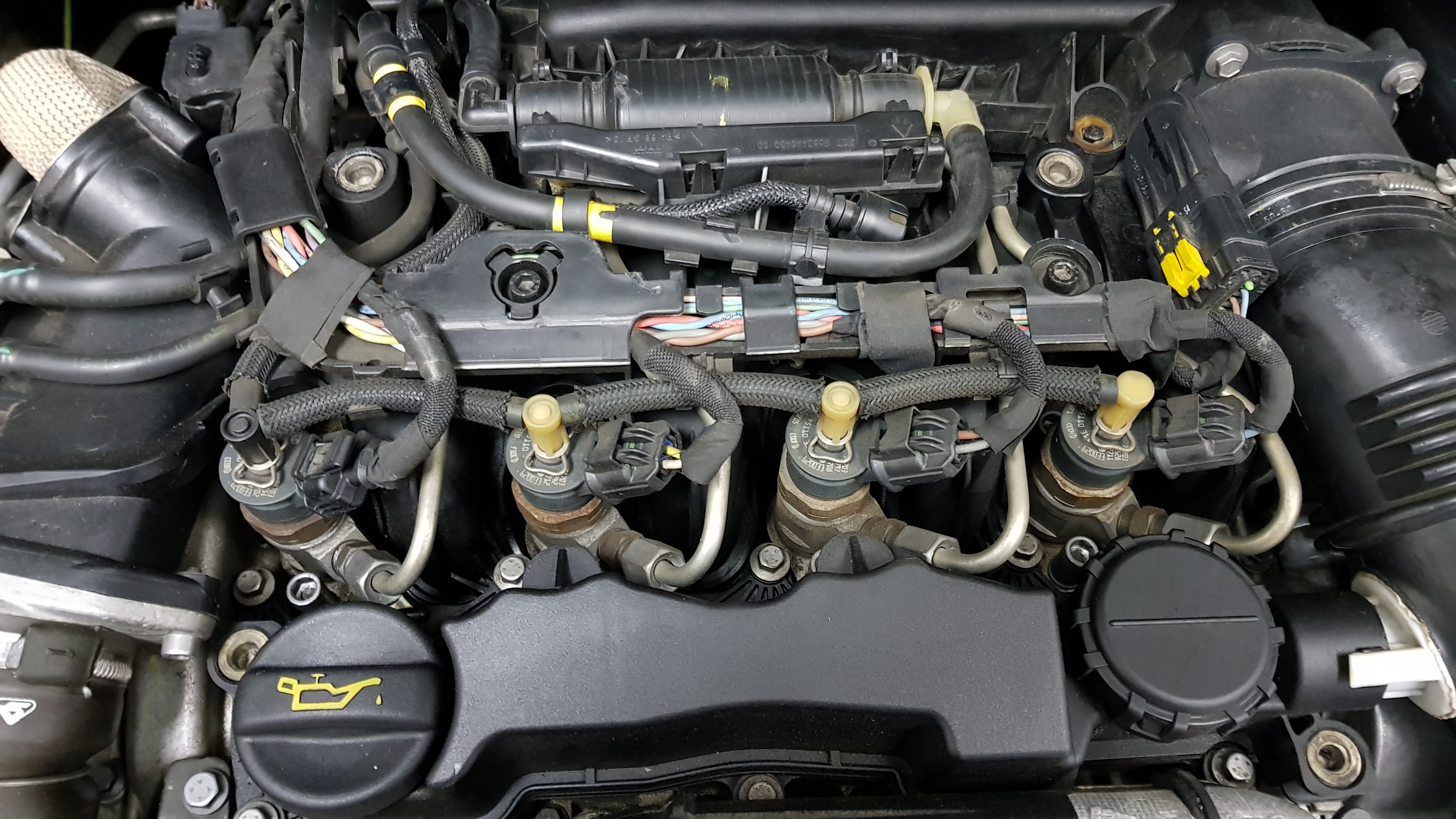

    Please, indicate in my photo where there are glow plugs and cables for glow plugs.

    You will not find them here.
    They are at the rear of the engine, from the side of the bulkhead.

    How should I get to them best?

    You have to take out the air filter with the "packaging" and possibly the manual fuel pump. Access weak.
