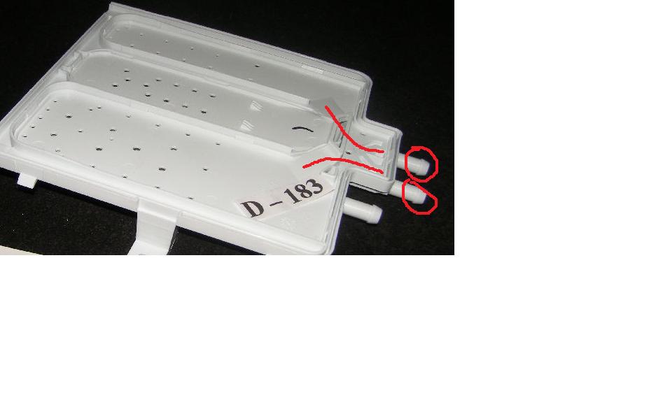

    I have a problem with my Samsung washing machine, for some time I have noticed that when I pour the prewash and main washing powder into the dispenser before starting the washing, after pouring water into the drum by the washing machine, the main washing powder is also taken. For the test, I took out the tray and started in the washing machine and noticed that water was pouring towards the prewash chamber and at the same time water was dripping towards the main wash chamber, this is not a lot of pressure, but quite a lot of drops dripping. Is it the fault of a leaking solenoid valve or maybe something else, I am asking for hints.

  • #4 16445627
    micuszyn88
    Posts: 116
    Help: 5
    Rate: 47
    You can try to unscrew and clean the water dispenser, perhaps the holes or inlets of the water dispenser are clogged. These dispenser outlets are most often clogged Samsung Washing Machine - Prewash and Main Wash Detergents Dispensed Simultaneously
  • #5 16445645
    puncio1
    Posts: 1062
    Help: 12
    Rate: 99
    But if they were clogged, it probably wouldn't be drawing in the powder
  • #6 16445653
    micuszyn88
    Posts: 116
    Help: 5
    Rate: 47
    And did you look at what pressure the powder is taking for the second time? Also only dripping or is the pressure normal?
  • #7 16445661
    puncio1
    Posts: 1062
    Help: 12
    Rate: 99
    I haven't checked. What would that have to do with?
  • #8 16445685
    micuszyn88
    Posts: 116
    Help: 5
    Rate: 47
    If the program is set to prewash and main wash, it takes detergent from one prewash drawer for the first time. The same happens when it takes the washing powder for the main washing and in both cases it should take water under high pressure. And one more thing. After taking water, does it collect it again the first time as it should be? or not. If so, it is worth checking when it will draw water for the second time and see what pressure it is under.
  • #9 16445695
    puncio1
    Posts: 1062
    Help: 12
    Rate: 99
    I checked, set the program to the main wash and I was pouring water under high pressure the same as in the pre-wash
  • #10 16445699
    micuszyn88
    Posts: 116
    Help: 5
    Rate: 47
    So, most likely, the solenoid valve is defective. There are no more options :)
  • #11 16458720
    puncio1
    Posts: 1062
    Help: 12
    Rate: 99
    The water feeder and solenoid valves have been replaced. The washing machine works.
