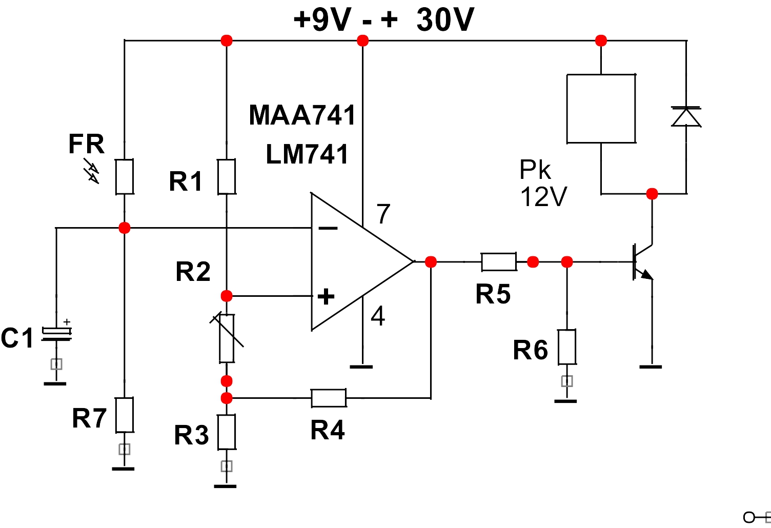

    Design your twilight switch on an operational amplifier.
    It's much simpler.
    Creating a 9V Schmitt Trigger: Calculating Elements, Transistor Selection & Input Voltage
    The circuit is very "flexible" in terms of the resistor value requirements.
    Calculations - trivial - you can do in memory.
    For design, the ability to use a voltage divider on resistors is enough.
    There may also be another type of op-amp.

    Design the circuit on the operational amplifier.
