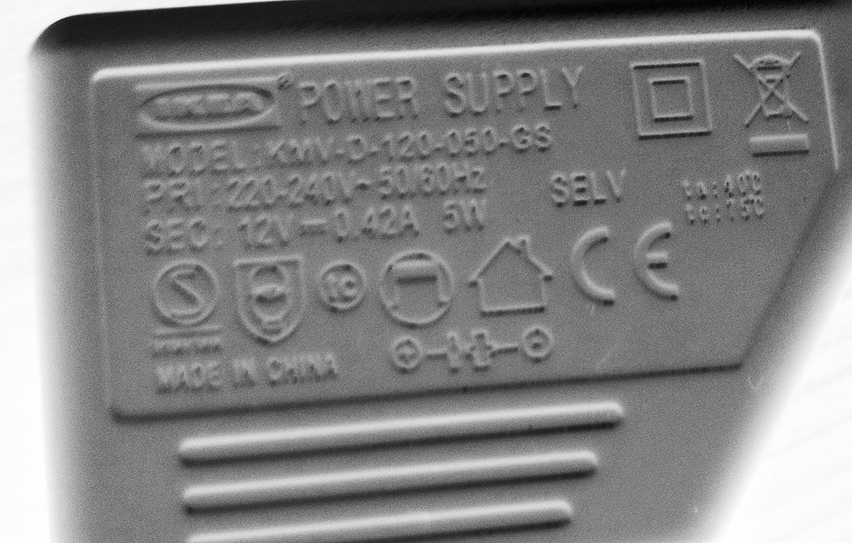

    one lamp says:
    12v DC
    36x0.06w 2.8W
    on the power supply from DIODER led lights
    220-240V 50 / 60Hz
    12V- 0.42A 5W

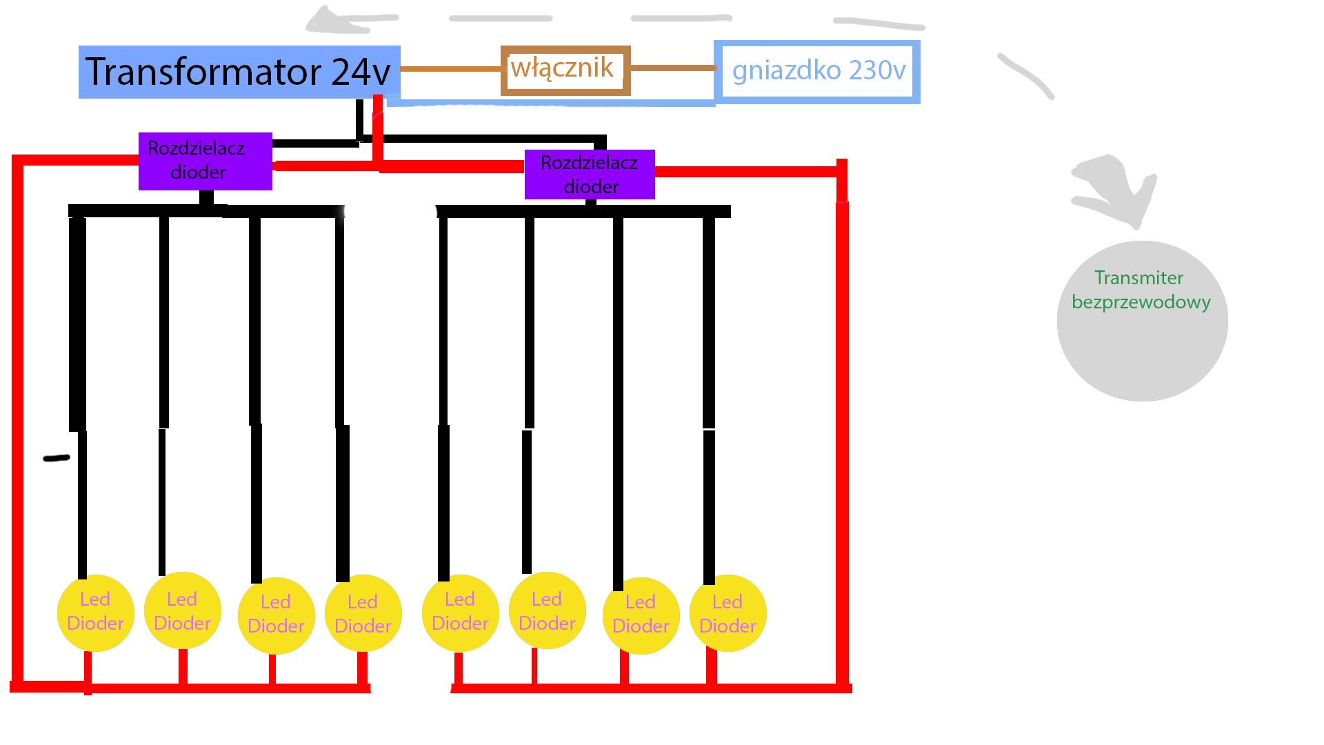

    I have a question, is it possible to connect an ANSLUTA 24V transformer and connect up to 2 DIODER distributors so that each of them has 12V?
    Something like Ansula - Dioder - led splitter.
    best regards

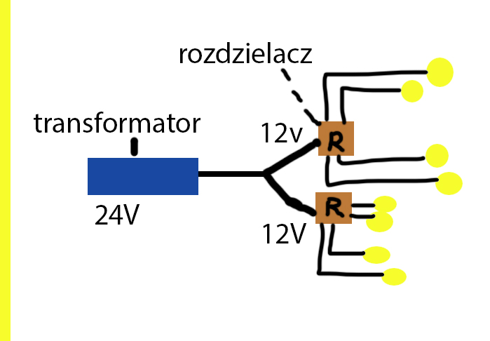

    Theoretically, it is possible to connect in series 2 sets adapted for 12V for a 24V power supply. It would have to be done this way Splitting IKEA ANSLUTA 24V Transformer to Power 2x DIODER LED Lights at 12V Each: Connection Guide
    But more accurate information can be provided when pictures of sets as well as diode and splitter parameters and power supply are inserted.

    this is a set from ikea why this transformer do not know what exactly are the parameters? I can send a photo what is written on the PSU packaging
    and below is the diagram I was thinking about

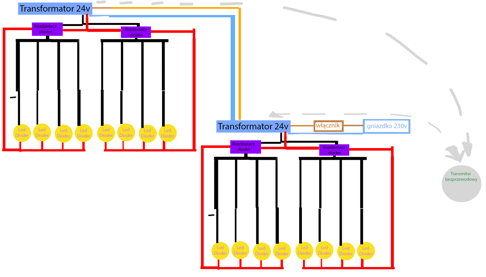

    Thanks for the idea, but apparently the 24v power supply will not evenly divide the voltage after 12v when I separate the cables, is it true?
    Added after 4 [minutes]:
    ultimately, the installation should look like this
    2 24v power supplies under the daisy chain (it is possible to connect several with each other at the factory) and pair with a switch.

  • #9 16449780
    wzielonymgaju18
    Posts: 316
    Help: 32
    Rate: 110
    Connecting in the way you drew (in parallel) you will burn diodes. You need to connect the distributors in series to make it good.
    If the sets have the same resistance then a voltage divider will be created, i.e. both distributors will get 12V, but in case of short circuit in any set, the other gets 24V.

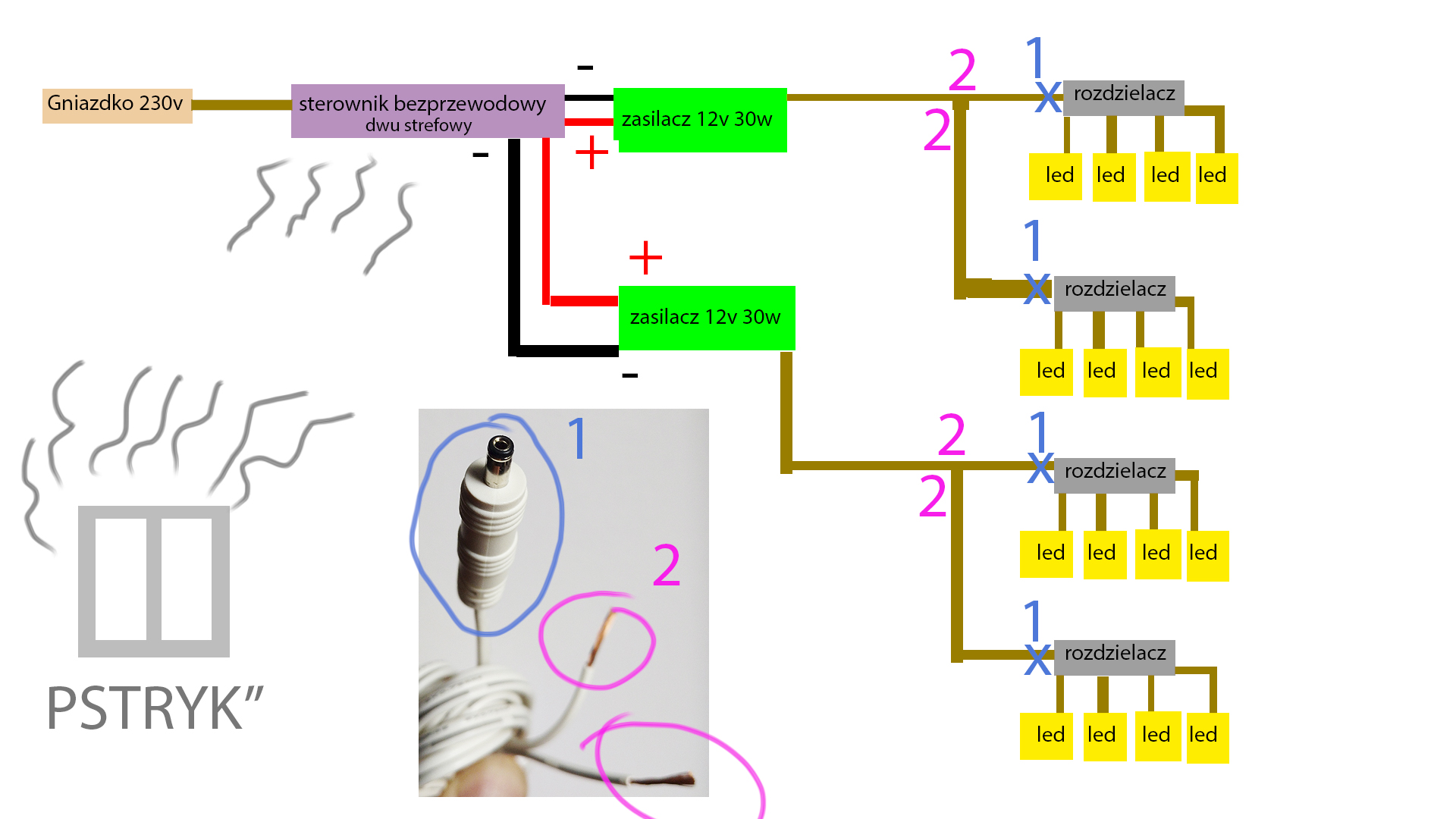

    Yes it is an electoral transformer but the concept of the whole has already changed after suggestions here in the forum ;)
    I found in the castorama radio on / off switches that looks nice and decided to modify my scheme.
    Socket
    - wireless control cube
    - 12v 30w power supply
    - manifold
    -4 led
    - splitter -
    4 led
    will such a set work well together?
    I put the diagram
    there is a photo of the cable that I plug into the splitter come out of this 2 cables are not marked how to check which one - / +? I bought a meter today ;)
