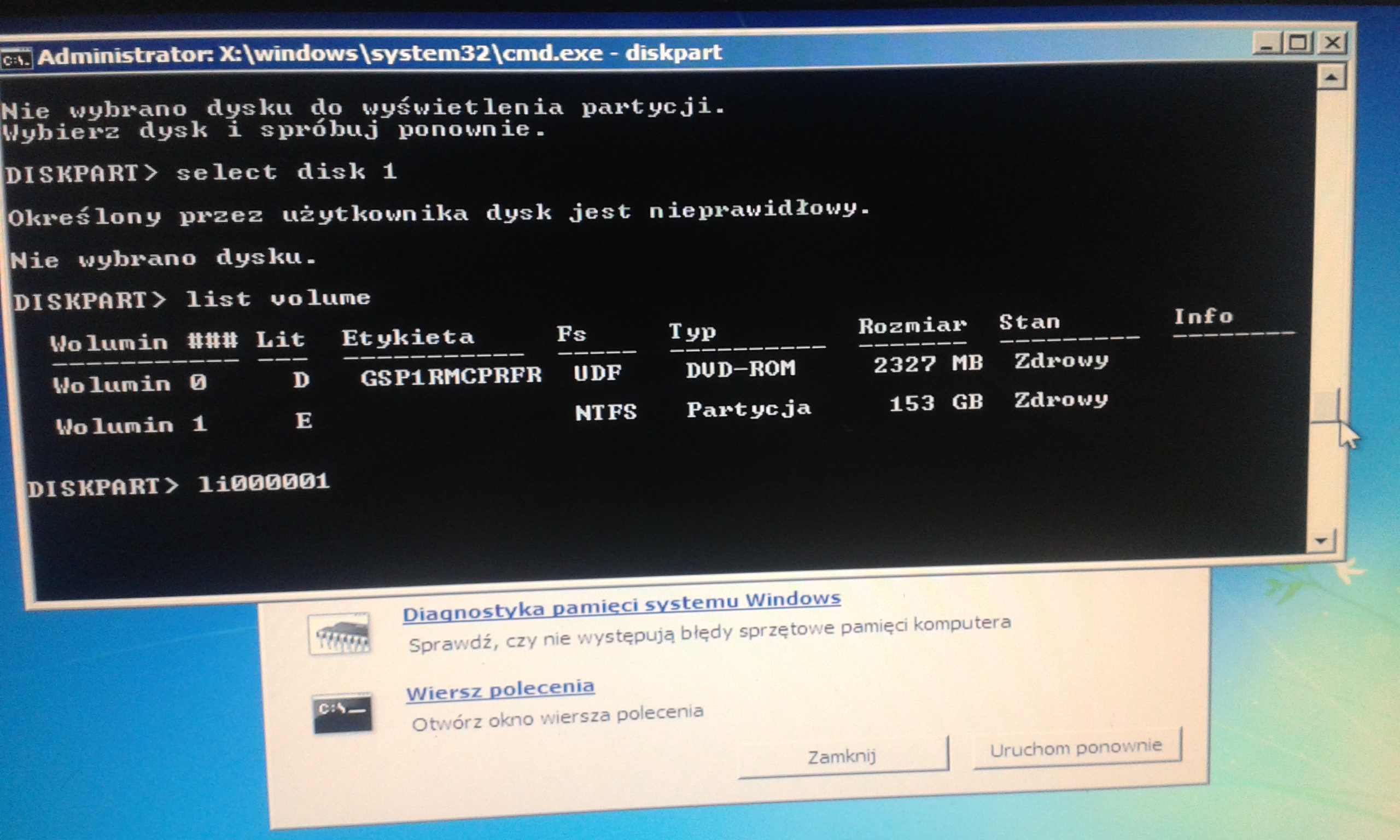

    Smajdzio
    I had win 7 and thought to install Win XP on the second partition. Everything is good, only the internet in XP wines did not work and 7 already did not want to turn on. I formatted the XP wine partition because I thought I wouldn't need it. When I wanted to reinstall win XP, I only got one partition 153/153 GB free, I installed it and after the reset the error A disk read error occurred. I connected cables to other inputs and an Invalid Partition Table popped up. I put it in place and then the same. I started with full instalke win 7 because the drive does not work and I gave the system a repair, which did not work. In addition, the installation does not detect the disk at all, it says that it is unknown. Fixmbr command does not work and fixboot cannot find a file. I tried chkdsk with commands to no avail. You can see the disk normally in the bios.
    Specs:
    AMD Athlon x64 dual 2.01ghz 3800+
    Gigabyte board I don't know the model
    1GB RAM
    WDC WD1600YS-01SHB1
    I will add that chkdsk says that the NTFS boot sector is damaged. I can't check the disk with someone, play testdisk and this type of dupes for pen, change SATA cables. I would like to fix it myself, but if it is impossible, I will contact a specialist

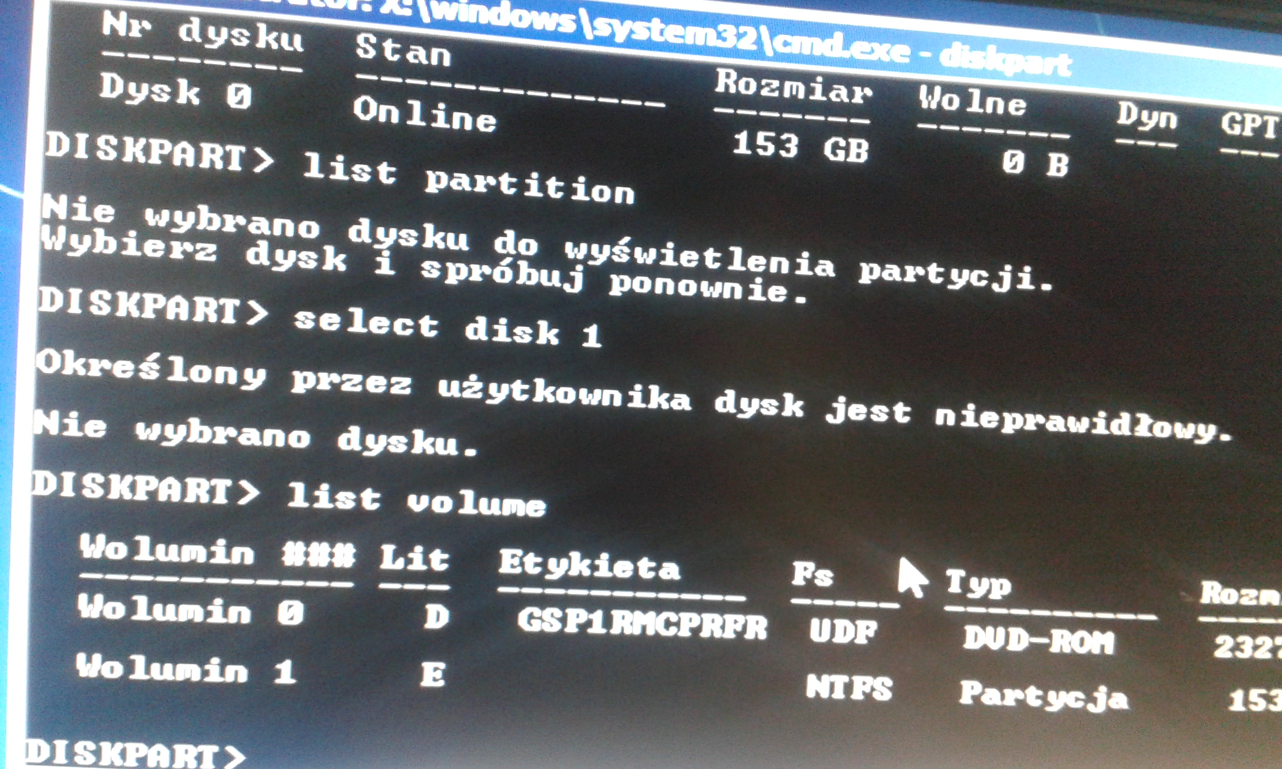

  • #5 16449553
    Smajdzio
    I care more for the disk to survive and I care little about the data on it. Recordings of this Linux. Does he need a disk or not to run?
    E: this is the partition where the XP win was, it is 153 GB and I gave 15 GB ac: it was from win 7

    It is not true that repairing a partition table involves data loss. The same use of a new non-sponsored partition does not delete data. We don't know exactly what the author did and the description is a bit chaotic. You can run, for example, DMDE under Linux and check what happened, what the partition table looks like and what is on the new partition, whether it has the boot flag, etc.
  • #7 16449769
    Smajdzio
    Good problem solved. It was enough to format the disk and create the partition from scratch. I have installed W7 and everything works. Thank you for your willingness to help. I close.
