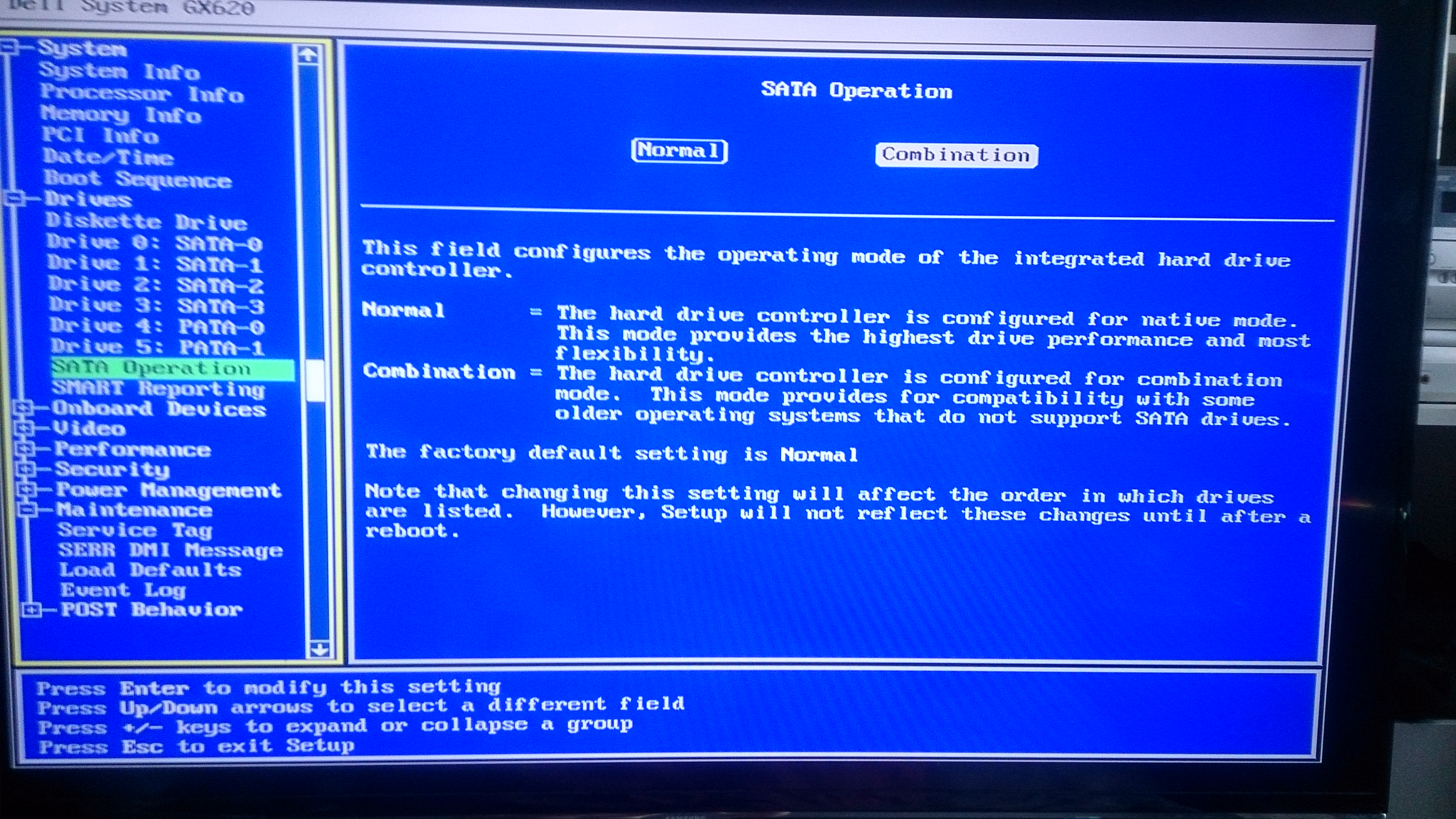

    Hello !
    I have already looked for answers to this problem on various forums but unfortunately I did not find ...
    I currently have two computers and recently wanted to install an operating system on this older one. At the beginning I installed win 10, unfortunately it turned out to be too demanding for the computer, so I decided to install win xp and that's where the problem started ...
    the old computer is a Dell optiplex gx 620 with an intel d 920 processor and some samsung 80gb SATA disk.
    I started normally from installing from a windows CD, unfortunately the cd-rom didn't even read it. I made a disc image on a pendrive and the installation started here, unfortunately after unpacking the installation components, a blue screen appears with the error 0x0000007B.
    Then I took the hard drive out of the old computer and installed it in the new one. I formatted the disk from the old computer (it had win 10) and started installing XP on the old disk using a newer computer. There, unfortunately, he did not want to boot from the disc, although after booting the system he sees it normally and I have access to its contents. After trying with a USB flash drive, the installation on the new computer works but does not see the hard drive from the old computer, even though the drive is visible in the connected hardware and I can access its contents after booting the system. Disconnecting both SSD with windows and HDD and connecting the HDD from the old computer does not help either. When installing from the disc with the system turned on, it says that it cannot be installed because the program will not work in the 64 bit system. I don't know what else I can do to install XP on the old computer.

    Honestly, I didn't know about these GPT and MBR disks. I formatted the HDD that XP wants to install on. Is it MBR after the format? If not then how to make MBR?
    I read about IDE and AHCI, unfortunately in the BIOS, I did not find such settings and I searched it thoroughly ...
    Tried installing with both FAT and NTFS, unfortunately it doesn't go from this or that :(

    The BIOS looks like the picture below. I tried with the "combination" option but it didn't help.
    It would be nice to integrate the driver with the system or install it with FDD during installation.

    GX620 this is the equipment where XP was originally; if the boot is not set up correctly, the optical drive is ailing
    Since the SATA controller is in the ICH7, there is no AHCI.
    @Wirtuozz - still struggle with the pendrive but first replace the NTDETECT.COM file on it with this one:
    https://www.elektroda.pl/rtvforum/topic2501801.html#11959591

    The computer works, but it was impossible to install XP on it, I had to transfer the disk to another computer and install the system there, which is risky because windows will not work in every case. I just succeeded, but it is not known whether XP will work 100% as it should and probably not everyone will have such a method ...
    It's true, the gx620 had Xp ex factory, I also have CDs for it with dell's Xp. In fact, I do not know why windows do not want to be installed now. As for the discs, the drive reads all except those with windows ... I also do not know why ... maybe it is something with the OEM version ?? That's why I was "tired" of the flash drive. The installation started from the pendrive but ended with a blue screen.
    For now, the system works and it's ok after installing the drivers manually, but thanks for another hint, maybe it will be useful to me or someone else who will look here ;)
