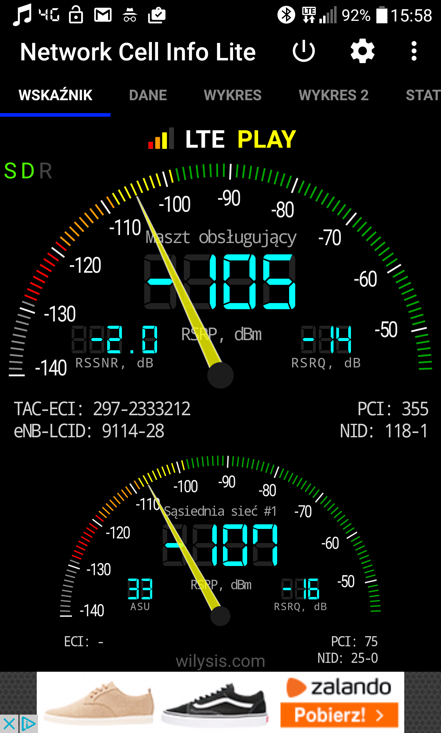

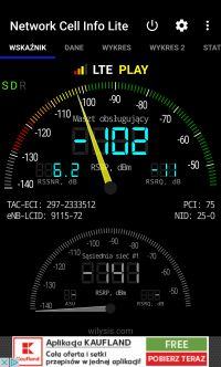

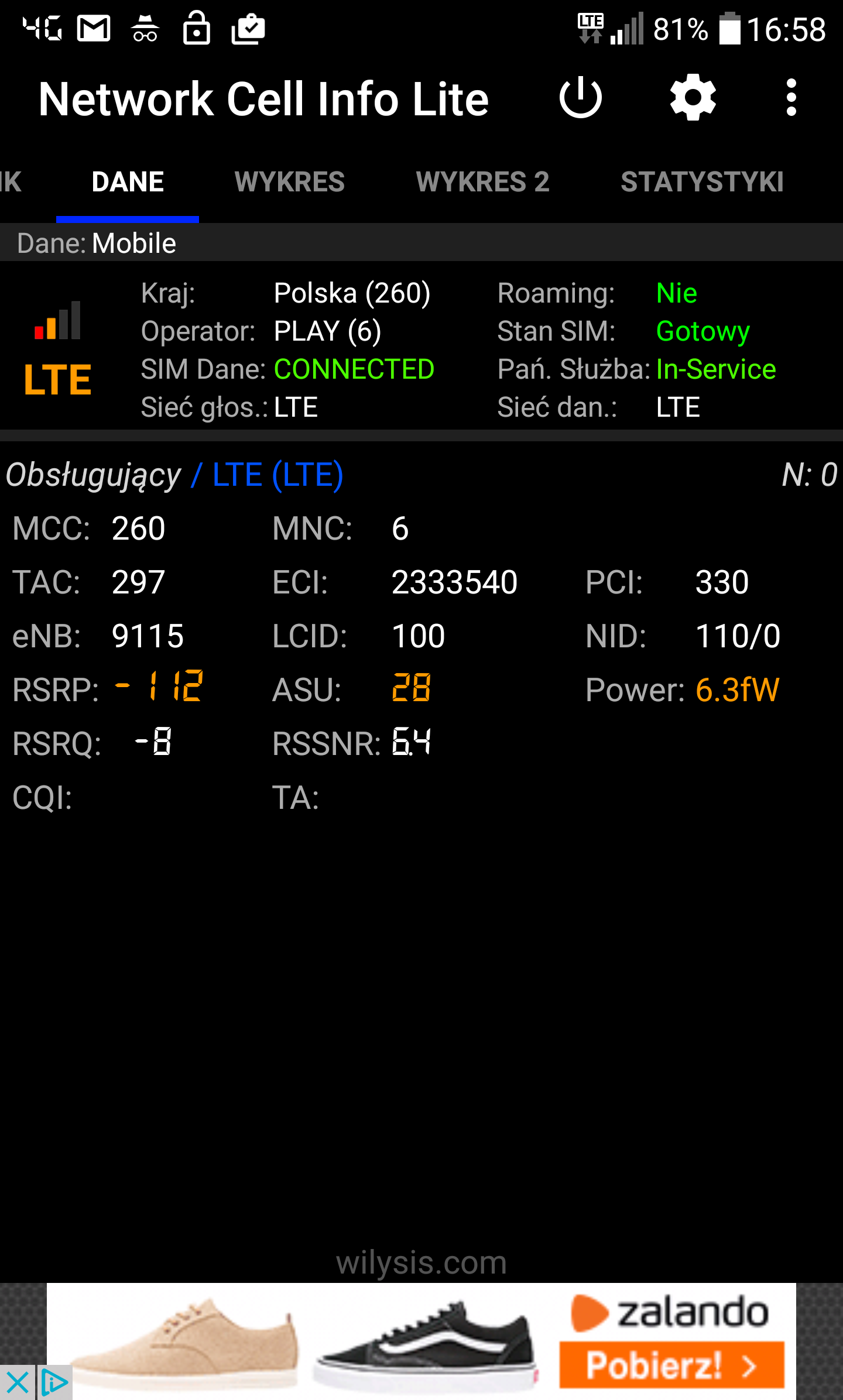

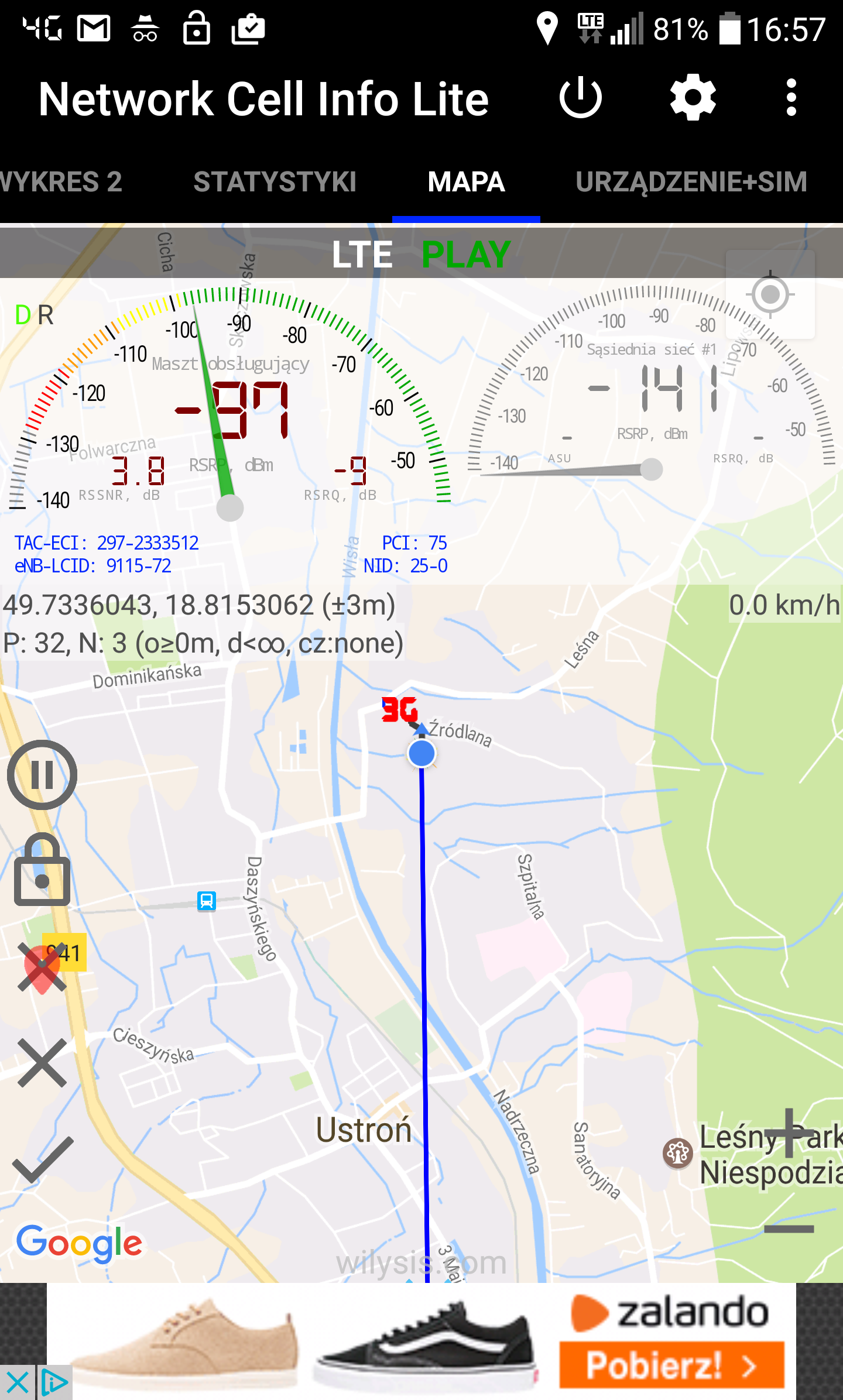

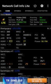

    Hello again.
    I did tests with a program that @ matek451 he recommended me (Network Cell) and I upload screenshots
    Outside:
    LTE router with external antenna output + external wifi antennas, preferably WiF LTE router with external antenna output + external wifi antennas, preferably WiF LTE router with external antenna output + external wifi antennas, preferably WiF
    Inside the house:
    As for the router, the B525 will probably be the best option. Please help me choose the right antenna, because I don't know anything about it.

    You connect outside with two BTSs, on the first screens on LTE800, on the second one is another BTS on LTE1800 addition. At home, the connection to the latter but on LTE800. What speed it's hard to say which BTS, LTE Play on them is unverified. you would have to do tests on the nearest Play BTSs to verify them.

    It is easy to choose the antenna when you have full information and this is shown in the tests. You have a weak signal at home, in addition to the LTE800 band, which is slower than LTE1800. On LTE800 Play it has DL up to 37.5Mbps with 5MHz bandwidth in MIMO and on LTE1800 twice as much. On both BTS in Ustroń, Kotschego, Zabytkowa 23 and Czantoria both these bands operate (probably also LTE21000). It is known that the choice of antenna is Dual LTE1800 or COMBO Dual LTE1800 + LTE800 antenna operating in these two bands for aggregation LTE1800 with LTE800. if B525 with LTE-A is to be used. But it is only after purchasing the router, there are appropriate programs that allow it to force these bands and LTE-A 1800 + 800. 99% of people don't do it, they buy the shit you linked to and then they are surprised. These are rubbish, not antennas, and salesmen are masters of pushy marketing. The description of this scrap is a piece of crap. No reasonable person buys antennas from such sellers. Garbage not worth even 1 PLN.
