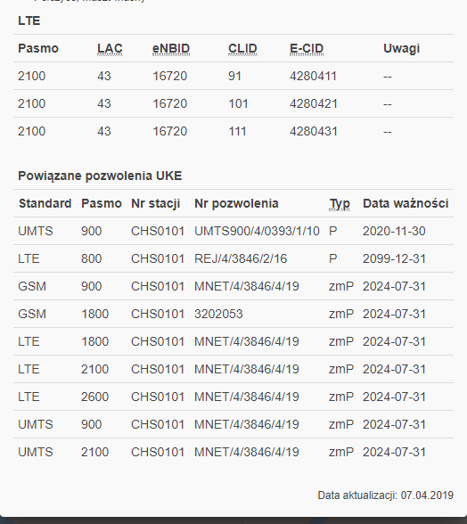

    BTSs
    Best External LTE Antenna Options for Huawei B818 Router: Recommendations & Buying Guide

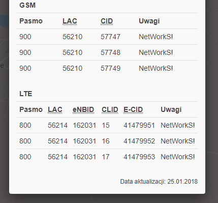

    @ matek451 I am asking for specificities ;) , the distance is about 6 km, not a toy you can suggest :D :D :D

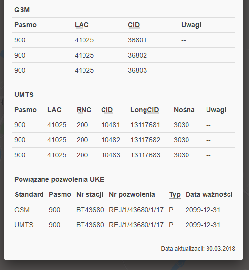

  • #6 18568816
    matek451
    Posts: 31253
    Help: 4352
    Rate: 5808
    Data from btsearch.pl is irrelevant, in the case of Play the LTE network looks completely different, most of this operator's stations are unverified and the bands on them also work. Please forgive the operators of Orange and T-Mobile, they do not exist there and the only station in Pełczyce with a bare LTE800 is laughter in the hall and mockery of customers, avoid like fire. Plus, in turn, has 3 stations with LTE1800 + 900. You should do the Play and Plus tests at the beginning, and above all, what is the place?
    @mothers, my assumption was not to reveal the exact place :D , 3 times I was robbed for several thousand :( :( :( .
    Okay, the data goes to PW.
    Please provide specific equipment :) . TP-Link has a chance of a refund.
    At the town you mentioned ;) there are physically three relays.

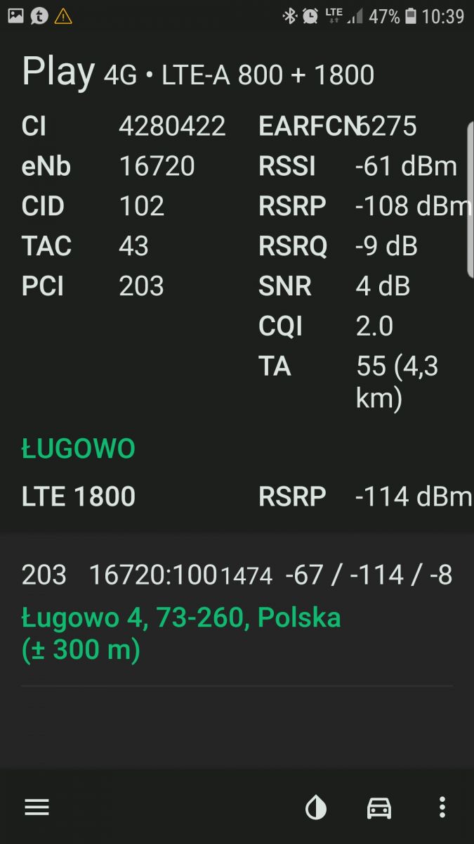

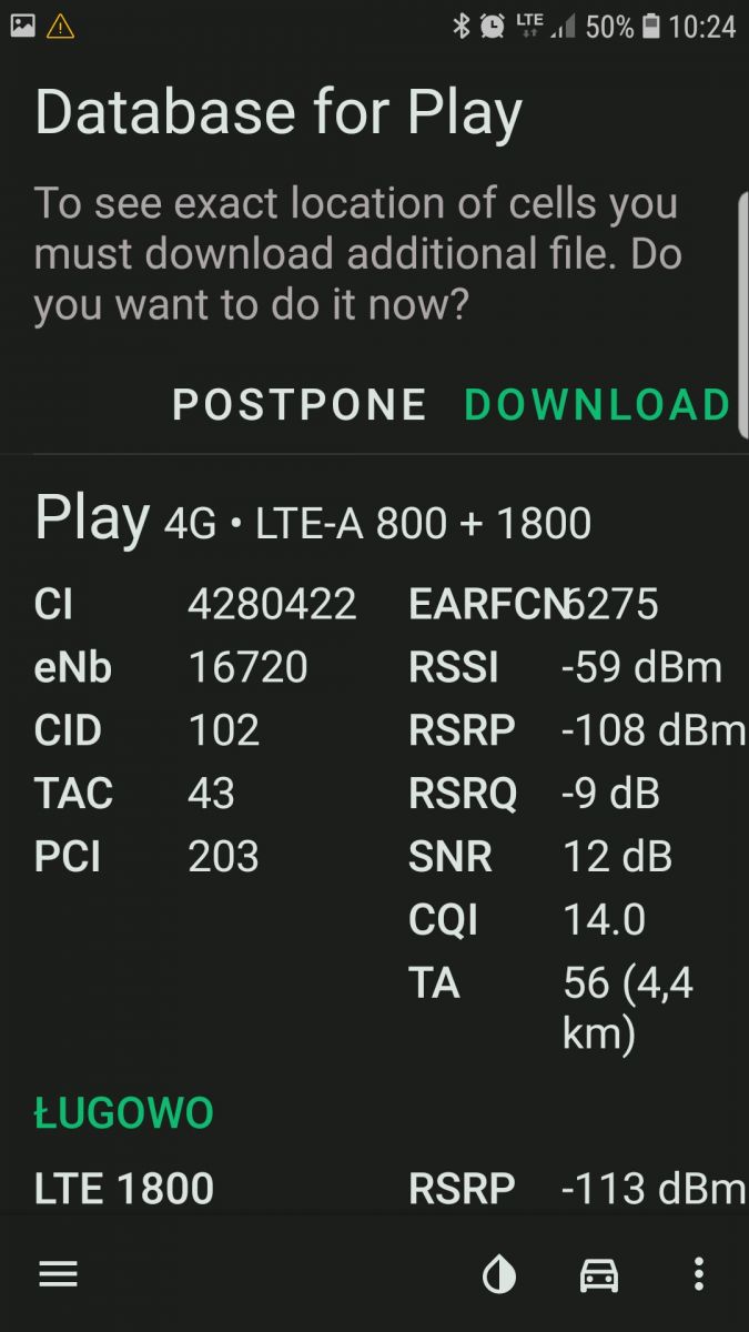

    kameleon11116
    Level 26  
    Posts: 899
    Help: 72
    Rate: 129

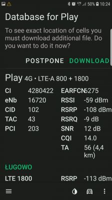

    Such results from the application
    Best External LTE Antenna Options for Huawei B818 Router: Recommendations & Buying Guide Best External LTE Antenna Options for Huawei B818 Router: Recommendations & Buying Guide
    I do not know if that was it. There was one more frequency, but I did not have time to make a screen, probably 2100
    #18 18577606
    matek451
    Posts: 31253
    Help: 4352
    Rate: 5808
    This is BTS Pełczyce, the signal on LTE800 is weak and even worse on LTE1800 and probably LTE2100, an external antenna is necessary.

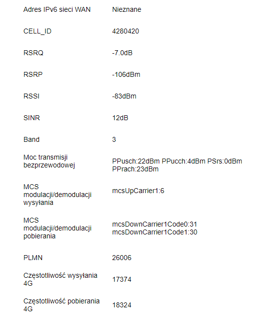

    And d..pa. Router purchased from the promotion you entered :) The advisor did his job :) Three, sometimes two LEDs shine from the antenna, so the signal is OK. Unfortunately, the cameras are practically impossible to control.
    On the old TP-Link MR6400 one dash but it works quite smoothly. I wanted to replace it because it sometimes crashed. On the TP-Link MR600 that I returned, the control and preview of the cameras also worked much smoother, although only one line was shining.
    I checked both on the Play card and on Premiummobile, Njumobile (on the old router on all cards it is similar, i.e. relatively smooth, you can control, cameras react relatively quickly to commands to change position and zoom)
    Maybe something needs to be changed in the B818 settings? I just don't really see any possibilities there.
    And one more disadvantage of B818 - no remote access as MR600 had :(

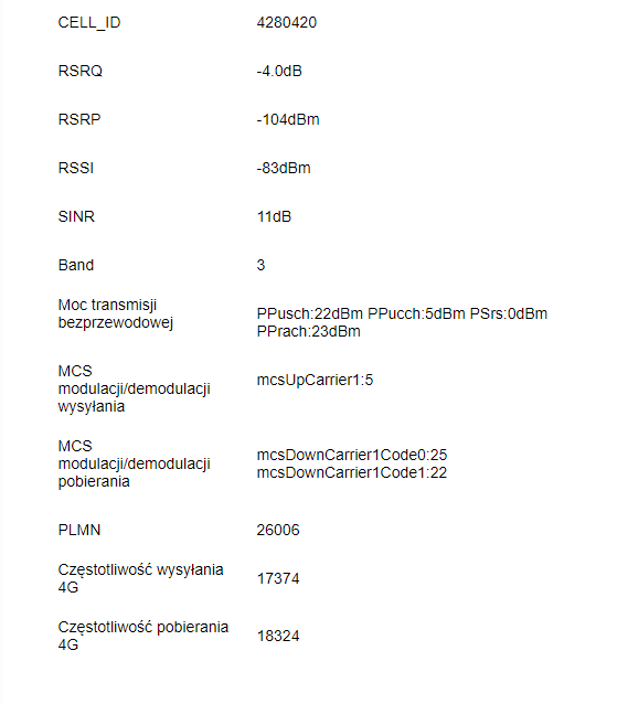

    @jimasek, unfortunately, I am not there where the equipment is, unfortunately I do not have remote access :( .
    I made such screenshots this morning
  • #26 18606828
    jimasek
    Posts: 35287
    Help: 3783
    Rate: 2681
    Weak signal so what do you expect? What are the parameters of the up.down link, it is probably crucial and prevents the correct operation of the camera controlled and viewed from the Internet - @ matek451 have a look at it.
  • #27 18606863
  • #28 18606869
    jimasek
    Posts: 35287
    Help: 3783
    Rate: 2681
    _cheetah_ wrote:
    It looks like something else, maybe some problem with UL or communication with cameras.
    I think this is a problem with the upload, but without specifics it is difficult to deduce something after the signal.
