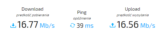

    Thank you for the answer, I have checked the recommended program on individual bands in the attachment. LTE antennas for the Huawei B315 router LTE antennas for the Huawei B315 router LTE antennas for the Huawei B315 router
    band 2600 1-3 lines DL 8mb / s
    band 1800 3-4 lines DL 23mb / s
    band 800 2-3 dashes DL 16mb / s
    I understand that I have to use the band 1800 or change to automatic so and how was it? I also understand that it is the evening time so the internet slowed down because more people use the internet in the evening. LTE1800NetWork - for sure less people use because in this area much less people live compared to the Alusive. Now with an antenna? how to combine and whether the "crap" of allegro is enough and if it will help at all. Today he is holding stable 3-4 lines throughout the day (today it's raining)

    I am interested in screenshots from LTEWatchH or Toolbox v0.9 with B315 on each of the bands and not the range lines. It's garbage, not antennas. One mistake with the choice of B315 has already been made, the choice of the antenna only after showing the screenshots, and not for 30 PLN.

    I did the test in the morning:
