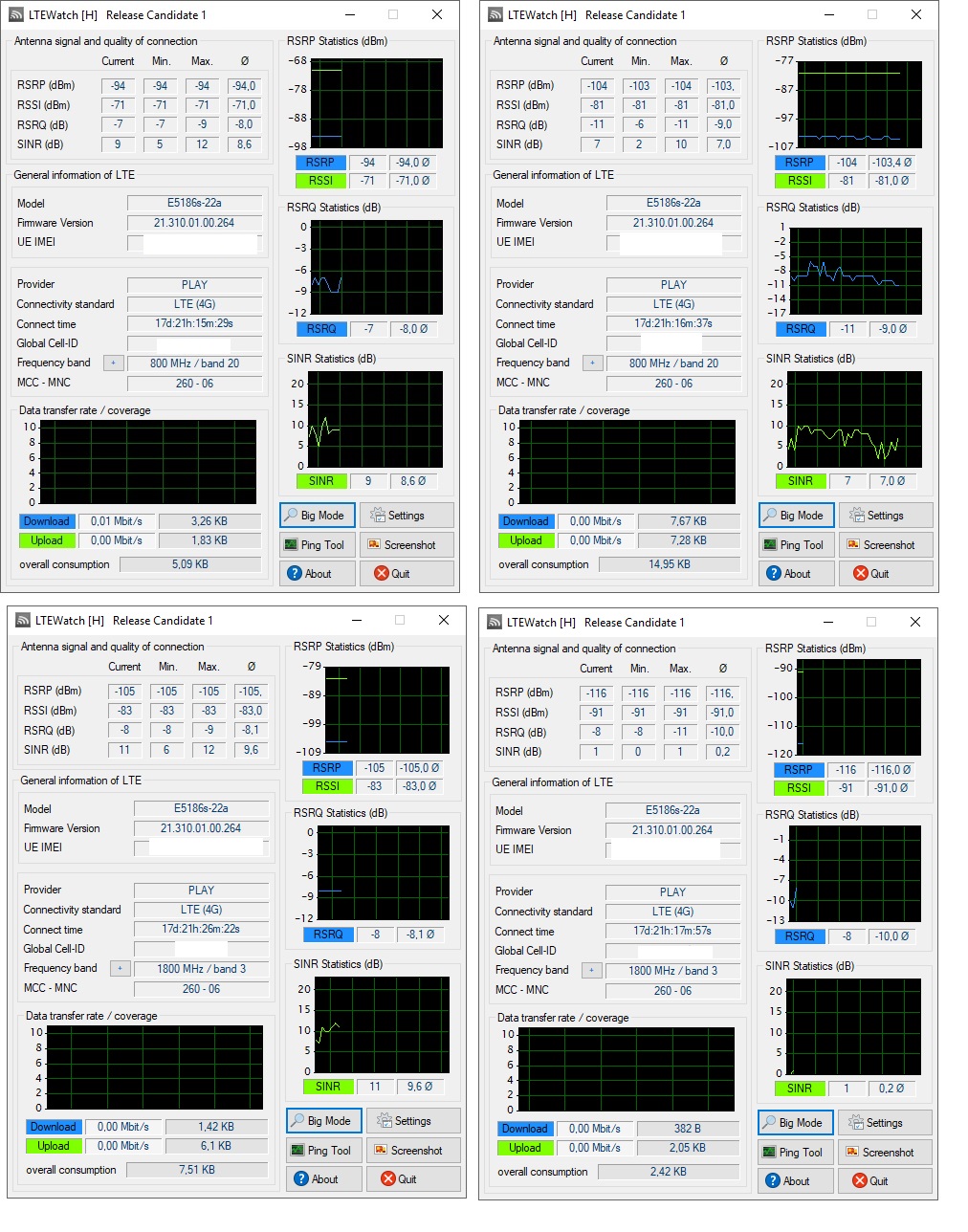

    Maybe gentlemen :) At the moment I do not have an LTE router - A. I'm thinking about buying. I did tests in both bands with the WatchLTE program. For the LTE-800 band, the signal is at the level of 82 and LTE-1800 shows 105. So it would be good to use the MIMO DUAL 1800 antenna. The only question is if today or soon I will exchange the equipment for LTE-A it will not be a coincidence he also had to replace the antenna on COMBO1800 + 800MHz? I thought maybe it's worth buying one ..... Can you recommend one?

    And what is the location? And basically, you showed the screenshots from LTEWatch to LTE800 and LTE1800 with and without. The question is whether the test without the antenna made inside the house or outside in the place of antenna placement?

    On Wednesday, 14/06, an antenna from Cybertech arrived. On the antenna built into the router the signals were at -106 dBm. After mounting and connecting the antenna, he jumped at -91 dBm. Maybe this is not a great result but considering that the BTS view covers the forest of tall trees, I think the investment has paid off. The speeds are different but it depends on the BTS load to a large extent ... However, the improvement in signal strength is significant. I am happy with the results and many thanks especially to matek451 for help.
