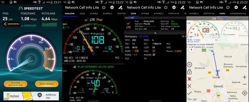

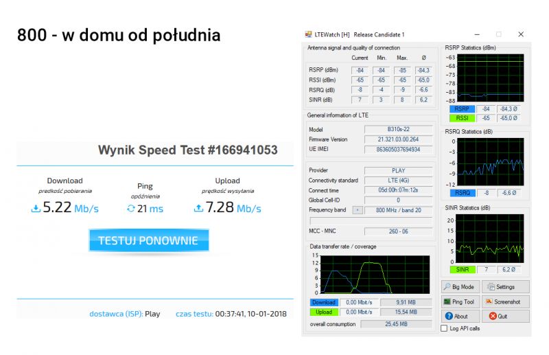

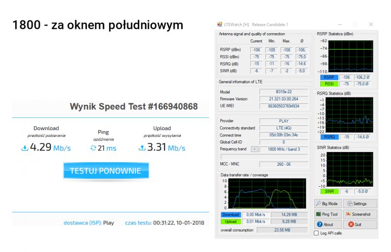

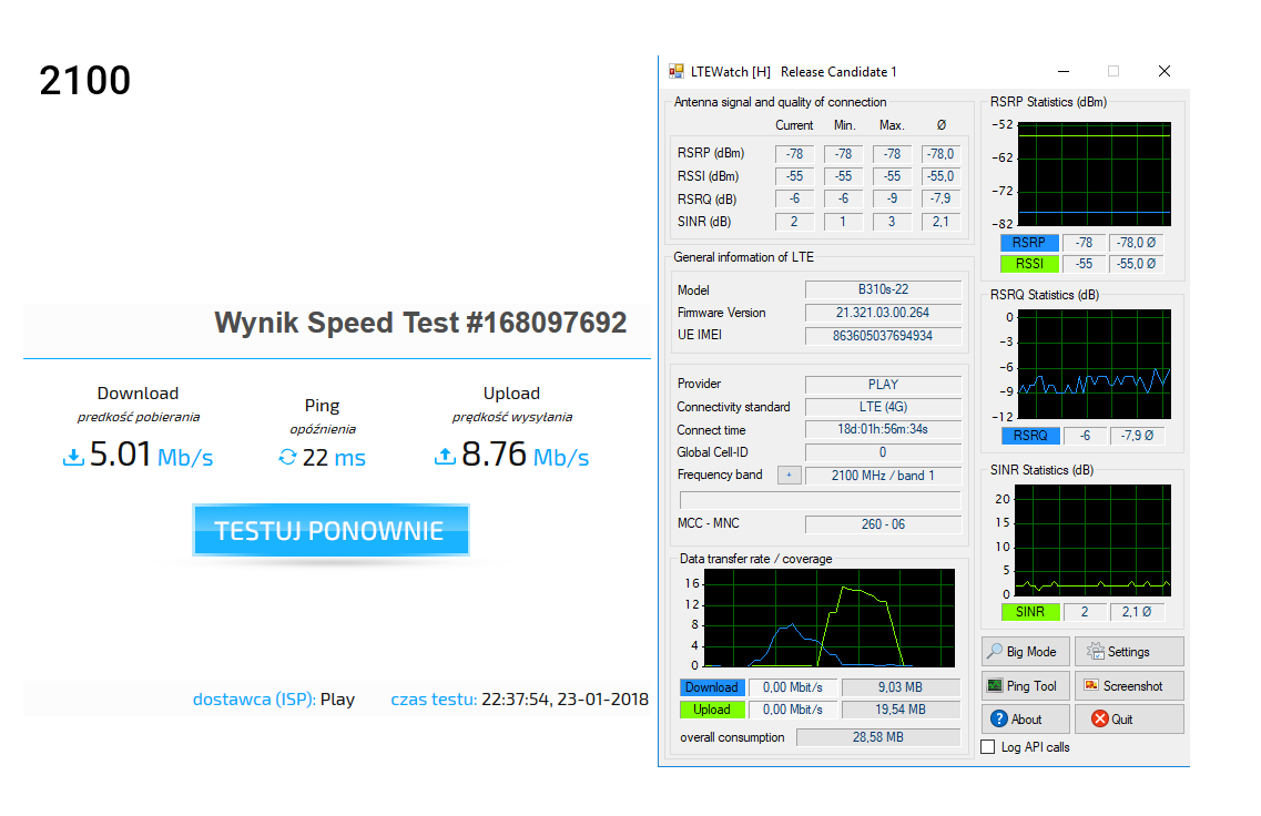

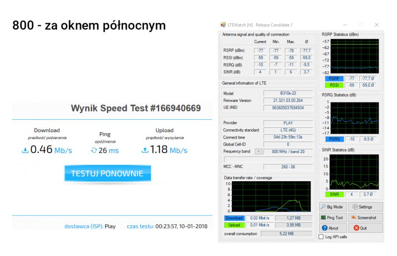

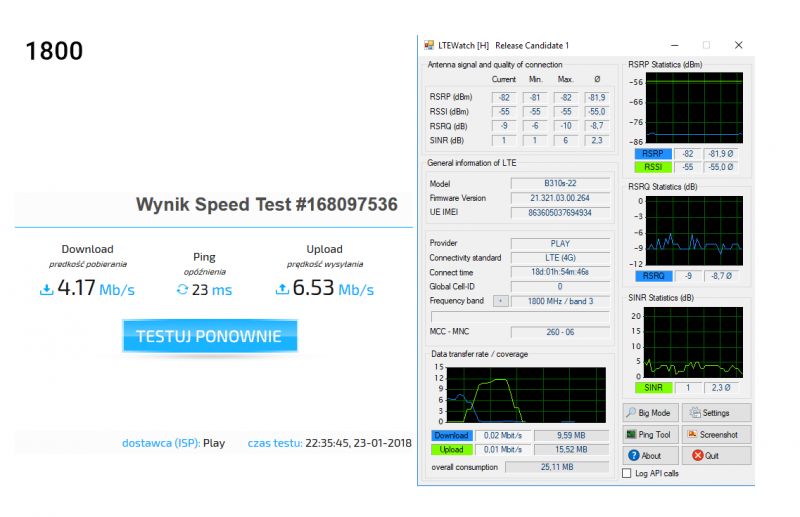

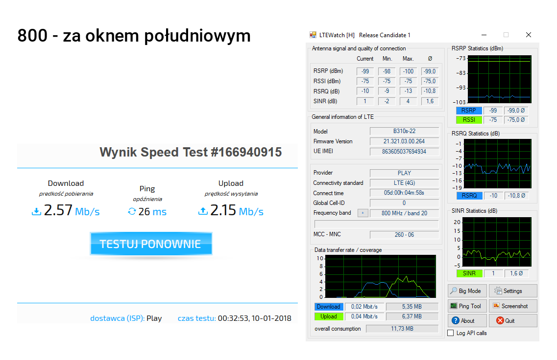

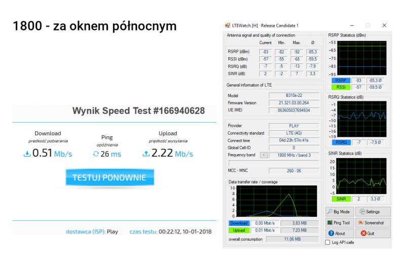

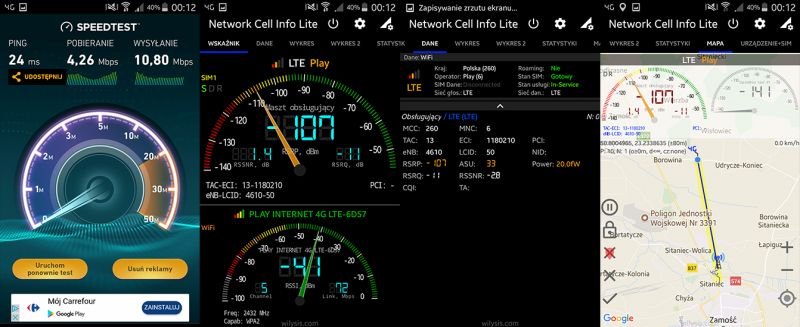

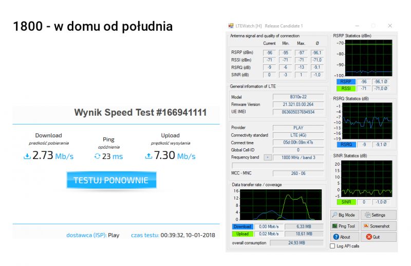

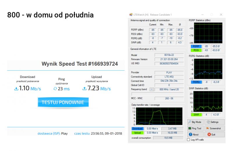

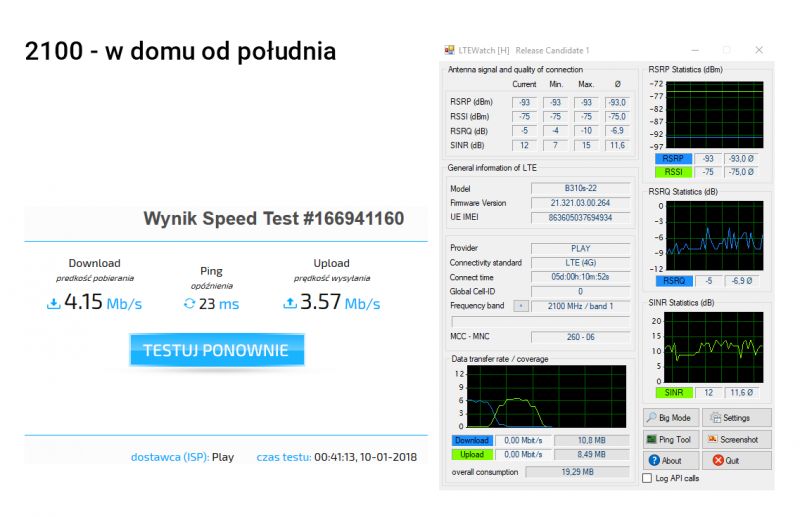

    It was only in the evening that I could take care of it - I send screenshots of info:
    Huawei B310 Router: External Antenna Options, Comparing to B618, Improving LTE & WiFi Signals

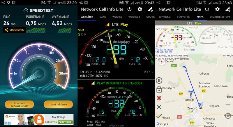

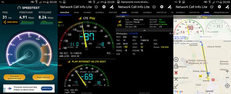

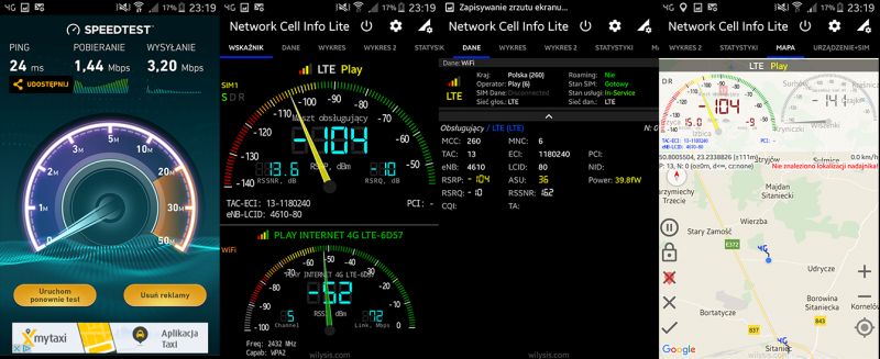

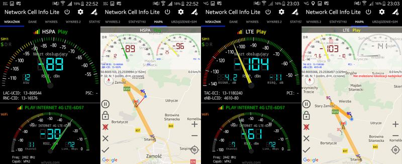

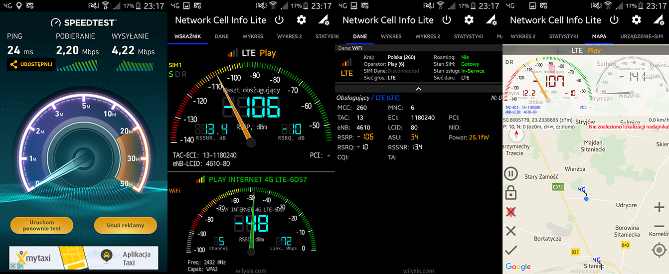

    And here are screenshots from the phone - where I did not have wifi to test on a desktop computer:
  • #6 16949416
    matek451
    Posts: 31253
    Help: 4352
    Rate: 5808
    And we have a surprise. at home, better signal parameters on all LTE bands, the B4310 does not show CID BTS, so it is difficult to say which connection. Generally, as if some BTS was from the north but it is not on the maps. Speeds are still weak DL

    I was also surprised that the results were worse outside.
    Maybe it is the fault of frost and wind?
    So there is hope that something can be learned from it?
  • #8 16949474
    matek451
    Posts: 31253
    Help: 4352
    Rate: 5808
    We will see outside there was a weak signal on LTE1800 and LTE2100 from Zamosc. Better at home but the lack of CID does not allow BTS to be identified. This is puzzling on the phone with LTE1800 coverage, at -99dBm. Play is now launching new BTSs and it is possible that one has appeared somewhere in the area. I verify it.

    The second BTS is a chimney on Hrubieszowska, all LTE bands in Play operate on it. Such signal parameters on LTE1800 with over 10 km is a big surprise.

    Fortunately, you can see Hrubieszowska from my home in a straight line without any obstacles. There are only meadows, no forests or hills. Chimneys are also very well visible. In the evenings the speed is ok but slightly jumps and can hang up for a moment. During the day, unfortunately, the signal weakens. Is there a chance that if I buy a directional antenna then this signal will get stronger and won't jump like that?

    Of course, this is done with an antenna that stabilizes the connection. You set the area code to a specific BTS. You have visibility with BTS and the area is favorable from here.

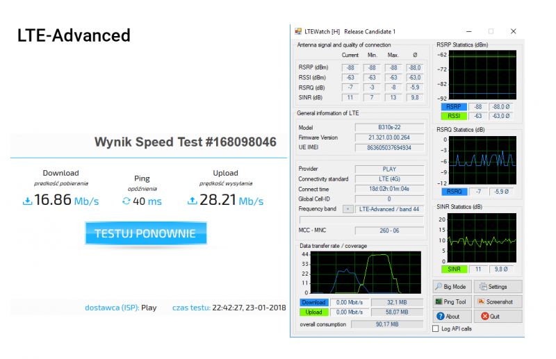

    I come back after tests.
    I bought this 1800-2600 antenna and I already installed it so that it catches the signal from BTS on the chimney in Zamość. So far, everything is going well :) I set it to 2600 because in the tests it reaches the highest speeds but it has a higher ping and I don't know if it is better to set a different frequency - does it bother?
    Thank you for your patience and help!
    2 years subscription I would not forgive myself, as if it worked as at the beginning: /
    I send today's screenshots:
