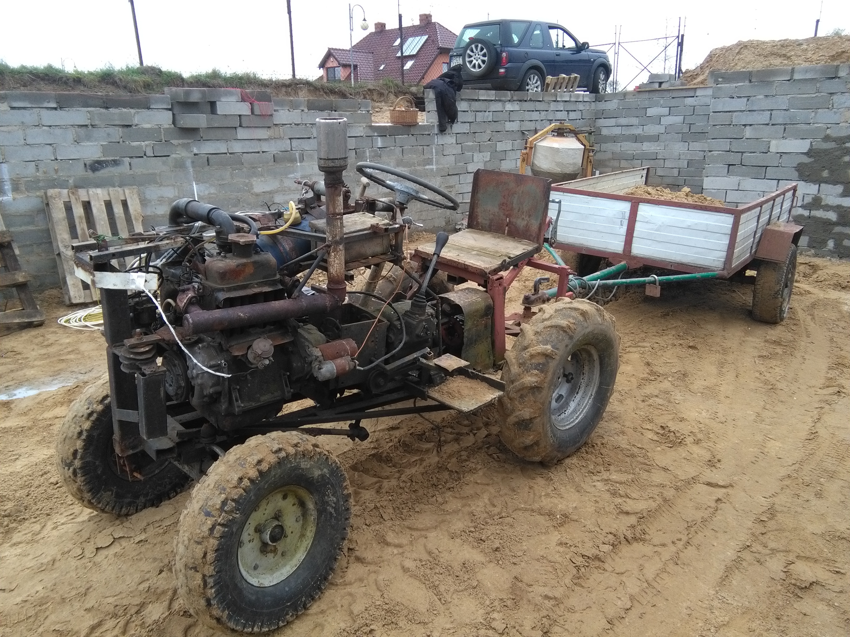

    I present the construction alone with the Fiat 126p engine, gearbox and beetle bridge.
    The tractor is lively and very strong for a baby. First gear is practically not used for starting. There were plans to do turns, but because of the weak frame, I did turns to a different construction

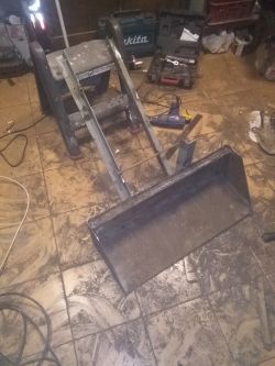

    New year, new ideas, and thus I necessarily developed another mini tractor into a mini loader. I emphasize the MINI due to the lack of hydraulics and the anticipated high costs associated with it. Well: hydraulic pump, distributor, cylinders, hoses, tank and 100 small elements not listed are the cost of min. PLN 1200 for used!
    I decided to go all the way and install it minimalistically, which is what I have in stock plus some small purchases.
    Plan for 2018: Mini loader / bucket for bulldozing.
    Parts needed:
    1T winch with aledro - set PLN 210
    electrodes - package 45 PLN
    4mm steel rope - complete with a winch, although I am wondering whether to invest in a thicker one.
    3mm bucket wall plate - I had it from an old garage door
    mini-construction, i.e. dismounted angles, tubes, bolts, nuts, spring from a bicycle leg :-) I was also up there ....
    So for the proverbial PLN 300 I have a mini loader.

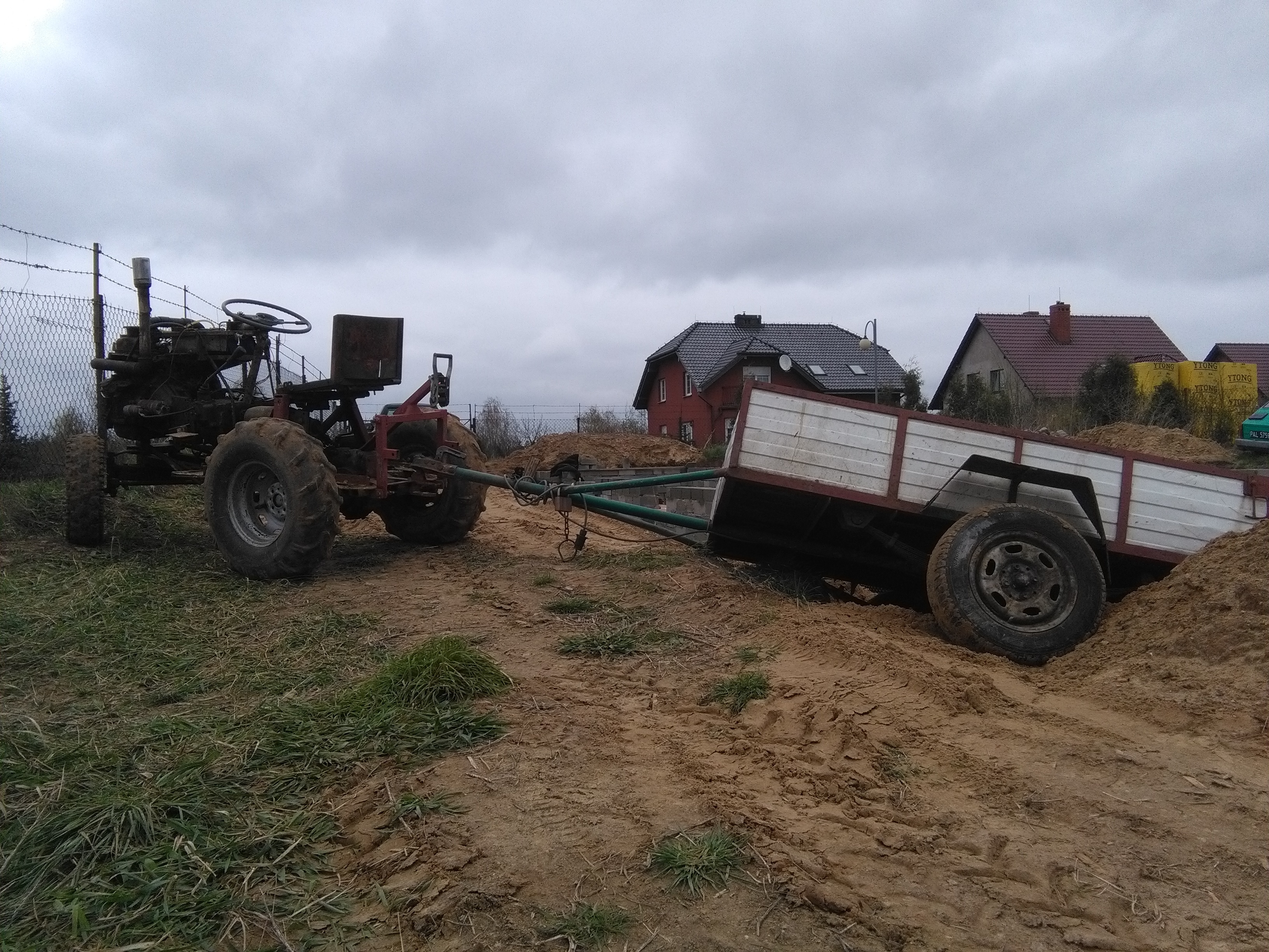

    Attached are photos from the construction site, photos of poor quality because I took it at the construction site in the basement and because of the lighting, you can't see too much. Until the end of the week, I will try to upload a few photos or videos from work myself, and so far I am presenting the first tests :-)
    ps. It's good that I thought about fixing the bucket and I can adjust the angle because when going up the hill, it does not collect as it should.
