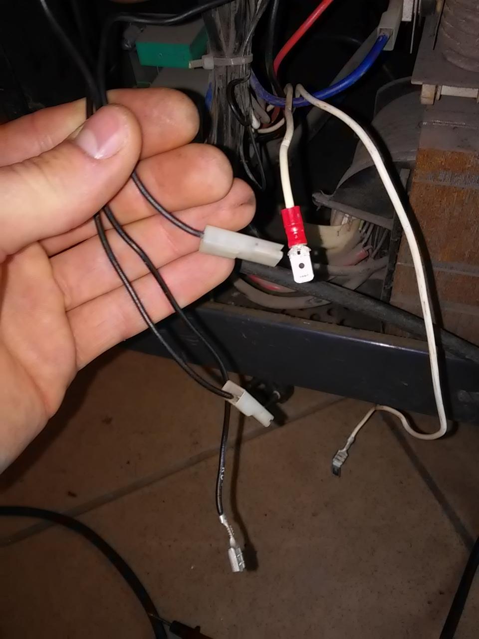

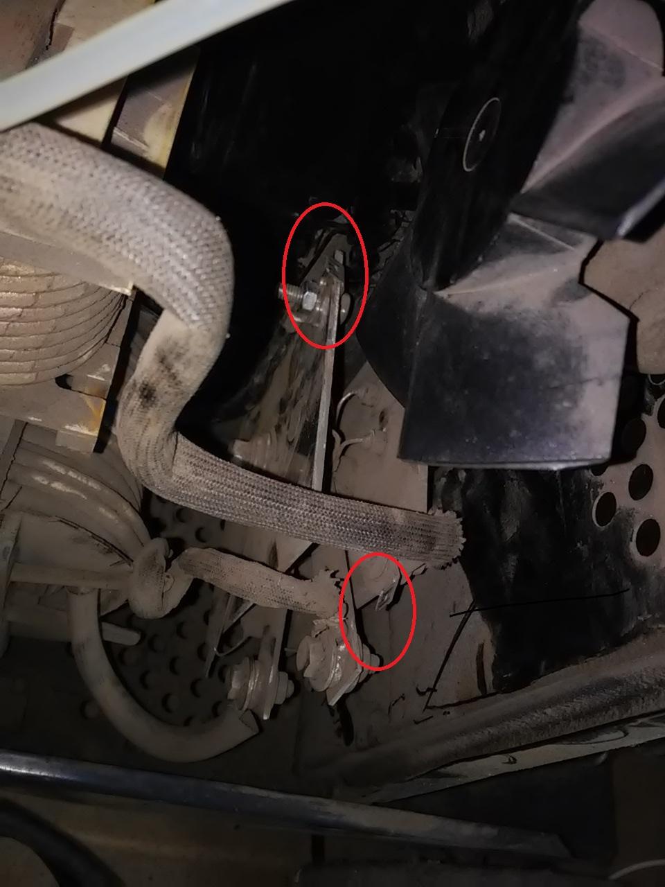

    Einhell sga 145 turbo I replaced the wire feeder after replacing it, I don't know how to connect the welding gun.
    • I do not know how to connect the Einhell sga 145 turbo welding gun 20170505_095325.jpg (91.85 KB) You must be logged in to download this attachment.
    • I do not know how to connect the Einhell sga 145 turbo welding gun 20170505_095115.jpg (103.28 KB) You must be logged in to download this attachment.

    SQ5AZP - could you clarify this scheme for me more? 3 wires 2 from the switch to the board (these two white wires) and this 3 ??

    And check with an ohmmeter what it is connected to. Since the Einhell scheme does not provide for its use - just insulate the tip and leave it in the air.
    Unless you mean this thick-current ...

    I mean this 3 coming out of the handle .. without that white insulation. Thanks for your interest, but I don't think I could do anything. in some service the infusion will probably exceed its value :)

    Check the switch's passage with an ohmmeter and connect these wires to those places where you had previously connected the cables from the old handle. (I hope you didn't pick the tiles ....)

    probably because of old age the positive wire was broken.
