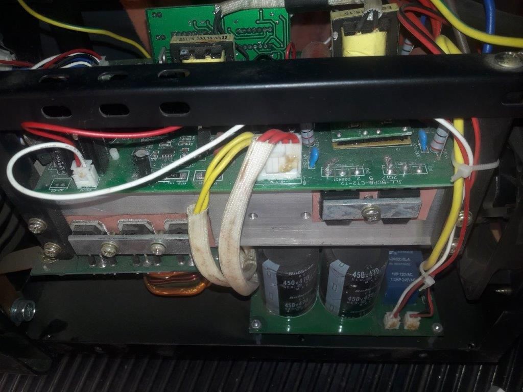

    As in the topic, the welder turns on the 15 V power supply, there is no response to the potentiometer. On the forum I found a diagram very similar to my system, but only the main one, I lack the control part, the welding machine has a hot start and anti-stik. My measurements show that I do not have voltage for the IGBT control transformer. On the control board, apart from the integrated circuits, there is such a bridge composed of IRFZ24 and IRF9Z24, it is possible that they control the operation of the steering transformer.
    Any advice or a diagram of such a welding machine? The board is removed from the heat sinks.

    Take accurate photos of the plates of this welder and blend.

    For a better overview, I have included descriptions of the scalers in the photo. The stabilizers are operational. LM358 with the potentiometer plug replaced, IFRZ24 checked. After removing the plug (bottom right) from the welder's output, the output voltage increases from about 9V to 57V, but the minimum current barely sparks.

    Check TL084 - solder the stand there and replace it.

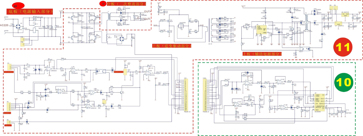

    Hello, I have a similar problem. The welder always welds at maximum current, no adjustment.
    On the display, the value of current changes when the potentiometer changes.
    I checked all voltages according to the diagram below and everything is correct.
    The question is what else should be checked and measured?
    MGSI-200 IGBT Magnum Welder: No Response to Potentiometer, Need Control Diagram

    After all, the error amplifier circuit must receive a signal from the current transformer!
    When the transformer is damaged, signal forming elements, paths to op-amp. - the effect will be exactly as described, and the amplifier's voltages will be within 10-15% tolerance! load the output with a 2? / 800W resistor and you can easily feel where the problem lies with the oscilloscope.
