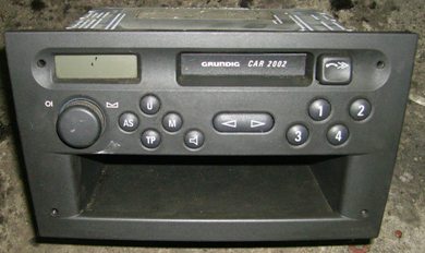

    I turn on the ignition switch so that the control lamps come on. I press the AS button, then while holding it, I turn on the radio and keep holding AS to be able to enter the code. Unfortunately, even despite holding this button for a long time, the text error is still displayed. (Opel Corsa C 2001. Radio Grundig 2002). What to do to enter the code. Unfortunately, I have no instructions from the radio.

    Three things that can be:
    1. Checking the connection between the panel and the motherboard
    2. Broken keyboard - something is sticking
    3. Full memory
    To work
  • #3 19860414
    Mrcincin
    No power to memory a thin red wire in the cube, after checking and connecting the plus, the radio looks beautiful
