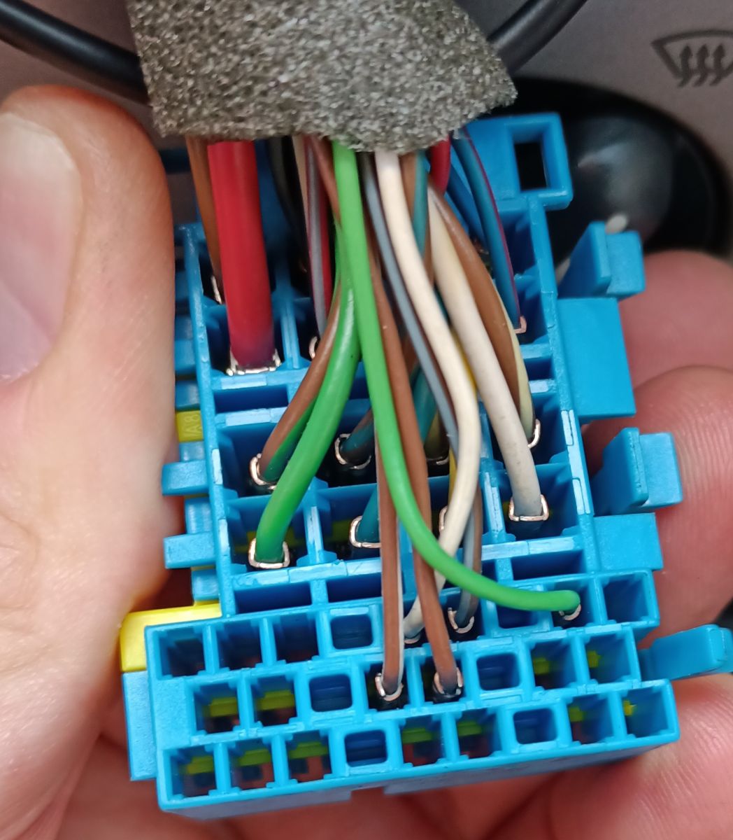

    #17 21191897
    smartdomtomashek
    I would like to reheat the topic of Key1 and Key 2
    Opel Meriva 2004 versus Chinese
    There are 5 wires coming out of the radio and 2 wires coming out of the chine's cube plus two loose wires marked Key 1 and Key 2.
    The wires of the chine's cube cover the android radio to the astra h - Where do I connect key1 key 2? To can h can L not work 50% with the original cube
    Anyone perhaps already worked through this?

  • #18 21191982
    milejow
    Posts: 13098
    Help: 1563
    Rate: 5148
    I think the steering wheel control in the Meriva is the same as in the Astra G, i.e. resistive, there was already a description of the connection somewhere on the forum, you just have to search for it.

    #19 21641800
    lezbriddon
    Afaik the cd30 radio uses resistive buttons on the big connecter under the usual power and speaker connectors, its 2 wires, one is SWC (Steering Wheel Controls) and immediately next to it is the ground for the controls.
    connect these to your new head unit, SWC to key1 , gnd to headunit ground.
    Can l-h on these radios(cd30/cd30mp3) I believe is just for the lcd display.
    I'm just fitting one myself and was wondering how the SWC worked and I know this thread is as old as I am.....
  • #20 21642082
