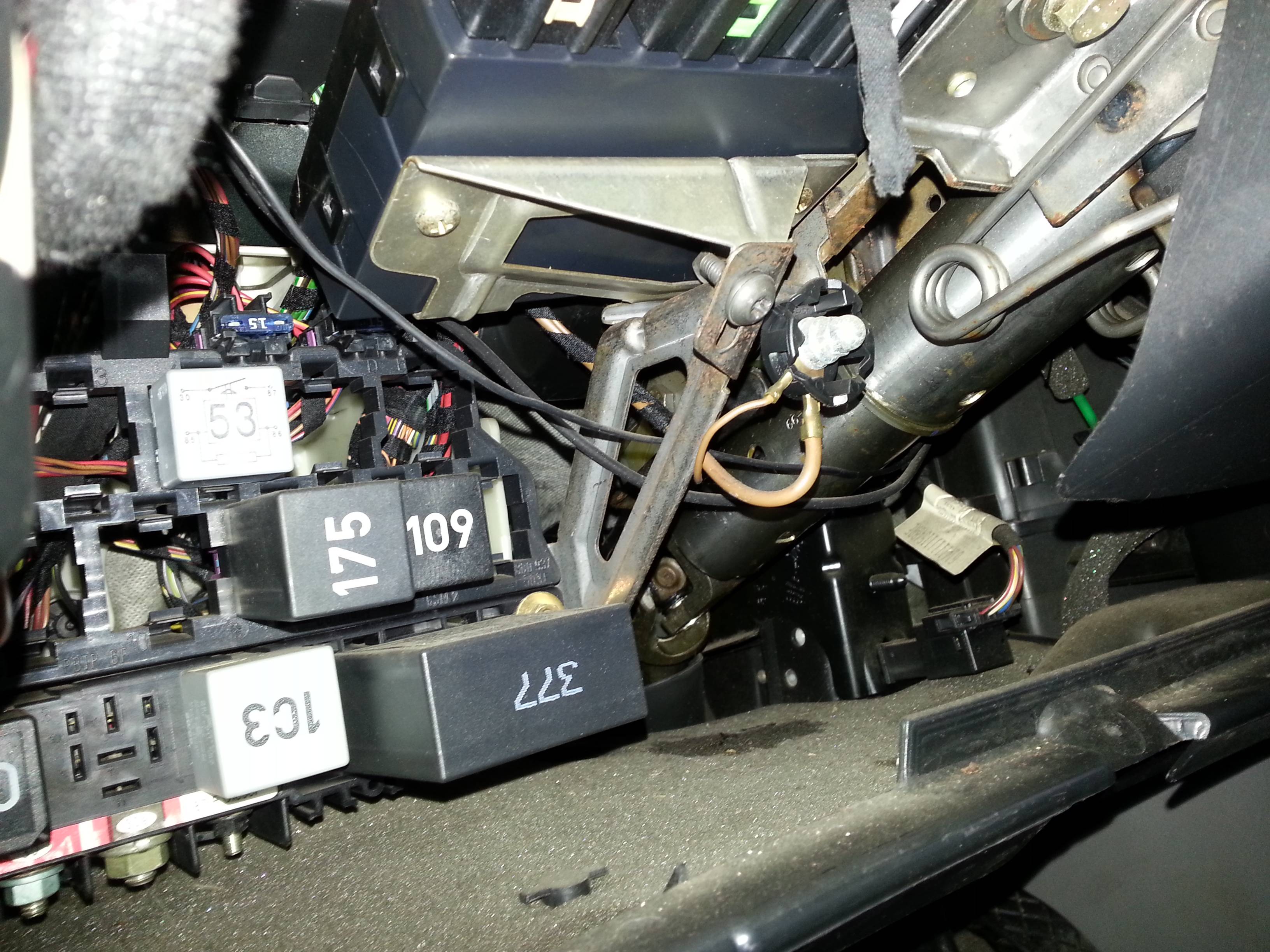

    There are probably 5 power supplies from fuses for comfort.
    The lamp in the trunk is controlled by the mass from the lock, the plus comes from the comfort module and the same plus goes to the cabin lighting.
    This plus goes through the relay from the comfort module.
    Show me what module you have.
    Open it and see which relay is ticking because there will be at least two inside.
  • #7 16461888
    Pablorza
    Posts: 19
    Photo attached
    • VW Bora: Ticking Sound & Tailgate Indicator Glowing After Rear Lamp Bulb Replacement image.jpeg (769.7 KB) You must be logged in to download this attachment.

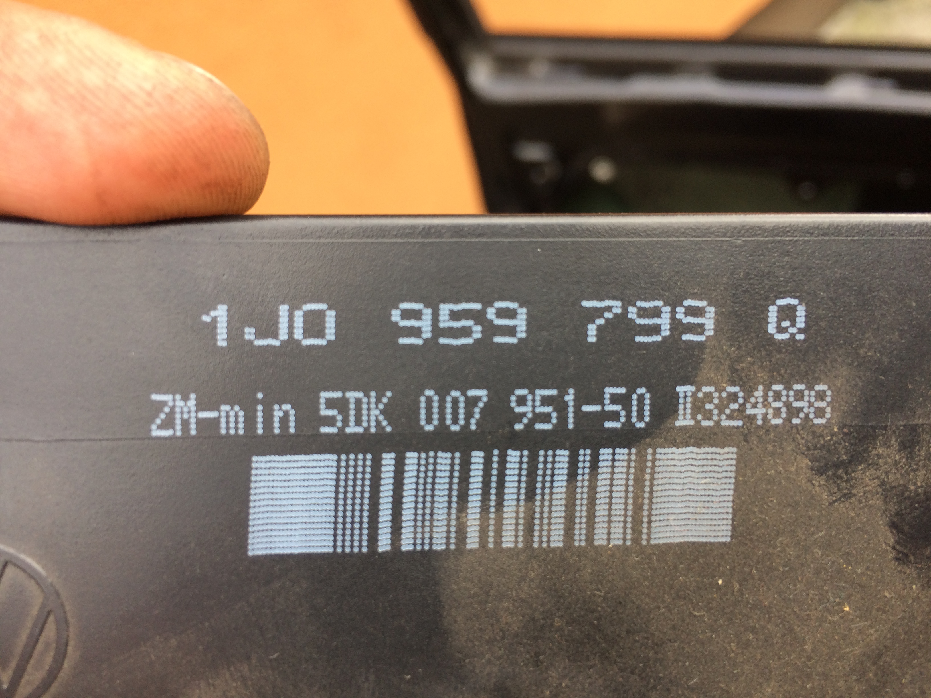

  • #9 16520367
    Pablorza
    Posts: 19
    Hello, my module number is: 1J0959799Q (ON THE PICTURE) ticks.
    I decided to replace it entirely. Today I am going for a module with the same number?
    Should it stop humming after plugging it in, or only after adopting it? I am asking because before I buy the module I will connect it to the car.
    • VW Bora: Ticking Sound & Tailgate Indicator Glowing After Rear Lamp Bulb Replacement IMG_0198.JPG (1.97 MB) You must be logged in to download this attachment.
  • #10 16520602
    grala1
    VAG group specialist
    Posts: 9823
    Help: 1495
    Rate: 5052
    You put in the module and the lighting should work. There, only electric windows are set in the coding - two, four, etc. Lighting should work on each coding.
    The encoding should be rewritten from the old one.
  • #11 16525494
    Pablorza
    Posts: 19
    I connected 3 modules with the same number before buying and unfortunately it is not a damaged comfort module.
