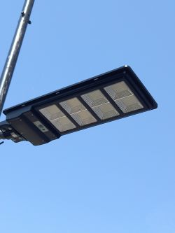

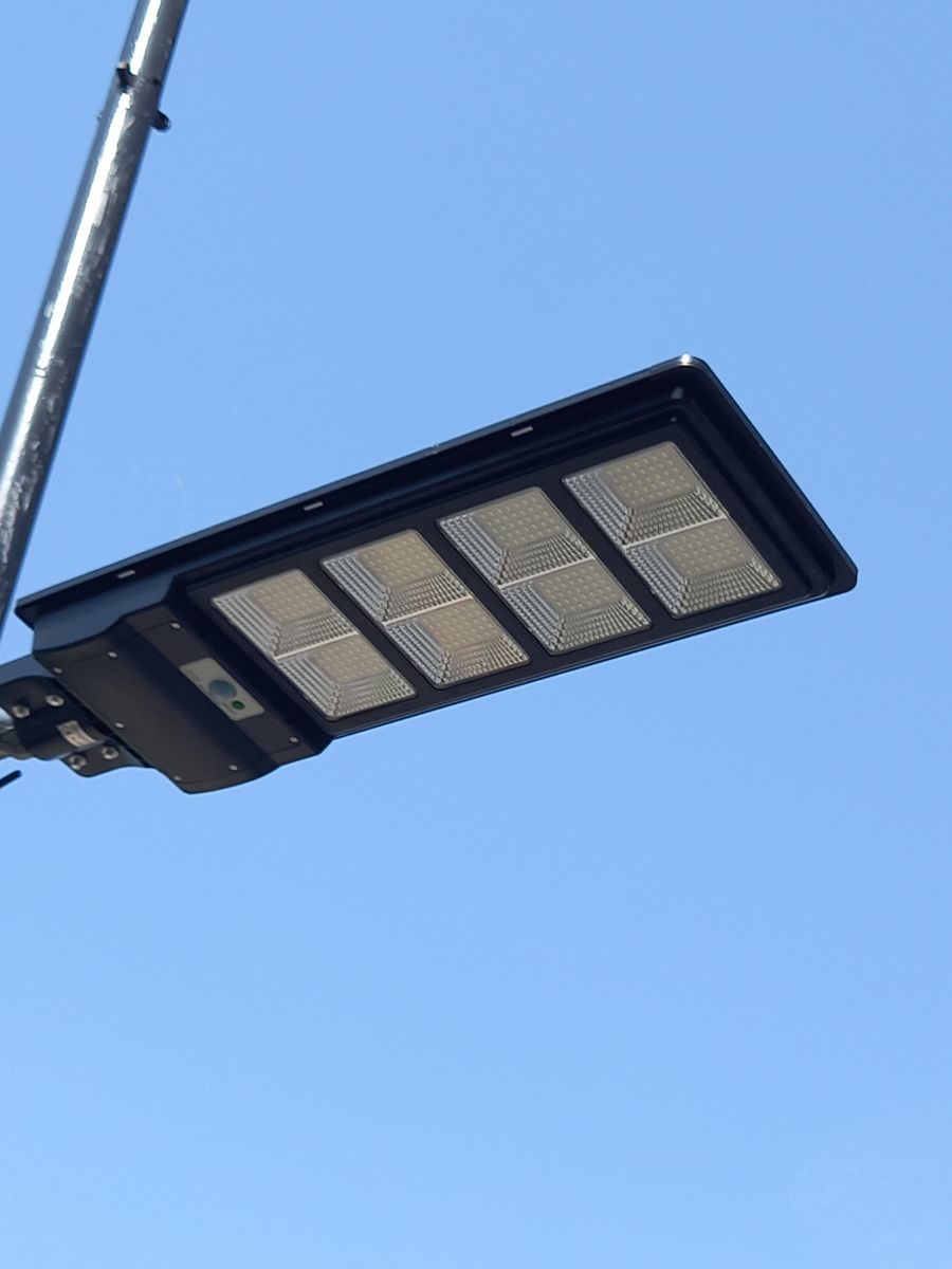

    It's not a lamp, it's a toy, buy something stronger It's December, the sun is almost gone. My lamps turn on at dusk. Batteries in this weather do not charge to the max, lighting time, or rather power consumption of about 6 hours, BMS turns them off because the battery is empty. I added a 100 W panel it's better charging current in the sun is 2.5 A in the shade 0.2 A is better the lamp shines until the morning The panel is mounted almost vertically the snow falls off it automatically Solar Lamp Opinions: Battery-Charged Motion Sensor Lights for Illuminating Dark Spaces

    The lamps are available on Allegro, the more expensive you are, the better, i.e. they shine brighter and have a larger battery capacity. The prices of good lamps start from PLN 250 for PLN 50.
