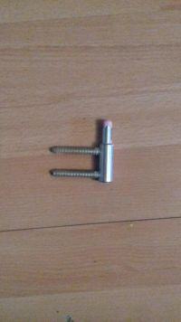

    today when installing the door, I noticed that the door frame lacks three screws holding the hinges.
    It's about those screwed in the picture below.
    Will anyone suggest where you can buy such screws?
    I tried to match some, but unfortunately none match. Looking for Replacement Hinge Screws for Door Frame - Where to Buy?

    Looking for Replacement Hinge Screws for Door Frame - Where to Buy? Certainly there was a screw because now I can pull out the hinge. Attached is a photo of the hovering pulled out
  • #9 16464221
    Parowy
    Level 22  
    Posts: 955
    Help: 55
    Rate: 227
    Welcome.
    There sits a 4mm screw with a hexagon head, plus a piece of metal that tightens the hinges.
    I should have something like this at my work additions, I will give you more details tomorrow.
    PS If the screw is missing and the plate could fall / fall behind the door frames.

    The plates are for sure but I can't match any screws ...

    Hmm, a nut from the other side could also fall out, from the wall side as if.
    To be precise - the doors are new, the wings have not been installed before, so you didn't know that there are missing screws, there are three hinges and there are no screws, right?

    The door is new, the frames were assembled a long time ago, in the meantime the room was painted and the hinges were pulled out of the frame, and probably the screws were broken.
    I unscrewed the screw from another frame and there is a problem of this type that I tried to screw it into the frame where these screws are missing and the case is as follows - if I pull out the hinge then the screw can be screwed in and then I cannot insert the hinge - but if the hinge is inserted, unfortunately I can't screw the screw in, it goes in and turns off ...

    Try it this way - remove the hinge, screw in the screw as far as it will go, loosen and insert the hinge as much as it enters, then simultaneously press the hinge and loosen the screw a little bit, press the hinge so tightly, you can gently tap with a small hammer or knock with your hand.
    In new frames, this is usually the case.
    If the hinge comes in but at the same time the screw is loose, in the sense the thread ends, it is simply too short.

    It looks like this:
    Looking for Replacement Hinge Screws for Door Frame - Where to Buy? Looking for Replacement Hinge Screws for Door Frame - Where to Buy?
    I am assembling Perfect Door, one hinge will be all I need, write on PW.
