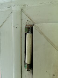

    Good morning,
    I did not find a similar topic, I will describe my situation, and after fixing it, I will add a step-by-step solution for others.
    Situation:
    My parents were diagnosed with a problem related to closing the balcony door - it turned out that it was the top hinge has a crack at the top the pin almost falls out and the door is slightly lowered. Due to the risk that the door may come off completely at any time, I would like to replace the hinge quickly. I won't be there until Wednesday, but I'd like to get an idea of the topic.
    Repairing Cracked Upper Hinge on Balcony Door: Steps for Successful Replacement
    I have already found a potential way to disassemble the door ( YouTube video window dismantling ) seems simple enough. Although in this case, the hinge is tiltable.
    Repairing Cracked Upper Hinge on Balcony Door: Steps for Successful Replacement Repairing Cracked Upper Hinge on Balcony Door: Steps for Successful Replacement
    If someone has experience in the subject, I wonder:
    1) Will I be able to handle it without any problems (I assume that it is enough to pull the pin, remove the door, unscrew the bolts securing the hinge to the "frame", screw the new hinge with the same spacing of bolts, insert the door, insert the pin),
    2) Is the tilting mechanism independent of the hinge (somehow it goes under the bolts), or is it necessary to replace the whole due to a broken hinge (or you can opt out of the tilt),
    3) Are such hinges standard and am I able to order one online now, or is it better to disassemble and take them to the store,
    4) Is there any recommended company that produces stronger hinges, and possibly there is a difference between the hinge for doors and windows.
    I haven't disassembled the hinge yet, because I didn't make it on my last visit. So I don't know how many bolts there are or what the distance is between them. I know that it is about 10cm with the cap.
    Thank you in advance for constructive comments, the problem is probably quite trivial, but it will be good to have such a case described on the web.
    Regards

    In your first photo you can see something suspicious - it looks as if the locking pin was not pushed in properly during assembly and it popped out of the upper slot :?:
    That's interesting, there is no way to determine it. Perhaps the fault of the assembly, but the windows are already old and perhaps the tilt mechanism also contributed to it, I don't know.

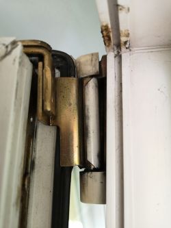

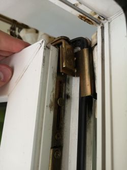

    I tried to knock out the pin, but it wouldn't budge over the curve. I was about to buy such a "handle" assembler, which would probably help. But somehow I stopped dealing with it because the door was sticking.
    After some time, a crack appeared in this hinge, which forced me to act. On the closed door, I managed to pull the pin somehow. It was enough to unscrew a few screws and screw in a new hinge with a new pin. Except I had a problem finding the right one.
    I figured it was a winhaus. But there were two possible types. One newer for PLN 15 on the allegro, another hard to get with a different shape of the convex, which enters the frame, for which they asked PLN 47 :O the more expensive one came earlier, it fit, so I canceled the cheaper one, so as not to waste time.
    To sum up, in such a situation it is enough to close the door, knock out the pin, unscrew the hinge, insert and screw in a new one, drive in the pin. Most of the problem could be with the pin if it is crooked. And most importantly, measure the dimensions of the hinge to find out which one to buy.
