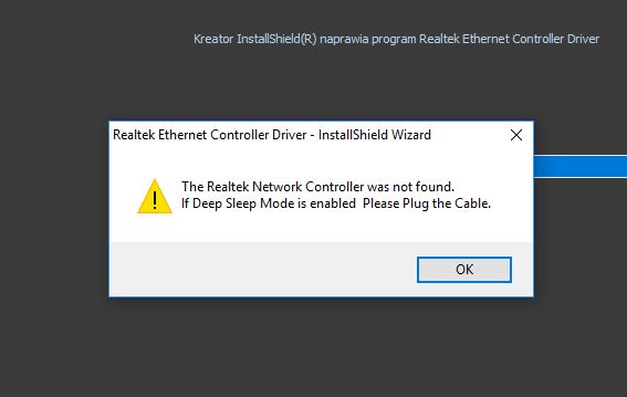

    After the last storm my network card refused to obey :(
    Consequently, I had 2 ideas:
    1) reactivate the card again (realtek RTL8111E card integrated on GA-970A-D3 board)
    after oe downloading the latest drivers and trying to update, he gets the message:
    Realtek RTL8111E Network Card Not Detected by Windows 10 & HP J2585B NIC Driver Search
    in the control panel, my list of network adapters is as follows:
    - After connecting the cable, the diode shines with a steady green light
    - The router cannot see the connection (i.e. the LED on the router is not lit)
    - ipconfig / all returns blank information
    - does not reach the router through the browser - no connection
    I lost all hope of recovering this network card ...

    Welcome. You won't get the first one after the storm. Check on the motherboard if this chip has no visible damage, burns, or if it does not heat up to redness - sometimes this is how the life of these systems ends.
