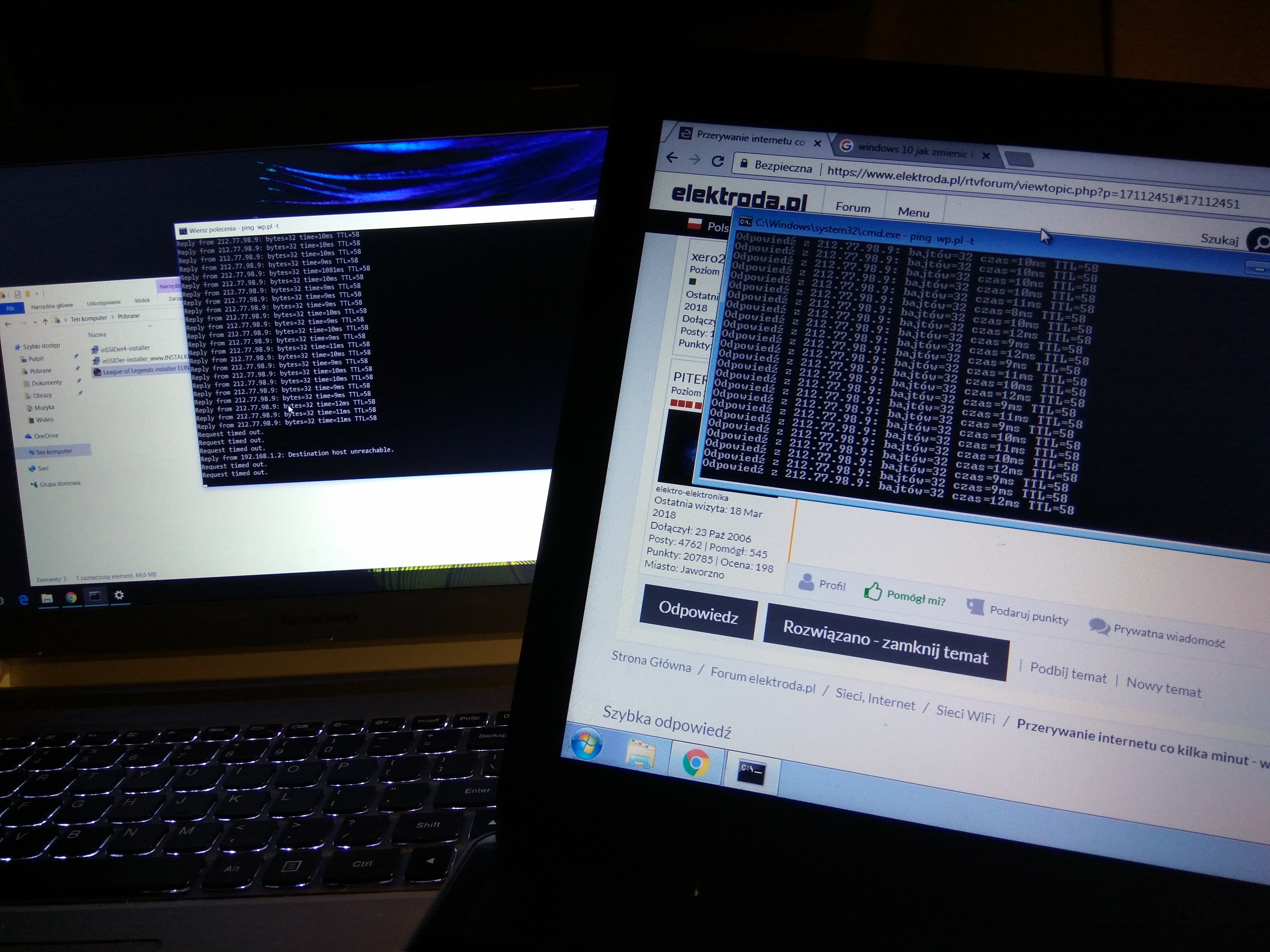

    Hello! I have a problem with the WiFi network. Well, the problem was on both laptops that the internet was interrupting every few minutes and it was back to normal over and over again, so I did the format on both laptops. On one with win7 everything works fine, but on the other one with win10 there is the same problem nothing has changed every now and then it hangs up in the command line shows request time out. The drivers are updated, the computer is clean because of the format. Any advice?

    This is a local ISP, the internet is radio and the brand of the router is Netis WF2419D. I will add that I have just restored the initial router settings and still nothing has changed. Everywhere, the internet works without any breaks, only on this laptop with win10 it breaks up every bit.

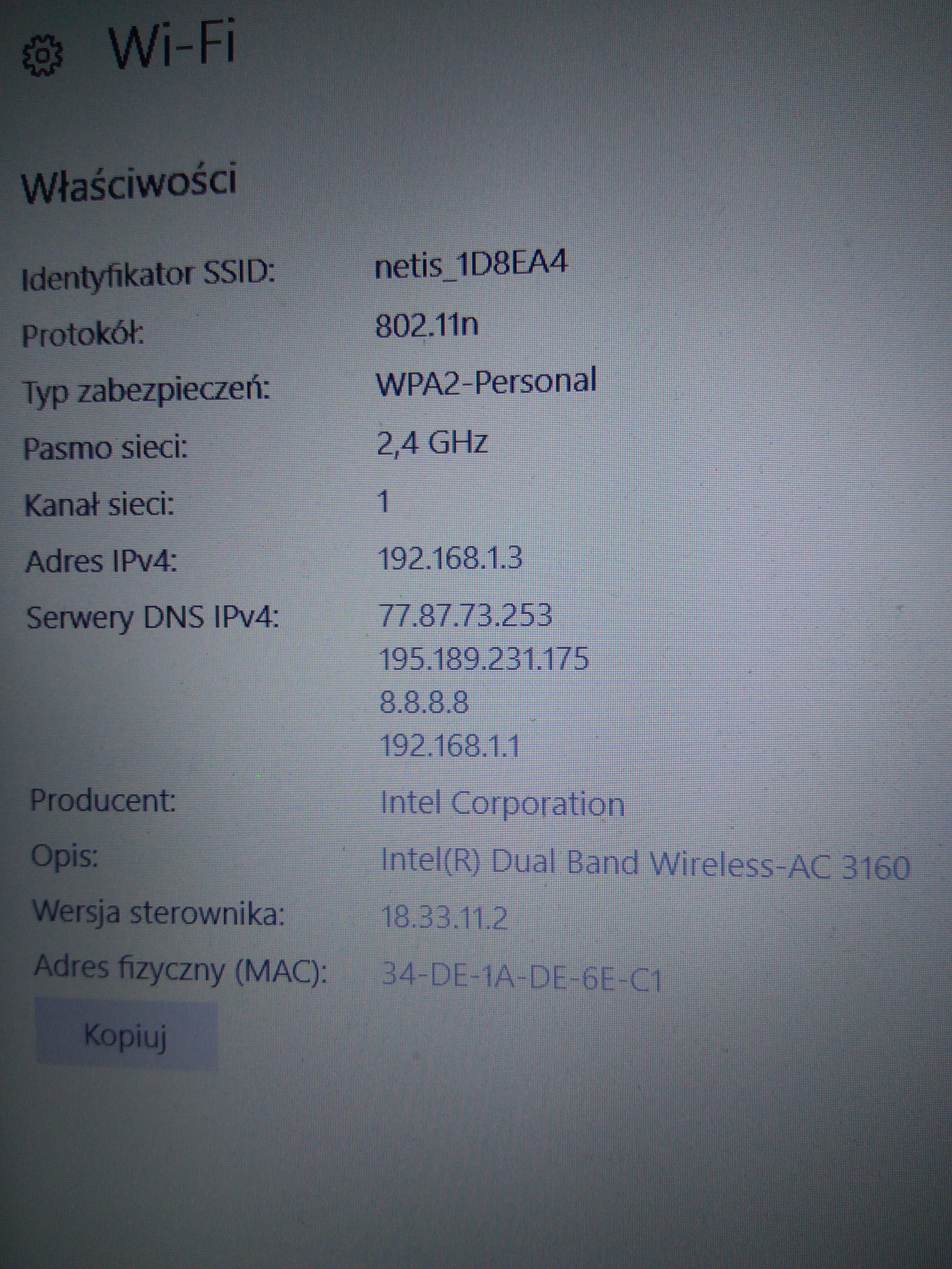

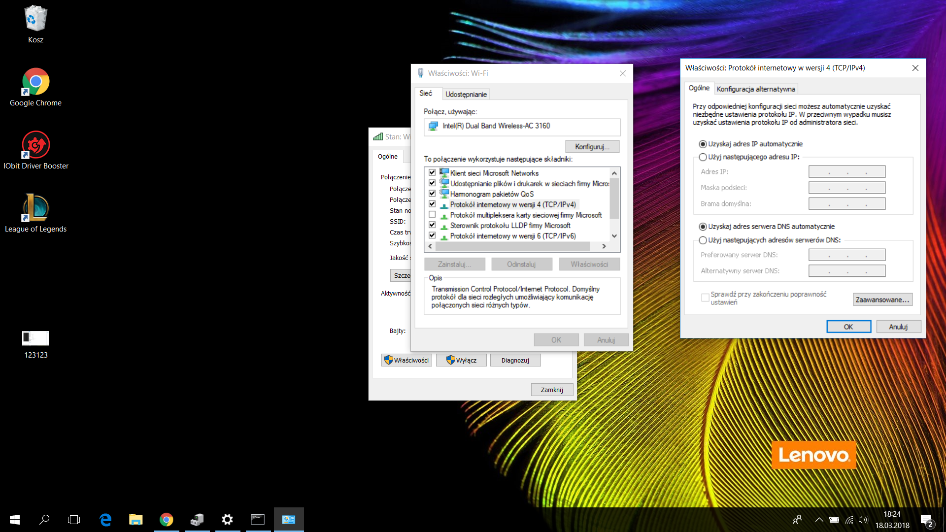

    Upload skreen from Wi-Fi adapter settings?

    I meant from the Control Panel tab settings.

    Just give me a general view and do a diagnosis of the Wi-Fi connection.

    And do you have VPN enabled or disabled in your settings?

    No, both options are turned on to allow VPN connections on tariff networks and while roaming

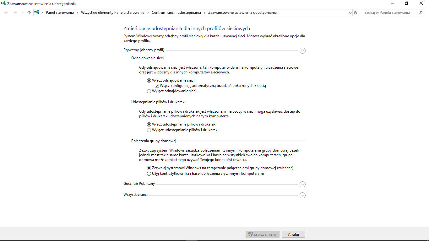

    How are your sharing options set? Repeated Internet Interruptions on Windows 10 Laptop Despite Formatting and Driver Updates

    I had these options turned off, turned them on but still the same: /

    How can it change the bandwidth? On the Internet from the phone, this lenovo flickers well, nothing gets stuck, only when connected to the router, it's a shame

    And the standard of this router is B / G / N is set to automatic? From the phone it is standard that the fault will go to the router side because Lenovo has a Dual Band card in it?

    Is it about the radio band? This is how it sets to 802.11b + g + n, I tried to change to b + g but no change. Yes, the card is a Dual Band

    Do not make a pledge on the BGN machine. In this win 7 laptop, what is the Wi-Fi card at 150Mbps of bandwidth and now goes on the N band and doesn't cut off your internet?
