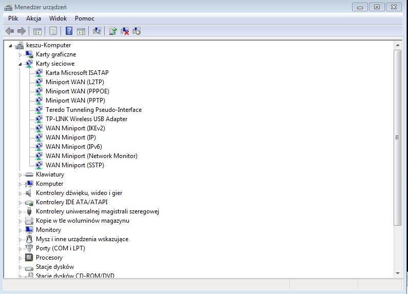

    Well, I do not know what the fault may be. When I connect the internet cable to the integrated network card of the motherboard (H81M-S2H), the device manager does not detect this card, there are no question marks, and when I click to connect me to the internet then solve the problems, I get a message that no network card has been detected. I installed mobo drivers both from the disc and from the manufacturer's website, I did the format but nothing works. The LEDs on the back of the Internet cable input are off.
    In the task manager, under "show hidden devices" there is only what is in the attachment, except that TP- link wireless usb adapter is a wireless network card that I am currently sitting on. Computer Fails to Detect Integrated Network Adapter on H81M-S2H Motherboard Despite Driver Updates

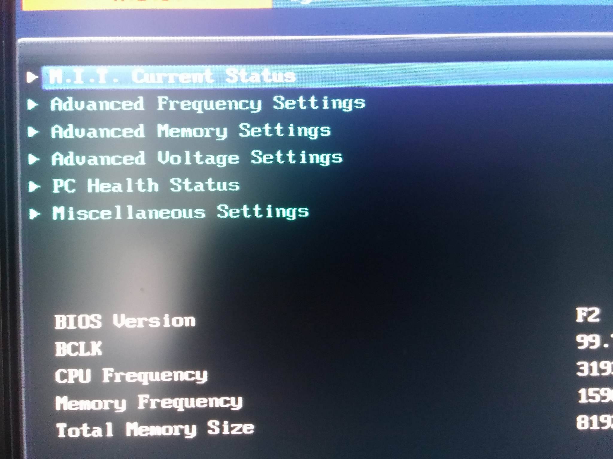

  • #3 16169272
    skwaro1214
    Posts: 15
    I have an uefi bios and I don't really know where it is so honest (layman).
    Added after 1 [hours] 14 [minutes]:
    Computer Fails to Detect Integrated Network Adapter on H81M-S2H Motherboard Despite Driver Updates Computer Fails to Detect Integrated Network Adapter on H81M-S2H Motherboard Despite Driver Updates Computer Fails to Detect Integrated Network Adapter on H81M-S2H Motherboard Despite Driver Updates Computer Fails to Detect Integrated Network Adapter on H81M-S2H Motherboard Despite Driver Updates

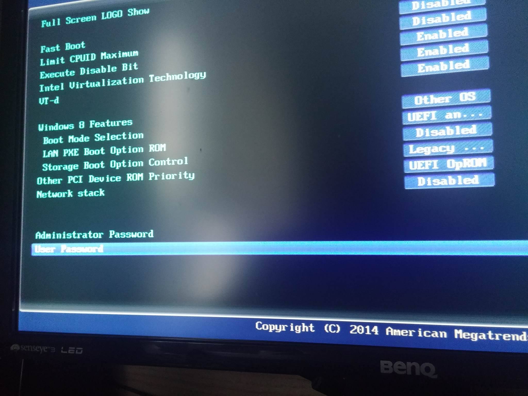

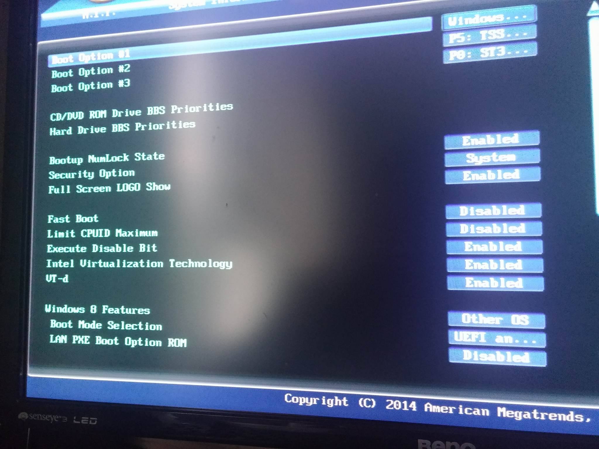

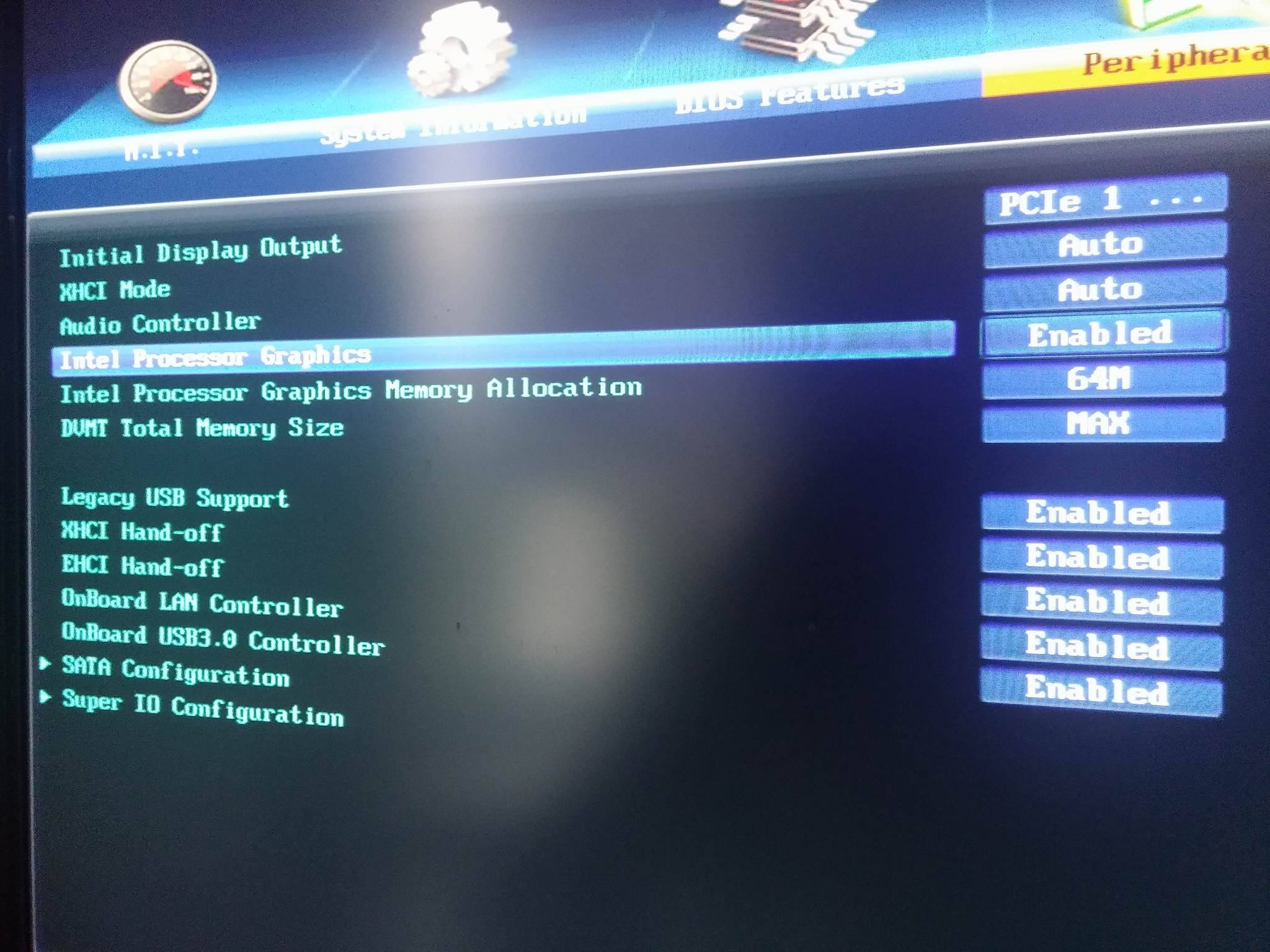

  • #4 16169630
    bogiebog
    Posts: 24793
    Help: 2569
    Rate: 1528
    Peripherials / Onboard Lan Controller
  • #5 16169966
    skwaro1214
    Posts: 15
    As you can see, this function is enabled and the cards are still not detected

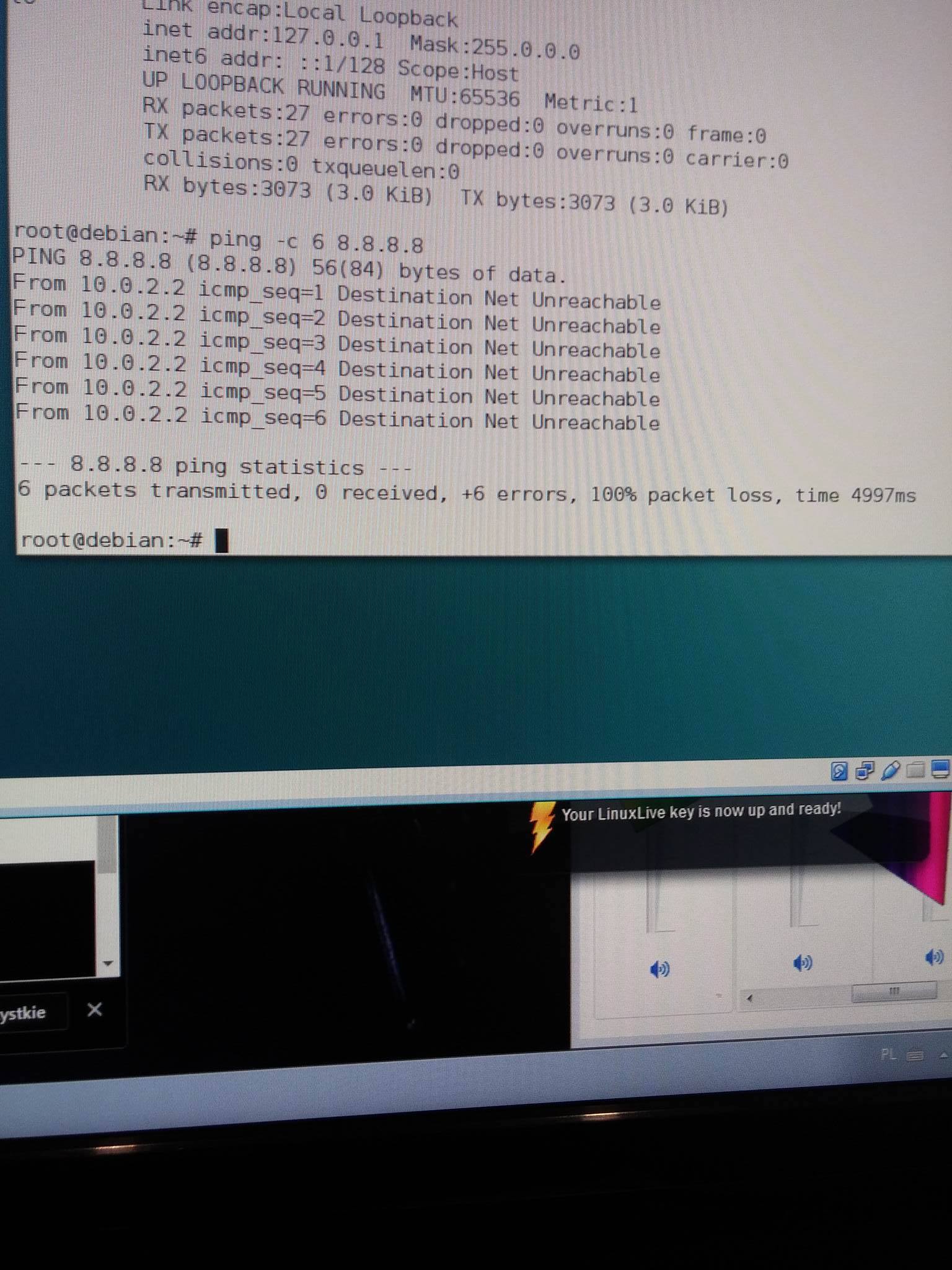

  • #10 16170842
    bogiebog
    Posts: 24793
    Help: 2569
    Rate: 1528
    Connect the cable and check if there is internet, start the terminal and in the terminal
    ifconfig
    ping -c 6 8.8.8.8
    lspci
    paste results for the "spoiler" section

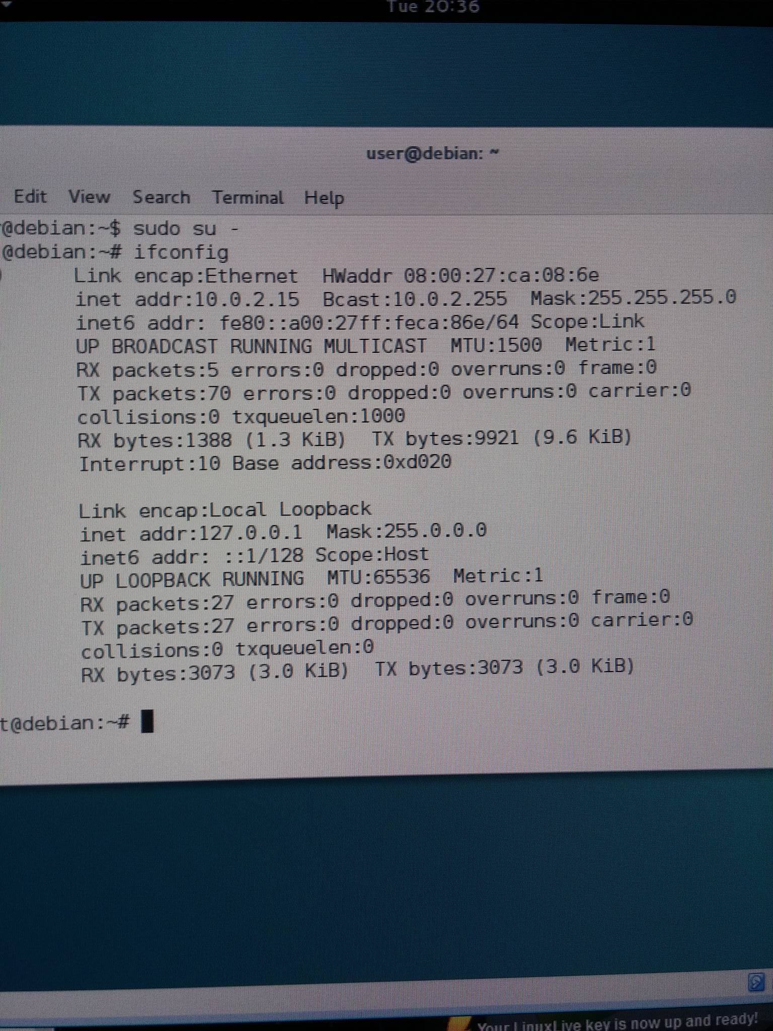

  • #11 16170881
    skwaro1214
    Posts: 15
    Added after 5 [minutes]:
    I just have something like that, that's it?
  • #12 16170916
    bogiebog
    Posts: 24793
    Help: 2569
    Rate: 1528
    Before these commands in the termial window, run
    sudo su -
    and then the rest
    ifconfig
    ping -c 6 8.8.8.8
    lspci
    It looks like the network card is showing "Ethernet controller"
    Under windows, in device manager, View / Show Hidden Devices
    did any network card show up?
  • #13 16170993
    skwaro1214
    Posts: 15
    you Computer Fails to Detect Integrated Network Adapter on H81M-S2H Motherboard Despite Driver Updates Computer Fails to Detect Integrated Network Adapter on H81M-S2H Motherboard Despite Driver Updates Computer Fails to Detect Integrated Network Adapter on H81M-S2H Motherboard Despite Driver Updates
    Results
    manager the same as he was.
    #14 16171026
    bogiebog
    Posts: 24793
    Help: 2569
    Rate: 1528
    The card is correctly detected by linux,
    combine with windows, can you reinstall? no ? then search on google
    windows does not see network adapter
    https://answers.microsoft.com/en-us/windows/f...adapters/3d8a589b-921d-453b-86af-36bc44eb1771
    Boot into Safe Mode + Networking, is the network adapter visible?

  • #18 16172560
    likufanele
    Posts: 81
    Help: 16
    Rate: 10
    Boot your entire computer with a Linux flash drive or CD, not VirtualBox, and then check again. VirtualBox emulates all hardware so obviously it will show a working ethernet controller.
