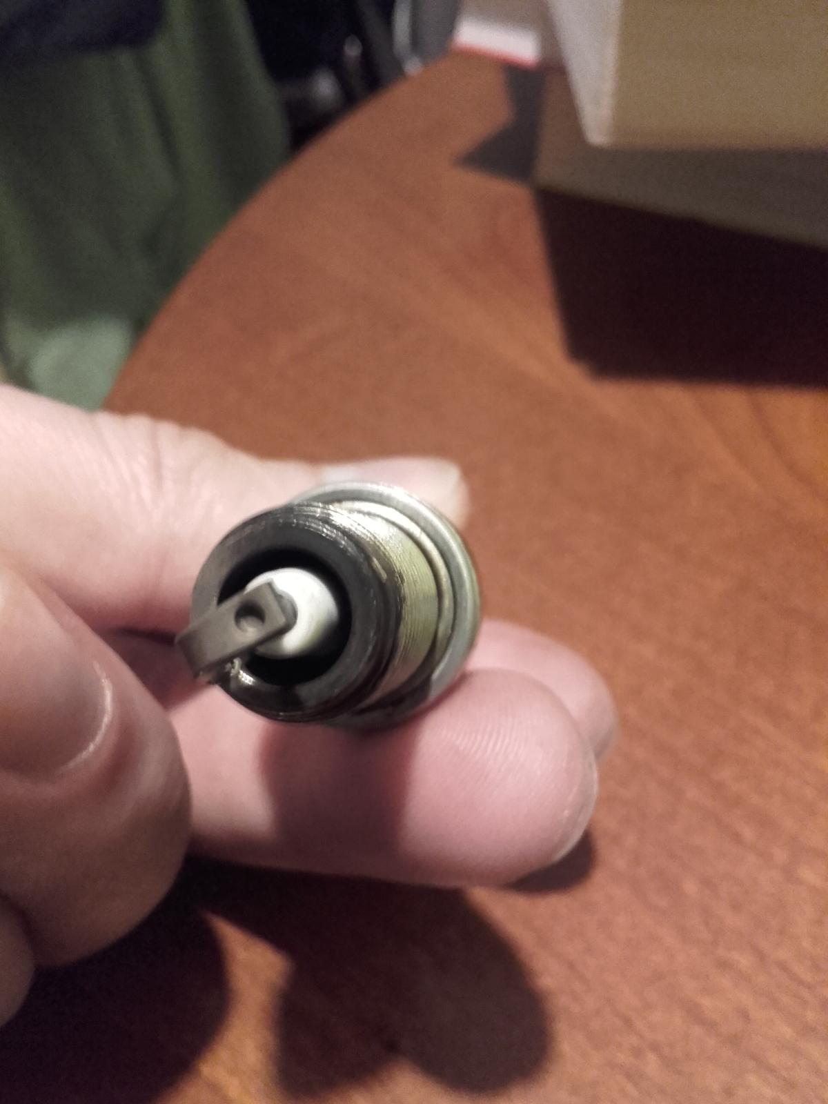

Why does my Vectra B 1.8 X18XE1 jerk during acceleration, especially around 1500–2000 rpm and mostly on warm engine, and what should I check first?
The jerking is most likely caused by the ignition system, especially the coil pack/ignition strip or damaged coil boots, rather than the exhaust or LPG settings [#16465000][#16474170] The fact that it gets worse under load and on gas also fits ignition trouble, because the spark-over voltage is higher on gas by about 20% [#16465000] Check the coil and the rubber boots/insulation carefully; cracked rubbers can affect engine performance and may need replacement [#16474170][#16466506] The original poster later confirmed that replacing the ignition coil stopped the jerking completely [#16516121] The discussion also notes that this engine should use 2-electrode spark plugs [#16474170][#16516121]

    Jerking in this range most often indicates a fault in the ignition system. Since you replaced the candles, essentially the coil remains. It's best to check the V gear slightly uphill, around 1500 rpm and press it downwards, as it is usually the ignition system. It jerks more with gas, because the spark-over voltage is higher by about 20% on gas.

    You don't write anything about replacing ignition cables.

    You don't have ignition cables? So how does the current get from the coil to the candles?
    As for the question, cracks can affect engine performance.

    After degreasing, smear cracked rubber on the pipe with silicone grease. Nevertheless, it is glass grinding. Generally for diagnosis rather than repair.

    Hello, Vectra with this engine should have 2 electrode plugs, replace the ignition strip, if the rubbers are broken, you will not do anything, it will stop.
  • #11 16516121
The discussion revolves around a Vectra B 1.8 X18XE1 engine experiencing jerking during acceleration, particularly between 1500-2000 RPM and under heavier throttle. Initial suspicions included components such as the ignition system, EGR, throttle, and exhaust issues. Users suggested checking the ignition coil and cables, as well as the condition of the spark plugs. The author confirmed the replacement of the ignition coil resolved the jerking issue, and they opted for GM original two-electrode spark plugs. The discussion concluded positively, noting the vehicle's improved performance after the repairs.
