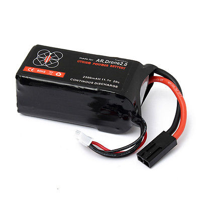

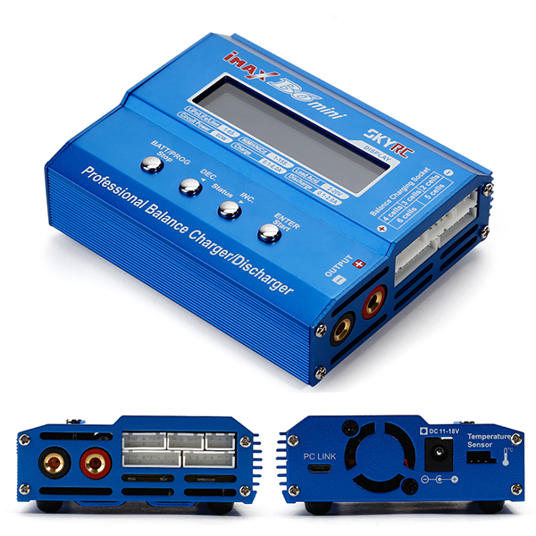

    I have been the owner of the IMAX B6 MINI charger since yesterday.
    I have 2 2500 mAh batteries that I would like to charge simultaneously.

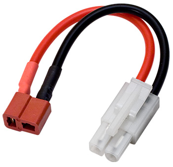

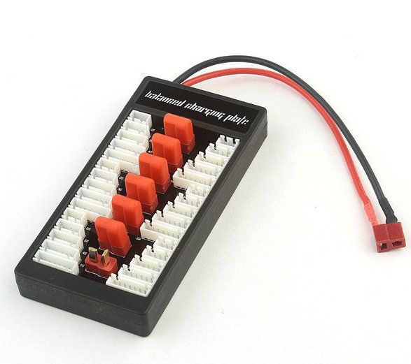

    The charger mentioned at the beginning of my post does not have two XH 3S sockets, so I bought a special adapter and cables for it.
    My problem is that I do not know with what intensity to charge them and if charging two batteries at the same time will not damage the batteries ???.
    What will happen if I charge both at the same time with 4 A and one of them charges faster than the other ???.
    The batteries are 2500mAh, 3 cells and 11.1V each. The cell has 3.7V each.

    The charging current depends on the design of the battery.
    How you can charge them should be in their specifications.
    Unfortunately, but this charger has low power and charging even with nominal current, two packages, is dangerously close to the performance limit.
    You can damage the packages and charger.
    These are large packages, and the charger is small. Load them one at a time.
    It is generally not recommended to charge two different LIPO packages with one charger.
    Package targets are usually selectable. But they can vary significantly between different packages.

    How little? I saw them charge 4 batteries simultaneously.
    What does the inscription 20C on the battery mean ???.
    I still don't know how much to charge.

    Thank you. After reading this article, I understood what I was dealing with. Summing up the data contained in the article, it turns out that the batteries that I have 2500 mAh should be charged with 2.5 A
